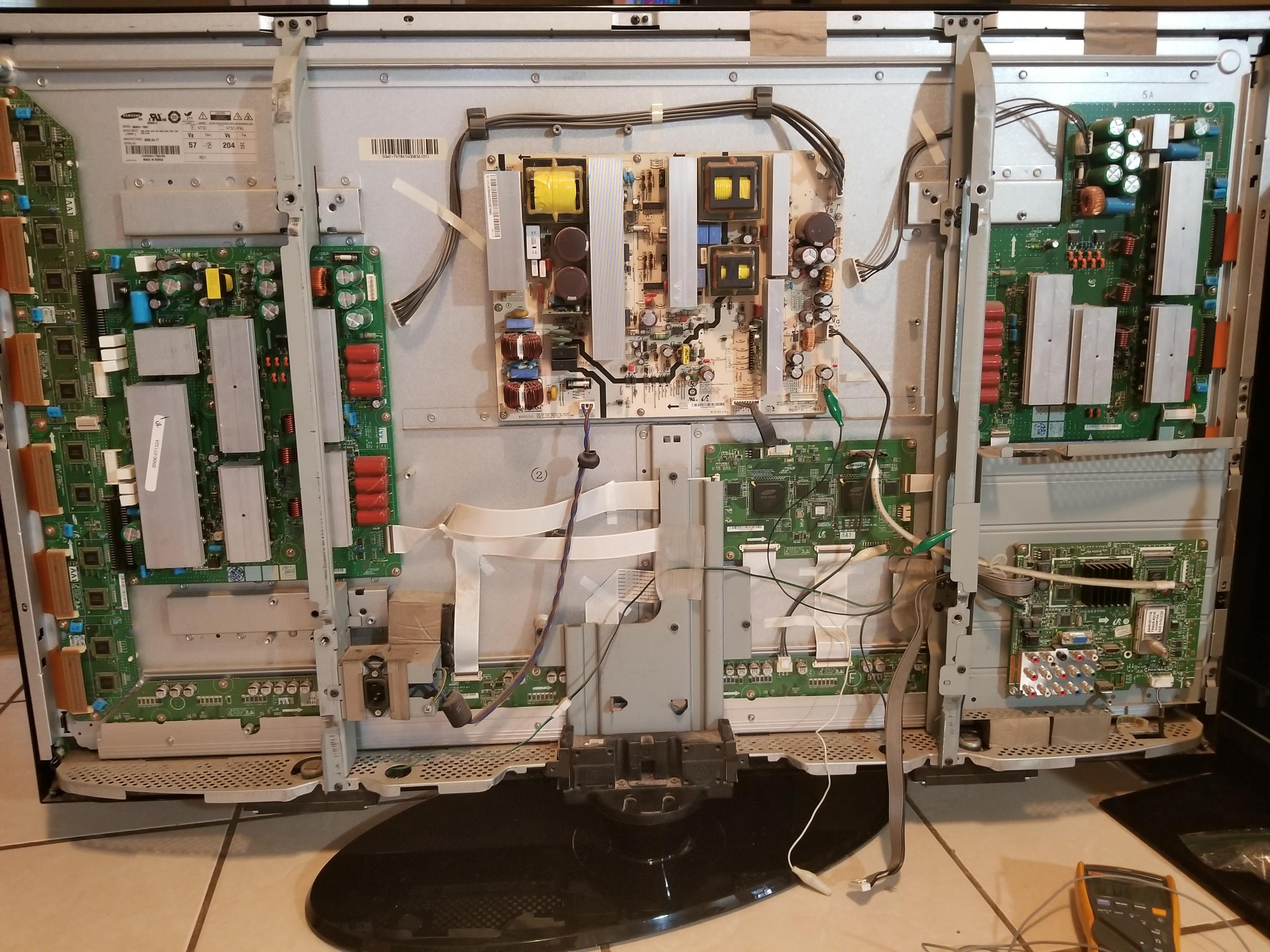

    Samsung PN50A510P3FXZA Plasma No Picture
    It's been a while since I worked on these... TV turns on and off normally (I assume I'd have sound), no screen glow at all. No VS voltage, VA is good.
    I have bypassed main board, forcing PS on with test pattern process and nothing.
    I have disconnected connectors to X and Y Main and still no VS. There is nothing obvious burned or shorted on the PS. I can't seem to find a SM either.
    Anyone familiar with these?? Thank you.

    Re: Samsung PN50A510P3FXZA Plasma No Picture
    Did you check for a short on the Vs line? Does the Vs voltage come up then drop off right after powering on? Most power supplies would need a load on the Vs line to test as they usually have Over Voltage Protection.
    You did check the power supply FS803 fuse correct?
      Ya the fuse is good and there is no short... It doesn't come up at all, 8V max...
        Check the connections on the output diodes like DS803 & Ds805, also check if DS803 or DS805 are ok and not shorted
          Should I be getting VS with X and Y disconnected?
            You may not get Vs with no load, You can use two 60w 120volt incandescent lamps in series connected to the power supply Vs and ground, if the Vs comes up it will light the lamps
              Well even with everything including Y and X main connected, VS doesn't go above 8V. Everything but VS seems to be good, 395V at main caps. None of the transistors or diodes I can find or that are in shopjimmy repair kit are shorted, unless it's one of the ICs but nothing is obviously showing bad or shorted.
              Anyone have a schematic of the this board (BN44-00222A) and can help tracing the VS line?

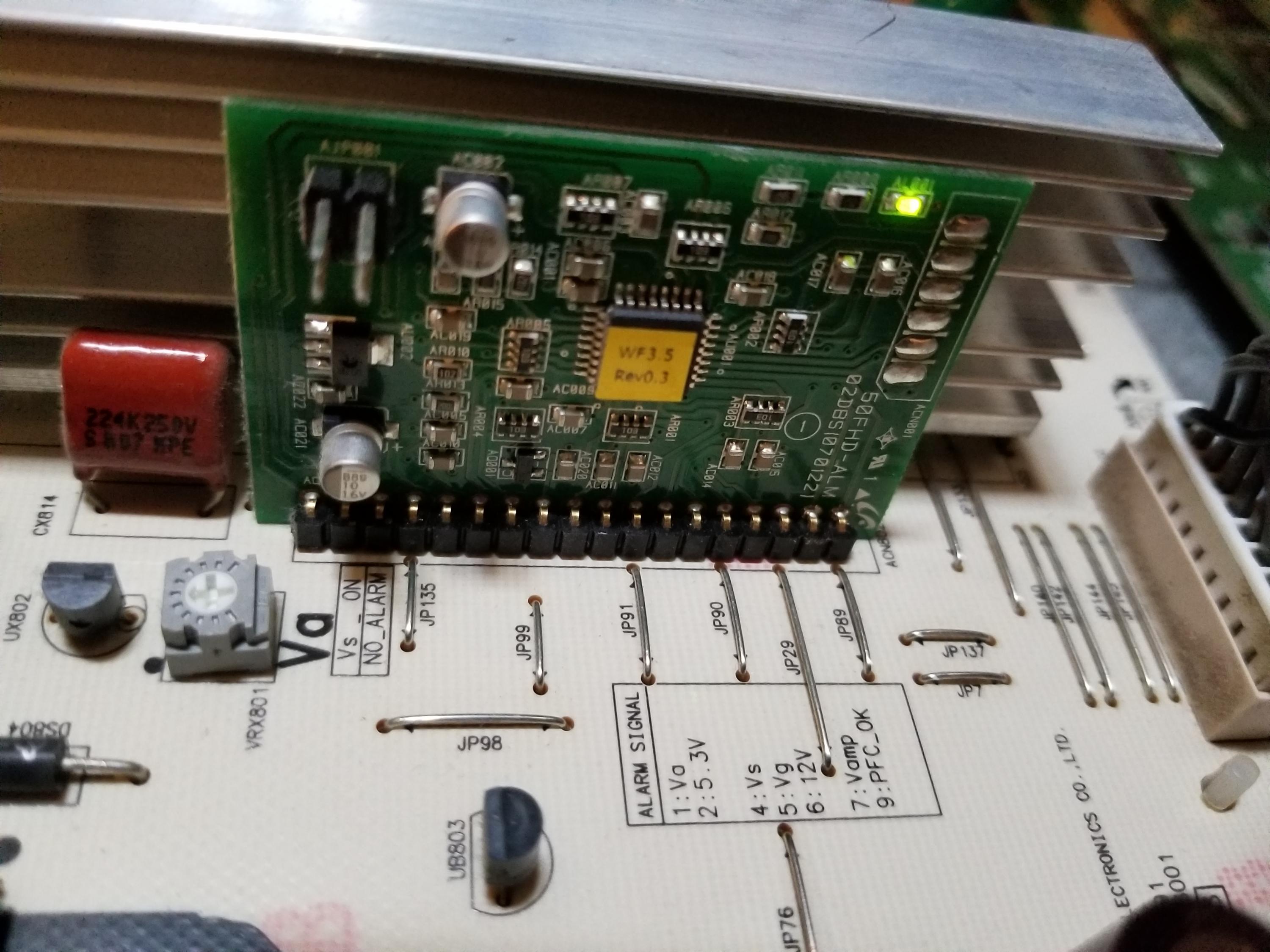

                Apparently there's this alarm board on this PS, I don't see it flashing a code or anything.. Not sure what to look for... Frustrating that there is no readily available info on a 10+ year old TV.
                          How do I tell about the alarm board? There is just one steady LED lit green on it, I don't see any way to determine what that means? Everything else seems to be good, minus the VS which just gives a steady 8.5V. I replaced almost everything in the shopjimmy repair kit..
                            If you are getting 8.5v it looks like that supply is trying to work, since you don't have a cap checker.
                            Why don't you try switching one of the blue caps, either cs811 or cs810 and switch it with CX810, and see if the Vs comes up

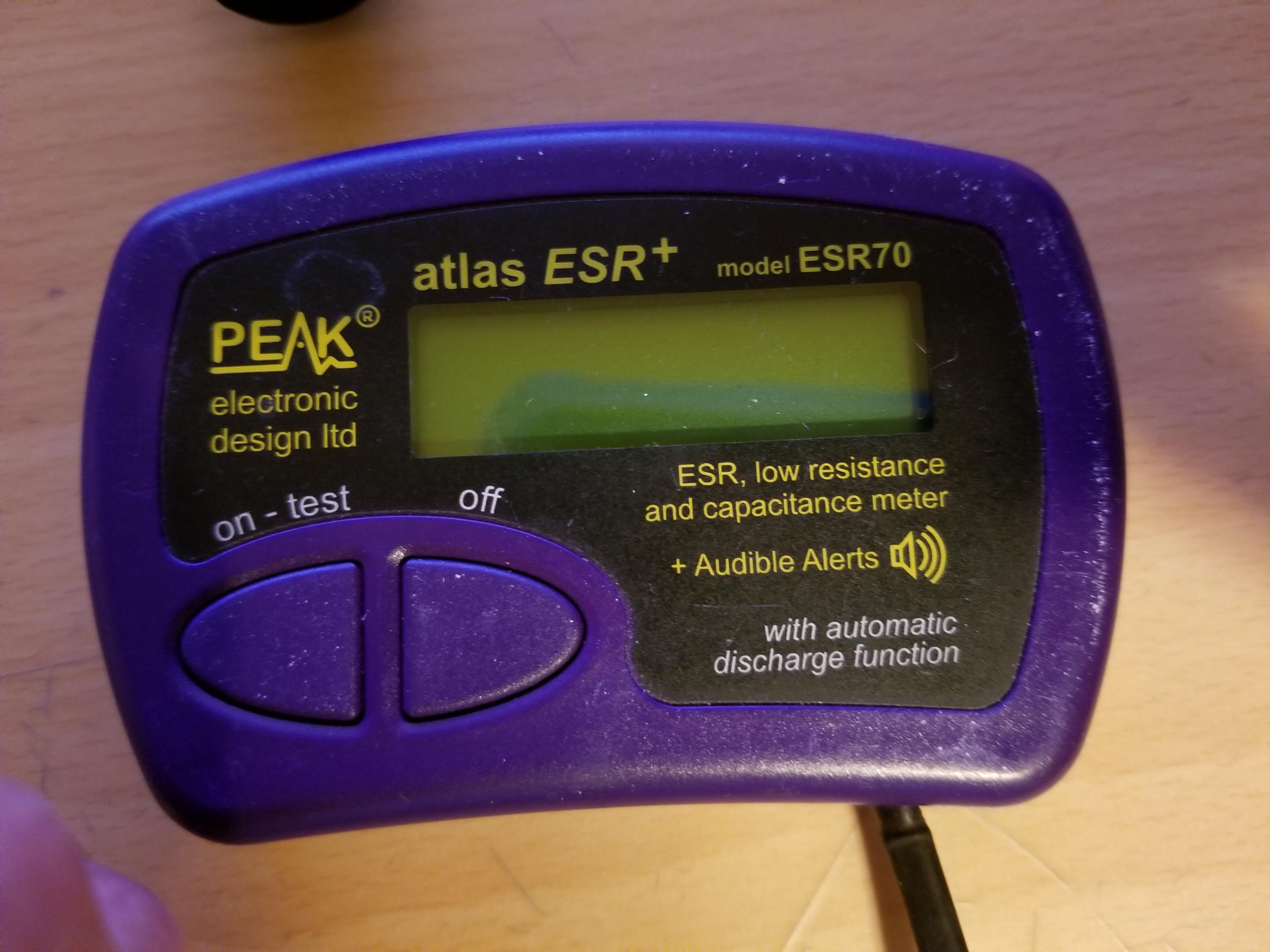

                              I have a cap ESR meter I haven't used it in years I'll try to find it..
                                I guess give it a try. I could'nt find any information on the error board al001, I suspect it just means there is a problem, in this case low/no Vs
                                Did you ever check RS807, Its a white ceramic resistor near fs803 fuse
                                  Ya I don't have the 12V battery this thing requires anyway and it's low... I mean it is a capacitance meter as well but I haven't used it much.
                                  What kind of tool would I use otherwise?
                                    Like I said you could swap the one from the va circuit with one of the ones in the Vs circuit just to see if it makes a difference. What kind of tool? a working capacitance meter, a scope, another 47n/1250 cap...
