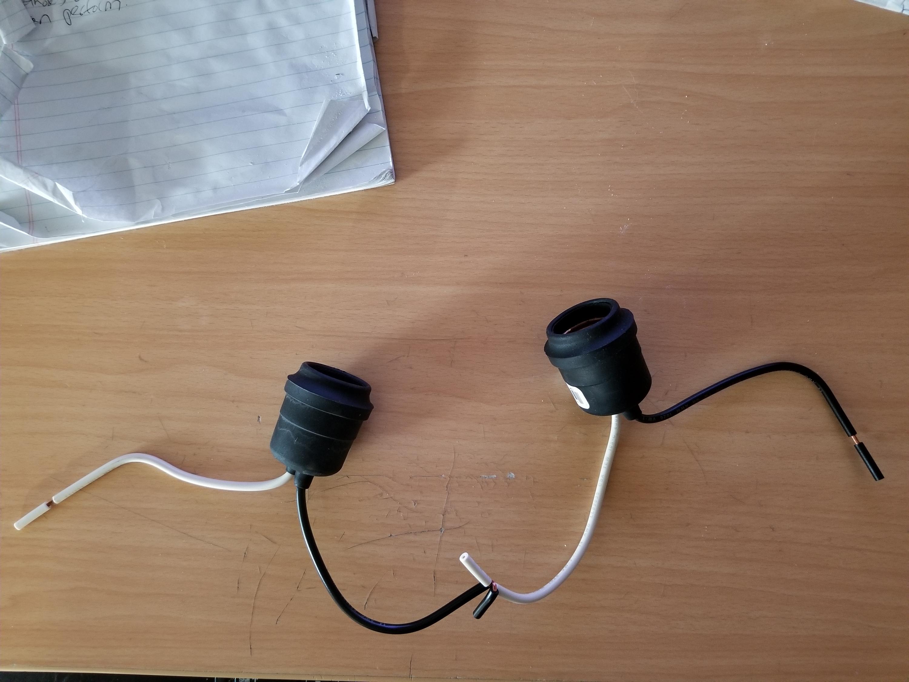

                          • kevinm34232
                            • May 2012
                            • 1884
                            #53
                            Re: Samsung PN50A510P3FXZA Plasma No Picture
                            This may be a stupid question but I remember last time I looked for a 100W incandescent light bulb I had a hard time finding one. Does it matter if it's a fluorescent or LED?

                              It can be 2 60 watt incandesent lamps in series, It is just used to put enough load to have the circuit operate and confirm the voltage comes up. thats it. and no led's ccfls etc will not work. go steal them from the bathroom

                                  #56
                                  I picked up the supplies I will do this test shortly, thanks. (60W bulbs only available)
                                  I got these 2 bulb sockets, this is how I'd wire it correct?

                                    #57
                                    Yes

                                          #60
                                          Welp did the test and I feel bad I didn't do this earlier, but it worked lamps light up and VS comes up to about 205-210V.
                                          I've never had a model where the load was necessary so sorry about this, and I didn't have the materials to do the test until today..
                                          I did try to leave the harness connected to either X or Y main individually, but it didn't work that way either..
                                          (Both PS's are working..)
