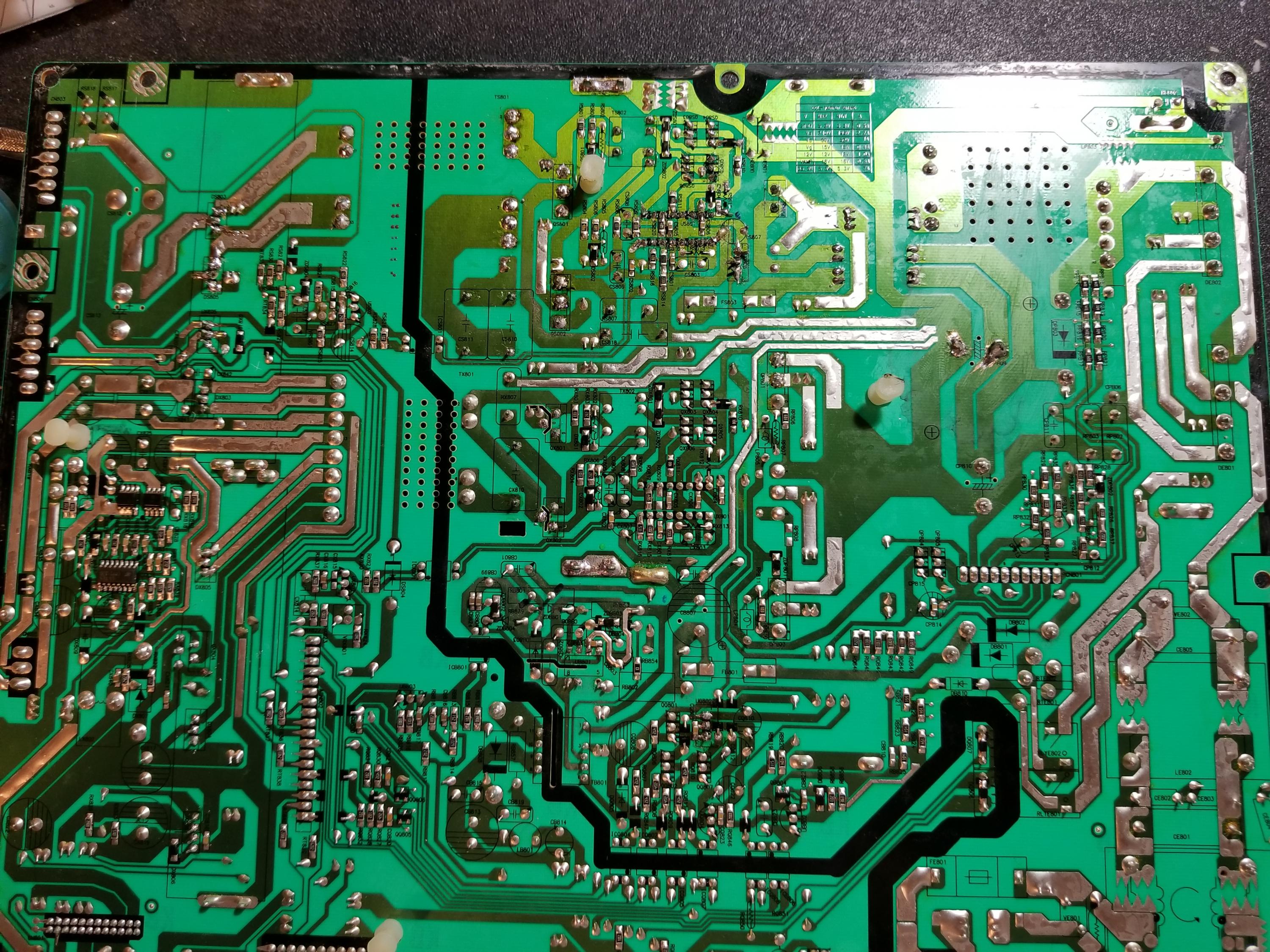

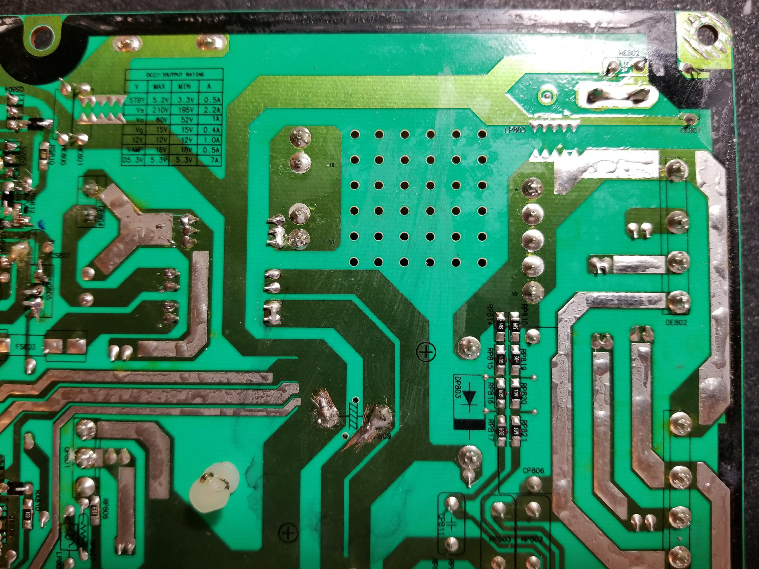

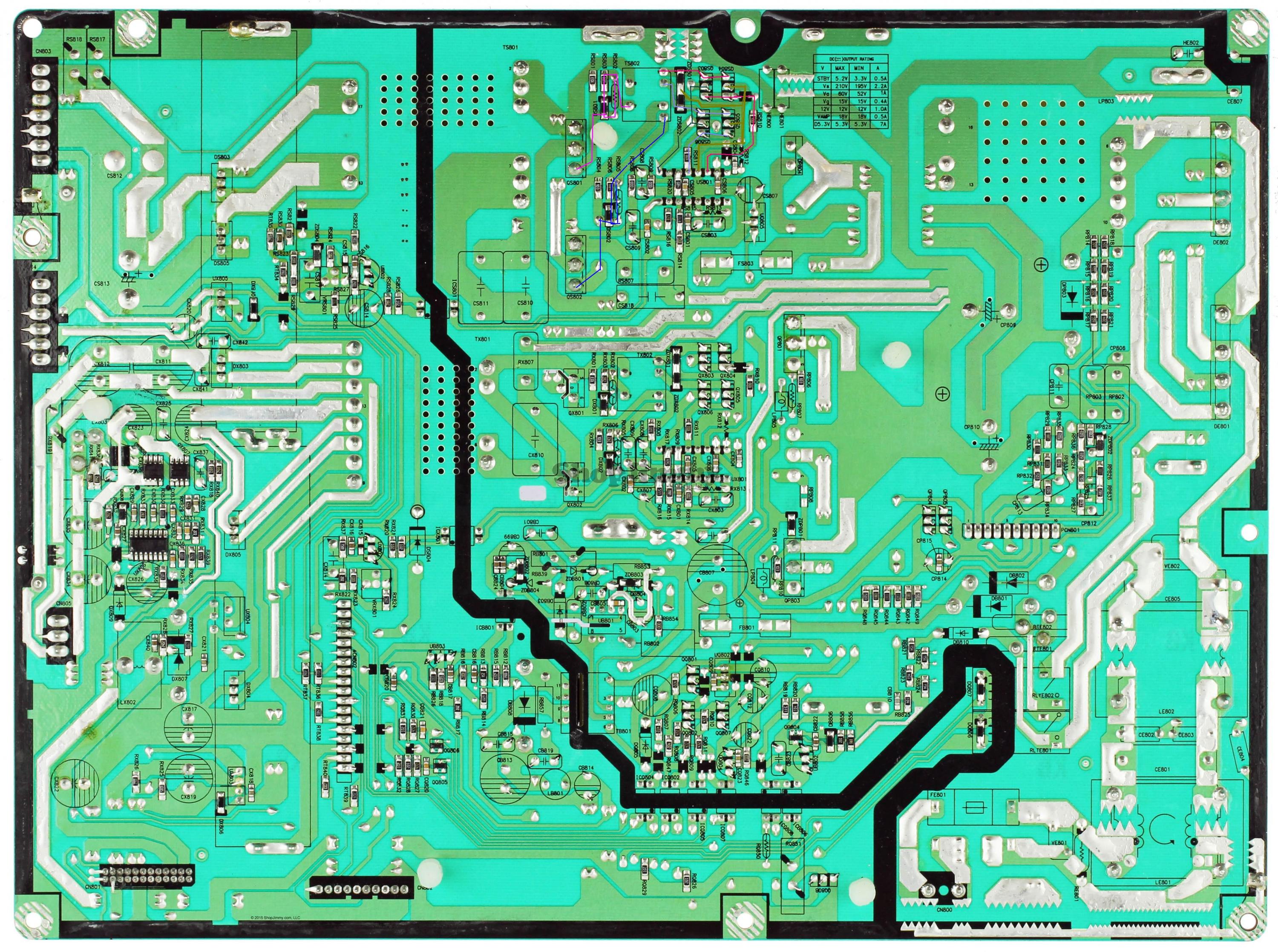

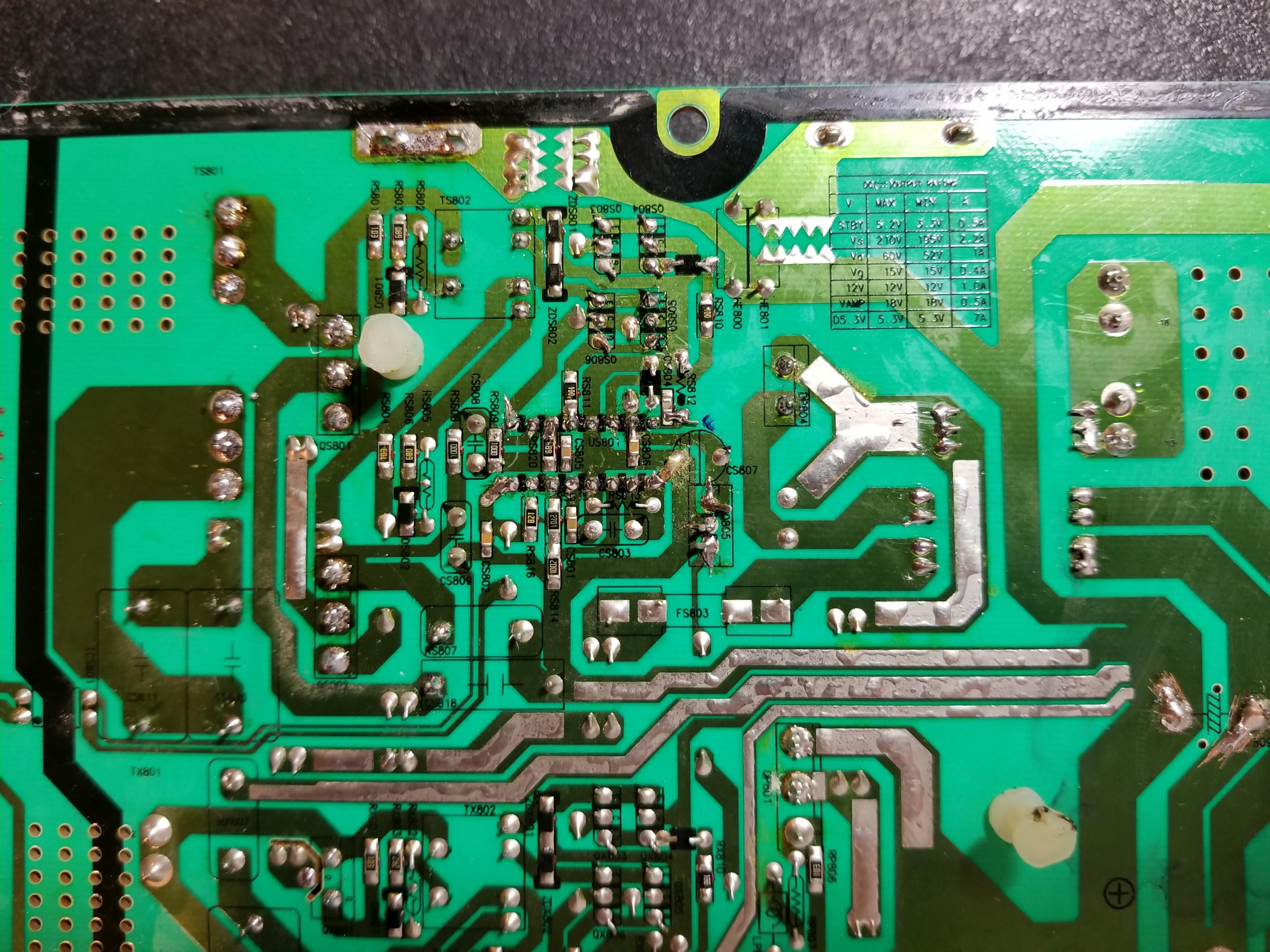

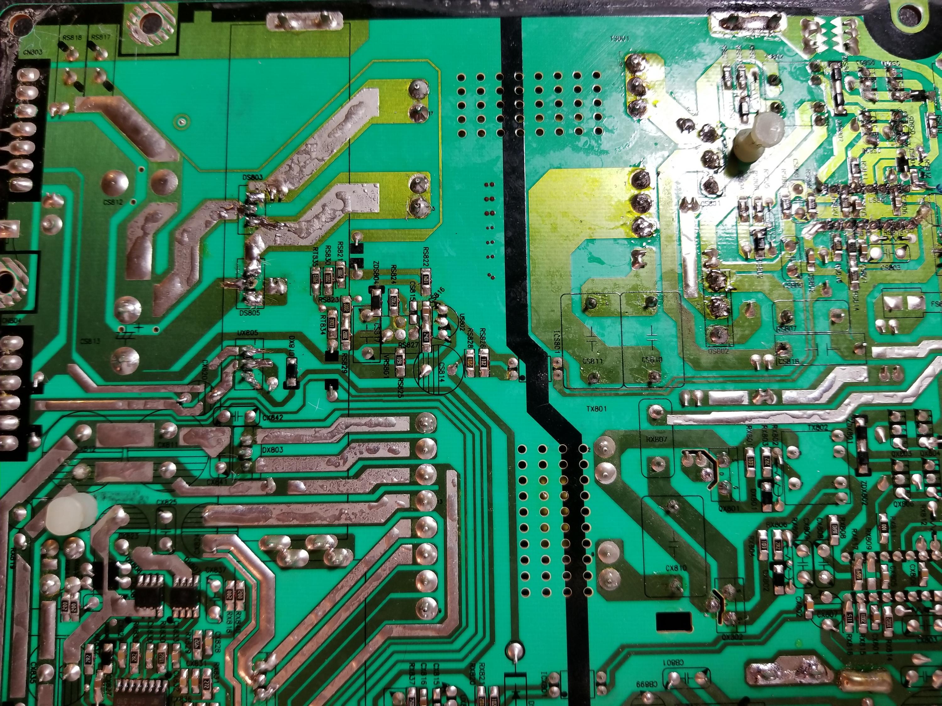

                        Re: Samsung PN50A510P3FXZA Plasma No Picture
                        Nothing changed that I know, I don't know exactly what VS was before I just knew it didn't come up.
                        Here some pics, let me know if you need closeups in any area. You see some solder work on a lot of areas where I reflowed potential problem areas and pads that came up off the board.
                        Also you will notice CP809, one of the big primary caps, was circled and unsoldered when I opened up the TV. The pads get damaged easy on this board and I had scrape away some of the board to get to the traces in some areas to fix..
                        I don't know why, and I'm pretty sure I checked early on and have 395V there..
                          Are you sure the center pin of DS805 is connected to the CS813, it does'nt look like it is in the picture
                            Yes it's got a good connection that's just the lighting..
                              Above US801 in the 2nd pic there are 4 transistors (?) (QS803>806), I can't be sure but it looked like maybe the solder had been changed on those.. Nothing is shorted I just know what someone did before..
                              I hope to be able to use the new board to figure out what's wrong on this one.
                              Where is the first point I should have the +-200V for VS? Anything I can check on the primary side of that circuit?
                                The secondary could not be simpler. What you could check is the voltage across the optocoupler, pins 1 & 2 (they are on the secondary) then check the voltage across pins 3&4.
                                If you want you should be able to compare the voltages on UX801 and US801, see if there is a pin that is different, remember this is using hot ground
                                The transistors are part of the drive circuit for the fets, the drive output A & B come from the ic, go through the 2 transistors and drive the gate drive transformer.
                                Usually if there is a problem with the drive circuit it blows the fets.
