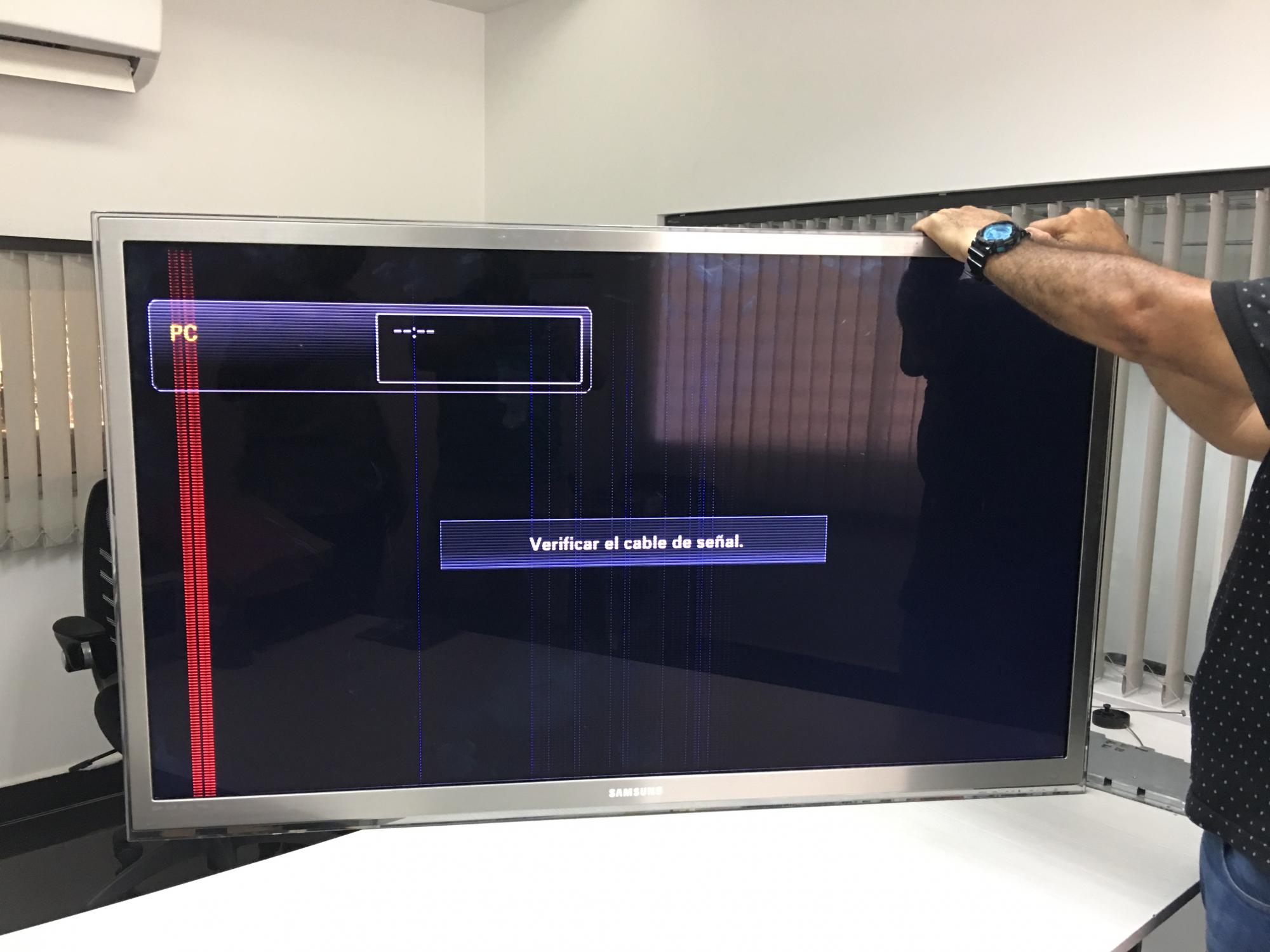

    UN55C8000 lines
    Hi.
    Tried troubleshooting this TV, however after changing the Tcon, still the same.
    Any ideas of what should I look at?

    Re: UN55C8000 lines
    Tab bonds

      Re: UN55C8000 lines
      Looks like it, give the bezel NOT the screen a squeeze or a light tap there where the lines end see if they change any.
