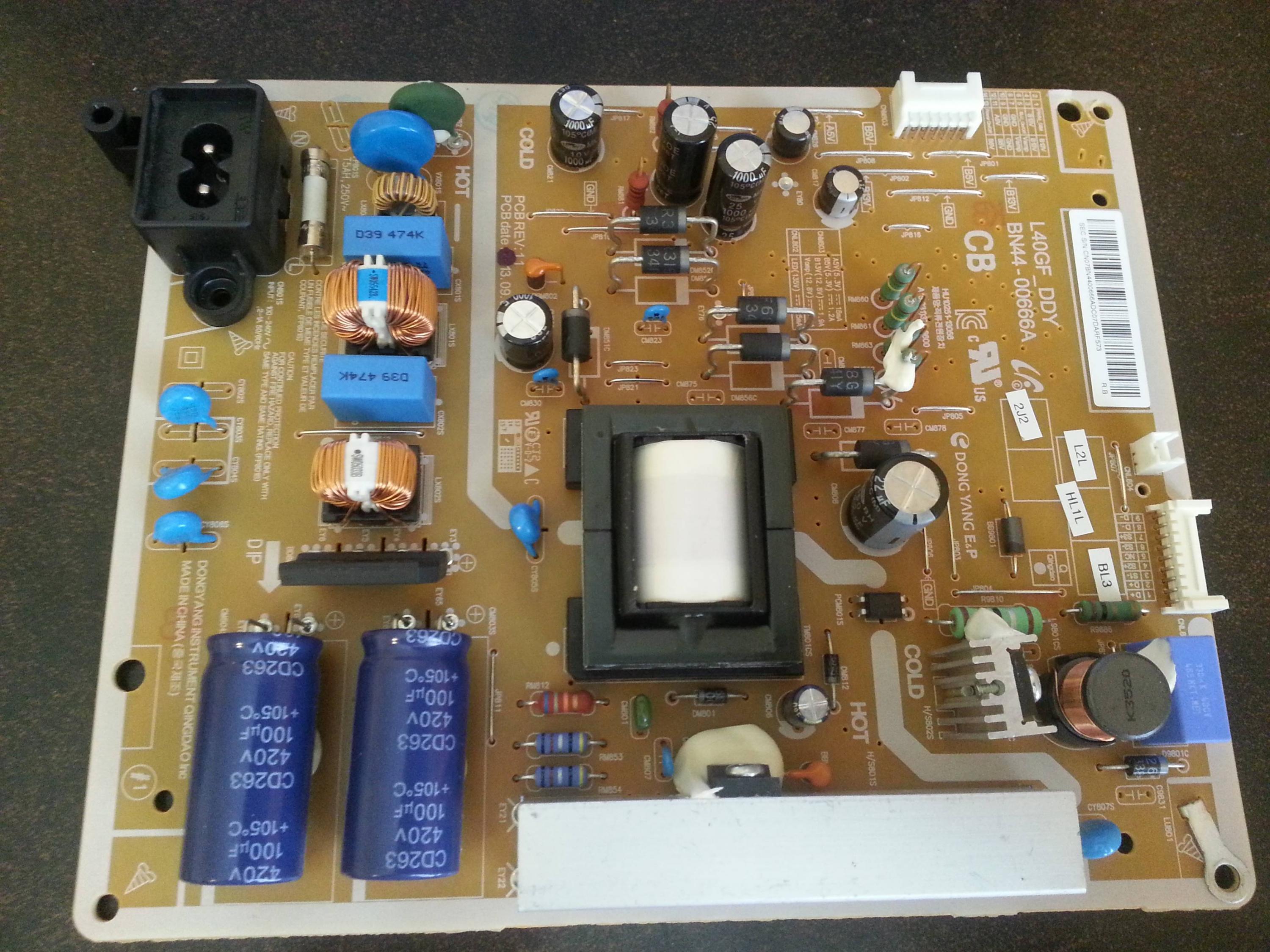

    Samsung UN40EH5300F No Power
    it's the power board, i know that, but i'd rather not replace it. no backlight, no standby. none of the capacitors look bulgy, fuse is good i think. can yall help me figure out what's wrong? i barely know how to use a multimeter or how to troubleshoot a circuit board but i measured ac voltage and it's like 120-140 volts up until the bridge rectifier and it turns to about 340. voltage remains that up until the legs of the transformer that meets the hot and cold side where it goes to 0 on the output of the transformer. is that normal? sometimes if i plug it in with just CNL802 (backlight) and not CNM803 (main board) the backlight flickers on but then goes off and stays off and won't do it again. it was making a baby lightning bolt when i measured DC voltage on some of the components by CNL802 but now it doesn't do it anymore. pictures are from shopjimmy, board is BN44-00666A

    Re: Samsung UN40EH5300F No Power
    check the connector that goes to the PSU for burnt contacts.
    With the PSU turned off, there should be 170V DC on the main filter cap. You can unplug the main board from the PSU, plug the back lights in, then plug the PSU into mains circuit. The PSU should come on and the back lights should be on and stay on. The flickering could have been an back light led going bad. Pin 12 is A5V, so this pin should have 5V STBY all the time.

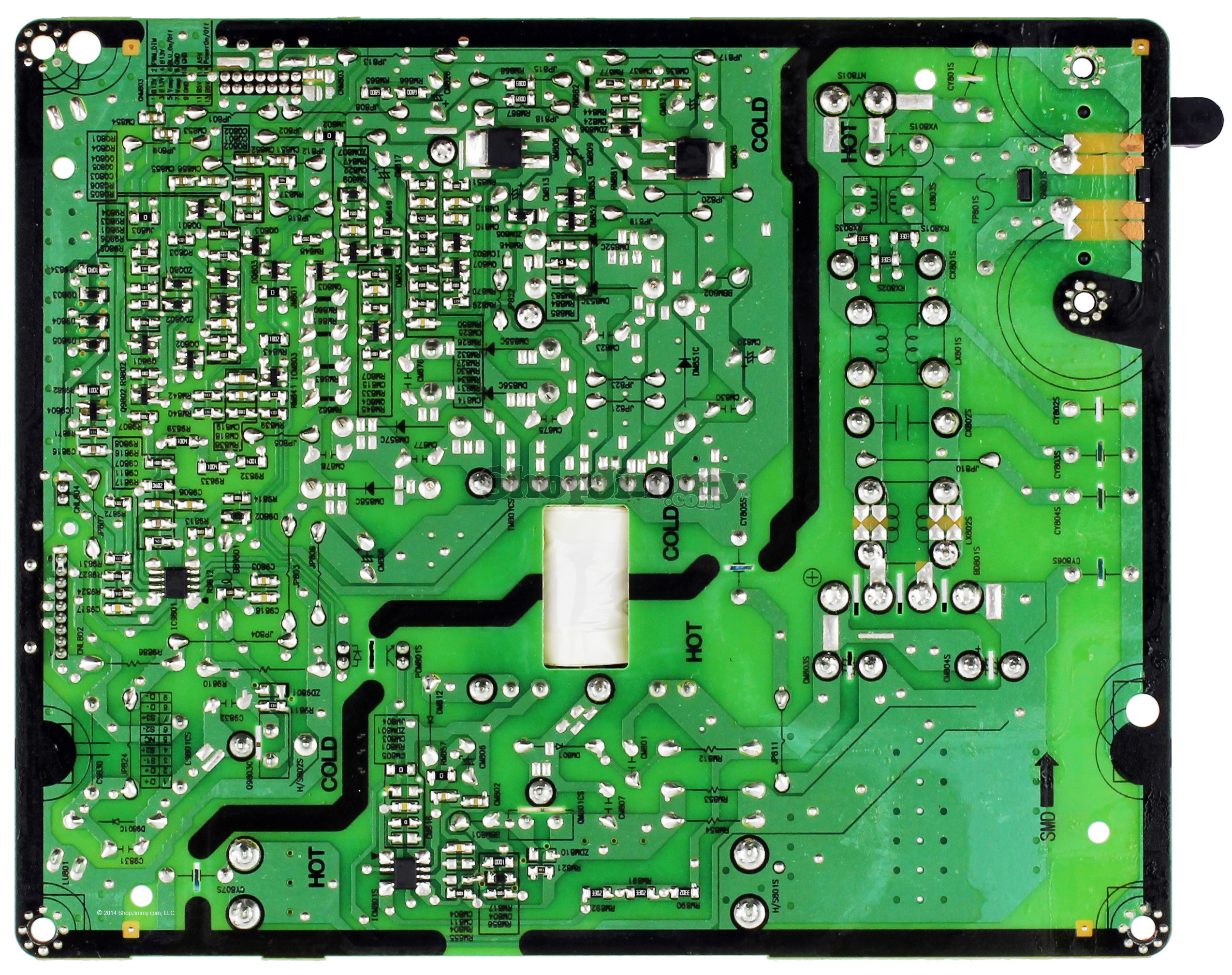

              There is NO PFC Voltage booster so the Voltage on the cap will remain around 160V or so, the power supply is an always on power supply since it is the only power supply on that board, some of the outputs are switched (the one with 'B' marking).
              I would like to see the pictures of YOUR board since there may be something that you did not see on your board.
              DM851C is the rectifier diode for the A5V.
              I would check all 7 diodes on the cold side.

                I would start investigating why A5V isn't there. On the back side the A5V goes through 2 jumpers and goes to a surface mount diode. check it out.

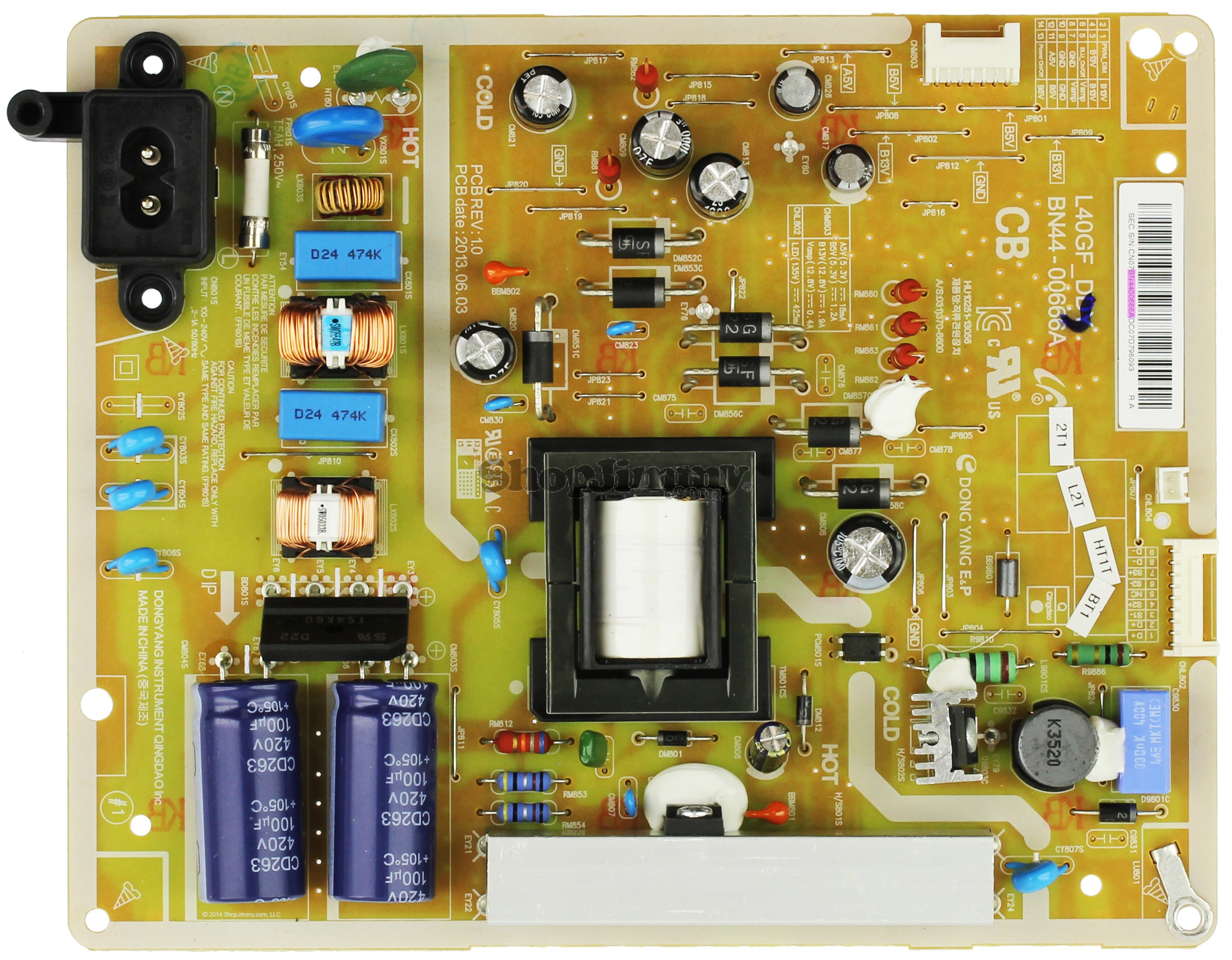

                  Can you provide the number on the ic on the HOT side (ic???1S) Is it a (SSC2S110) by chance? I suspect it should be operating in standby mode, which would produce the needed 5 volt standby, when the power on signal comes, opto (pc???1s) puts the ic into full on operation. and you should get the other voltages
                    The two SMD MOSFETs on the bottom side of the board; One is for B5V and another one is for B13V; they are turned on when PS-ON is present.

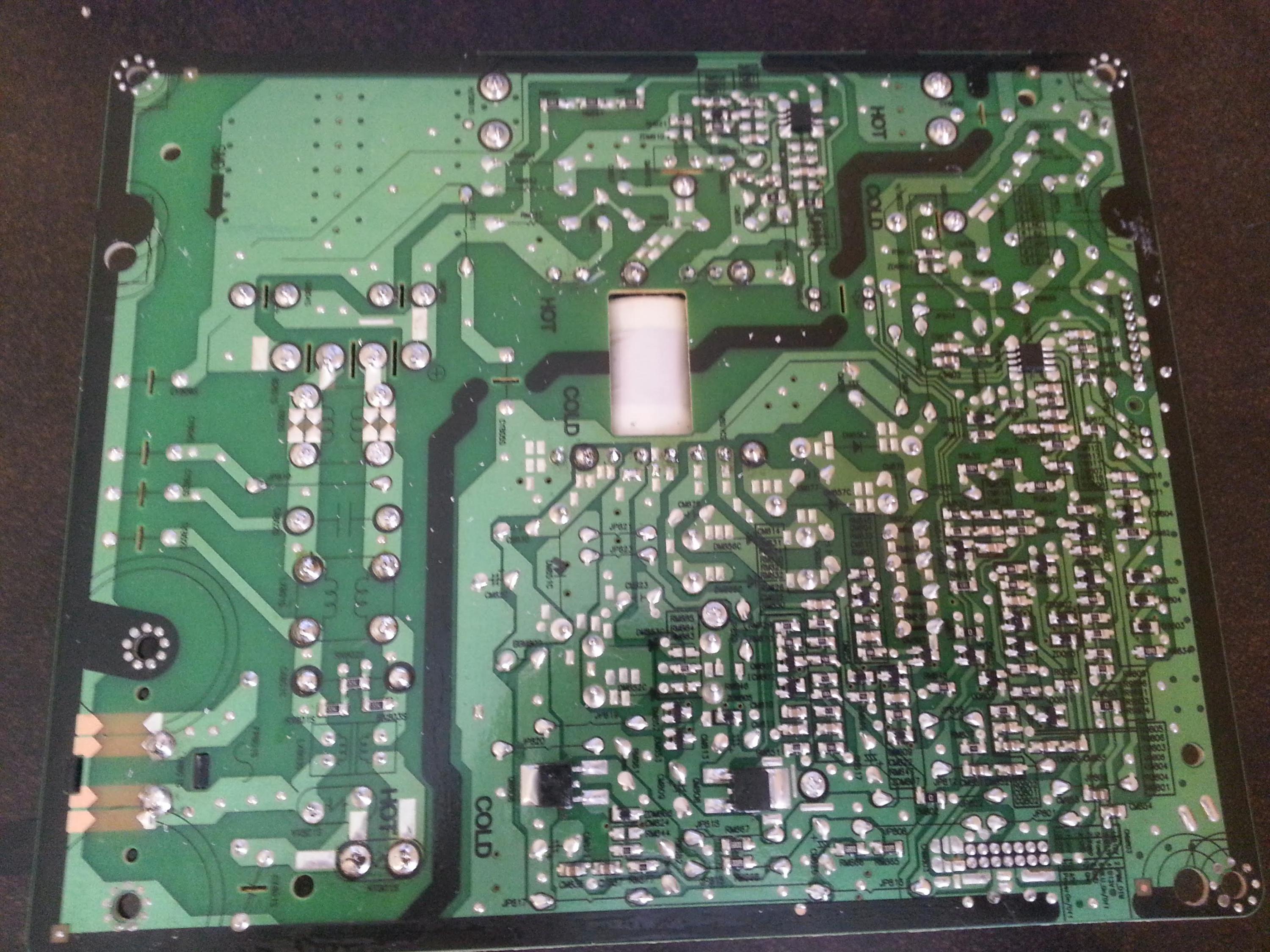

                      DM851C has no resistance in either direction, DM852C and DM853C have something wonky where they slowly increase slower and slower in the correct orientation to like 8k ohms (is that right? the dial is on 20k and it's showing ~8.00) and then slowly decrease with the opposite direction. DM855C-DM858C have ~16k ohms and then ~100k the opposite way.
                        OK the Diodes are not shorted.
                        Check DM851C in diode mode to see what you get.
                        The SMPS IC in question is ICM801S, it is the SMD 7-PIN IC.
                        BTW, when you tested the DC V on the cold side connector, is the board connected to the main board? If it is then try running the power supply board by itself to see what dc V you will get on the cold side connector.
                                The ic is similar to this SSC1S311, pin 1 is controlled by the opto to switch the ic out of standby condition. Check the voltage on pin 4 using the main cap's negative for meter ground
                                Sometimes one of those series resistors coming from the main cap's (+) goes open.
