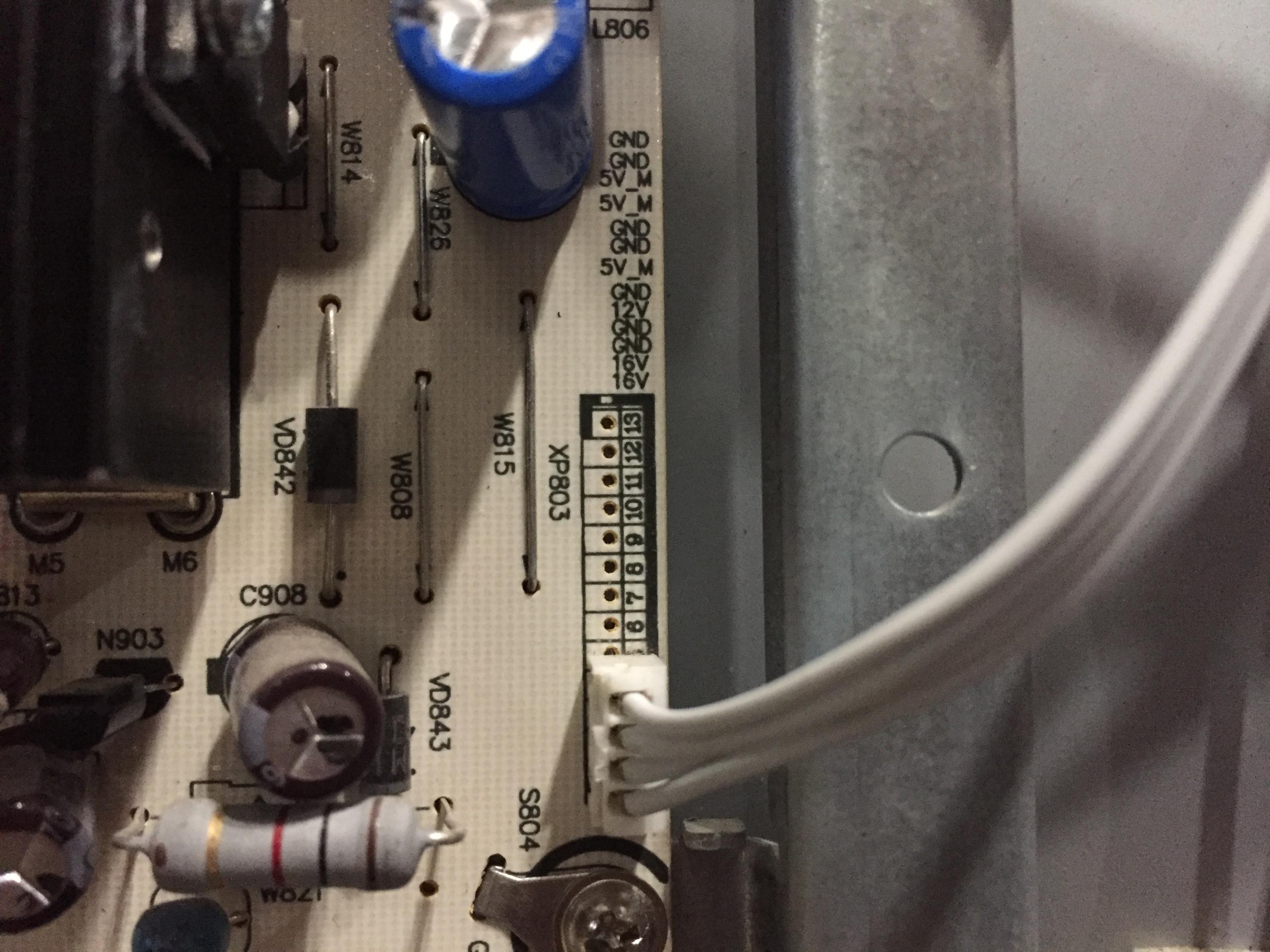

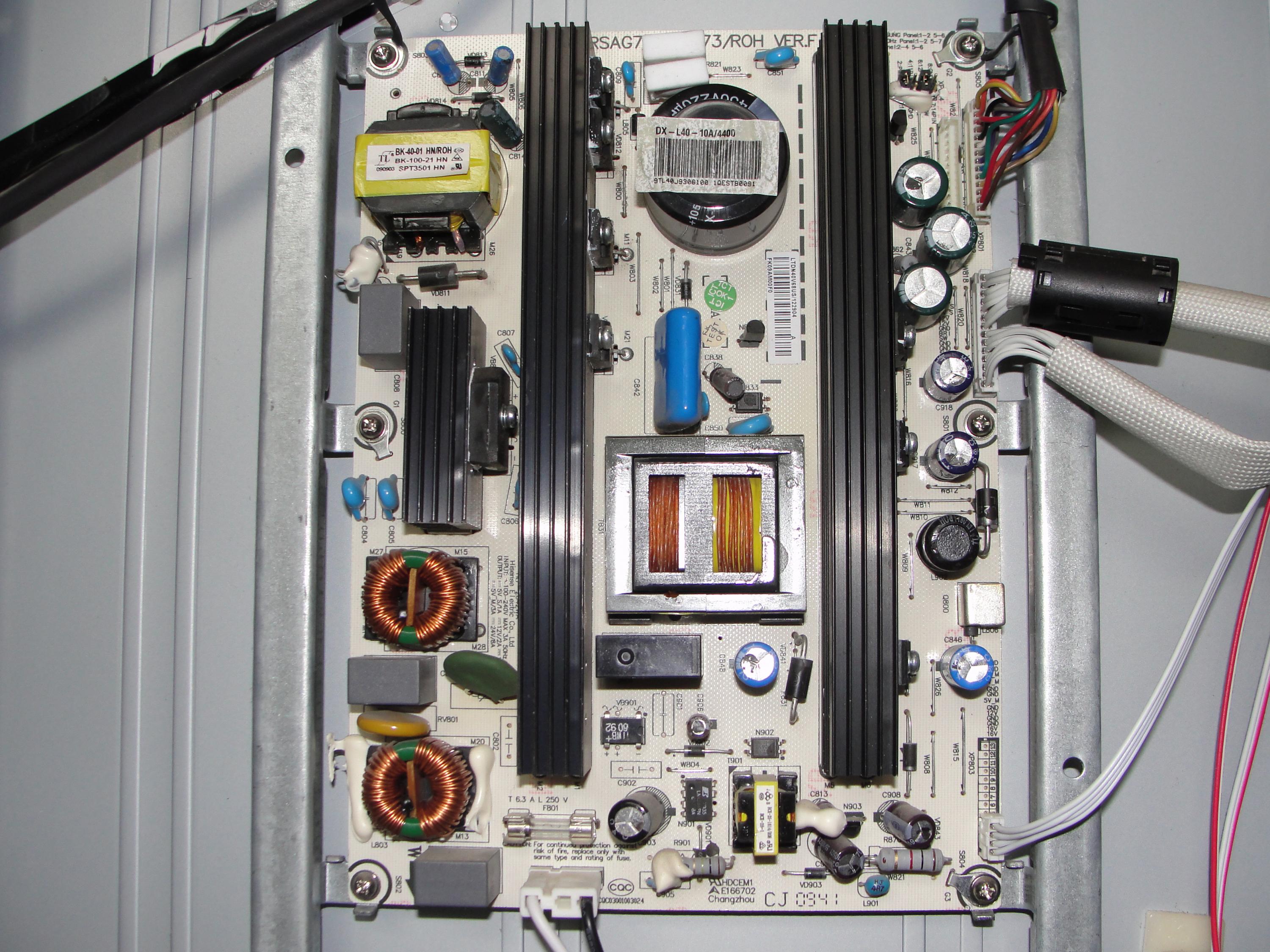

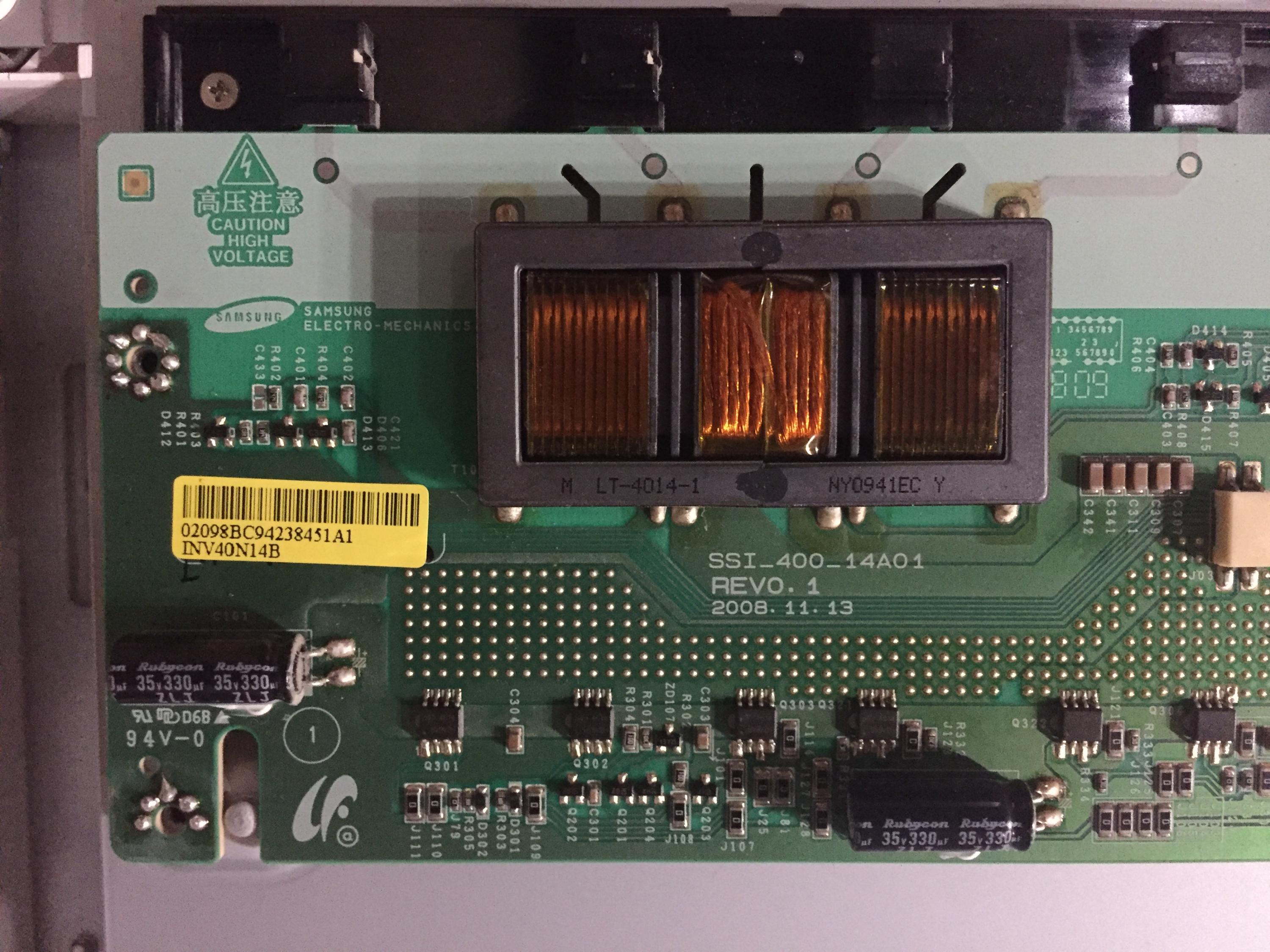

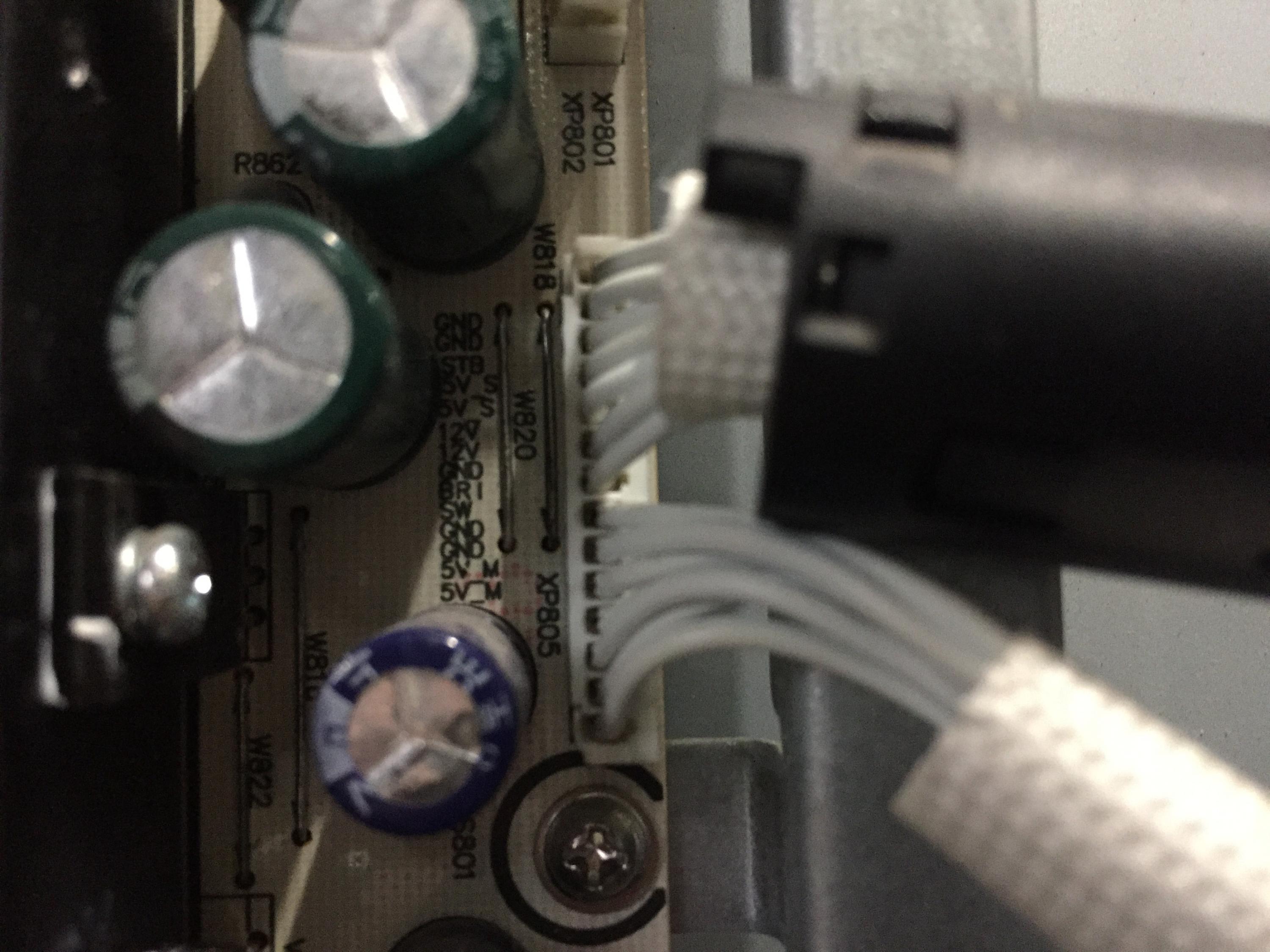

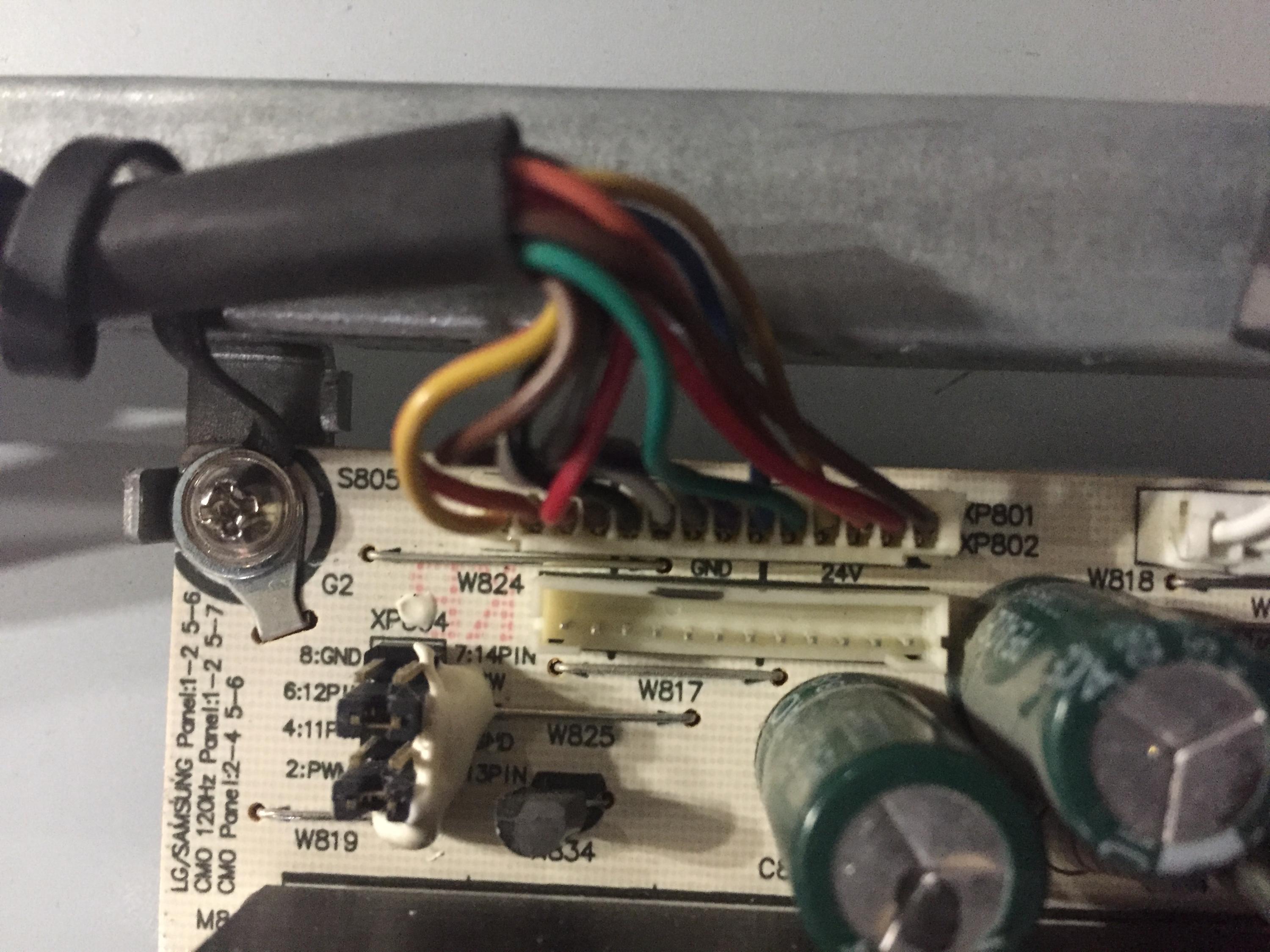

    O.k. it sounds like you have an inverter problem. On the PSU top right there are 2 connectors. Turn the TV on and measure the DC voltage on each pin. Post the pin out names with the DC voltages measured. A Brown, yellow or blue wire doesn't tell us much, we really need the pin out names.
    If the BLon and Dim pin is good, I'd be checking the capacitors and compare the output winding each of the transformers on the inverter board.
    Please post a picture of your inverter board, and another one of the top right corner of the PSU, so we have the pin out names.

      Here are the pin outs. The yellow, orange, red, and brown wires do not have any names or values on the board that I can see. They are the first four colored wires at the top of the connector to the inverter.
      From top to bottom along the right side of the board are three connectors.
      The multicolored connector going off to inverter board. (Top to bottom)
      Unlabeled - Yw - 2.917v
      Unlabeled - Or - 2.903v
      Unlabeled - Red -4.10v
      Unlabeled - Br - 2.593 to 259.3 up to 3.260 and 326.0 The decimal point constantly jumps back and forth
      from after the first number to before the last number. Reading just now was 326.31v
      Gnd - Bk - 0V
      Gnd - Wh - 0V
      Gnd - Gy - 0V
      Gnd - Pu - 0V
      Gnd - Bu - 0V
      24V - Gr - 25.11v
      24V - Yw - 25.11v
      24V - Or - 25.11v
      24V - Red - 25.11v
      24V - Br - 25.11v
      Below that is a 14pin connector going to main board:
      GND - 0V
      GND - 0V
      STB - 2.833V
      5V_S - 5.00V
      5V_S - 5.00V
      12V - 12.34V
      12V - 12.34V
      GND - 0V
      BR1 - 2.903V
      SW - 4.10V
      GND -0V
      GND -0V
      5V_M - 5.25V
      5V_M - 5.25V
      At the very bottom right is a 4pin connector going to main board:
      4 - GND - 0v
      3 - GND - 0V
      2 - 16V - 16.52V
      1 - 16V - 16.52V

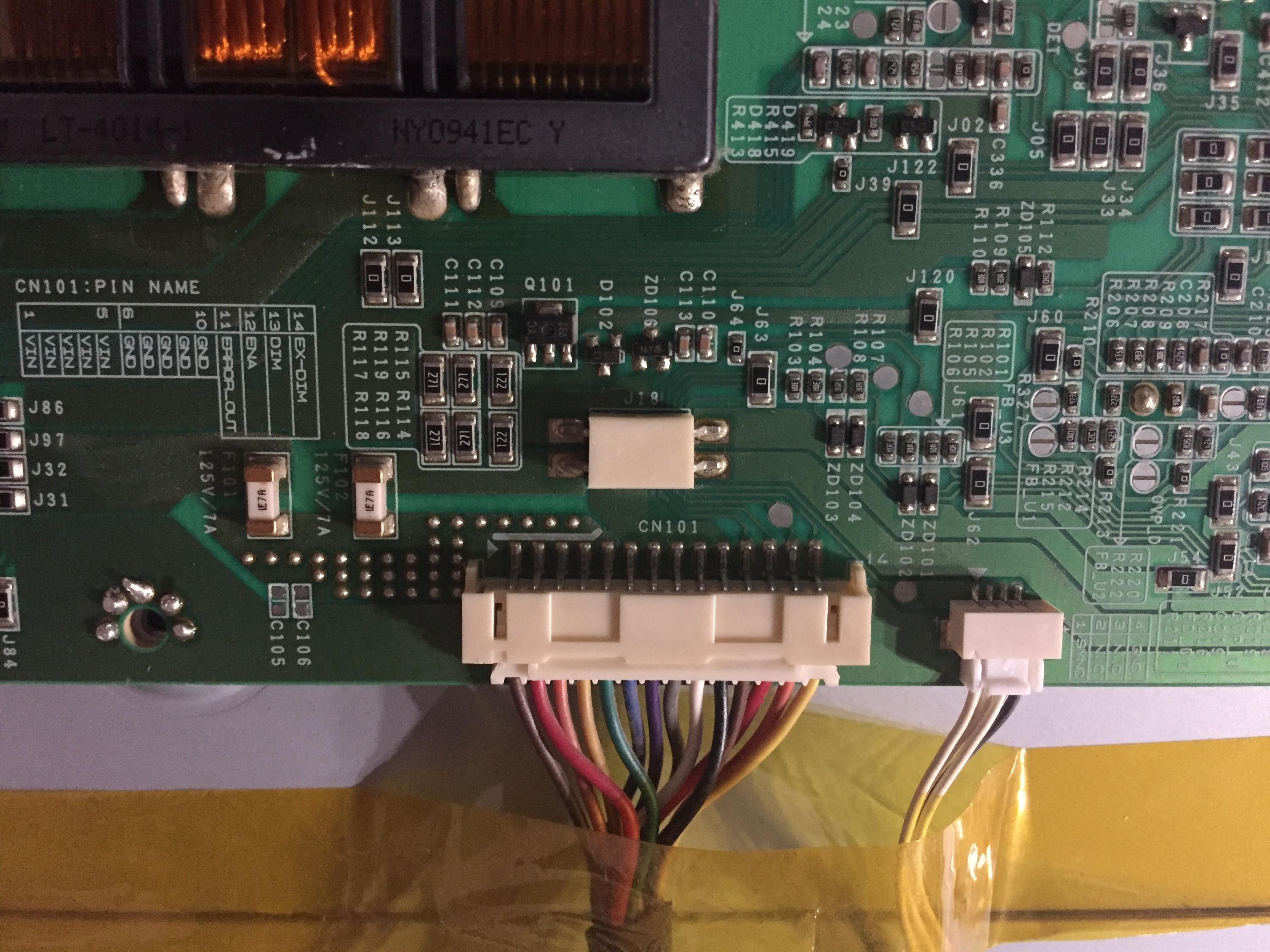

      Haven't checked any inverter transformer outputs yet but I did post a pic of the inverter board in the first post but it doesn't have the cover removed.

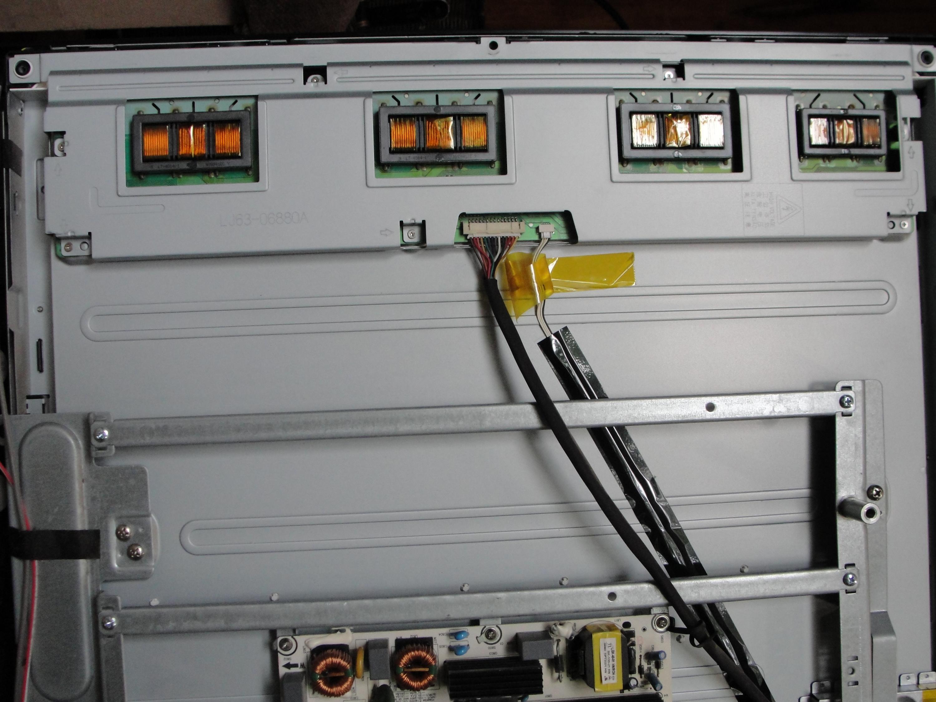

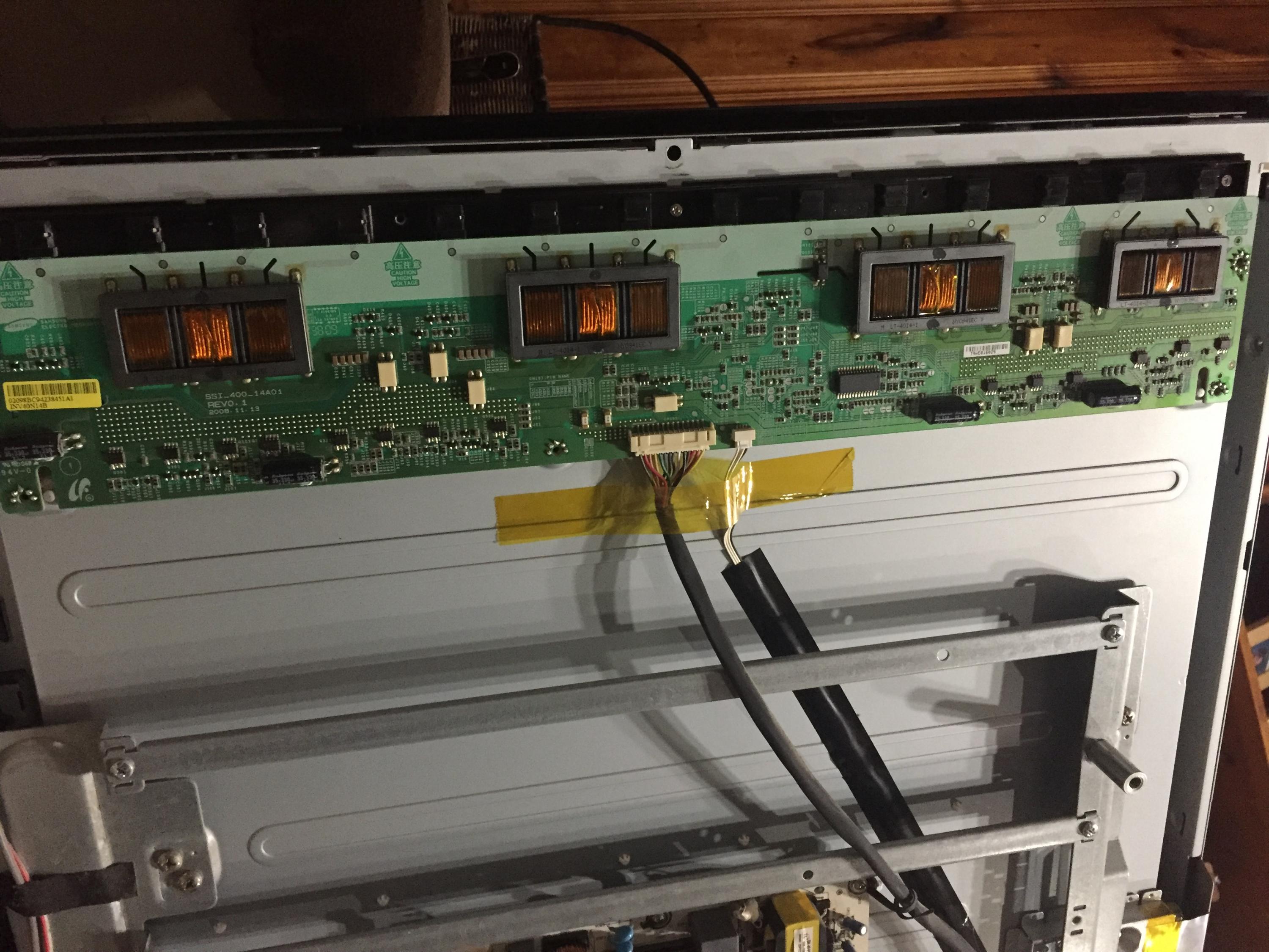

            Are there any brown scorch marks on the back of the inverter board.
            Watch the following video and test the mosfets as shown, Power to the set OFF.
            https://www.youtube.com/watch?v=2QTfOy4BUpU&t=651s

              I did see that video and tested the board accordingly but everything seemed normal even though the back of the board is scorched exactly like his video. The ground points were also blackened like the video and I re-soldered them. After watching that video I thought for sure I had found the problem and was a little disappointed the components tested ok, ha.

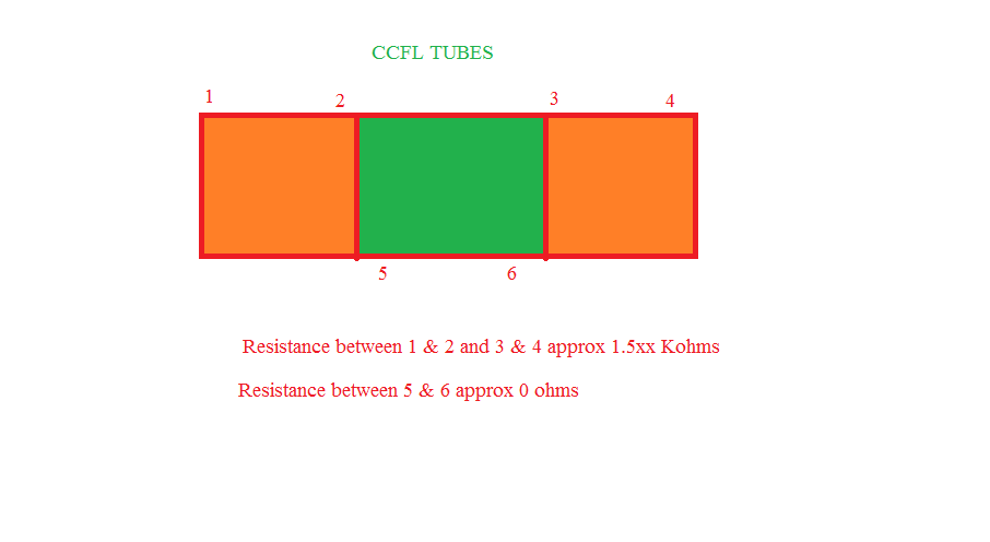

                Have you checked that the resistance of each of the transformers windings match each other?

                  Have you checked both the white ceramic fuses on the inverter board are OK
                  Inverter transformers

                    Yes, the fuses checked out ok. Thanks for the little graphic, that was perfect. Here are the readings from top to bottom of the board:
                    1.04 k ohms
                    1.05 k ohms
                    0 ohms
                    1.47 k ohms
                    1.48 k ohms
                    0 ohms
                    1.51 k ohms
                    1.51 k ohms
                    0 ohms
                    1.52 k ohms
                    1.52 k ohms
                    0 ohms

                      Remove that 1.04K and look at the bottom side of the transformer.
                      • fatcat
                        • Nov 2014
                        • 45
                        Re: TV sound no video DX L40 10A
                        Well, I would like to remove it but I am having a hard time to do so. My iron is not very good and my solder sucker isn't the best either. I don't have any braided wire but I could try with a regular copper power wire. I don't have a hot air pen either but I have used a heat gun to do a re-flow before. That might be a bit much in this situation. How would you remove it?
                        The transformer in question is smaller than the other three and is under less load, so would the values change or should they still be similar to the other transformers?
                        Do you feel confident that the inverter board is where the problem is? Replacements from China seem to be reasonably priced.

                          The reading appear to be in line with one I have in front of me. Same model inverter board.
                          The last transformer (T104) measures 1.07K on the two windings. It's wire up slightly differently to the others and only drives two tubes while the others each drive 4 tubes. Had't noticed it until I saw your readings and then double checked.

                                  Ok, couple of things. First, I re-soldered the top two transformers and the values changed a bit. The small top one now shows 1.07 kohms on both outputs and the next one down shows 1.49 kohms on both outputs.
                                  I put the inverter back in, booted the tv, screen flashed and back lights shut down. I re-tested the questionable brown wire on the psu output to inverter. In auto mode I get the readings like I first posted with the decimal jumping back and forth. I changed the mm range to mv manual and I get an out of range reading. Seems there is a problem there, but what? Could it be the psu capacitors?

                                    That is ERROR pin for that Brown wire (Inverter connector) pin 11.Put meter on higher Voltage range than 200mV, put it to 2V, if it is still OL, then put in 20V.
                                    https://www.badcaps.net/forum/attach...5&d=1527484887
                                    It can be the inverter board or the lamps.
                                        You are right, I didn't catch that. I'm not sure what it means exactly. Does that mean the inverter sends out an error? I'm having a hard time getting a proper reading on that one. Values seem to change and fluctuate. I'll keep trying.
