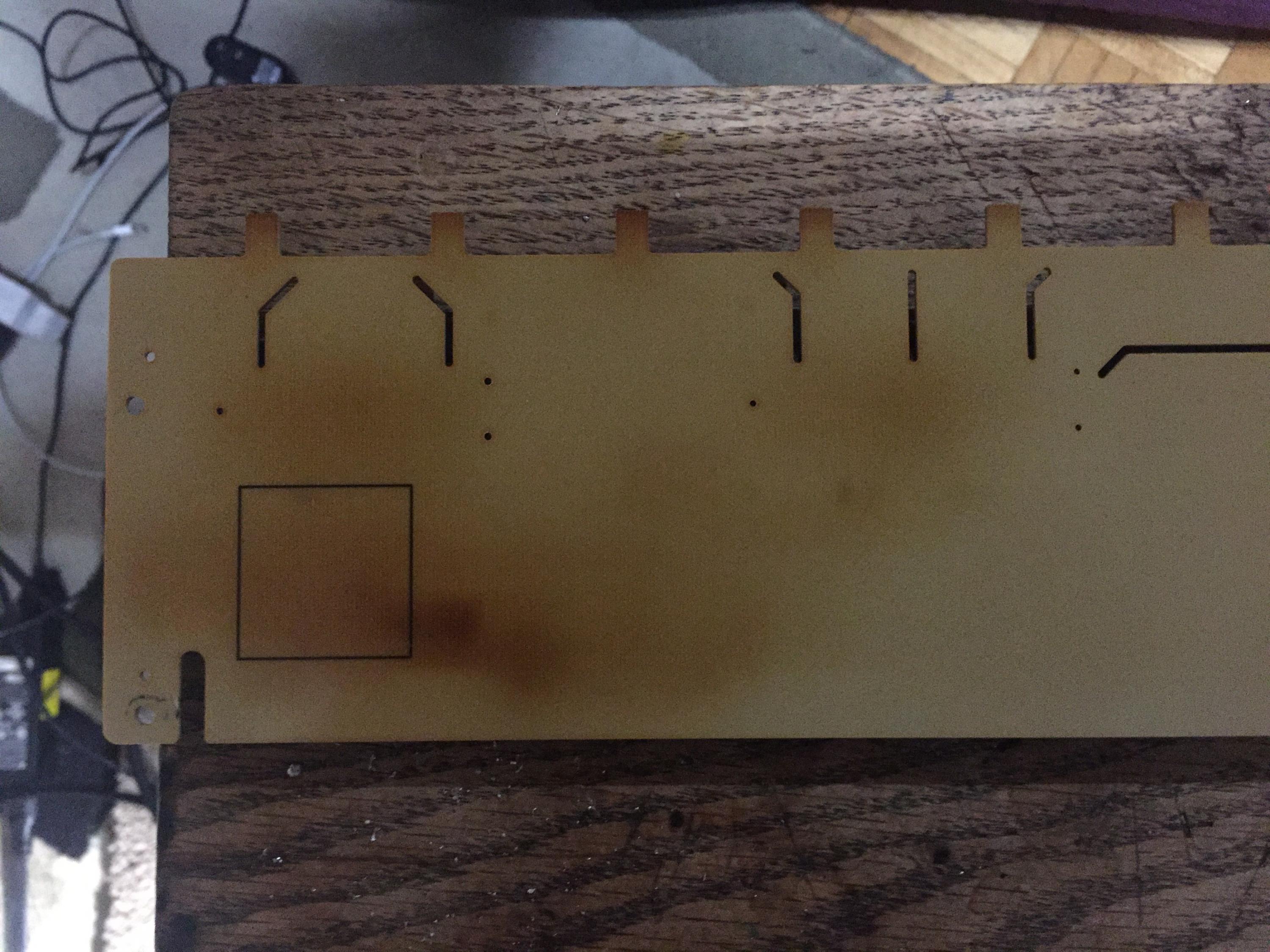

                    So I tried pin7 to ground and it didn't make any difference. If it was the tubes, it is unlikely they would all burn out at the same time so something should have lit up with this test.Thing is, the guy in the other discussion obviously had a good working inverter board so I'm thinking it has to be the board. I'm attaching a pic of the scorched back side of the inverter. The worst burn marks are under what looks like a set of 4 resistors.

                      https://www.badcaps.net/forum/attach...3&d=1527484887
                      You should check those 8-pin power MOSFET's Source and Drain pins closed by that small inverter transformer. Can you read the P/N on them?

                          It certainly looks as though the mosfets have overheated and I would be checking all the 0 ohm resistors in that area for open circuit

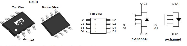

                                  #36
                                  Re: TV sound no video DX L40 10A
                                  Here's the pinout of the Mosfet

                                    What kind of readings should I be getting and should all those mosfets have approximately the same readings?
                                      #38
                                      We are looking for low resistance reading between Source and Drain pin so just report the reading for those two pins for us to look at.

                                        #39
                                        I'm not sure I'm testing right, I get a bunch of different readings and they fluctuate. I understand these are dual mosfets with 4 drains and 2 sources with 2 drains per source, so when testing do I put the red lead to drain or source?
                                          #40
                                          You test in both directions with the meter, typical failure mode for the MOSFET is shorted circuit or low Ohm resistance reading between S and D, so just report what you are getting, make sure to read the meter correctly to see if it is showing in Ohm, K Ohm, or M Ohm.
