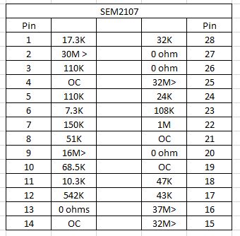

                                  I've taken some resistance readings of the SEM2107 I have on my board. Power to the set off, of course. Black meter probe to the 24V ground pin at the connector and using red meter probe to take resistance readings. Meter set to auto range. [OC = no reading (OL on meter)]
                                      Thanks for that. I'll check for these readings later on.

                                        I wondering if your SEM2107 IC is faulty but lets wait and see if there are any obvious resistance discrepancies.

                                          #60
                                          Re: TV sound no video DX L40 10A
                                          Checked with power unplugged.
                                          PIN
                                          1.-----17.20k
                                          2.-----39.49m
                                          3.-----111.8k
                                          4.-----OL
                                          5.-----110.1
                                          6.-----7.14k
                                          7.-----150.4k
                                          8.-----51.2k
                                          9.-----16.34m
                                          10.----68.7k
                                          11.----10.15k
                                          12.----538k
                                          13.----0.3 ohm
                                          14.----OL
                                          28.----19.19k
                                          27.----0.4 ohm
                                          26.----0.3 ohm
                                          25.----36.36m
                                          24.----23.84k
                                          23.----108.1k
                                          22.----0.812m
                                          21.----OL
                                          20.----0.3 ohm
                                          19.----OL
                                          18.----10.77k
                                          17.----42.7k
                                          16.----3.73m
                                          15.----31.64m
