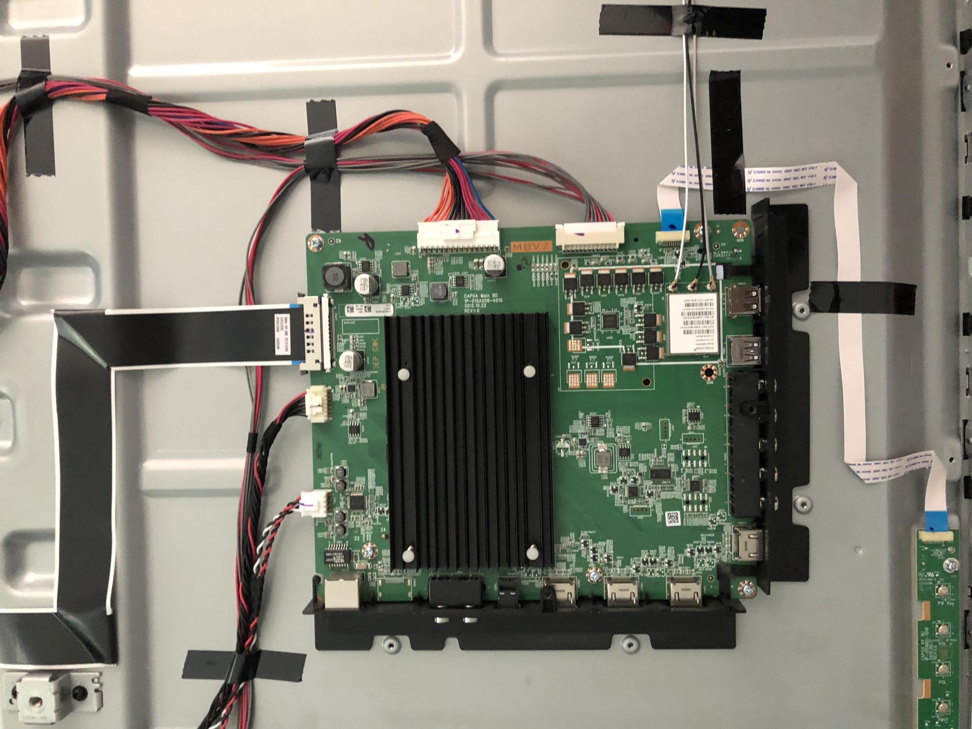

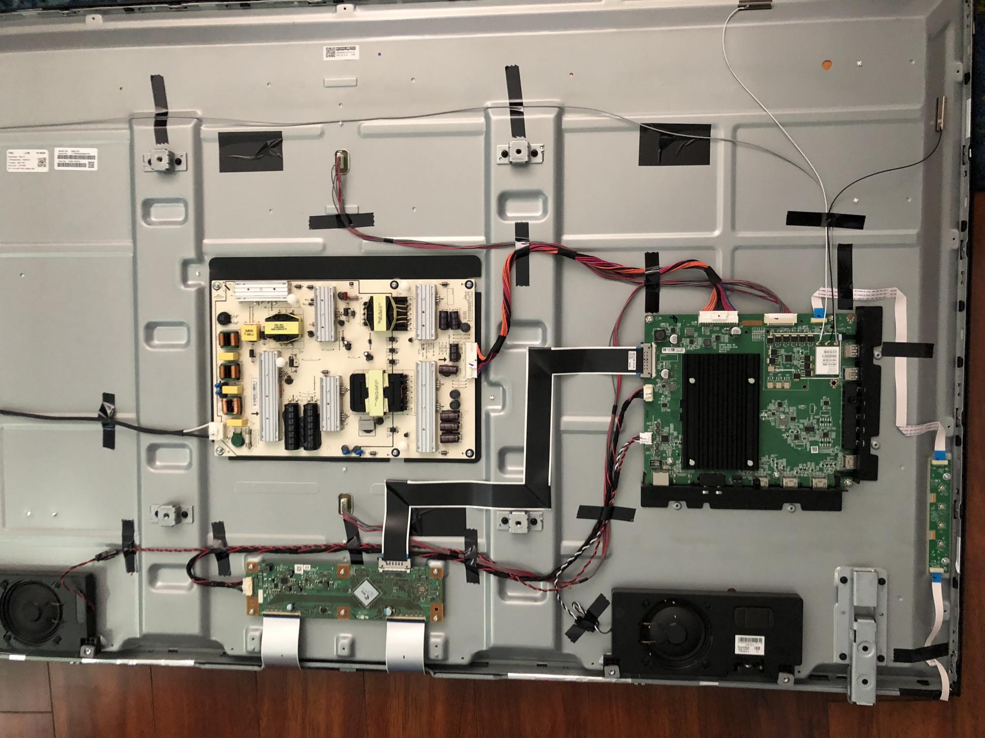

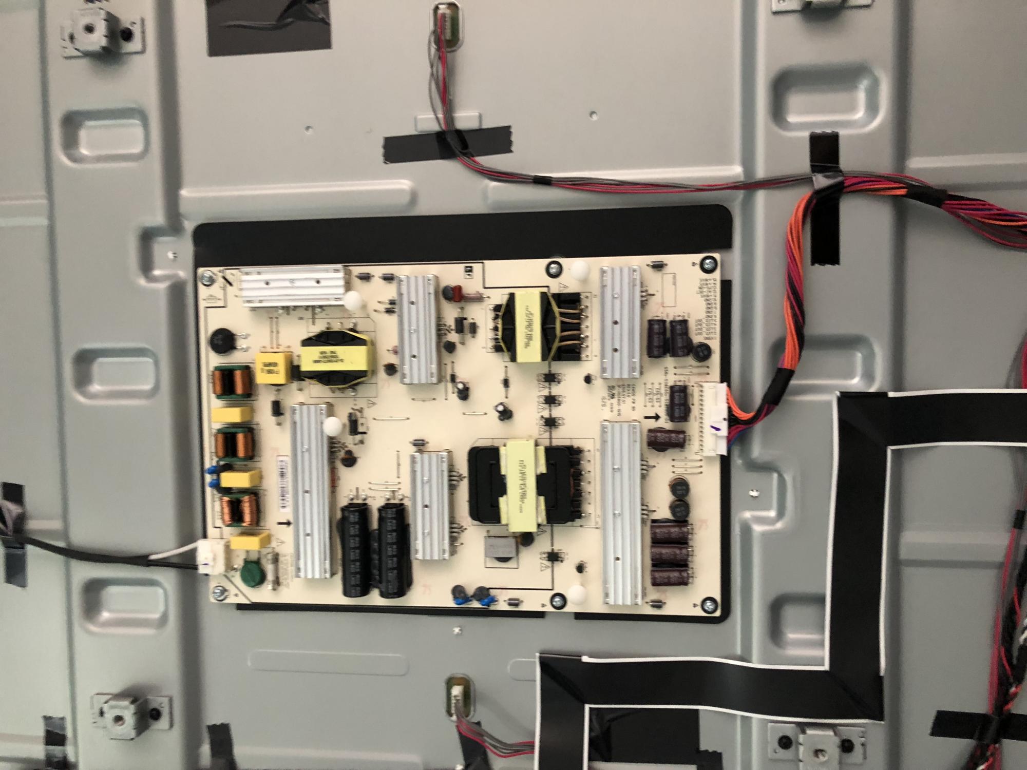

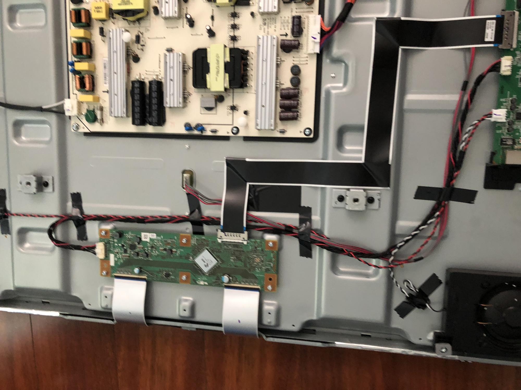

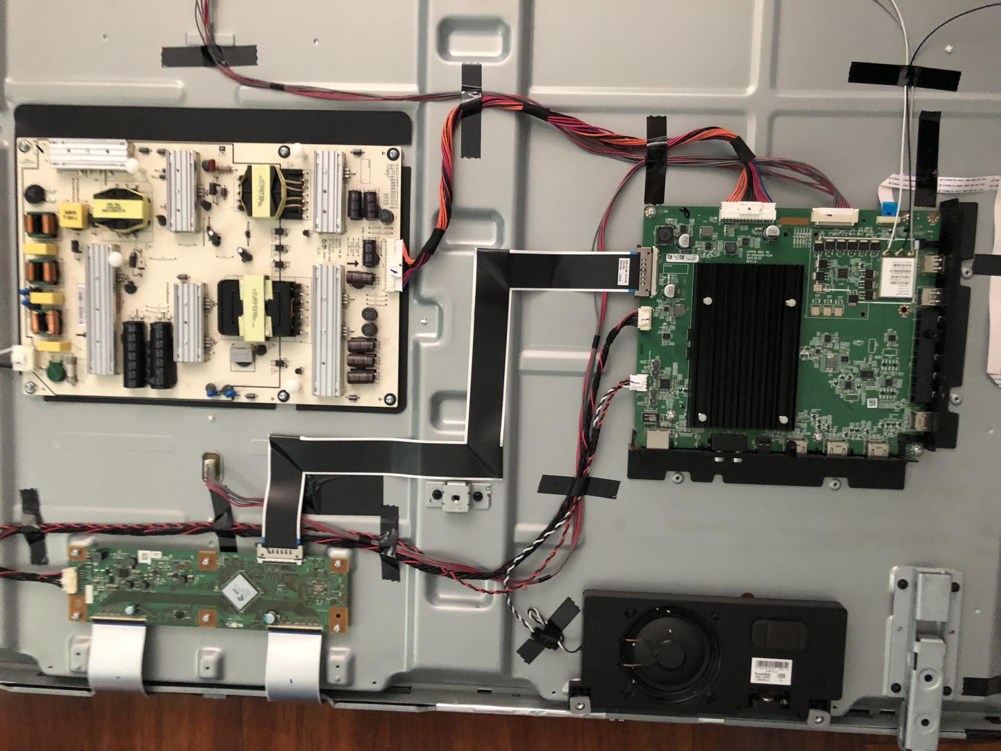

                  Re: Vizio E60u-D3 Power Supply Help
                  Can we see the pictures of the whole back side of the TV showing how all the boards are connected together?
                  • Roccot
                    • May 2018
                    • 19
                    #29
                    Here you go and with a bonus picture of my cat sleeping.
                      #30
                      Cute cats, I have 7 rescued cats myself (one of them is Tortie like yours but short fur and with CATTITUDE). I love cats! Dogs too.
                      So the main board also has LED driver circuit too.

                        #31
                        Is that the thing with the three wires coming out of it on the top right of the main board?

                            #33
                            I was wondering - so I know when the new board arrives - what are those three very thin cords coming out of that white part in the upper right of the main board? There's a black, white, and grey wire all coming out and I was just hoping those wouldn't be trouble, as I haven't seen any of those while watching videos of others replacing boards in similar TVs.
                              #34
                              That middle connector on the top edge of the main board is the LED backlights connector that goes to the LCD panel.

                                #35
                                Those are coax connectors, they just unplug, I don't believe there are any latches etc. to press, just note there positions so they go back on the same jacks.
