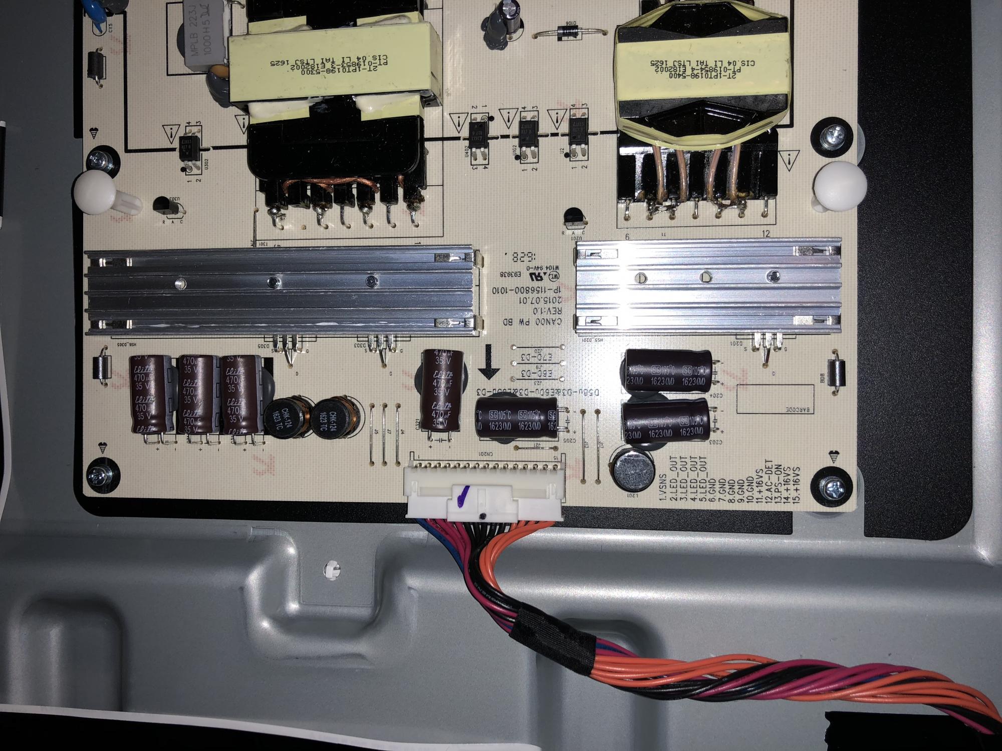

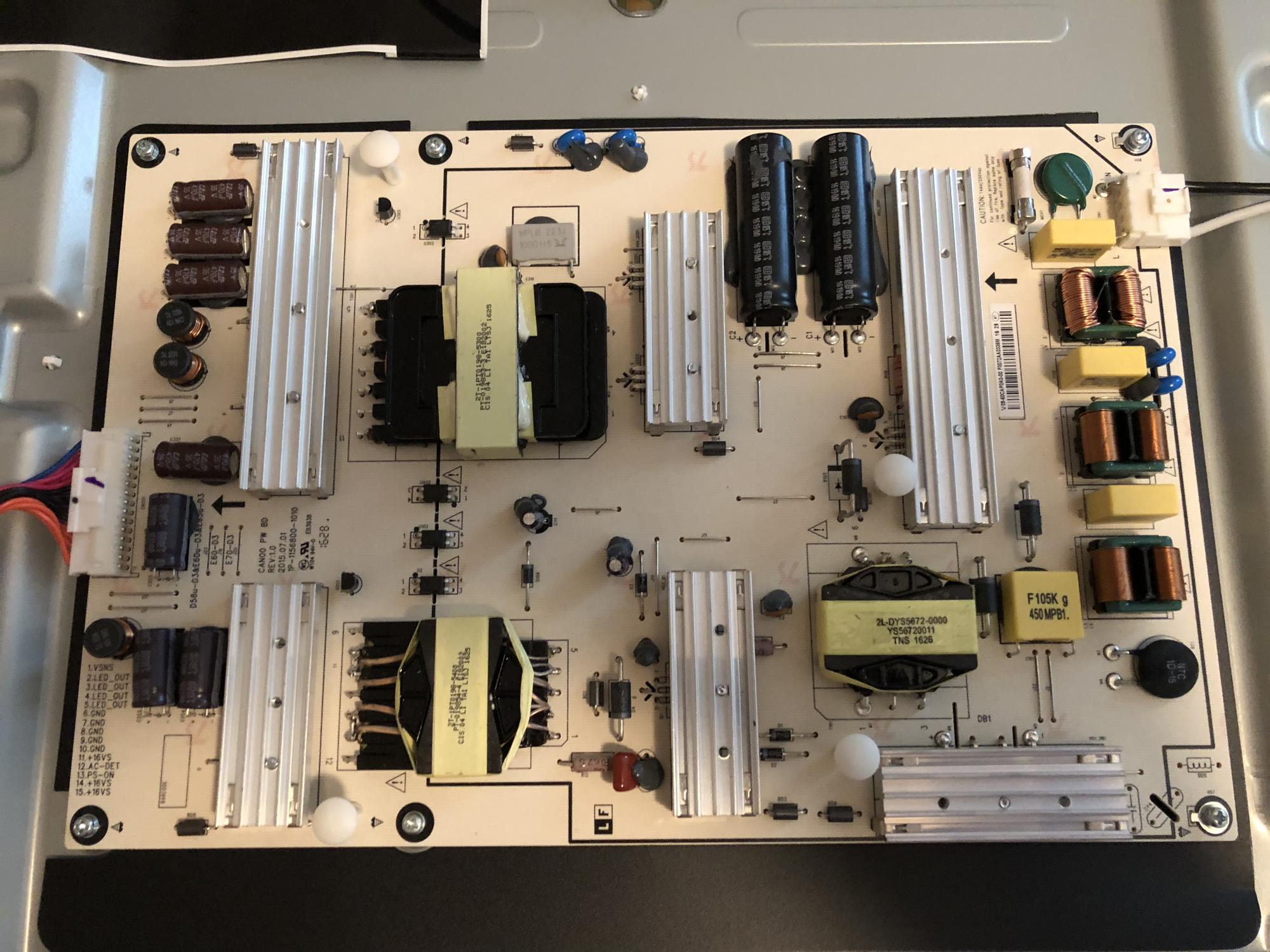

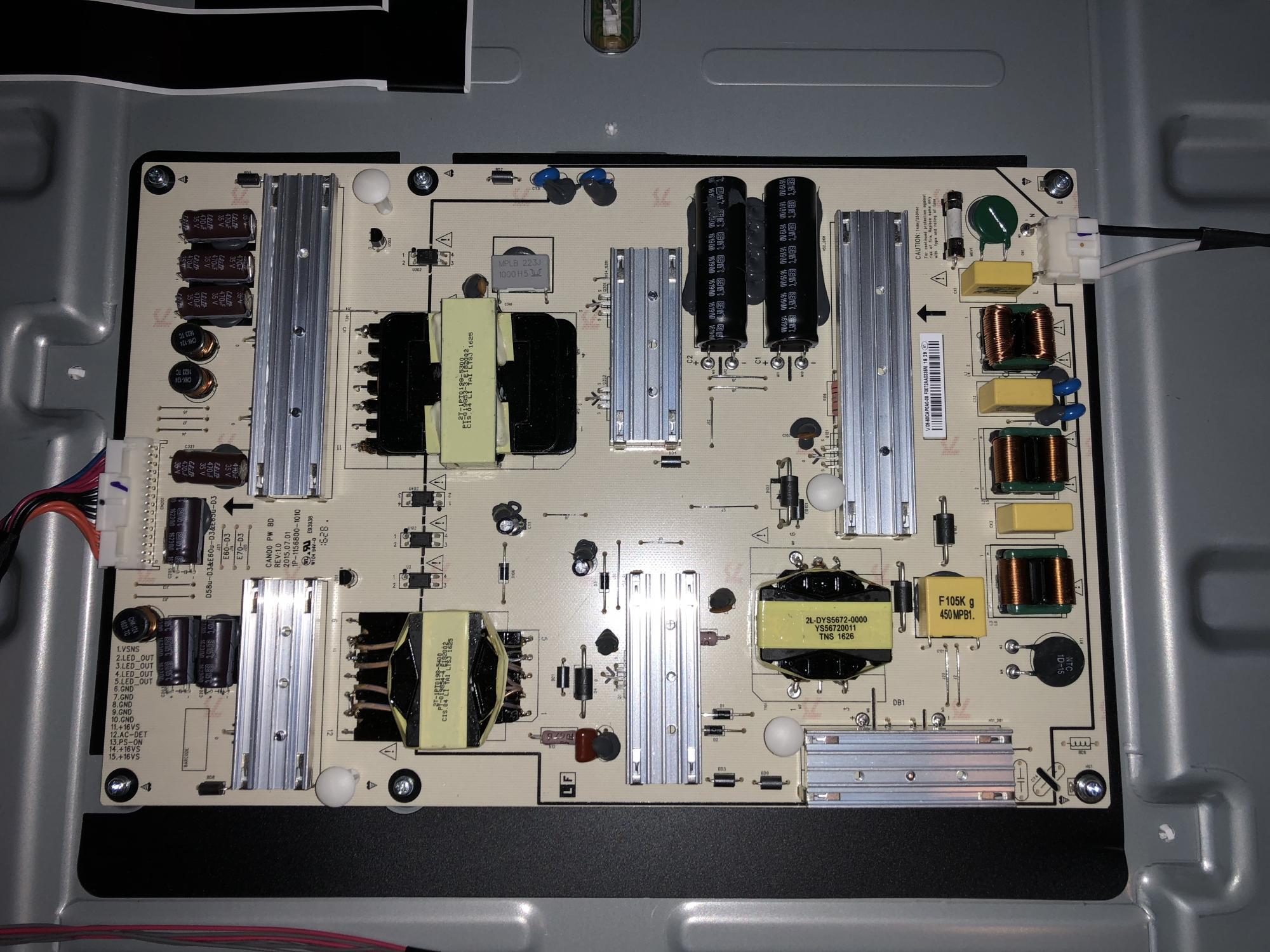

    My TV died because of a storm and I took it to a nearby shop. They charged me 100, said the power supply board was the problem (which i figured, given the surge) and said the repair would be an additional 350.
    I just don't have that kind of money, so I went on ShopJimmy and got the power supply myself (Vizio 09-60CAP0A0-00). The part arrived today and I did the swap, which seemed to be a relatively easy fix.
    The TV still doesn't power on at all and I'm not even getting the standby light.

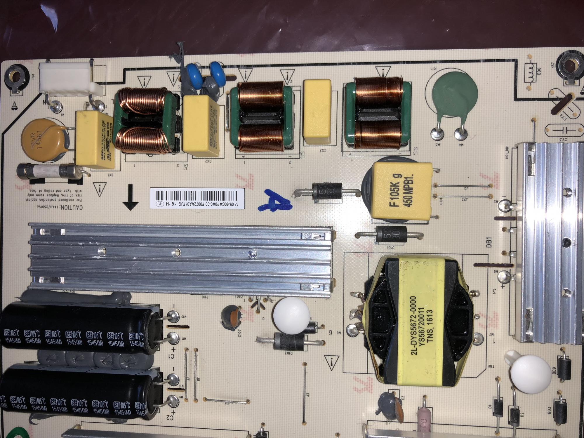

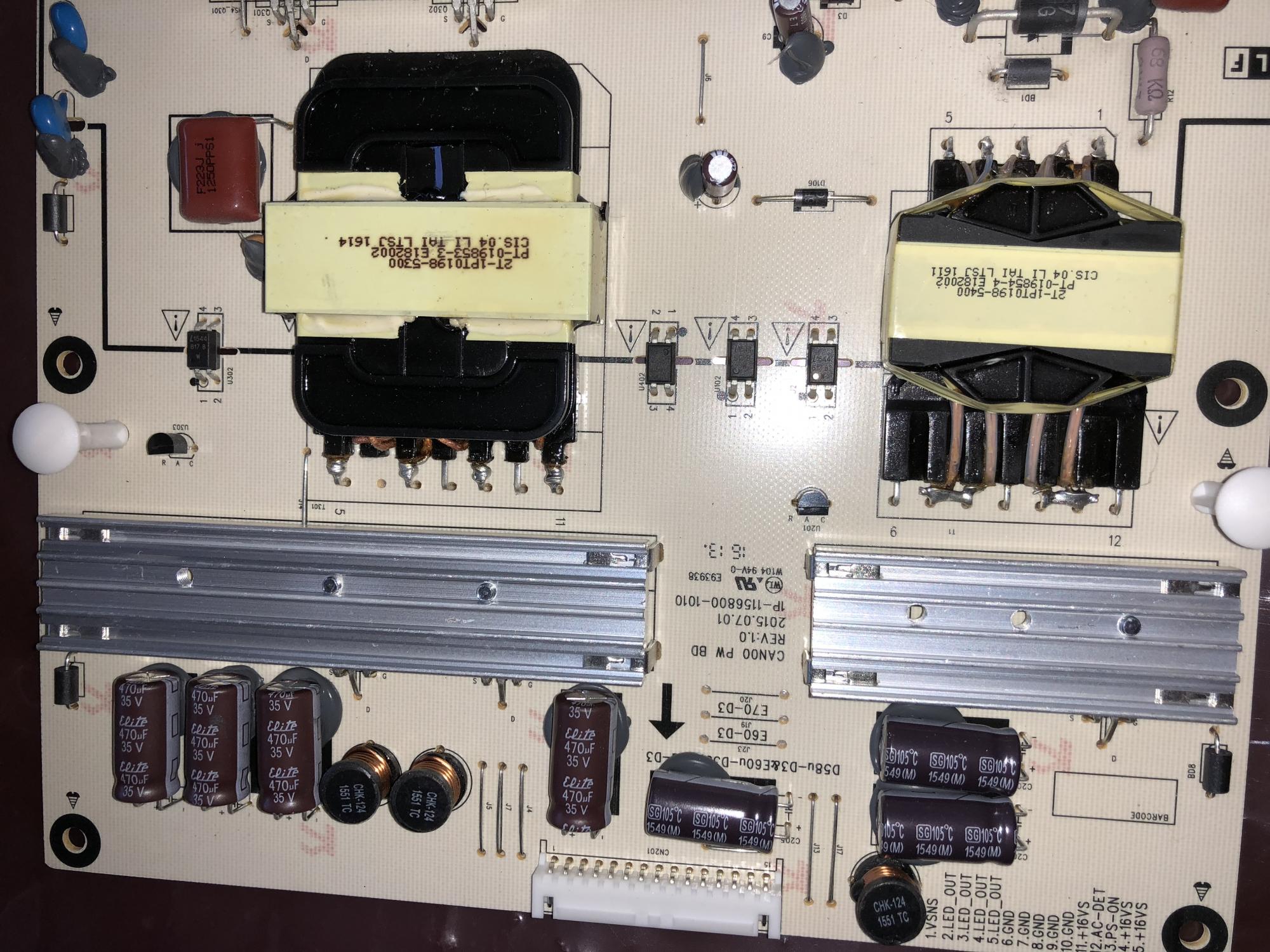

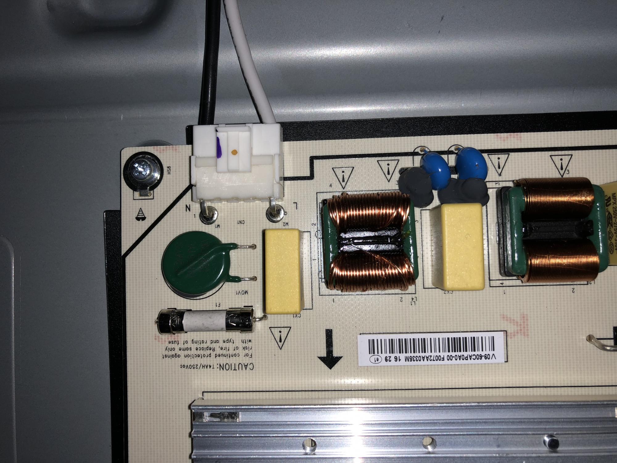

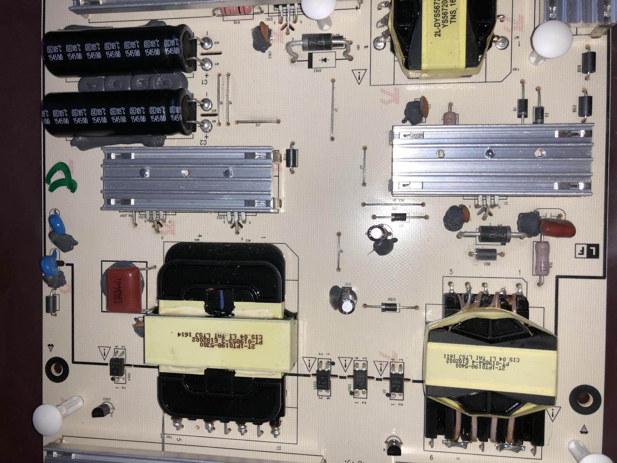

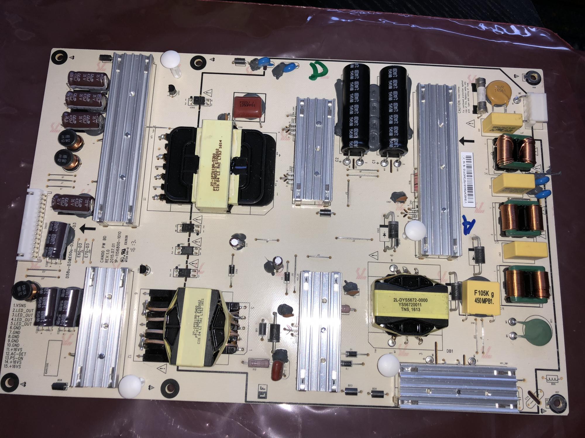

    Was hoping one of you would be able to at least point me in the right direction. I'll provide pictures if anyone thinks that'll help.

    Yes pictures will help as we do not have the actual TV in front of us. Clear, focused and close-up. Not just the PSU but with the back removed to see all the boards and how they are connected.

                                Just checked the new power supply board with multimeter. Pin 1-1.7 and pin 15-14.9
                                  Re: Vizio E60u-D3 Power Supply Help
                                  Please provide the pin names so we can tell what it should have, without the pin names we will not have any idea what the pins function are.
                                  Please report the reading of all the pins except the GND pins.
                                  Example:
                                  Pin 1 (VSNS) TV off = ??? V, TV on (power switches activated) = ???V
                                  Pin 2 (????) .........

                                        Plugged tv in and tested all 15 pins with multimeter. Numbers were identical (or within .01) for each pin before and after pressing power button on side of tv.
                                        pin 1 - 1.5
                                        pin 2 - .2
                                        pin 3 - .7
                                        pin 4 - 1.2
                                        pin 5 - 1.3
                                        pin 6 - 1.8
                                        pin 7 - This one was just bouncing around all over the place. no reading
                                        pin 8 - 1.8
                                        pin 9 - 1.9
                                        pin 10 - 1.9
                                        pin 11 - 16.30
                                        pin 12 - 3.99
                                        pin 13 - 2.6
                                        pin 14 - 16.31
                                        pin 15 - 16.30
                                        Checked a few random pins on other side of this cord (the side plugged into the main board) and they were the same as on the power supply pins.
