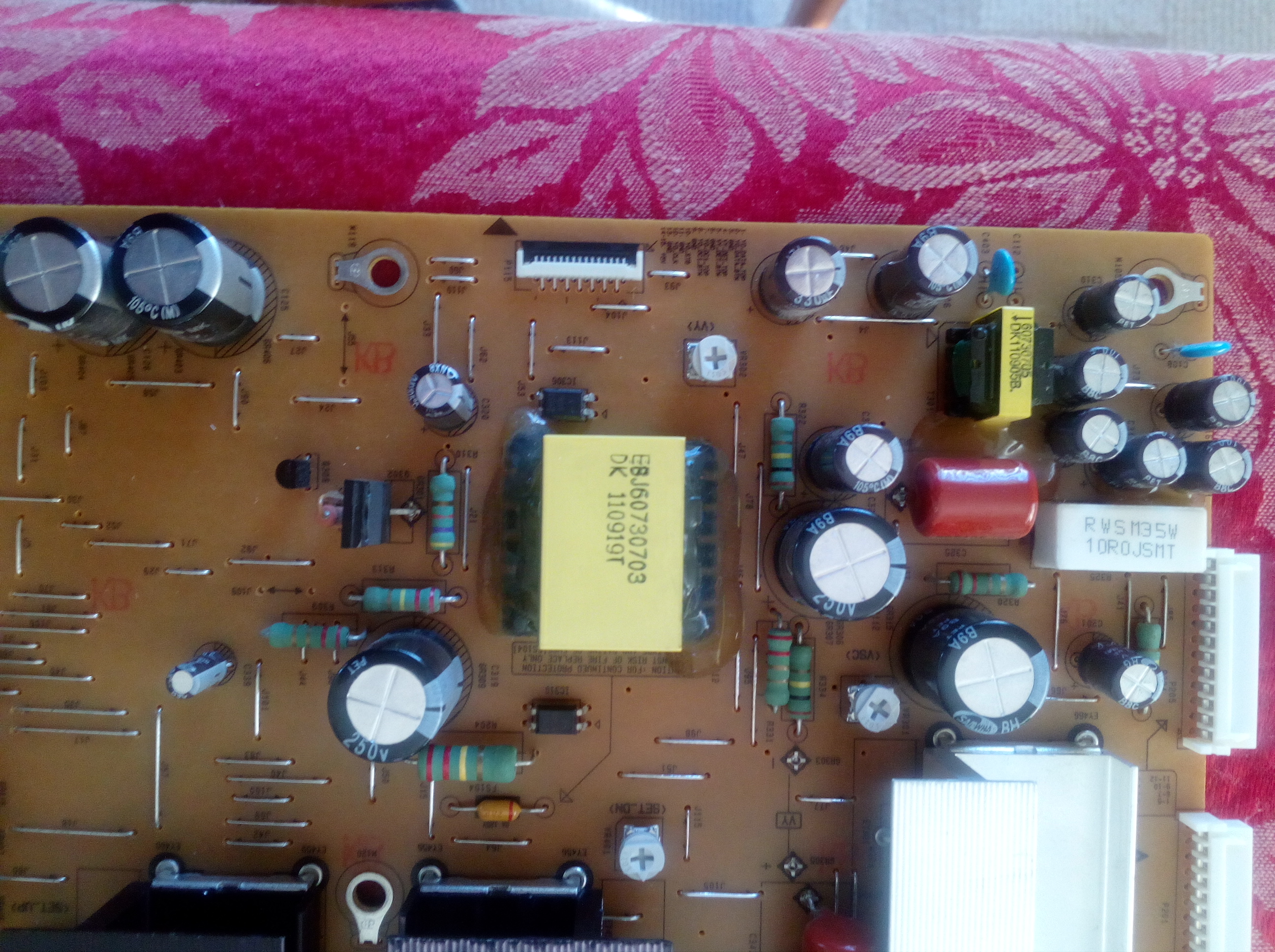

    This is a heavy monster given to me "sound OK no picture". Obvious someone has had a look at it as rubber pad missing from under ysus and a broken screw in back panel. Took voltages and VS 203v , VA 55v both OK per sticker and stay up as well. VZB 105v may be a little low? But both VY and VSC are all over the place - what I think is happening is the voltages are both being generated then quickly running down due short somewhere then regenerating etc etc. No difference with buffers disconnected nor with Z disconnected. Smaller 5v and 17v OK and set reacts to inputs. When on it stays on until turned off. LED is visibly working on logic board and looks to be . . - - repeating. Looks like Ysus problem to me. Can't see anything obvious but will go over board with hot iron - its EBR73561201. No sign of life on screen no blink at all. Did try pattern gen from logic but nothing of course. Pics a bit later but usual setup. Meanwhile, pointers welcome.

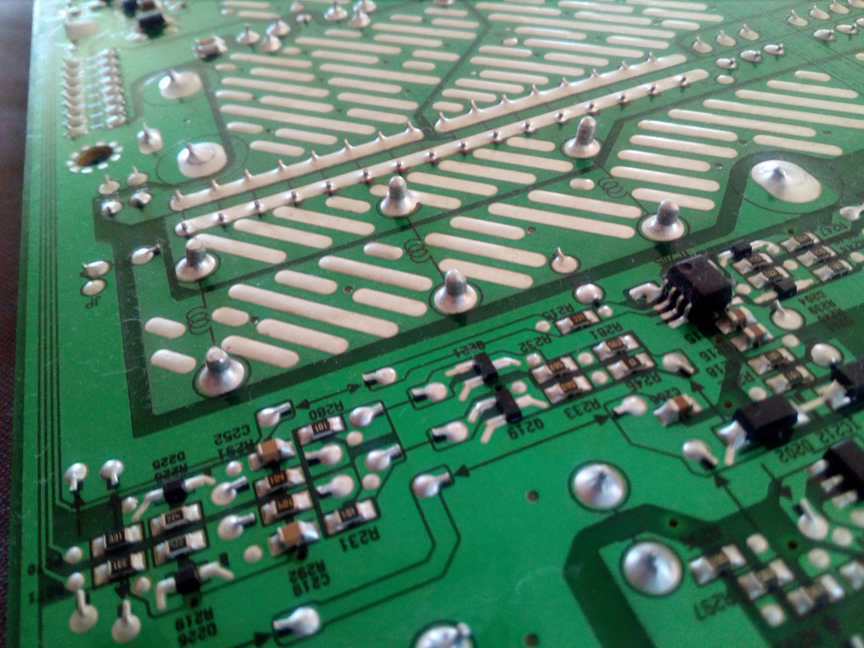

              I had a similar problem on a 60pv400 but the picture would go off after about 10 min (tv heating up) and what I found is there was a hairline crack on a solder joint on the Ysus board that only could be seen with a magnifying work bench light. I am trying to remember where it was and when I reflowed it the problem disappeared. Inspect the back of the board again very closely. It may have been one of the coils, again it was very hard to see with the naked eye.

                  Went over the board again including coils and transformers plus a couple of other things. Am not the best soldering person in the world but no change with both Vsc and Vy voltages continuing to fluctuate. I will next try splitting buffers and try the set with one or the other disconnected just in case some screen reaction. Did try with both disconnected but no change then.

                      Although obvious differences in the two ysus the only real disparity I have found in bottom circuits of these boards is with coil EBJ60730703 where on original set there is no continuity showing whereas on recent set there is. The coils have different sub numbers being DK101115T for older board and DK110919T on later one. Can't find any information on these. Have resoldered connections but no change. Is this a transformer for the voltages that are fluctuating??
