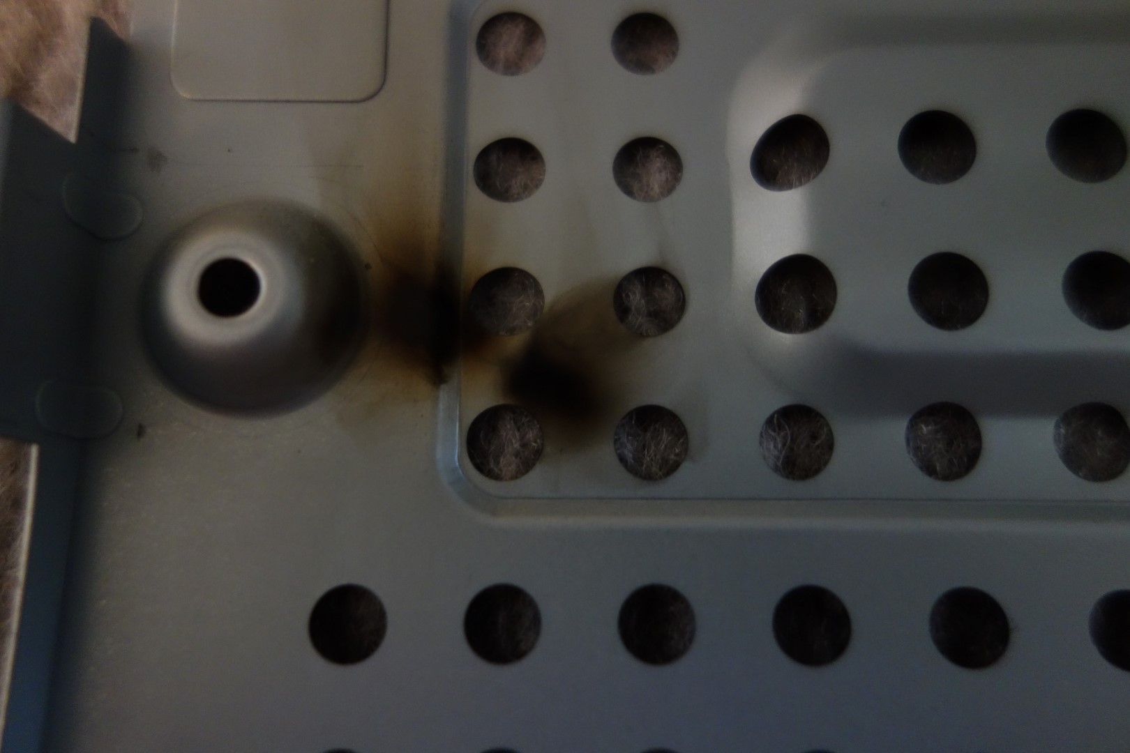

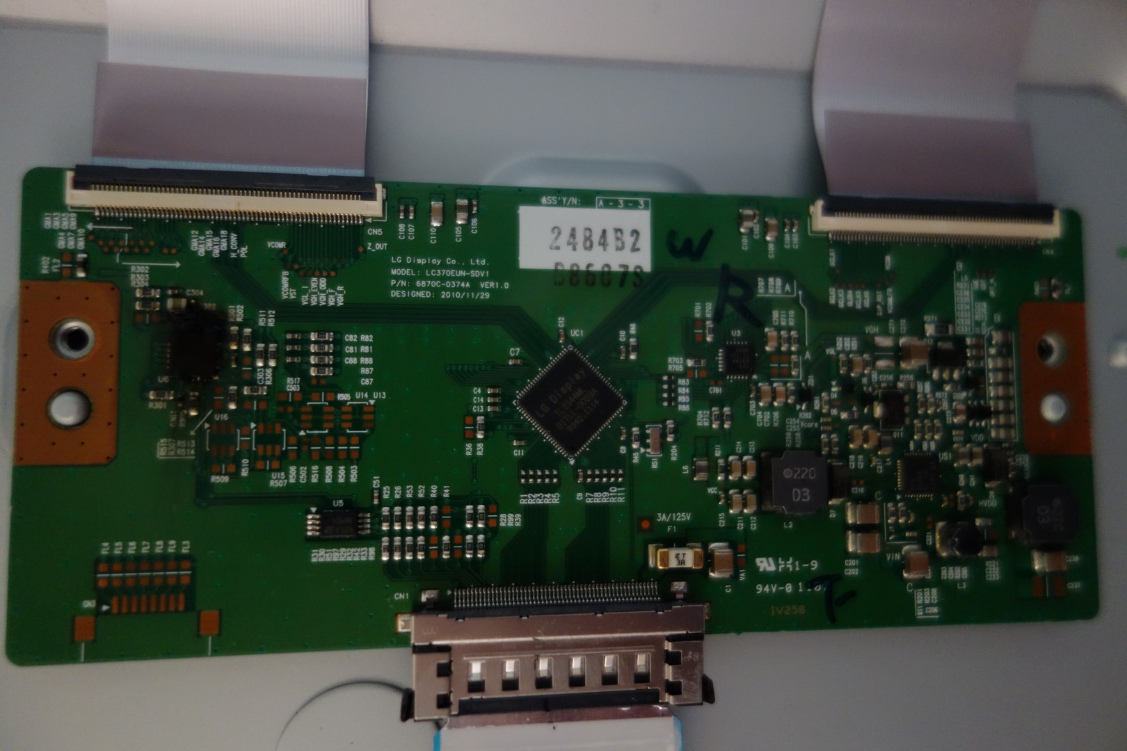

    Found a scorch mark on the tcon shield and burnt out IC on the Tcon.

    Replacement Tcon boards are around $30 USD.

        Any other opinions/experiences? The ebay seller cancelled my tcon board order. Can't find any exact part matches on ebay. There seem to be several different versions of this tcon - shopjimmy says mine is 2484B stamped on the board.

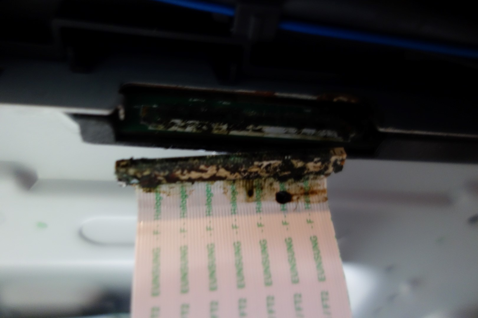

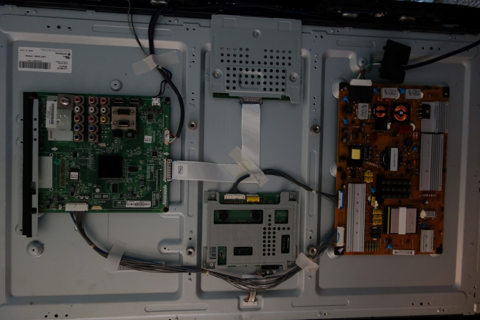

            I found a board on Aliexpress for $8. Picture showed 2484B and got a 2484C with extra connector. Plugged it in and got half a screen. Checked the tcon ribbon on the bad side and the connector is melted where it attaches to the flex circuit. Should have done a better inspection. Would have been a good find. Was a nice thin TV.
            Edit add: Tearing it apart, lots of damage on the left side flex. Looks like a coffee was dumped on that part of the screen. TV is edge-lit hence the thinness.
