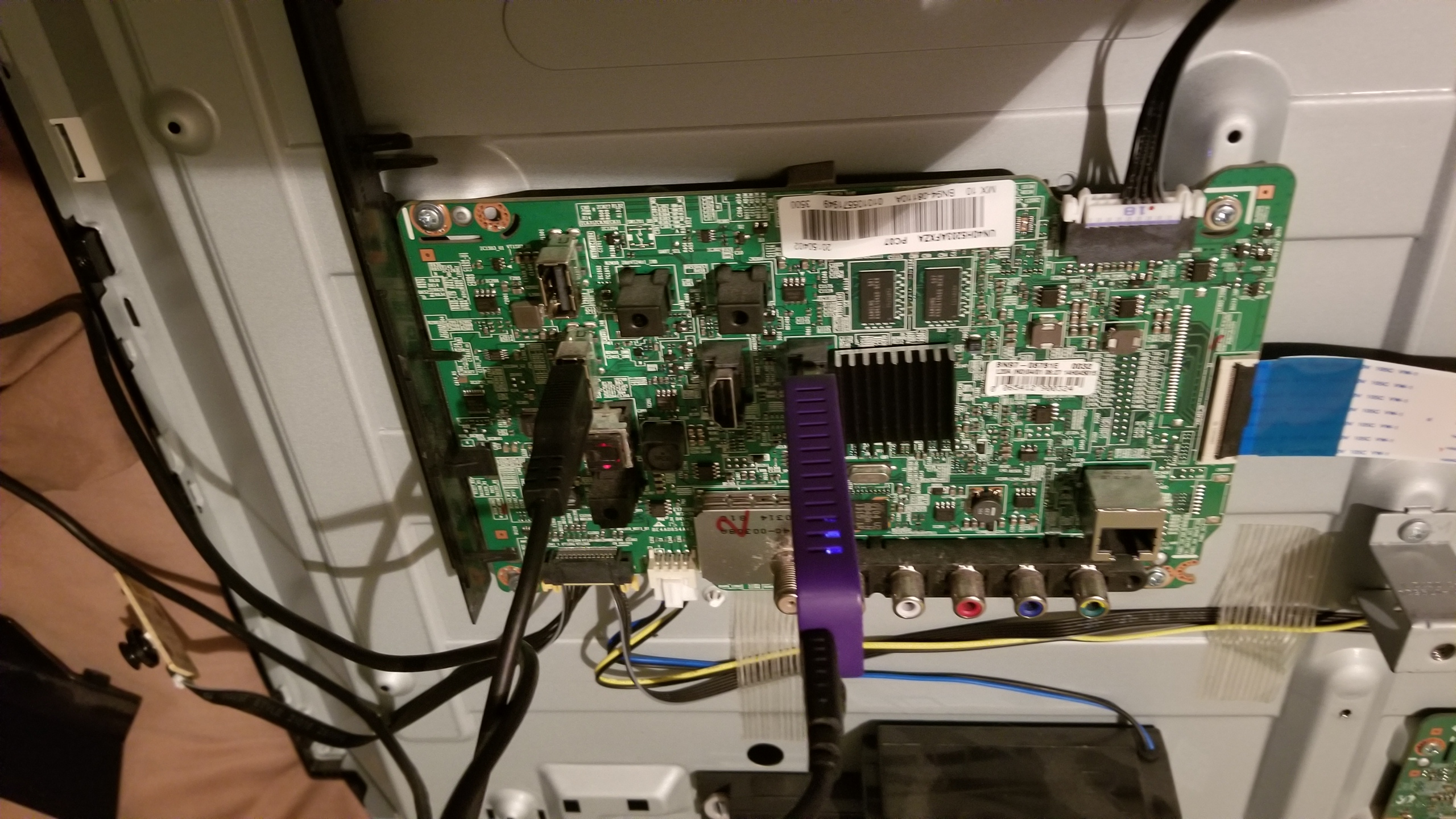

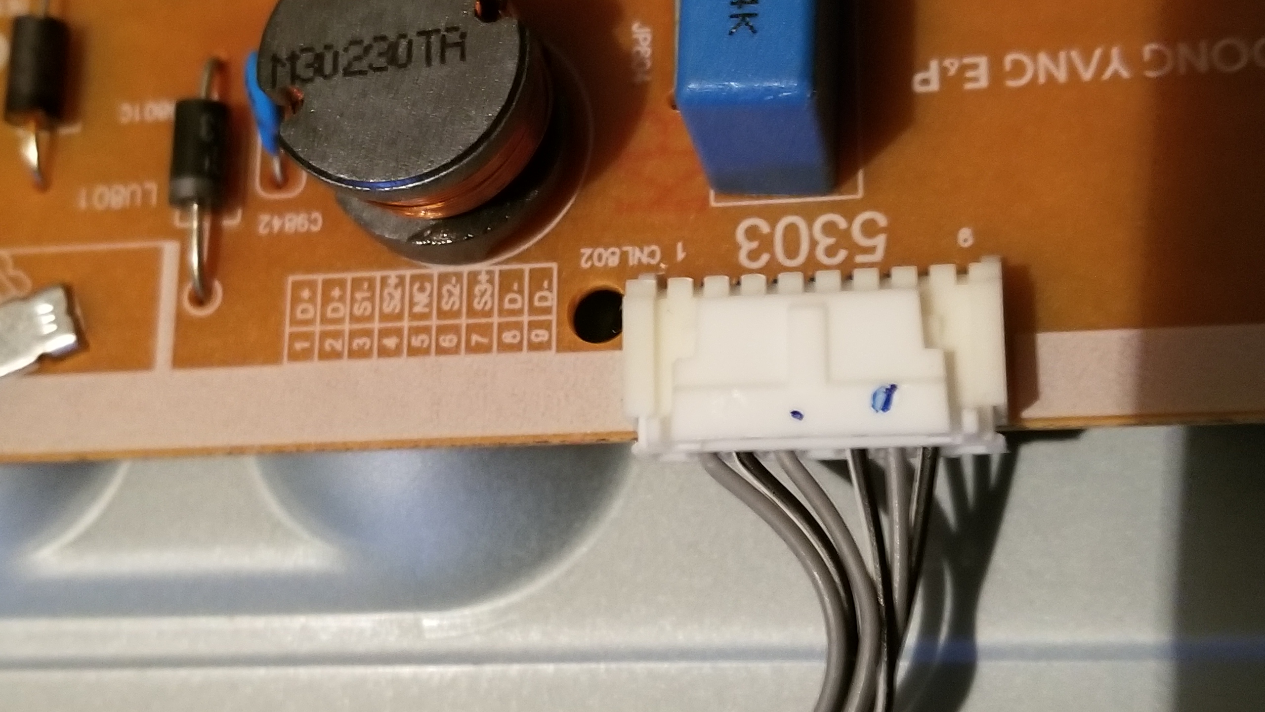

    This tv has no backlight, no screen image. But the power button blinks on and off normally and responds to remote control commands for on off and blinks for other commands
    I plugged in my roku stick and eventually got sound

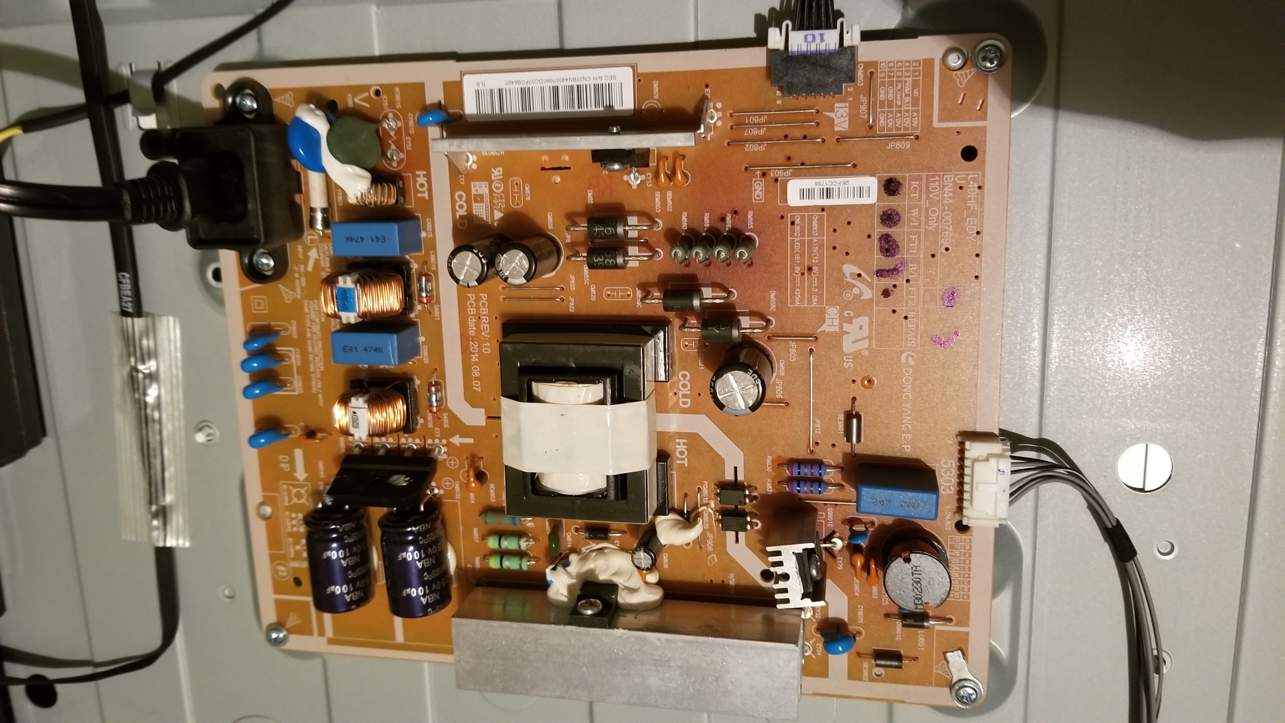

    Driver leds are lit. No visible bad caps but are samwha. Board browned a bit on four resistors (ive seen this common on samsung power boards, same group of resistors).
    Voltages to main are all reading steady 13v

    1) TV is OFF, ALL connectors in place.
    2) Put DC Voltmeter to 200VDC scale
    3) Keep Black probe of the meter on the chassis
    4) Put red probe on pin 1 of the LED, tuRn the TV on while watching the meter to see how high the meter jump up to, record that reading, and wait 5 seconds to see how low it goes down to, record that reading. Turn TV OFF.
    5) Repeat step 4 on the rest of the LED connector's pins.
    You MUST report the Pin name and follow by the Voltage reading of each pin of that LED connector so we do not have to guess what each pin is.
      Re: Samsung un40h5203. Power board diagnostic (mainboard boot, remote responds, sound
      Im guessing this is the led connector.
      1 (D+), off: 189, on: 203
      2 (D+), on-same as above
      3 through 9 off: < 1v
      3 through 9 on: < 0.2v
        Samsung BN44-00769A Power Supply / LED Board
        You have open circuit in the LED strings.

          So the strips are the problem? Never replaced those before. I had a chance to in a 55" Sanyo but the risk of breaking the lcd was too high. This might not be as bad. Any idea where to find the strips?
            You need to match the strip to the LCD panel model number, so find the LCD panel number sticker and search for the LED strips based on that model number.
            BTW, do you have LED tester? that is a good tool to have.

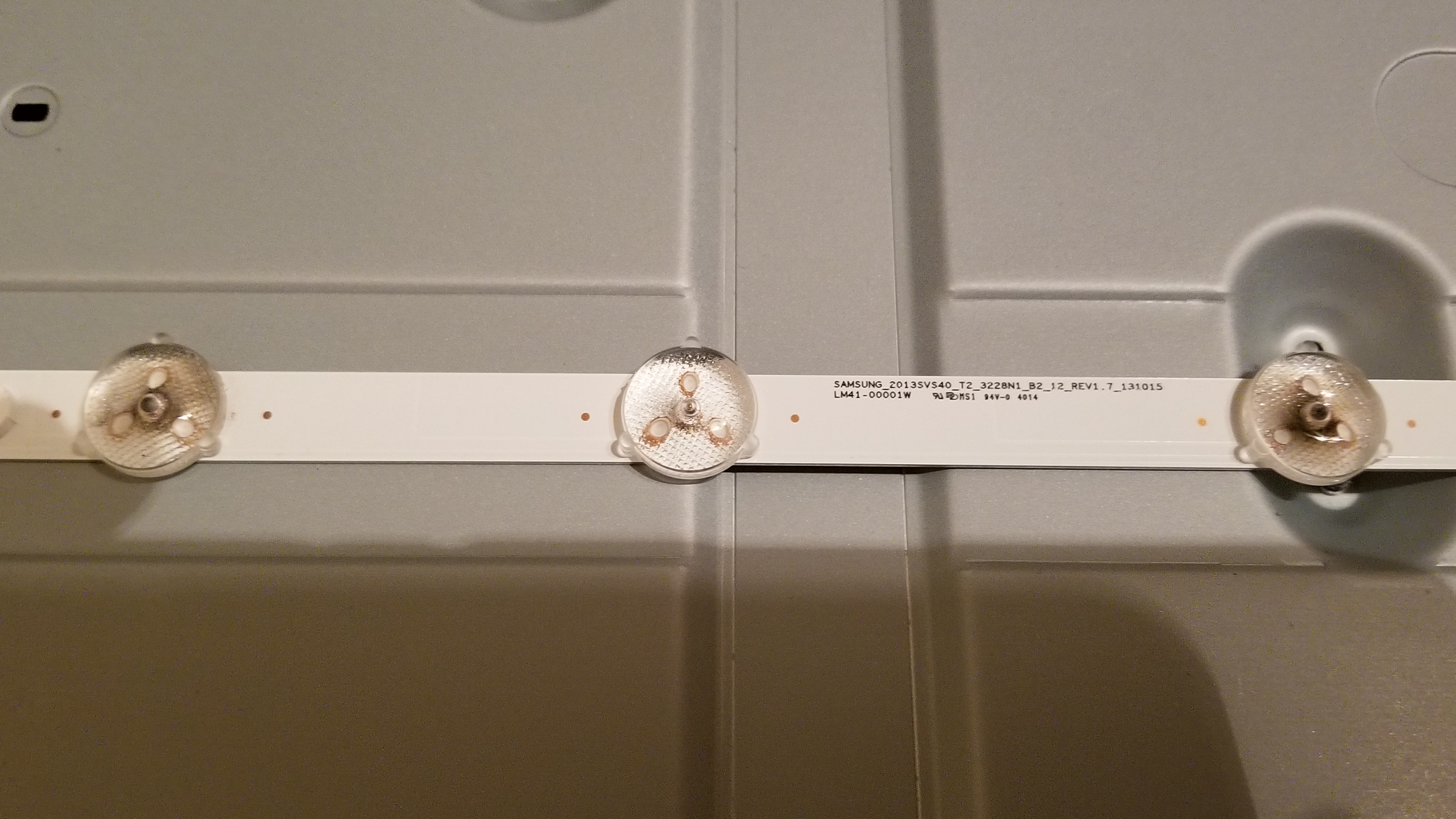

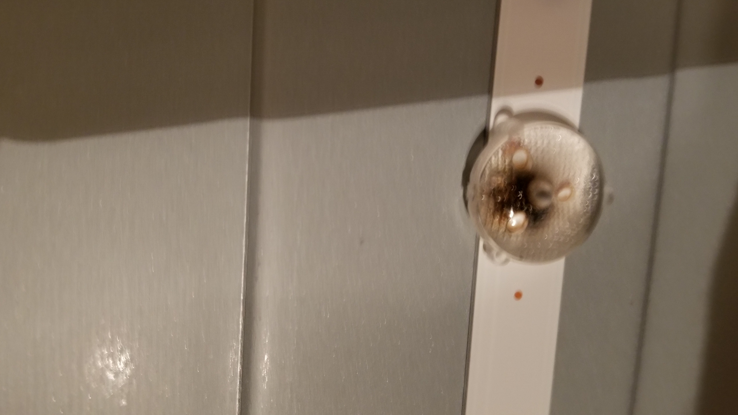

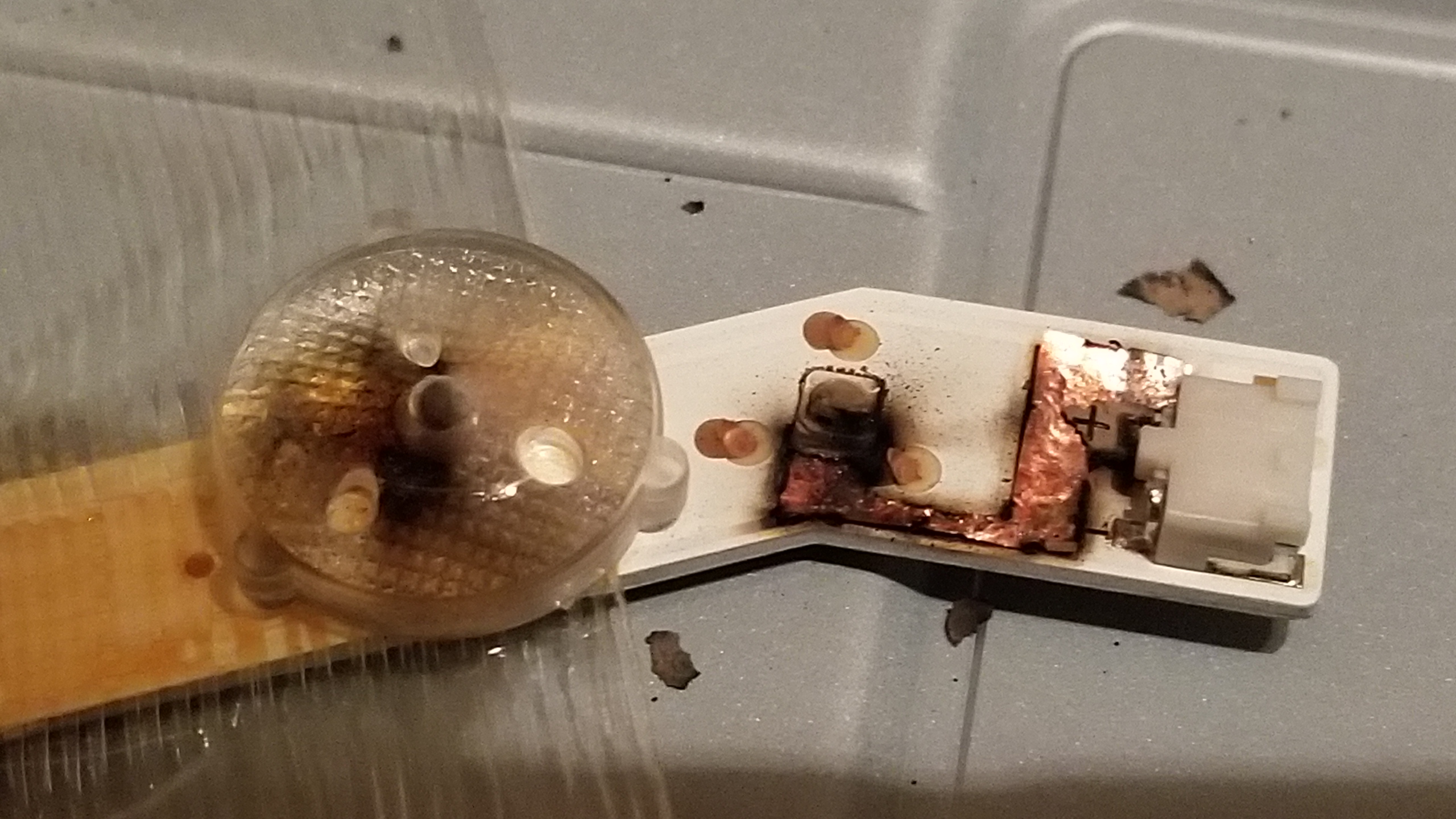

                    First two are from string 1. Obviously the problem there
                    Second from string two. Should replace
                    Third seems fine
                      I mean, the first two pictures are from led strip 1. Third picture are from led strip 2
                      Led strip three looks fine, but at shopjimmy it's $34 for one or $54 for all three so I should go ahead and replace all three

                        Good plan...Replace ALL the LED strips with new ones...that will eliminate backlight problems in the near future. Good Luck. As soon as it is possible invest in a LED Backlight Tester. Though it may sit around unused, you will be glad to have it in the not too distant future.
                          Once you get it fixed, make sure to set the backlights level on all input to as low as possible and never put the pictures setting to VIVID mode.
                            Worked!
