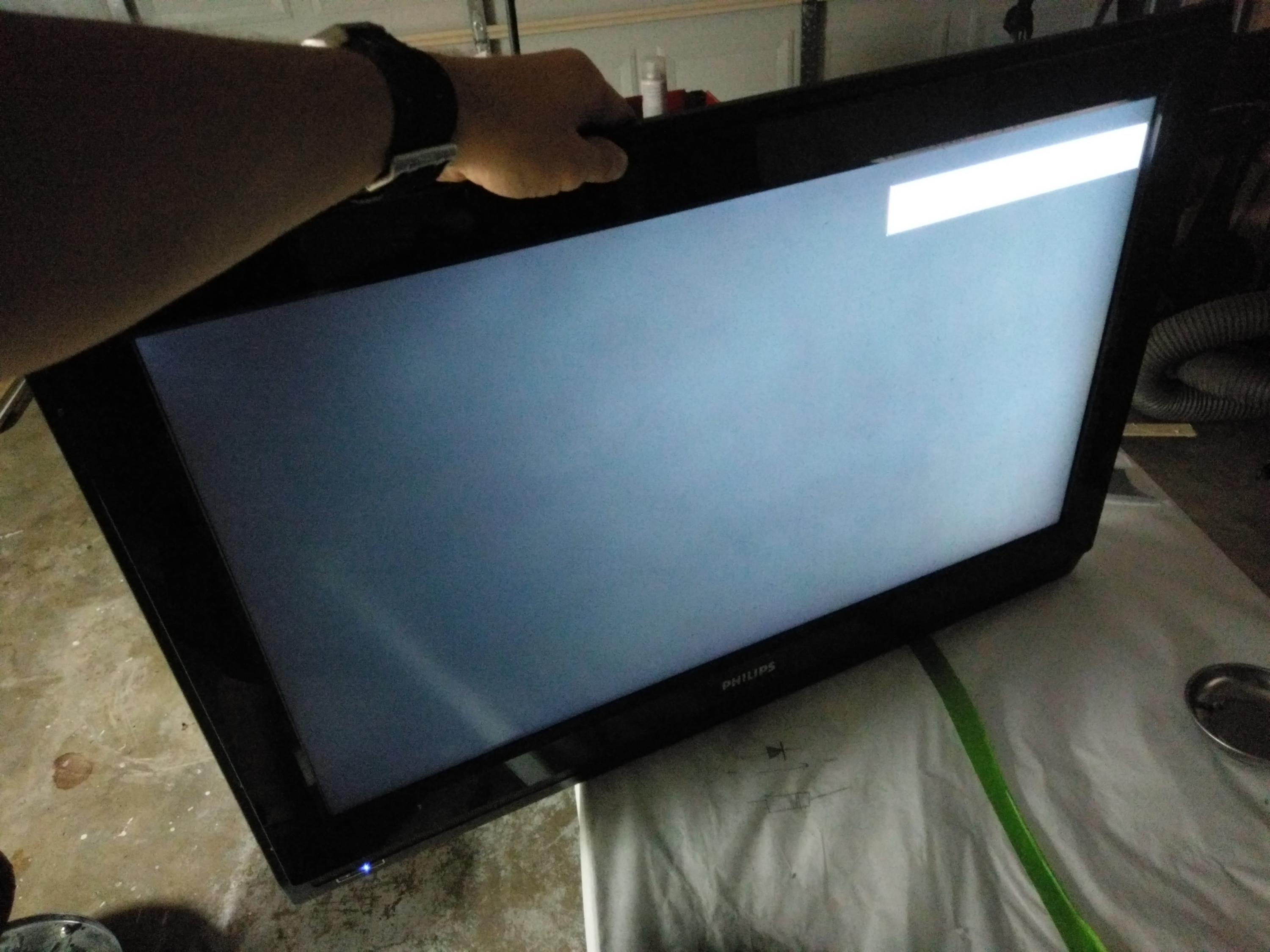

          Well son of a b*tch... I Put a 53watt bulb in my test cable, put the FET back in, powered it up, checked voltage across the main filter cap and Im looking at right over 400v...
            #45
            Re: Philips PLCD190P5 power supply
            Budm and R_J, you guys are f*cking awesome! I'm the proud owner of a working 11 year old TV.
            Just now realizing it doesn't have wall mount attachments...
            ***EDIT: It does have wall mount attachments, a metal plate on the inside of the plastic back panel, no actual frame work inside... Kinda sketchy...***
