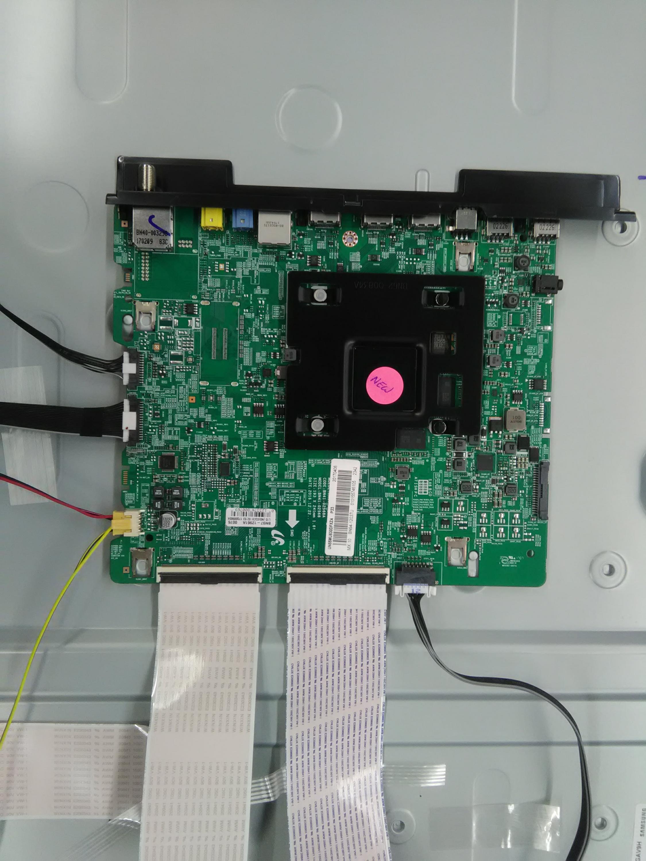

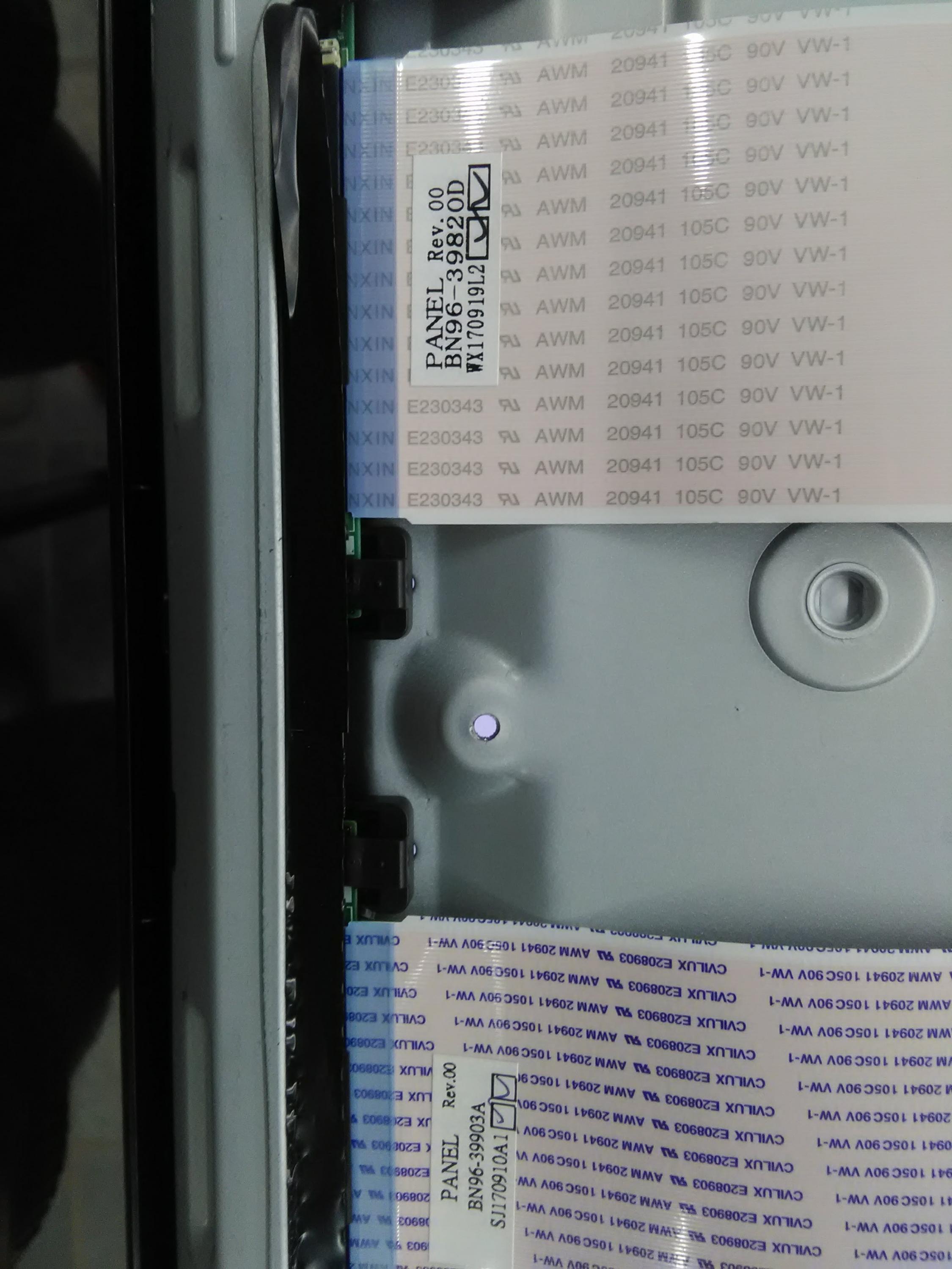

    Hello I have a Samsung UN55MU630DF television. I have tested the power supply and getting good reading on my voltages. 12.2 and 3.34. I replaced the main board because initially it would not even come on. Now the back lights flash on and off in a cycle. No T-Con but did replace ribbons from main to panel.

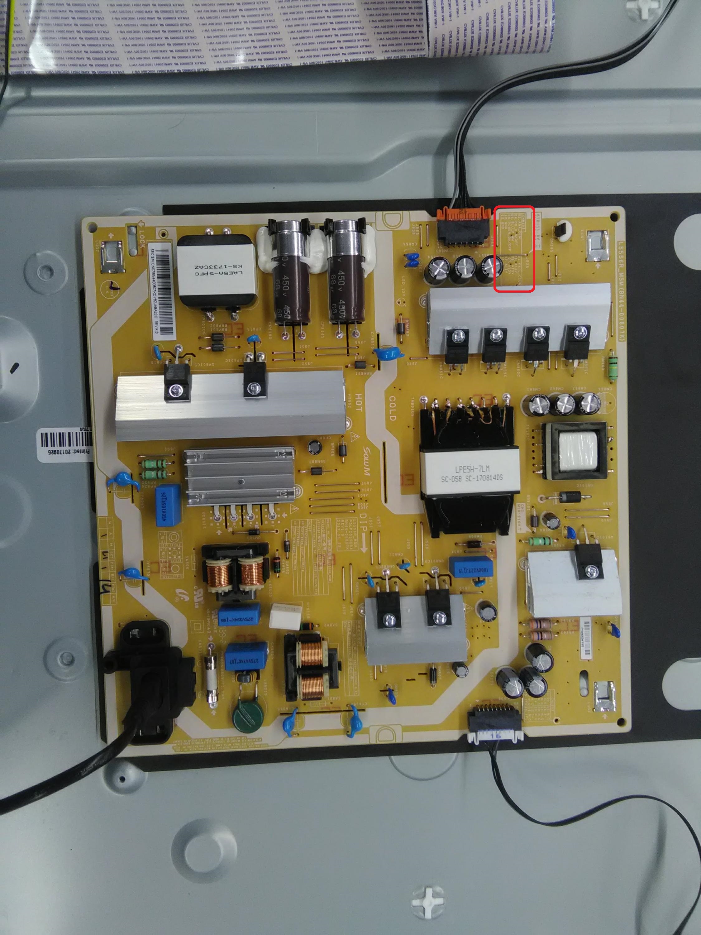

      Here are some pictures of the boards.

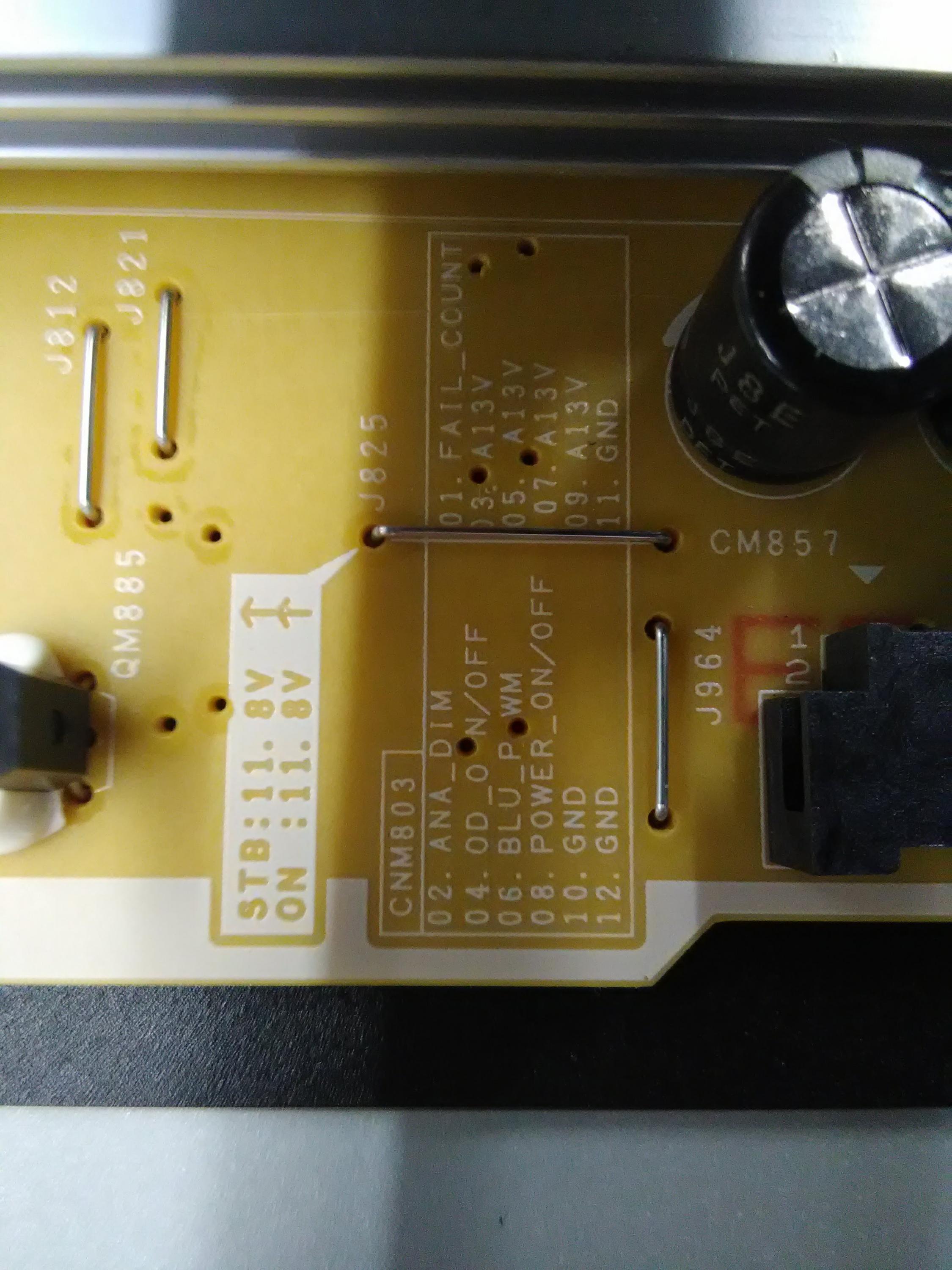

        Can you give the voltage readings on the 12 way connector CNM803 (blurry so hard to read) and the legend name alongside it.

          CNM803
          Pin 1 - .01V
          Pin 2 - 3.21V
          Pin 3 - 12.67V
          Pin 4 - 3.47V
          Pin 5 - 12.67V
          Pin 6 - 3.15V
          Pin 7 - 12.67V
          Pin 8 - 4.41V
          Pin 9 - 12.67V
          Pin 10 - .01V
          Pin 11 - .01V
          Pin 12 - .01V
            Re: Un55mu630df
            Can we please get the name of each pin?

              Without the legend corresponding to the pin numbers the readings are not much use.

                This is what I got.
                  Re: Un55mu630df
                  So ALL the control signals are all stable while the Backlights are flashing?

                    What happens if you unplug the main board from the PSU, then plug the TV in? Back lights should turn on and stay on.

                        Yes if I unplug the main board from PSU backlights come on and stay on.

                          Try these readings again, need them with tv plugged in and then with power switch activated, see if any change value when you hit power button, report findings.

                                    Looks and acts like mainboard but seeing how bad these samasungs are, I think it's the powersupply.

                                        If the backlights come on and stay on without flickering then your power supply board, LED driver and LEDs are OK.
                                        But as I asked in post #9, are your sure that the control Voltages (not the A13V) are stable?
