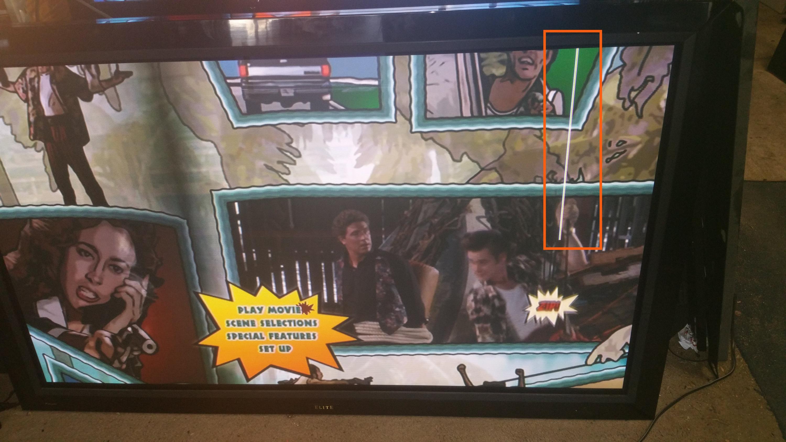

    Pioneer 1410-HD Plasma Vertical Line Top Right 1/3rd
    I got in a hulking monster of a 65" Pioneer Plasma TV...
    Any idea what could be causing that line (see pic)??
    If it's not any easy fix, I am thinking of just using it as a display monitor in the front of my shop.. Kinda scared ta put it up on a wall, though..

    Re: Pioneer 1410-HD Plasma Vertical Line Top Right 1/3rd
    I'm not even going to say it unfortunately. Just use it like it is.
        Not certain how the drive is done on this tv but look for drive board on the top RHS connections to the panel . Tap the connector lining up with the panel or un clip and re clip the tab connector , see if that fixes the problem
        Almost 99% not a panel fault
          I'll check that when I get into the shop tomorrow. Monday is my day off..
          The thing is built like a tank... Heavy thick metal frame.. It's gonna be fun to tear down..
          Not sure if it's relevant, but the "line" is actually made up of 2 or 3 very thin lines. And they change color.. Sometimes shades of red (red, orange, yellow) sometimes shades of blue (blue, green)
            OK fiddled with the tab bonds and the buffer board.. Still has that line.. Ordered a replacement buffer board..
            Hopefully the problem is in the board and not the panel...
            Thanx for the help.. I'll follow up and advise the result..
              Final dispo on this..
              Turns out it was in the display panel.. Replaced the buffer board, still had the same quarter line..
              Oh well.... I'll pair it with an XBOX 360 system and, for $100, it will make someone an awesome 65" gaming monitor..
                Definitely a dead panel. You should know better than replacing the buffer board because that deals entirely with rows. There is no failure of the buffer board that could cause this fault. Literally nothing could fail in that way on the buffer board, due to the principle of operation (see my previous posts on why buffer boards should be called scan drivers, and why they are pretty easy to diagnose really.)
                  "Something that would have been good ta know YESTERDAY!!!!"
                  -Adam Sandler, WEDDING SINGER
                  Just kidding..
                  Yea, live and learn.. It only cost me $12 to find out what a nimnull I am...
                  But I did get a win today.. A Panny P60"... Another Dead As The Proverbial Doornail Panasonic.. Ordered a new Main Video board and it came up like a champ!
                    Yea. I knew it was a bad panel. That's why I said what I said earlier. Just run it as is. NEC/Fujitsu had this problem quite a bit in the mid 2000s.
