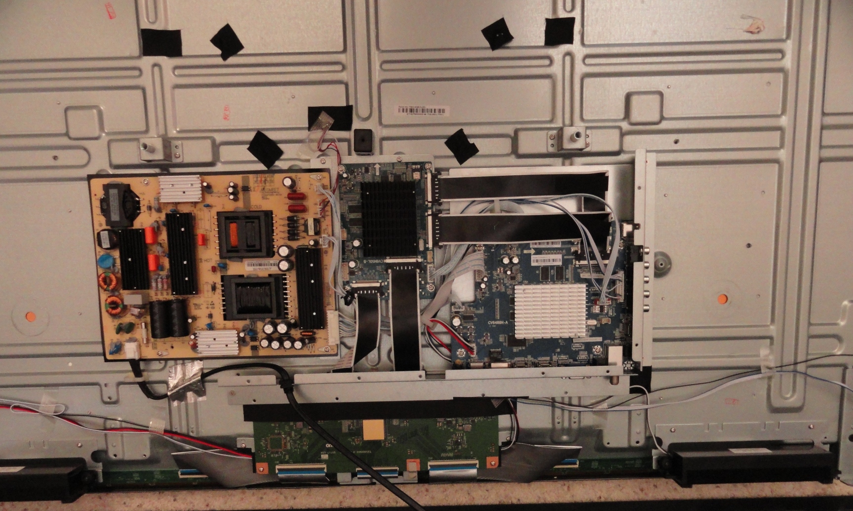

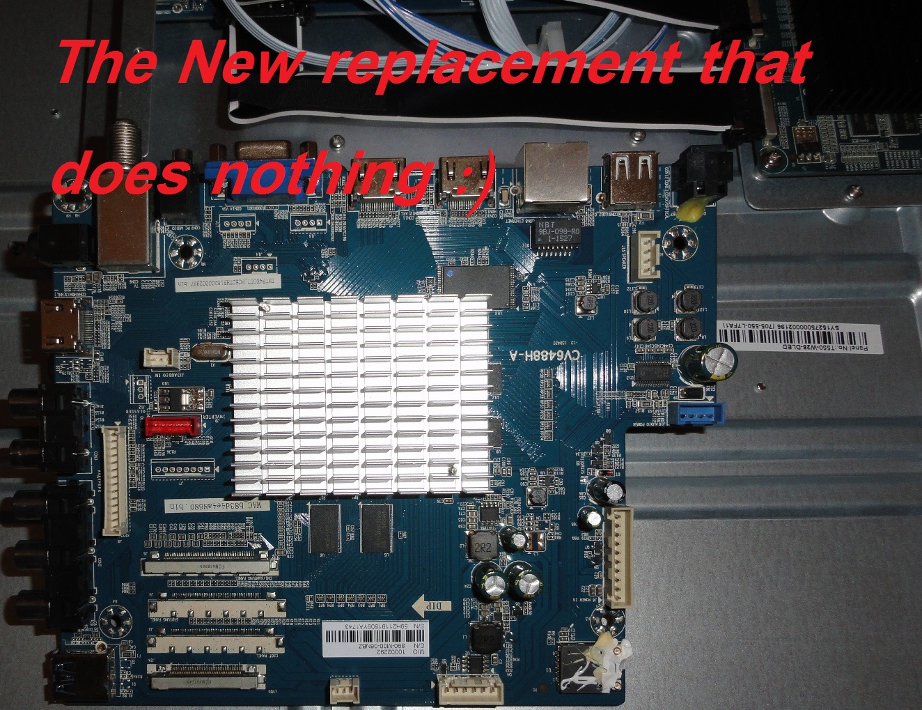

                  Finally, I ordered a main board from eBay thinking this is it. Seller swears it is a working main board. When I install - I only get backlight and on/off activity. Nothing at all on the screen - no logo or anything else. Does the main board have to match the LED control board (are they paired and need to be replaced together?) or did I just get a bad board? I installed my glitchy main board and it's fine

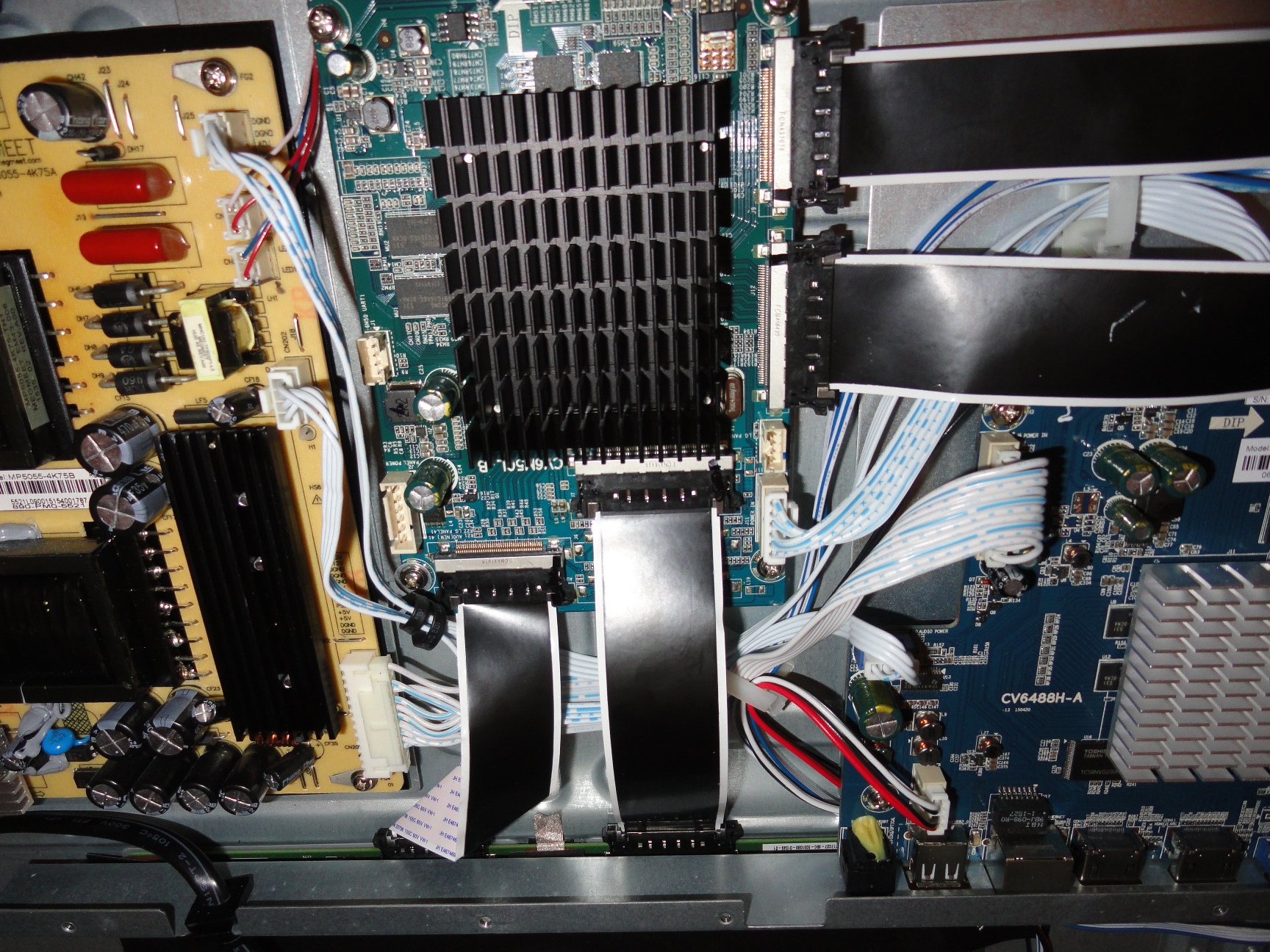

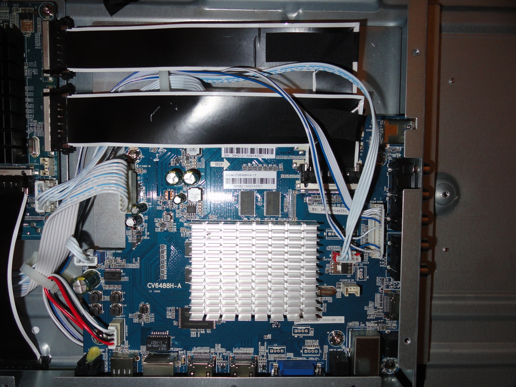

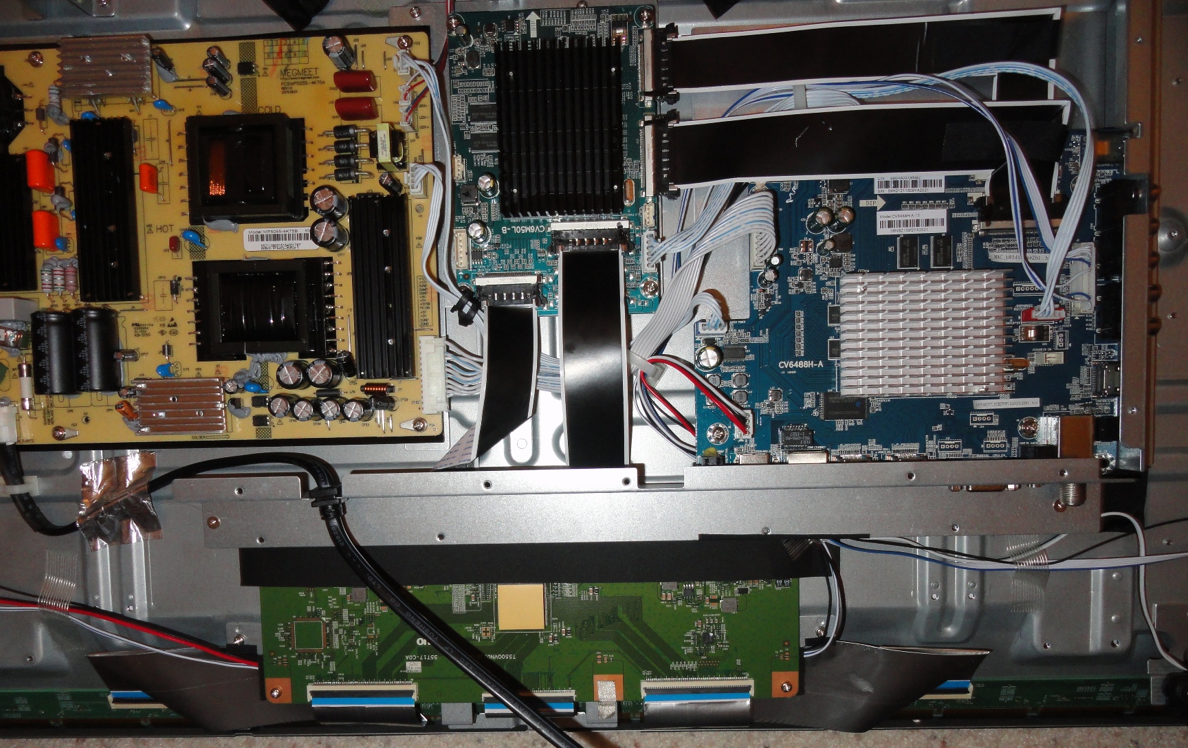

                      Can you post clear pictures of your boards to see the set up.
                      • jason123
                        • Oct 2015
                        • 1154
                        Re: Panasonic TC-55cx420 Backlight Control
                        Here you go

                              A search of the board number CV6488H-A comes up as being used in a number of different sets. Could your supplier tell you which make of TV it came from.
                              • jason123
                                • Oct 2015
                                • 1154
                                He had it listed as coming from a Panasonic TC-55cx420U which is exactly what I have. Labels on the 2 boards seem to be identical.
