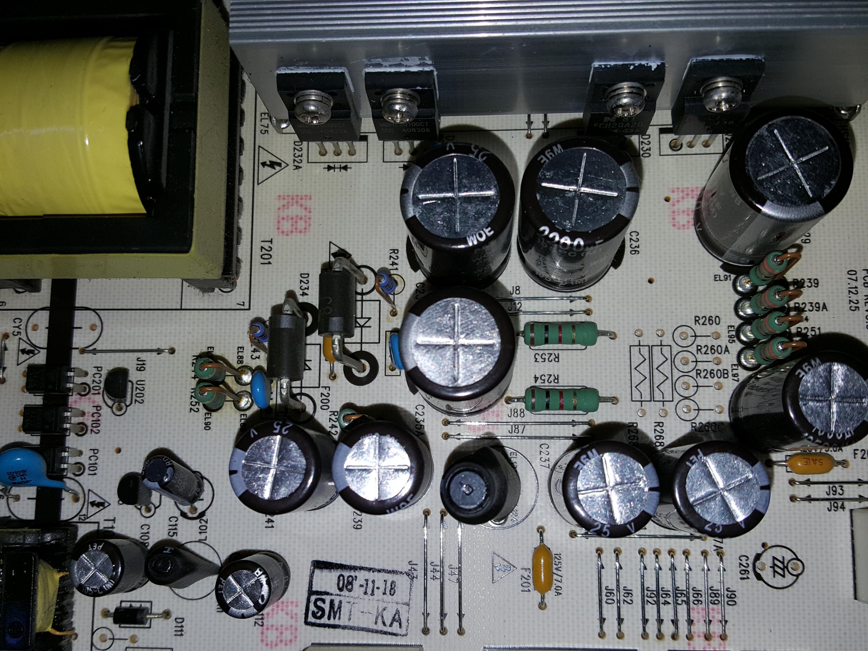

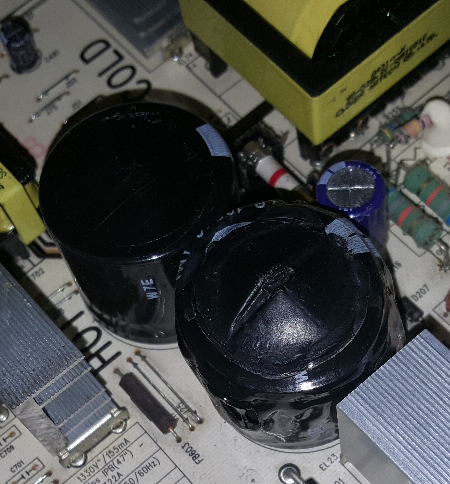

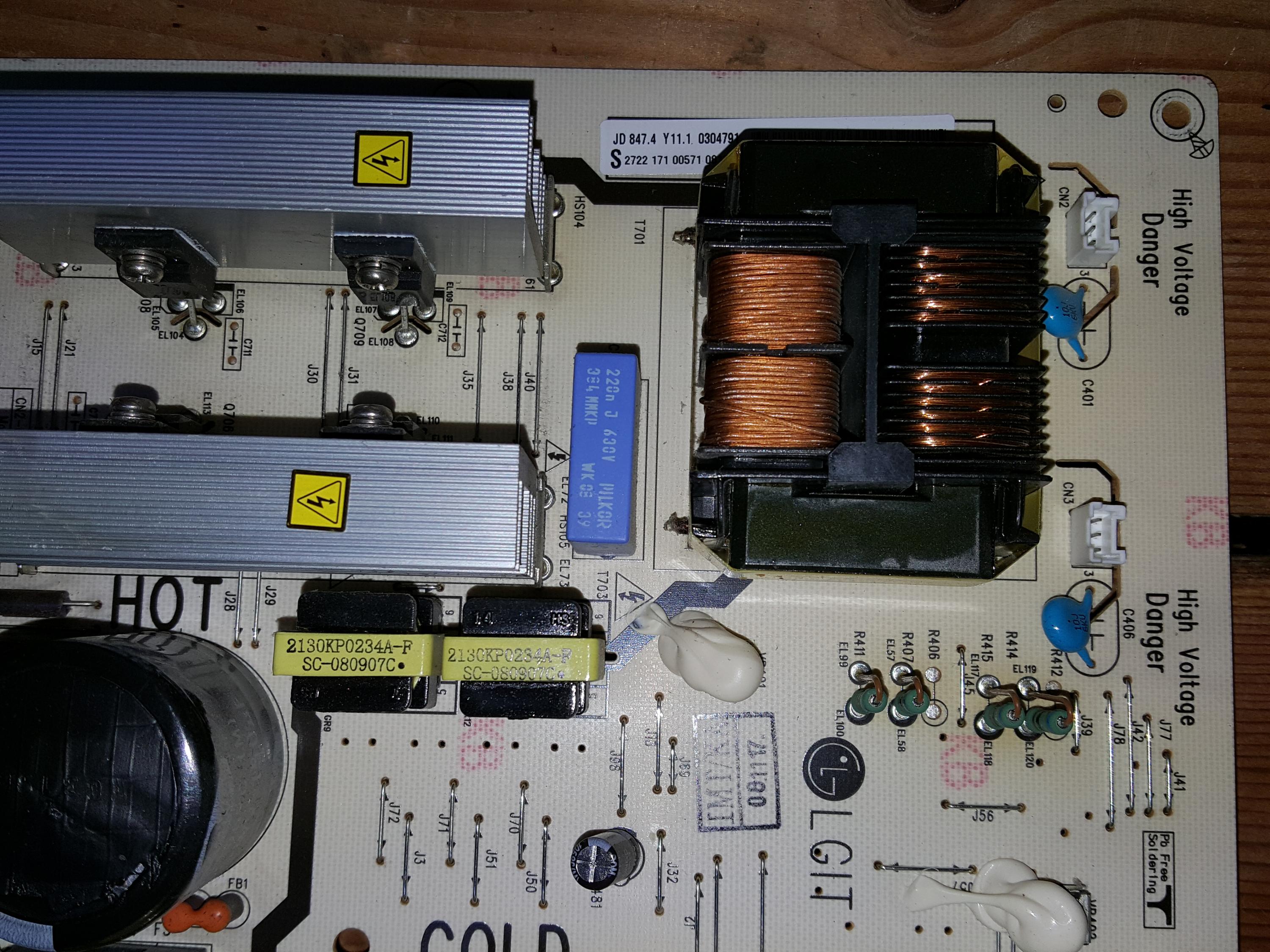

    I work on tv's off & on & have repaired about 100 TVs over the years. I opened up the back of a Philips 47pfl7403d/f7 and saw that the large 150uf at 450 wv was totally expanded and blown wide.
    I'm just curious if any of you have seen this often.? I don't see any any other blown capacitors but I may change some of them in their surrounding area. Also do you think there is any other issues I should check out before I order parts? Thank you
    I asked on the AVS forum but have not seen any replies.

    Re: 150uf at 450 wv Large Capacitor Blown - I've Never Seen This... Have you?
    It can happen... lightning strikes, power phases being shorted in such a way that you'd get 300v+ in the device, active pfc circuits breaking and sending high voltage in those caps...
        These caps are filters in the rectifier circuit and they can fail, after all it they are man-made and active in circuit. I would suggest you test the bridge rect and the switching transistor/s also.
          Yep, I've seen about a dozen or more. Several were from bad house wiring (open neutral doubling input voltage), but most were just runaway high ESR. These supplies run 24/7, and when they start getting hot, you can get a thermal runaway. The hotter they get, the worse the ESR gets and they may even get electrically leaky. Once the vent opens, they spew and vent themselves out. You'll find the cap weighs about a quarter what a good one of the same size weighs.
            An open resistor in the voltage sense of the PFC could be the issue .

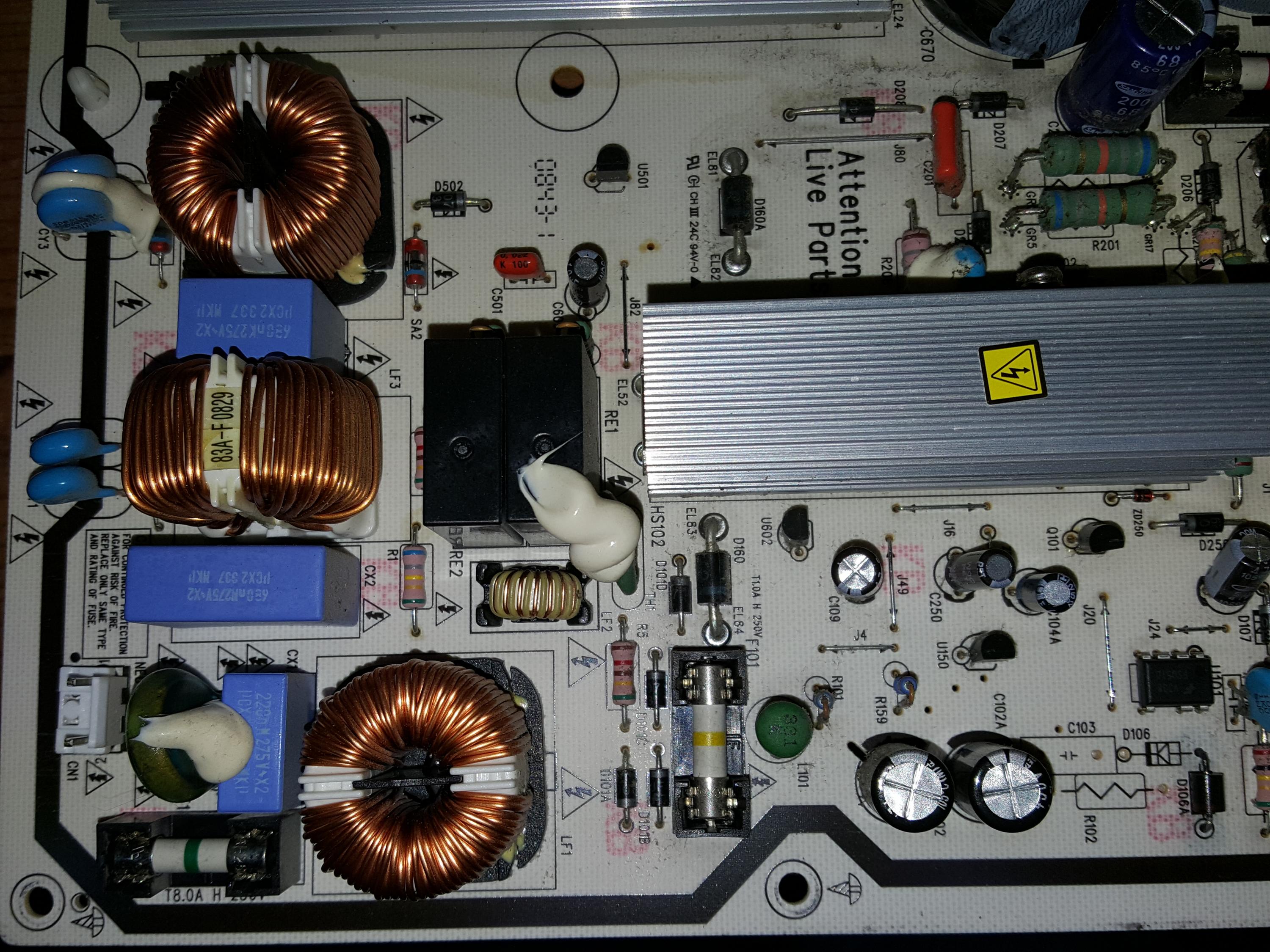

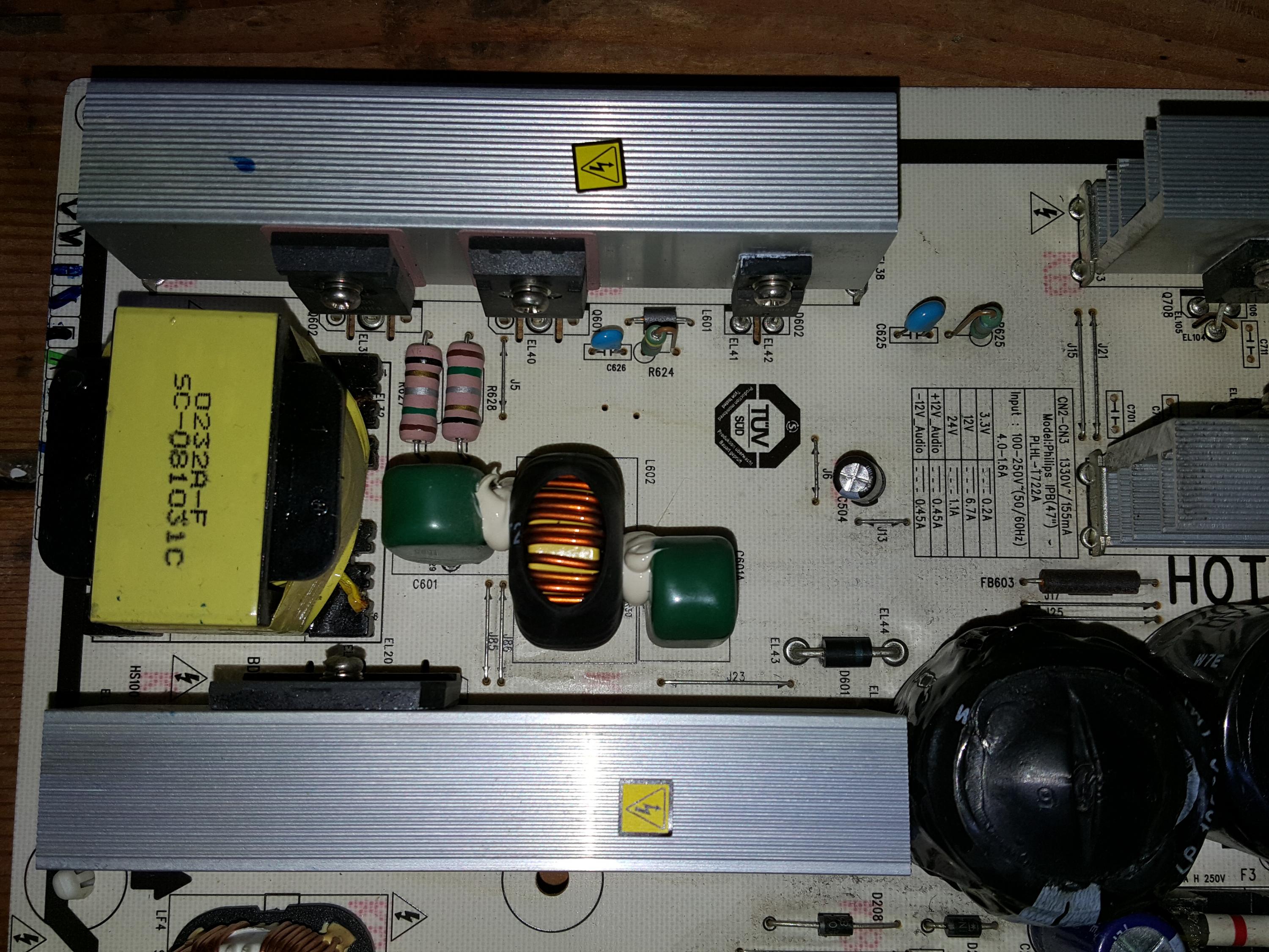

                You need to upload good clear straight shot pictures of the whole top and bottom side of the board to be able to locate the feedback resistor network.

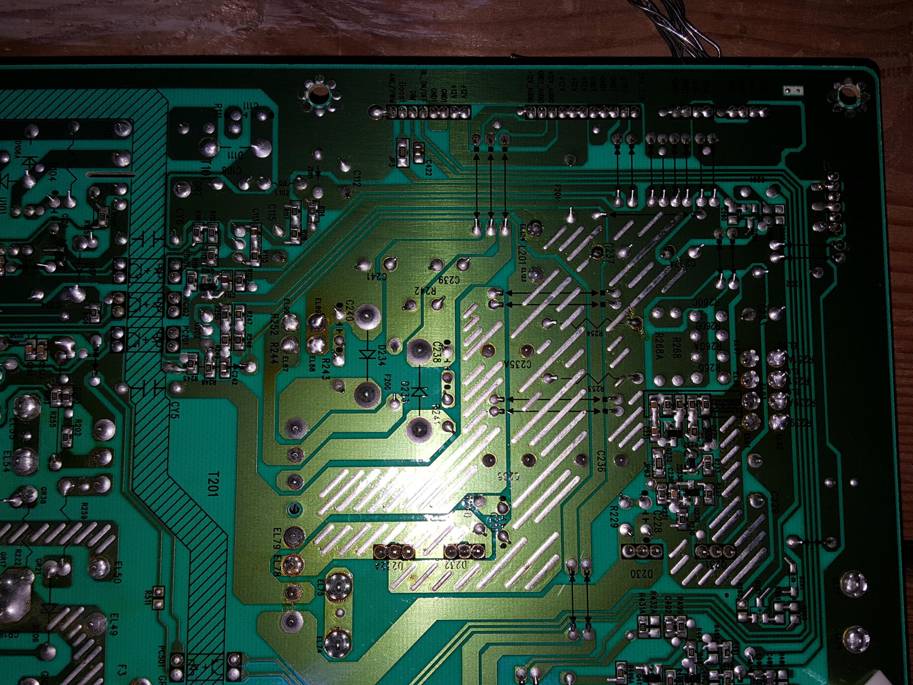

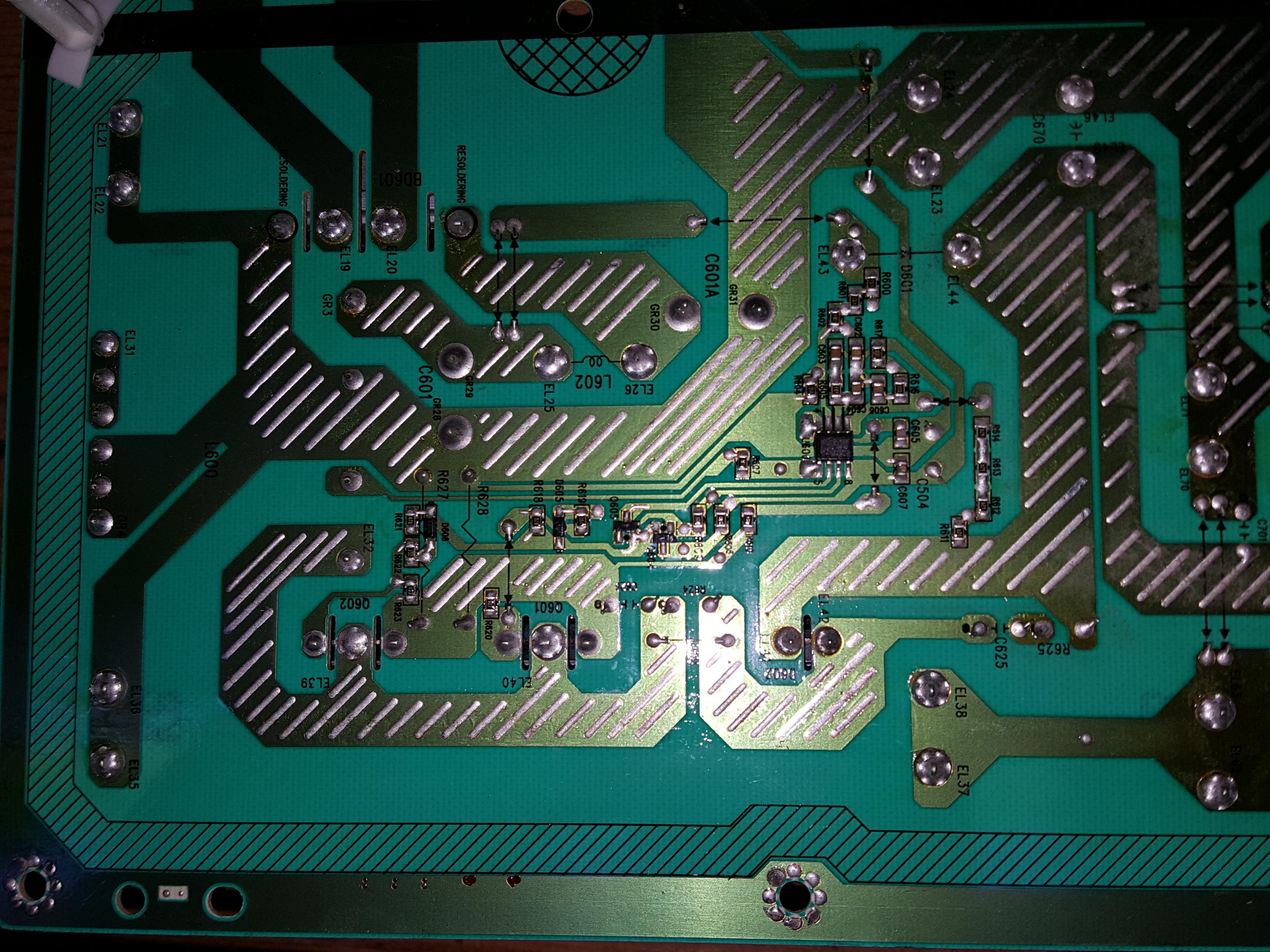

                  Thanks budm... I took 4 pictures.

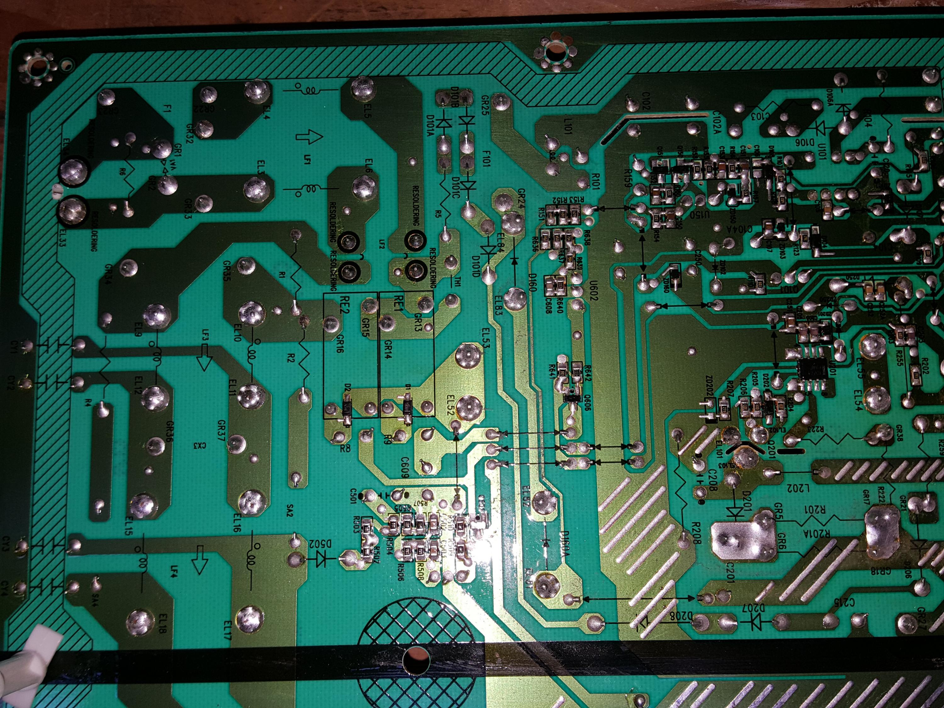

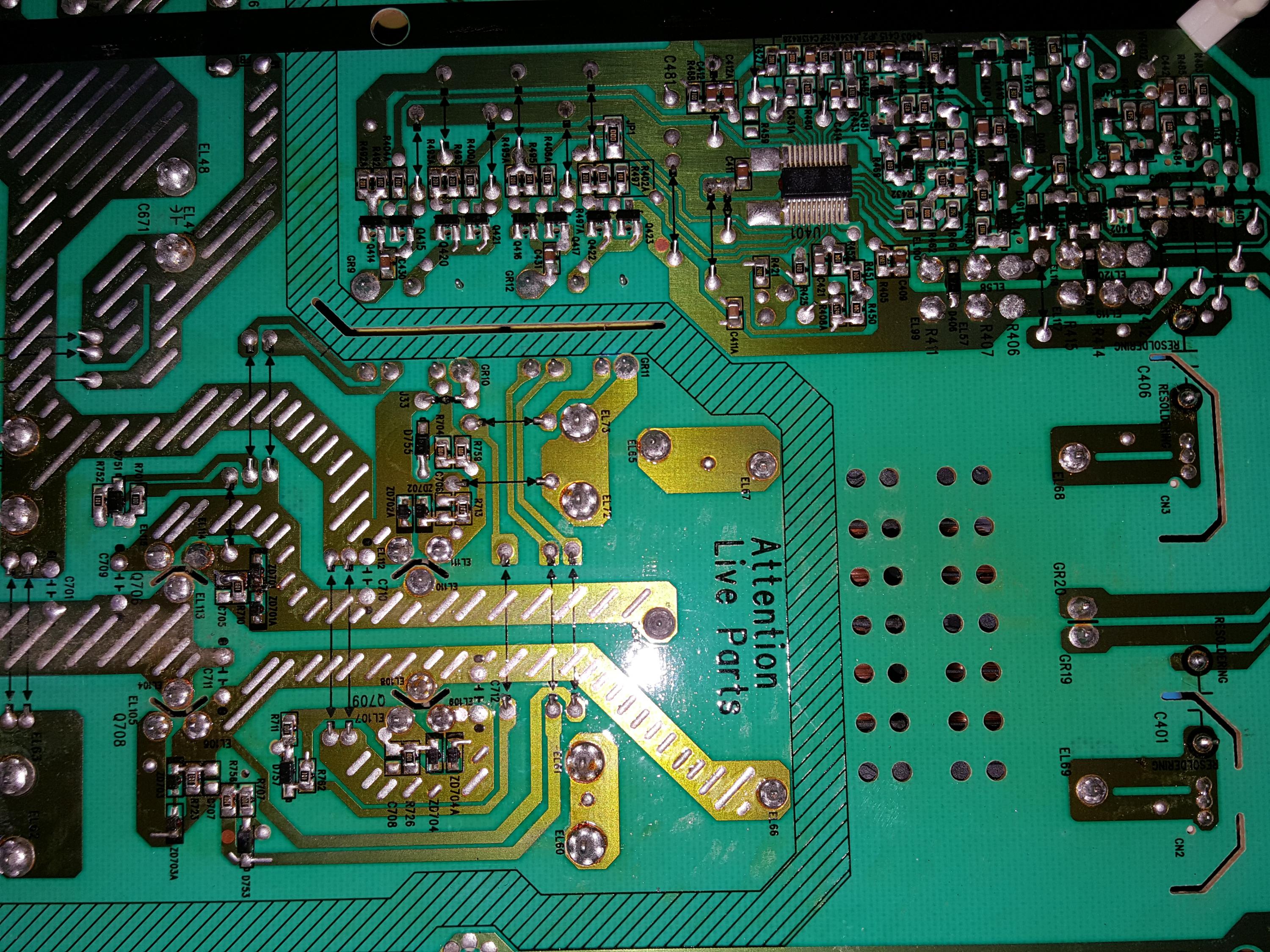

                    Need pictures of the bottom side of the board because they will be SMD type resistors connected in series in the PFC feedback section..
                        Hopefully... All that's needed are the capacitors replaced... thanks for checking the board out.
                          Well over 99 percent that all you need is a new cap(s).
                          AFAIK, most if not all pfc controller ICs will shutdown with overcurrent detection, the type that happens when the pfc capacitor is over volted.
                                    I have seen the bottoms of the caps blow out. Almost tear the leads out of the board.
