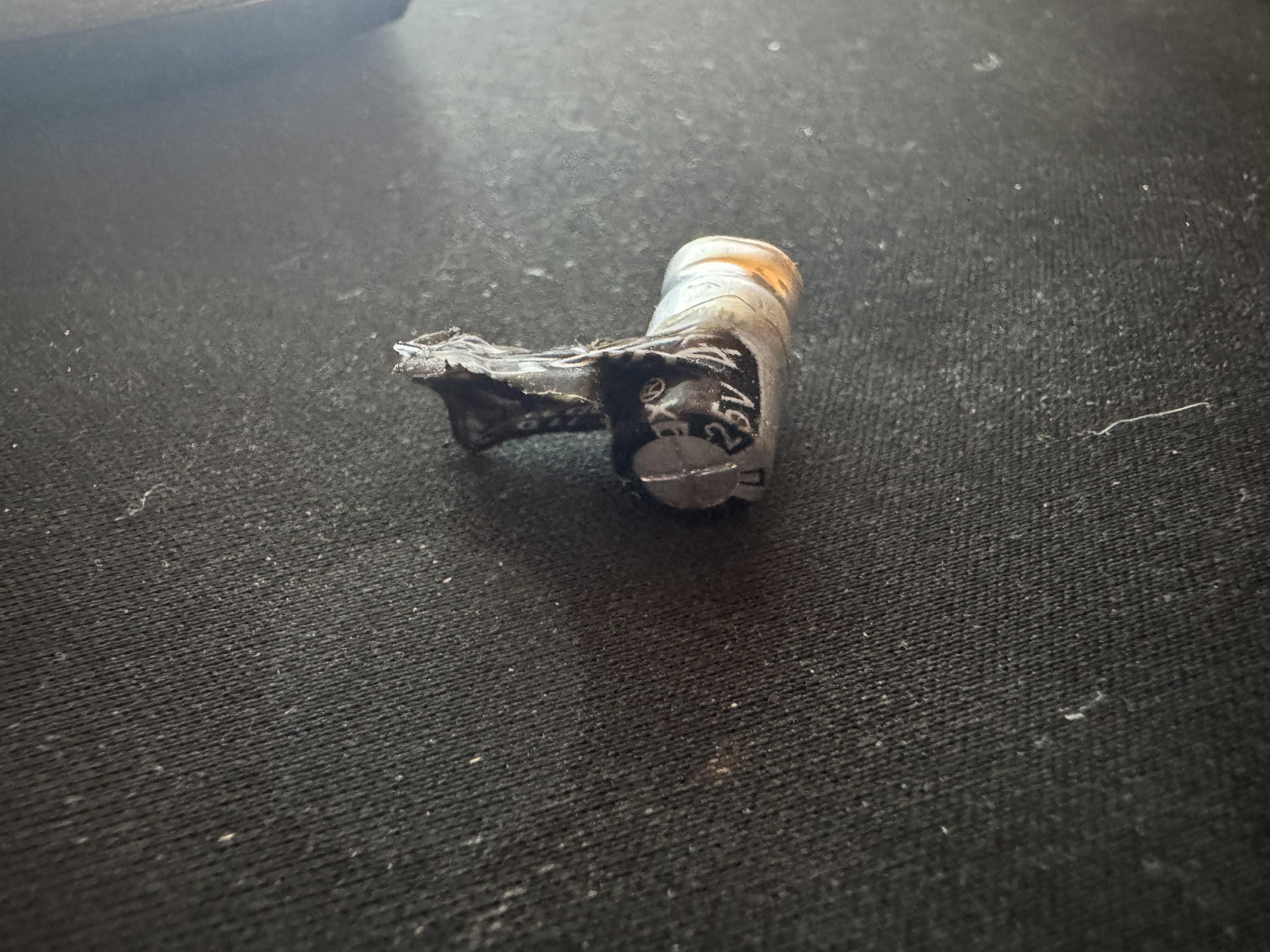

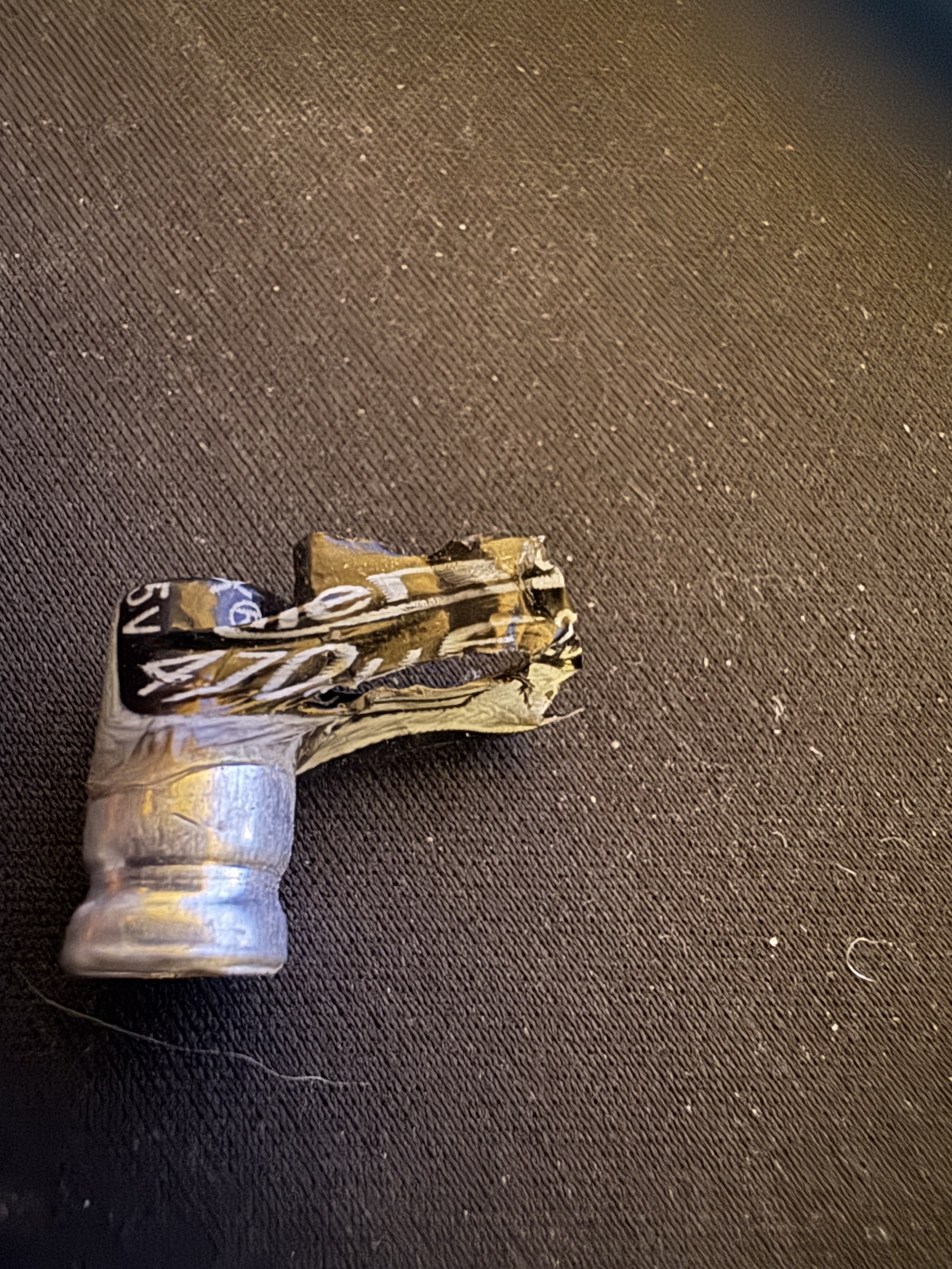

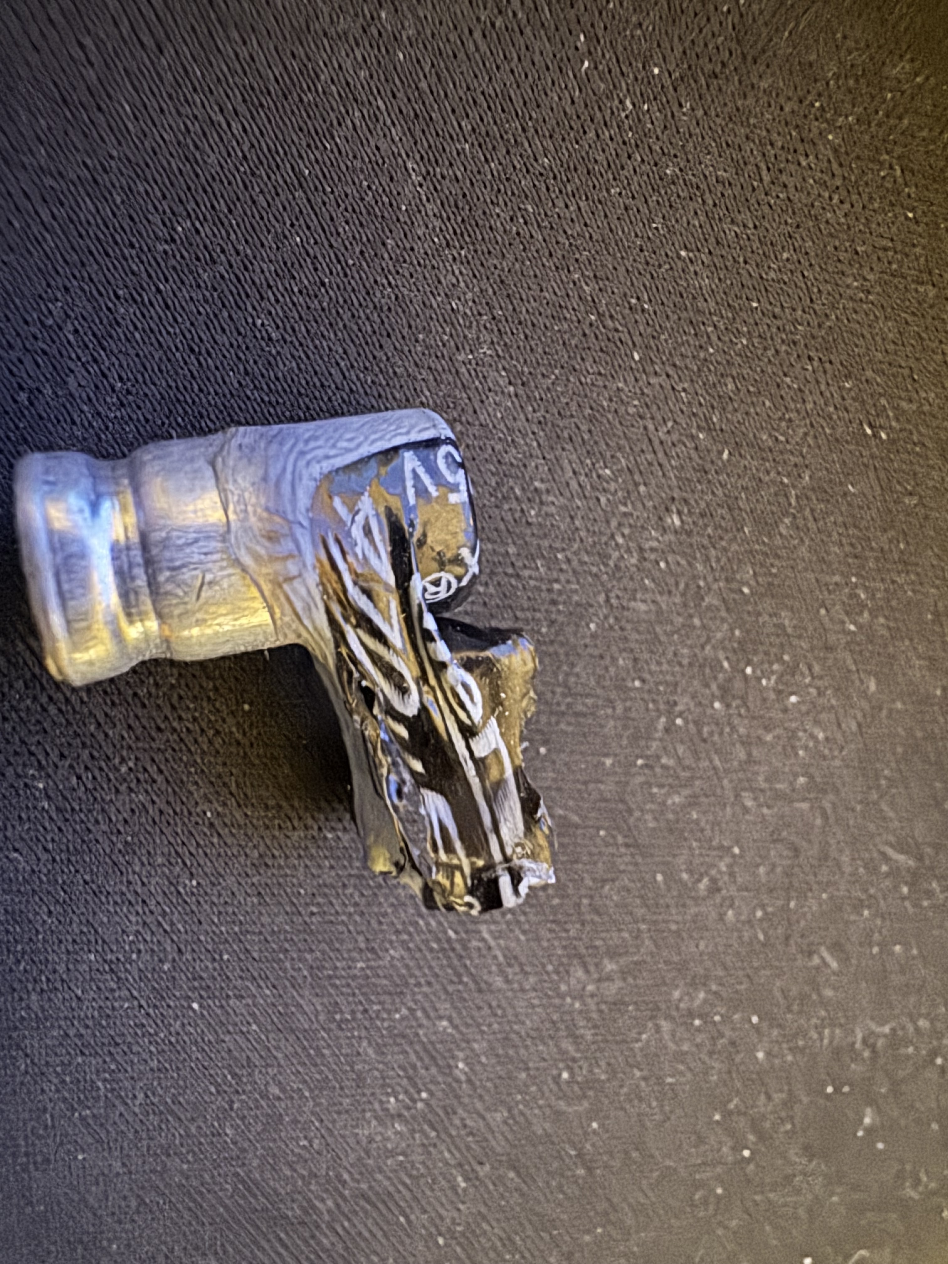

    Trouble reading this blown capacitor
    25V 470uF? Any help would be appreciated! This was in an Adam A7X speaker. I replaced with a different uF and voltage closest to the values I thought because it is all I had in stock. It restored the speaker to working condition but it is certainly not what I needed to do as it is putting out less volume than its sister speaker which presumably no issues.

    470µf / 25Volt

      Originally posted by R_J
      470µf / 25Volt
      Thank you for confirmation. Unfortunately this will mean a specialty order but one that is necessary! Thanks again!

        I'm sure whatever you replaced it with is fine, you likely have other problems than just this cap, for a cap to blow like this is usually reversed polarity or too high a voltage or it internally shorted.

          well the voltage ends in 5, for safety i would call it 35v
          specially in audio.

            Look at the last picture 25V, but 35V would be fine as well
