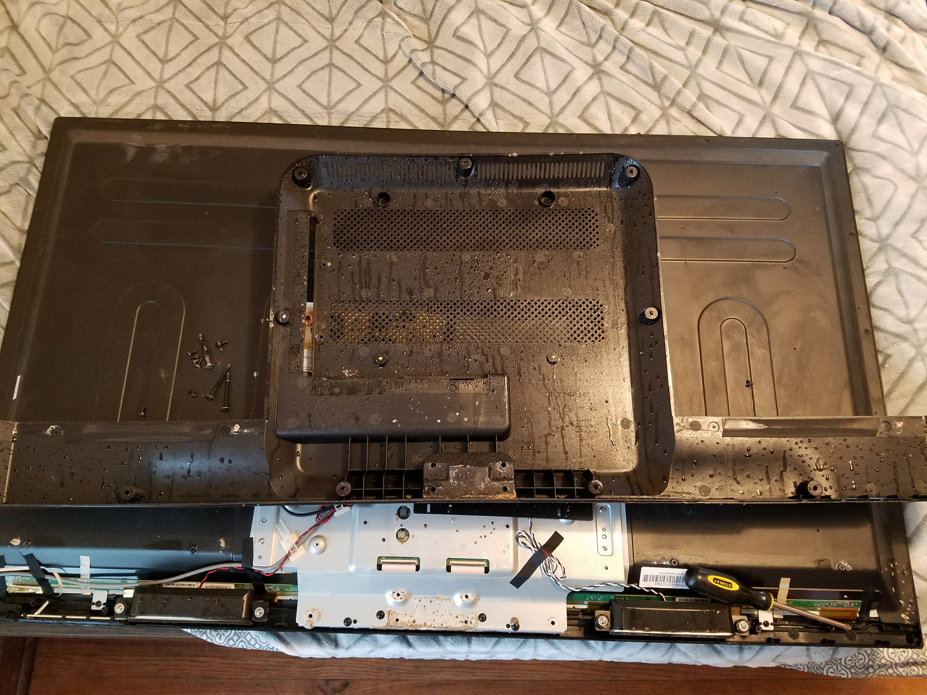

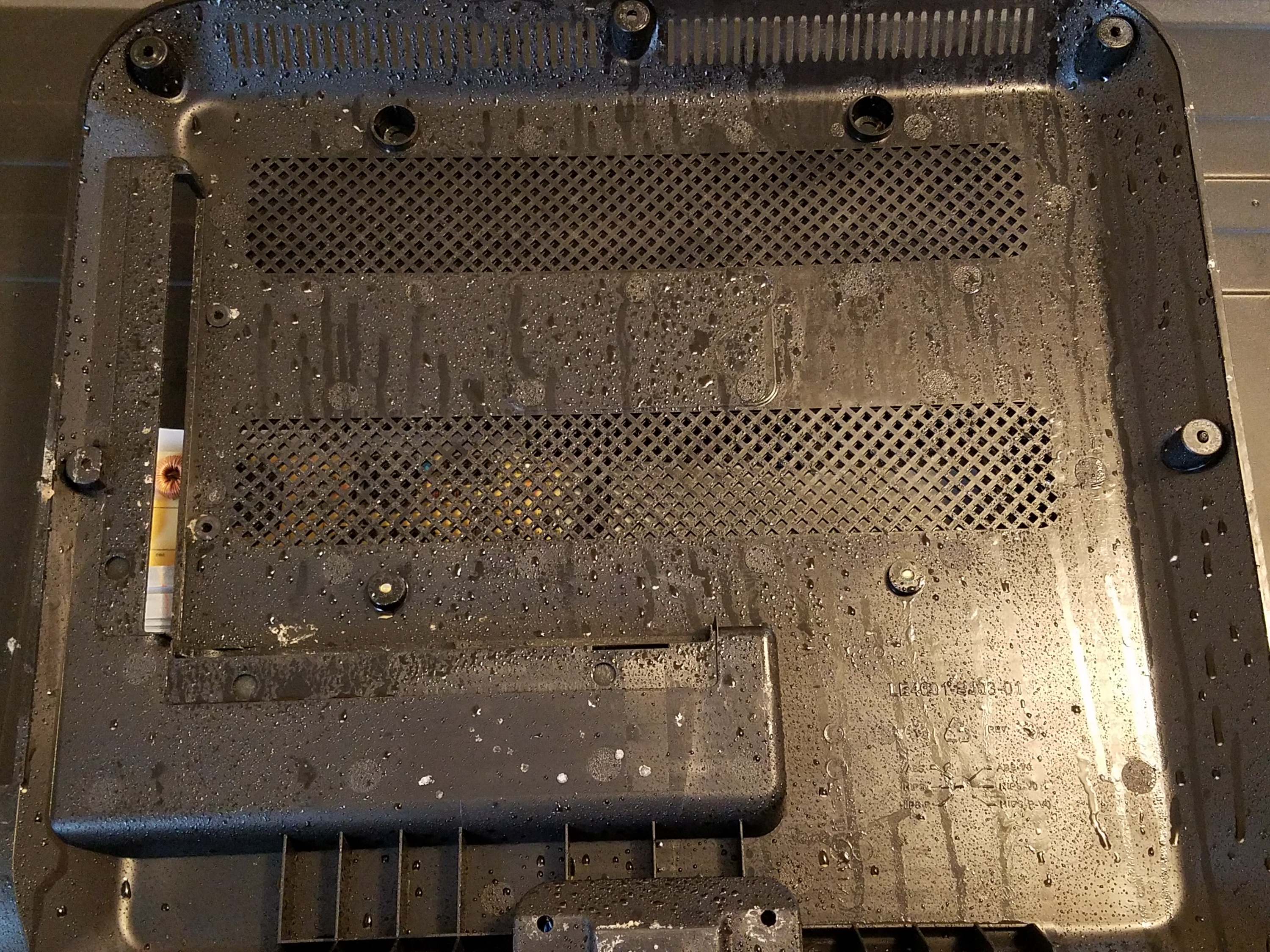

                      Re: Haier LE46A2280 all remotes (any button) cause volume to go up.
                      i don't see any pix?
                      • lookimback
                        • Aug 2013
                        • 1489
                        Oh, it probably helps if I add the pictures.
                        ------------signature starts here------------
                        • CapLeaker
                          Leaking Member
                          • Dec 2014
                          • 8325
                          eww! looks like some one tried to clean the tv and used too much water / cleaner that ran down.
                          • lookimback
                            • Aug 2013
                            • 1489
                            I asked her if she spilled something in it, or sprayed it with anything. She said no and she bought it new. There's places where the plastic is bubbled too. It sat in a Uhaul storage room for almost 2 years. Steel building and no climate control. That probably didn't help.

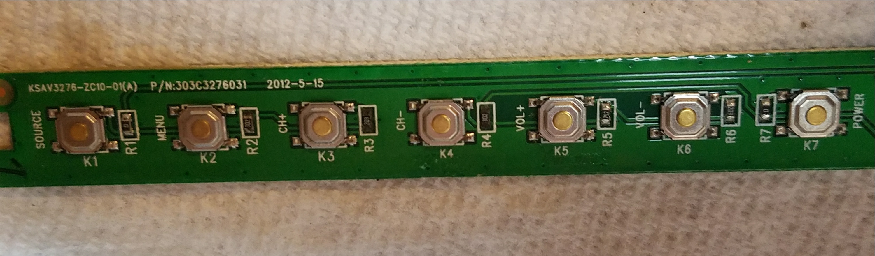

                              I am almost certain that leaking stuff got into the micro-switches. Clean up the 'mess, and give the switches a good spray with some ISA and then a dose of an electronic cleaner trying to get into the switches. Or perhaps a change out of the switches. They most likely would be the 2-pin type.
                              • R_J
                                • Jun 2012
                                • 9588
                                Locate the board for the buttons and unsolder the vol up tac switch, this should allow the other buttons to function and prevent vol going up. If this solves the issue replace the tac switches
                                If there is any of that goo on the switch board wash and dry it.
                                • lookimback
                                  • Aug 2013
                                  • 1489
                                  I removed that board completely yesterday. Still doing it. I'm going to pick the TV up in a few minutes and then I can do some actual testing. Below is a pic of the switch board. I definitely see some bad resistors. As for the switches, I have some of them, brand new, because I needed one for my car alarm remote once and ordered like 25.
