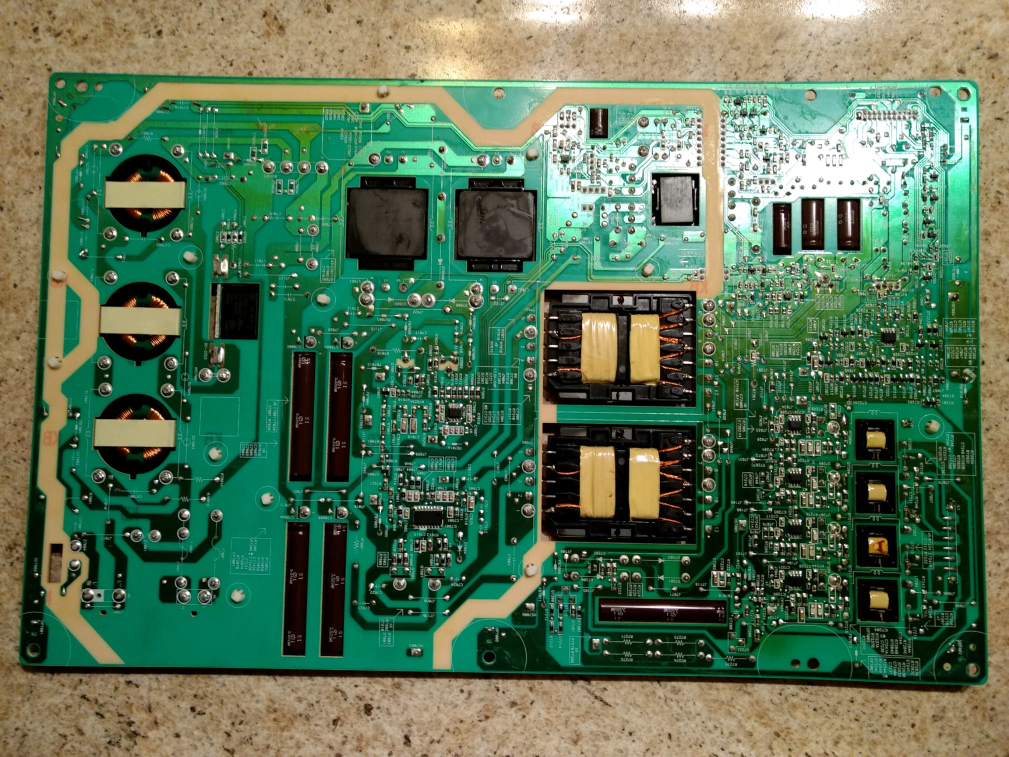

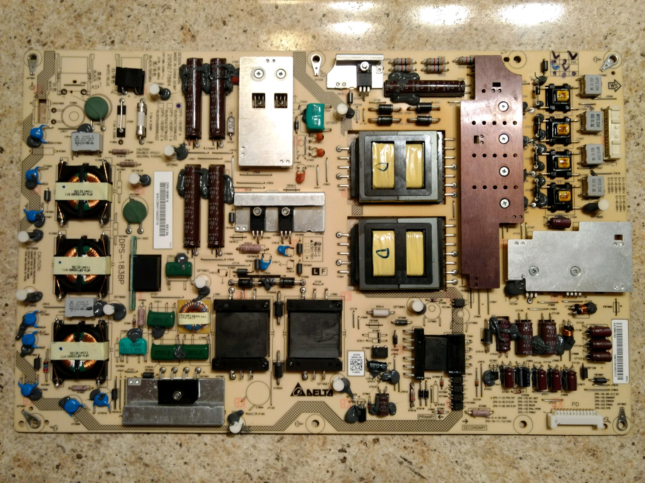

      Re: Sharp Aquos lc-60le831u question about LED's
      Can we see the pictures of both side of the power supply/LED driver board?
      Also need to see how many wires there are on the LED connectors.
      The Voltage will jump up high if it does not see the load so the protection circuit kicks in and turn off the Voltage booster circuit.
      • DXseekerMO
        • Feb 2018
        • 1119
        • US

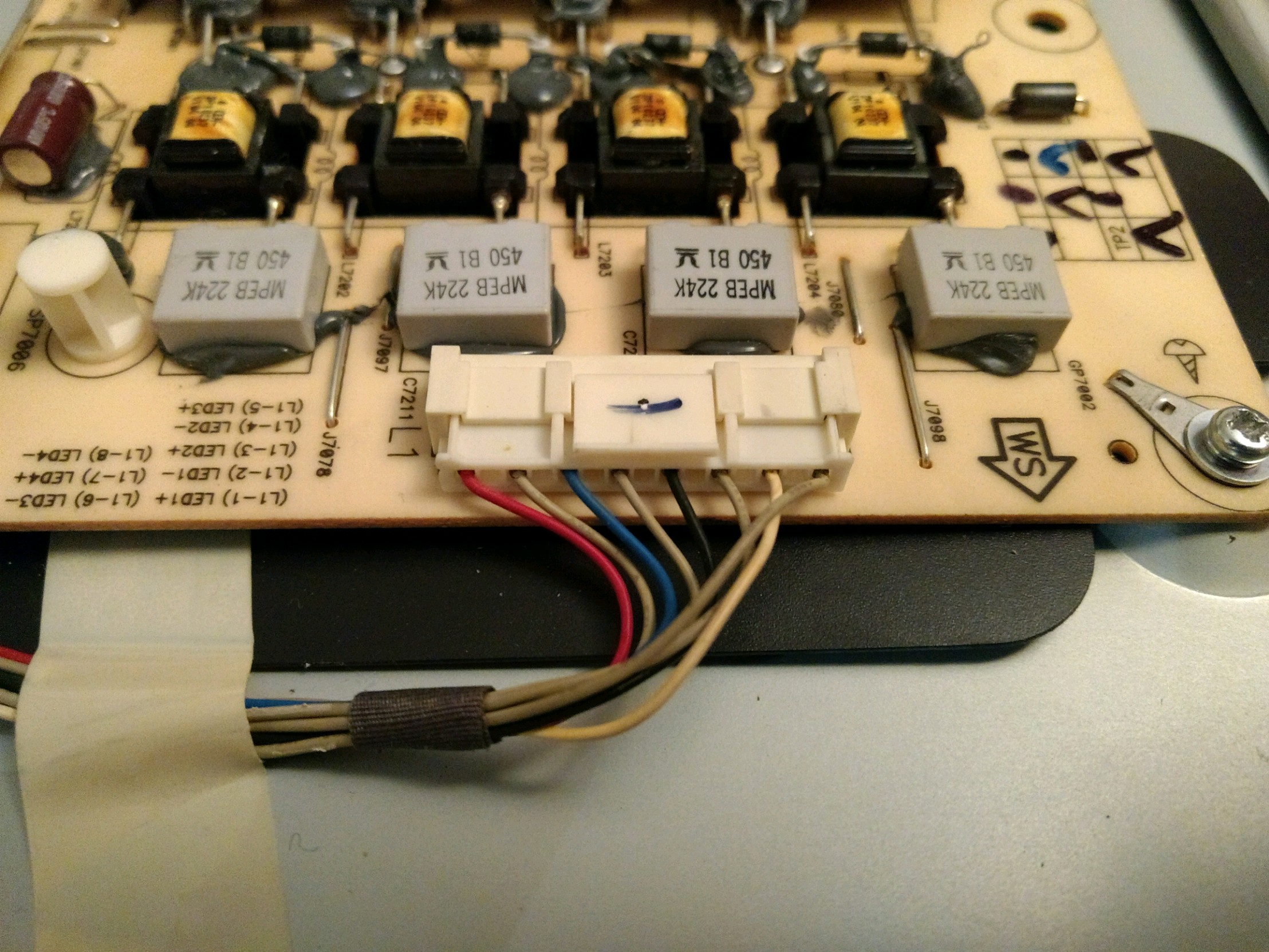

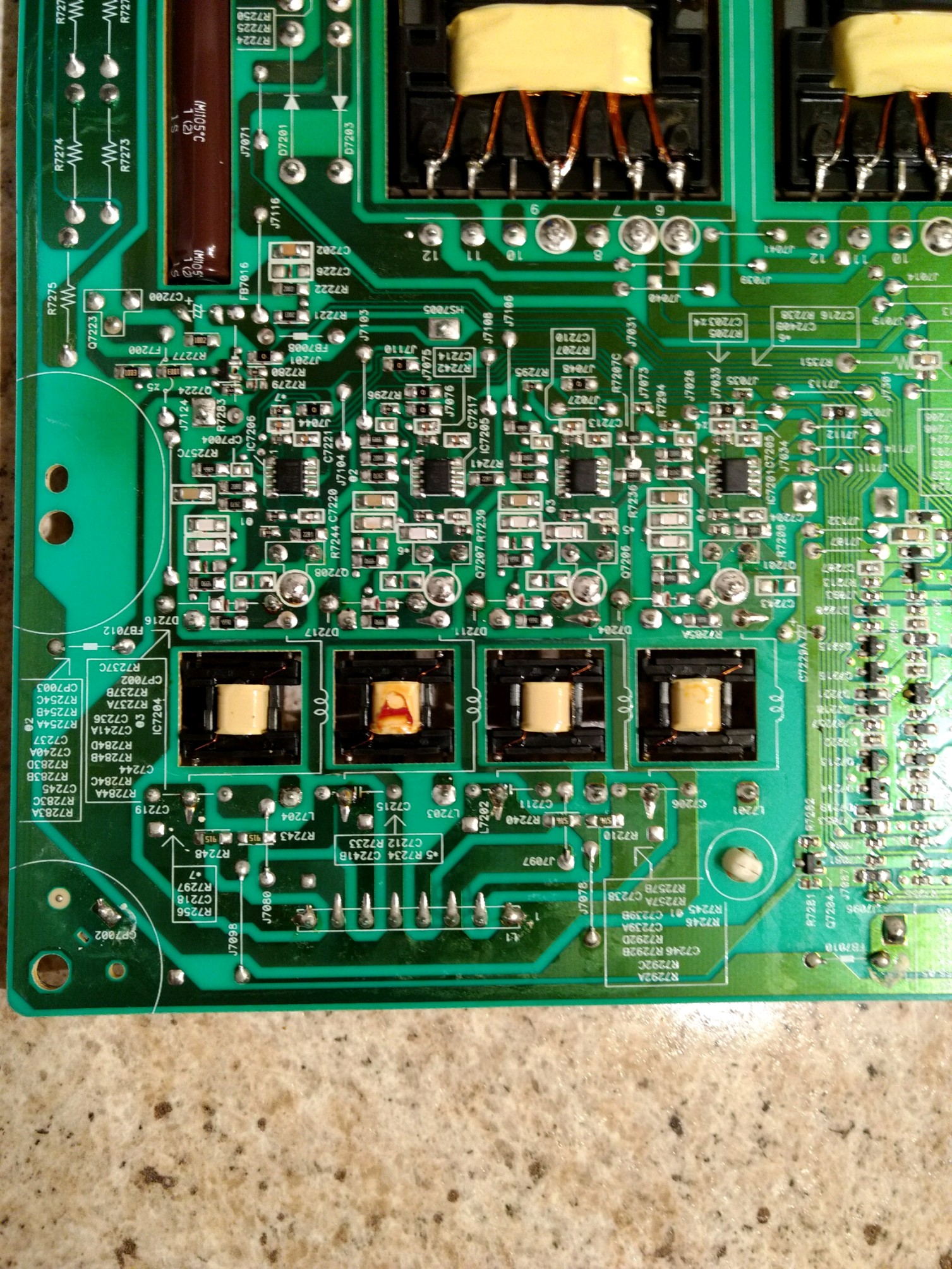

        Sure thing, here's pix of both sides of the power supply. I took close-ups of the backlight inverter area on both sides and a picture of the plug for the back light.
        I checked voltages at each pair of wires. They all come up to 202v or so, except for the blue wire and the tan to its immediate right, it only seems to come up to 178V or so.

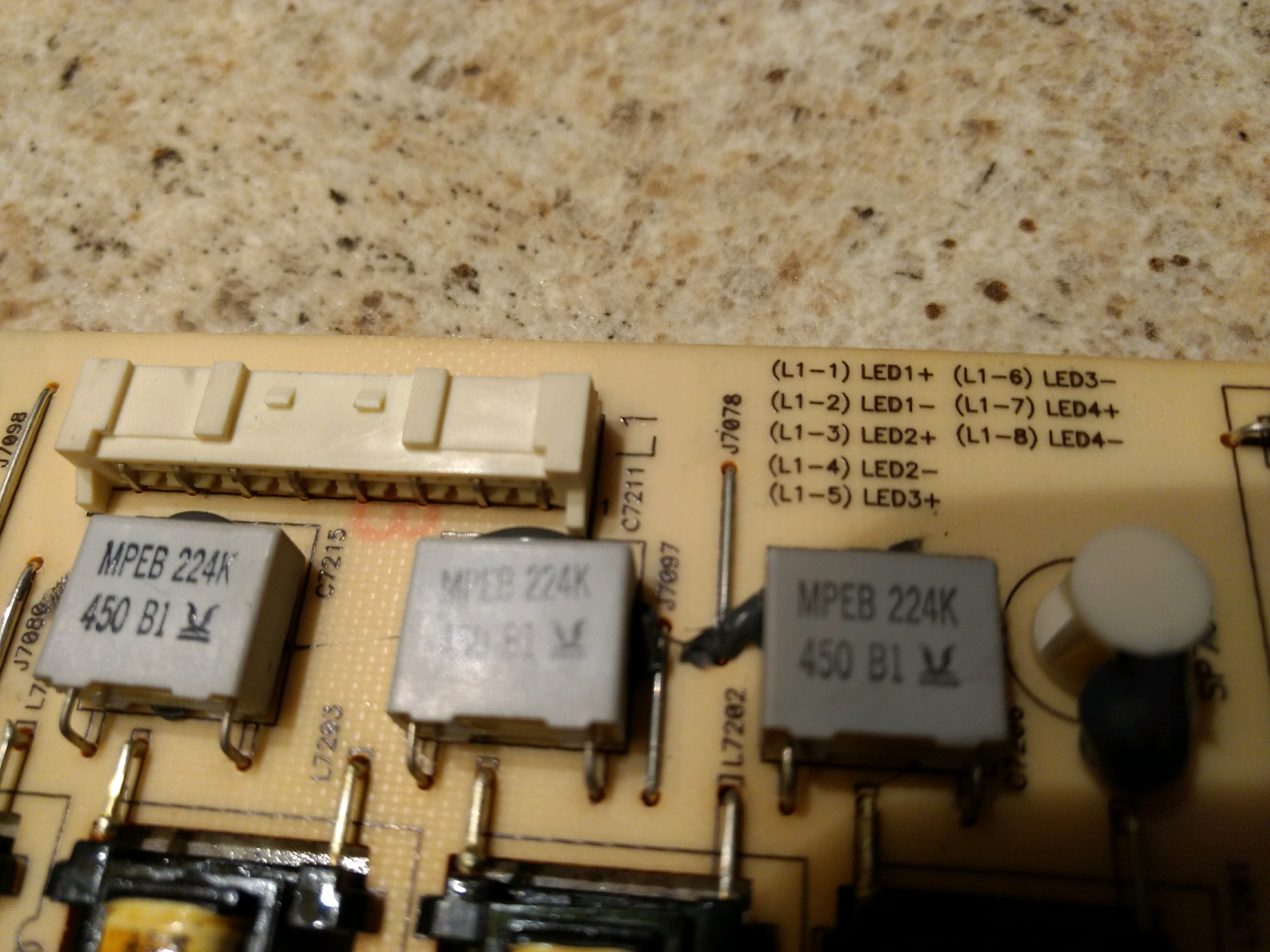

          OK, you have 4 set of LED strings:
          LED 1+ (Anode)
          LED 1 - (Cathode)
          LED 2+ (Anode)
          LED 2 - (Cathode)
          LED 3+ (Anode)
          LED 3 - (Cathode)
          LED 4+ (Anode)
          LED 4 - (Cathode)
          So what do you have on EACH pin every time you turn on the TV?
          1) TV off.
          2) Keep Black probe on the chassis, then red probe on each pin at a time then keep an eye on the meter to see how high the Voltage jumps up to when TV is turned on and then wait 5 seconds to see how low it goes down to.
          3) Turn TV off.
          4) Move red probe to other pin and repeat step 2 and 3, and so on for the rest of the pins.
          5) Report the readings.
              All 8 pins must be checked with ref. to chassis GND.
                  LED set # 1 and #3 look suspicious, especially on #1 looks like it may have some shorted LEDs. LED tester will sure come in handy since it will show the Vf (forward Voltage on each set of the LED strings then you can really compared the readings.
                  One way to find out too is to swap the LED # 1 pair to see if the reading will follow or not, same for set # 3.
                  All the L+ pins for the Anode of each LED strings are tied together and fed by the LED power supply.
                  The (-) pins are the Cathode return lines for the LED strings, each one with its own return circuit.
