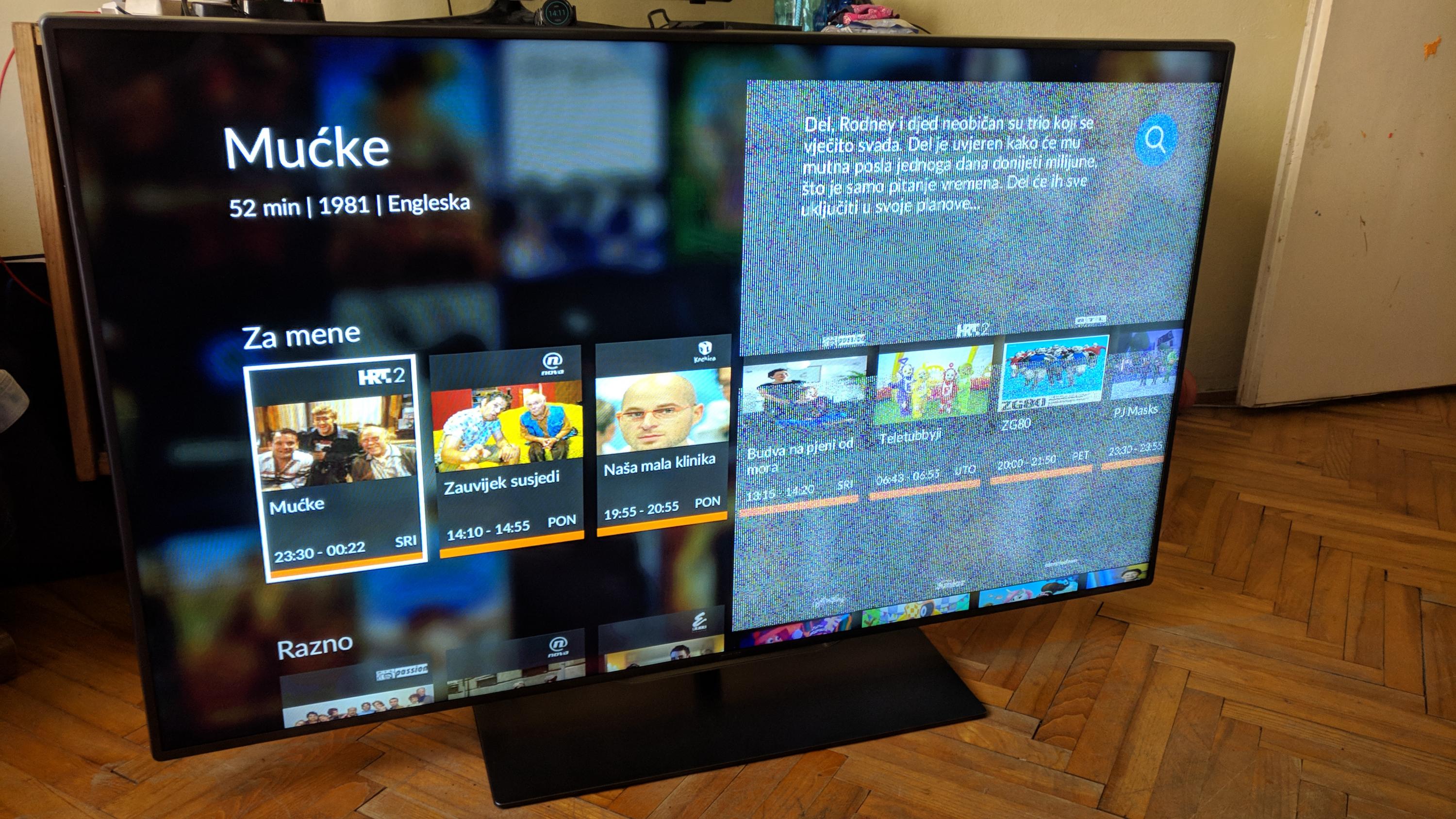

    I have Philips 55 LED TV ( 55PFL8007K/12 ) and few days ago it started with some problems.
    First, when I turn it on first few minutes picture is slow ( audio is ok but picture hangs ).
    Also, on right side there are tiny lines which are showing at moments ( not constantly ) and edges flashing .
    When picture get back to normally , flashing on the edges stops, but sometimes ( every few seconds, depends if picture is static or it is some motion ) lines only on right side shows .
    Is it maybe T-Con module, main board or something else ?

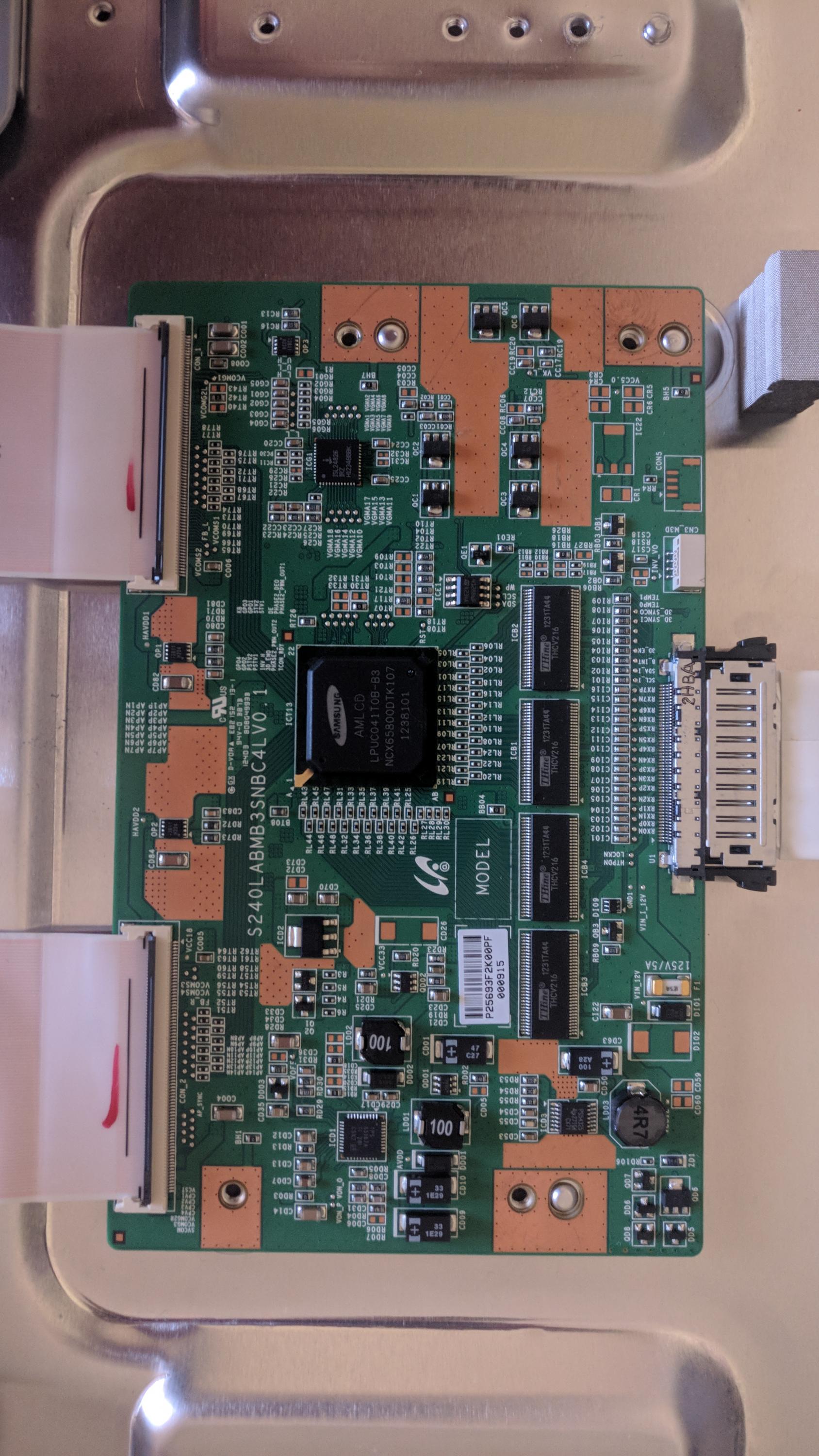

    Sounds like a T-CON Bd problem. Could we get clear, focused close up shots of your T-CON Bd?

      Yes, I uploaded it here :
      https://ibb.co/i3n0UH

        Situation update:
        Today, after 3+ hours after I powered on TV and let it work , all lines gone.
        But, when I turn it on in the morning it not shown any picture first half minute and then just slow image motion.
        Maybe heating up board will help ?

          Clean and reseat all cables to and from the T-CON Bd. I could not connect on the link to view the picture. The Level Shifter IC and associated components would be the components of interest as the lines would be generated from here.

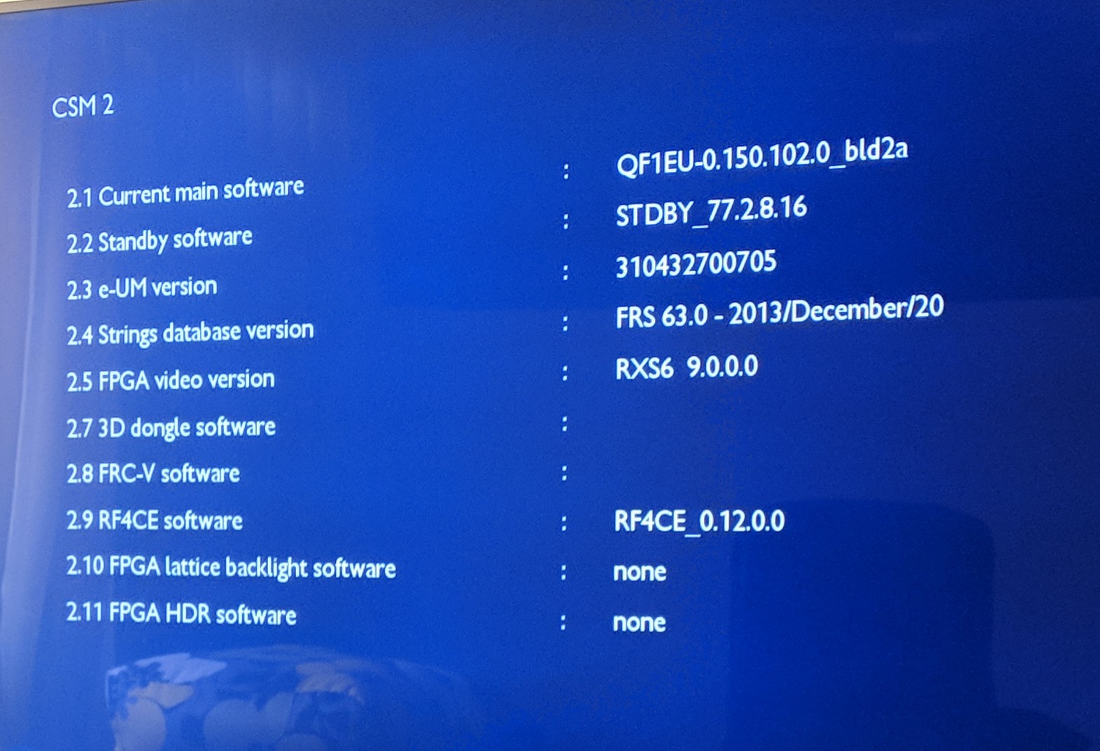

            put your Pfilips in TV Mode , and open CSM customer service menu platter down round 2 pages you find the firmware version write down here yours version. you can make hard reset too at the same menu. how just after TV mode push with RC 123456 the CSM will open.
              Already reseated all cables from board and T-con (and cables from panel to T-con ) but that did not solve the problem.
              Picture of Tcon and all data from CSM second page are in attachment.

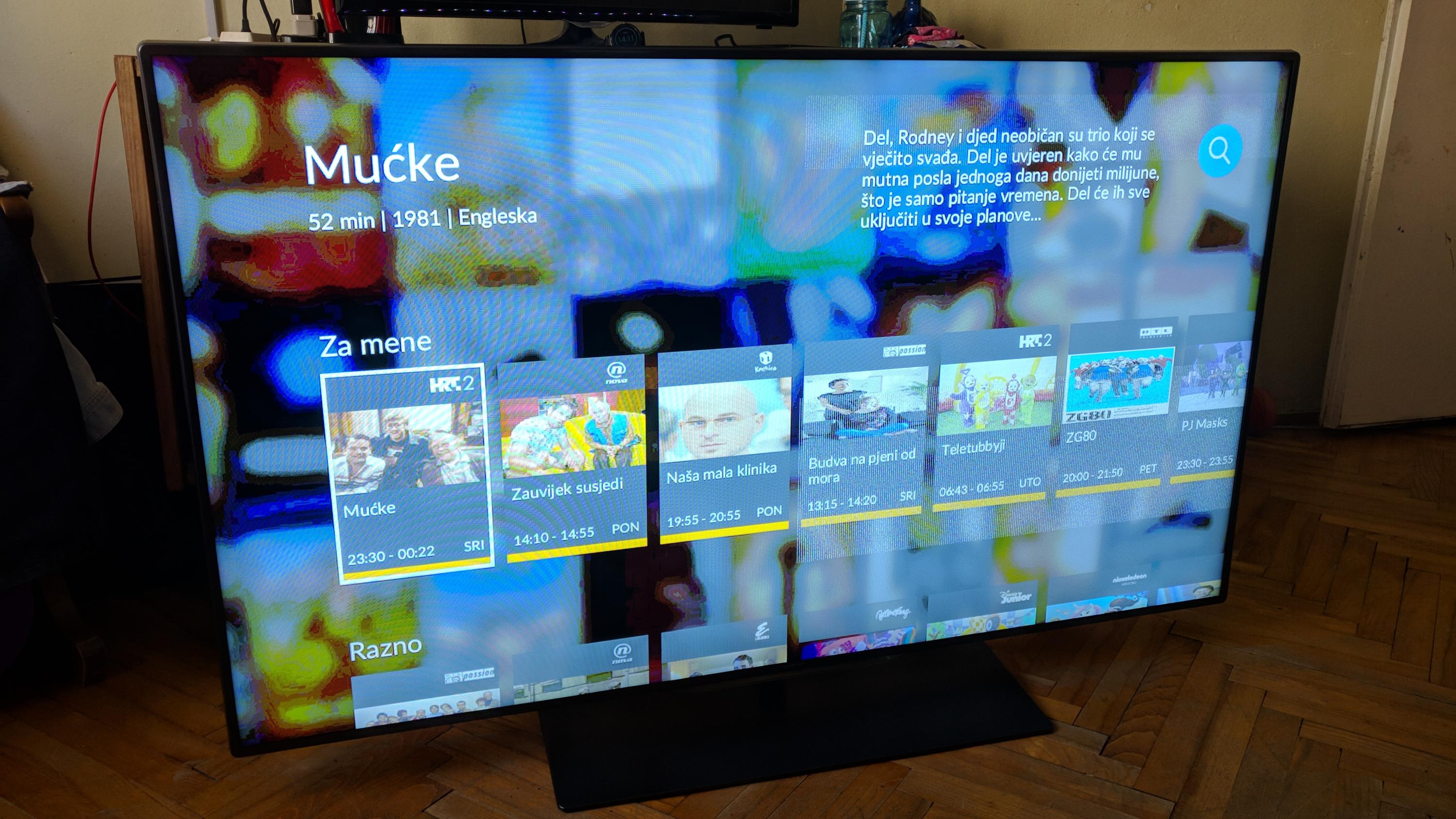

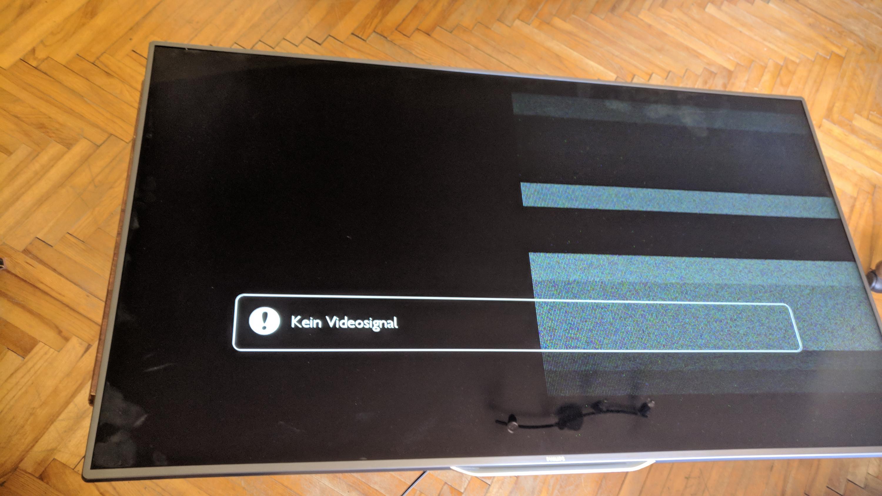

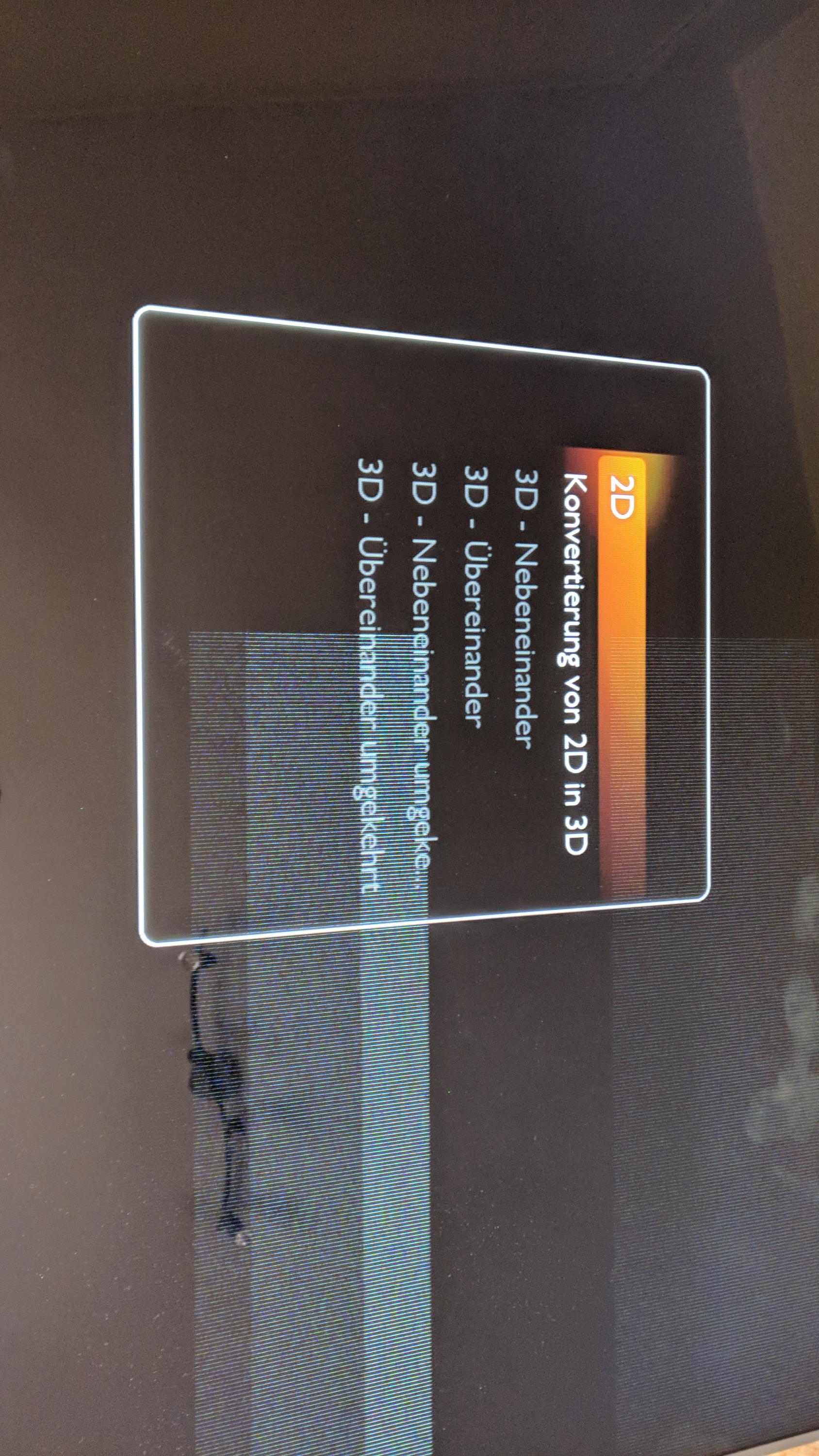

                          I described the issue in first post.
                          Photos are in attachment - First two are from yesterday when I power on TV , last two are from few days before ( only lines are visible )
                          I have a video, but dont know where to upload it so you can see it.
                          Problem is that that today TV is working fine after 3 hours of being powered on.
                          Maybe there is need to heat some parts ?
