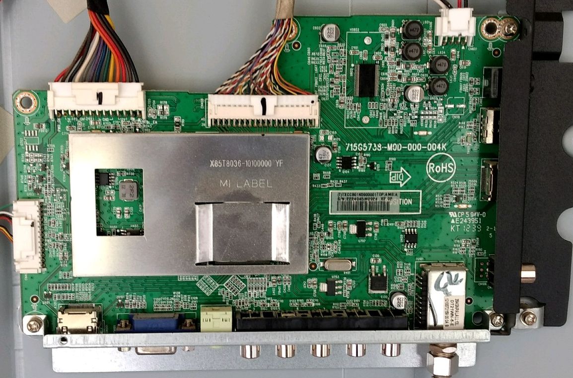

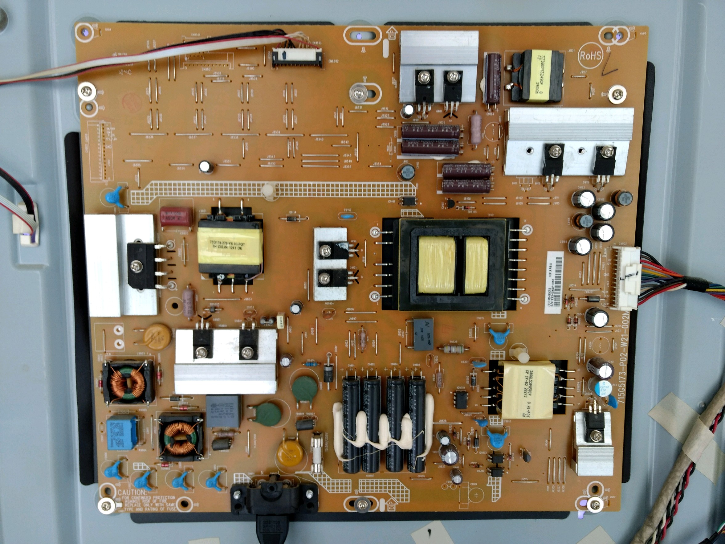

            Re: Insignia NS-46E340A13, no sound with 75ohm, turns itself on
            Board pix if that will help?
            I pushed the power button then unplugged the IR/button board and the set still powers itself on.
            Also tried a moderate amount of heat on the main board with no change in sound.

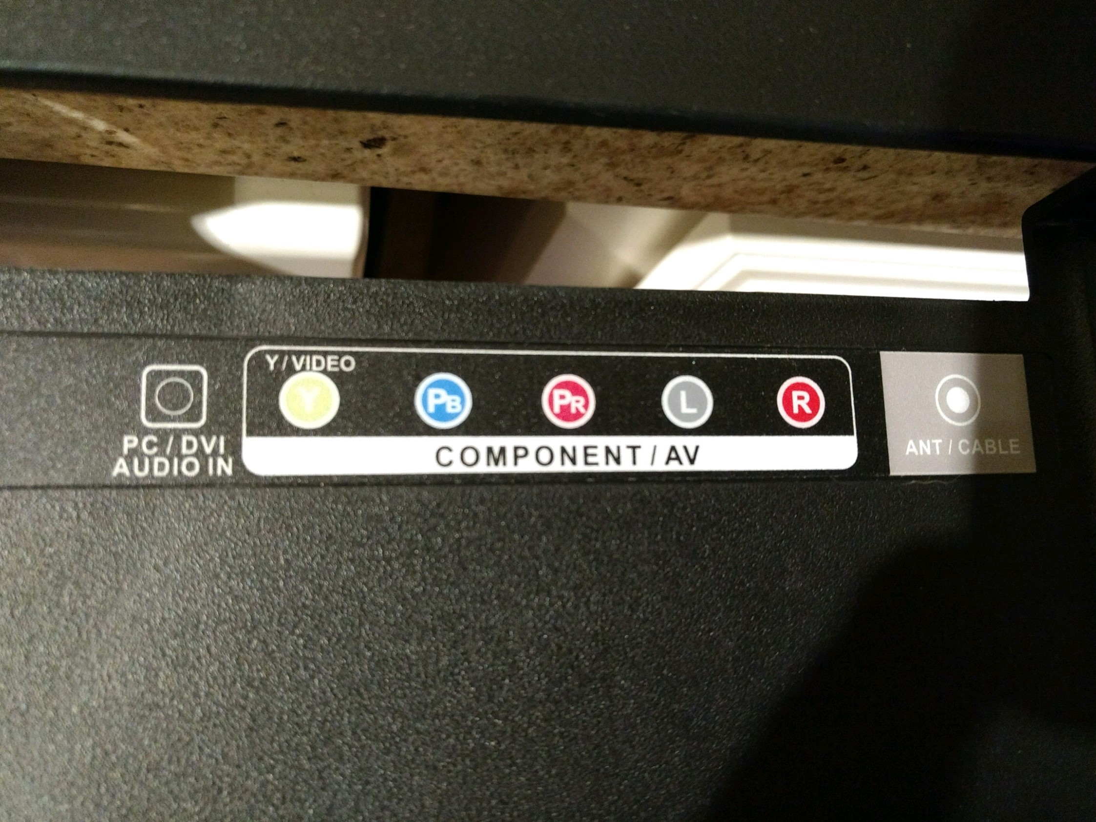

                    The 12V is OK because you do get sound with HDMI input.
                    Does this TV have RCA (RED/WHITE) audio line out?
                      Thanks for the reply budm, here's a pic of the RCA jack ID's. Never seen Pb and Pr, would those be outputs? I plugged the converter box I use for DX'ing in to the L, R and video jacks and it had sound/video.
                            Those are Input for Component Video + L/R Audio.
                            At this point it seems to be something in the audio Tuner section since you were able to get the Audio when switching the SAP.
                            It may be FW problem. I believe these day Insignia are made by Hisense.

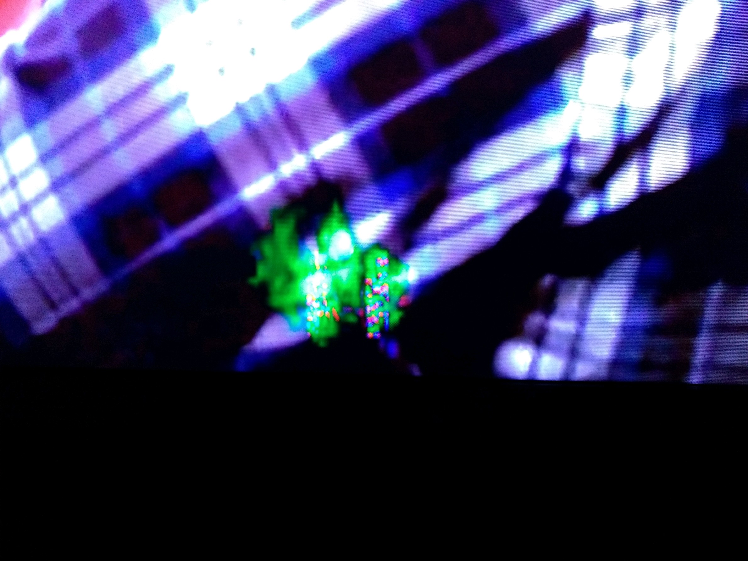

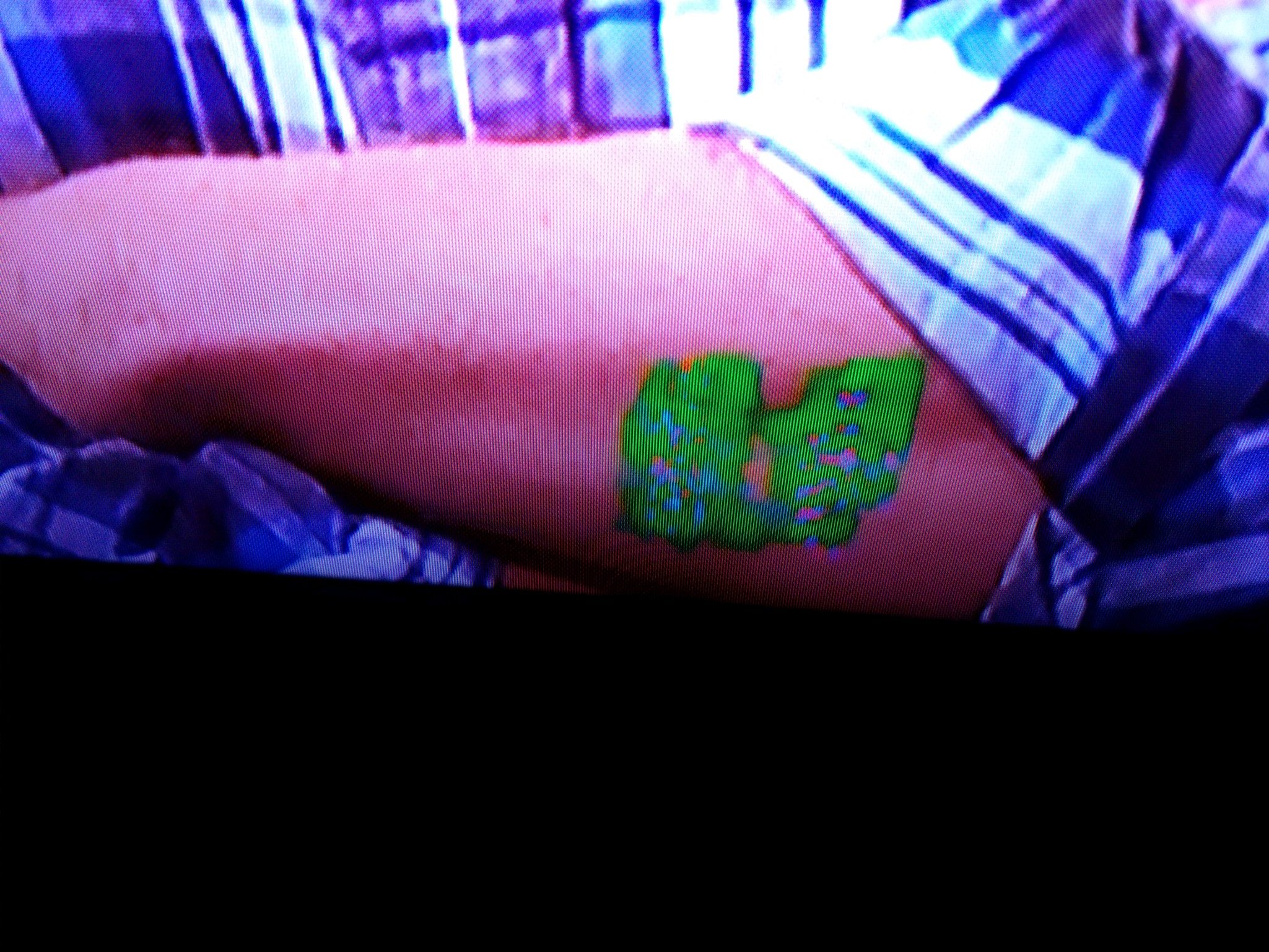

                                      Just in case it's related this artifact shows up after the set is on for a while. Change the channel and it disappears then comes back after a while. The picture seems a bit grainy at times too.
                                      It's got some gremlins.......
