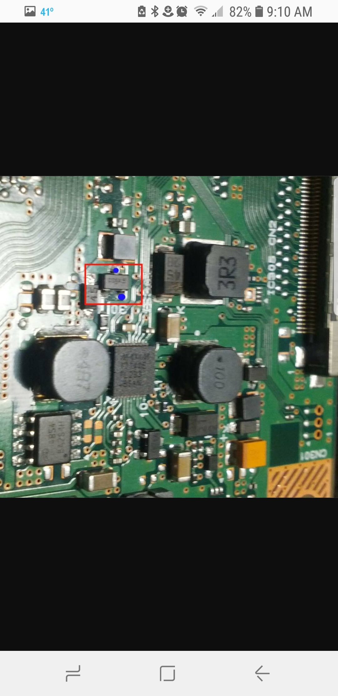

        Well, the part came in late yesterday.. Didn't have time to do more than to throw it on and power up the TV..
        All I got was a backlight.. Nothing on the display..
        Is there a way to use a voltmeter to check the TCON to make sure I didn't get a TCON that was already blown??

            Re: E701i-E3 70" LED Horizontal Line
            Thanx, NoMore...
            Yea, it looks like this TCON board has a blown component.. No voltages on any of the points..
            Is there a way to test the viability of the component itself off of the TCON board?? As I mentioned, I have several of these boards. If I can confirm a quality component then that might help me fix a TCON...
                No need to check this transistor off the tcon board if it is bad it will read that either way on or off the board. Transistor operates the supply voltage to the PWM. Without it, there is no dividing of the voltages for the panel to. Function.
                This is what you need.
                QF which is a RTR020N05 2a 45v n channel SOT-23 style mosfet and it goes here. See pic attached
