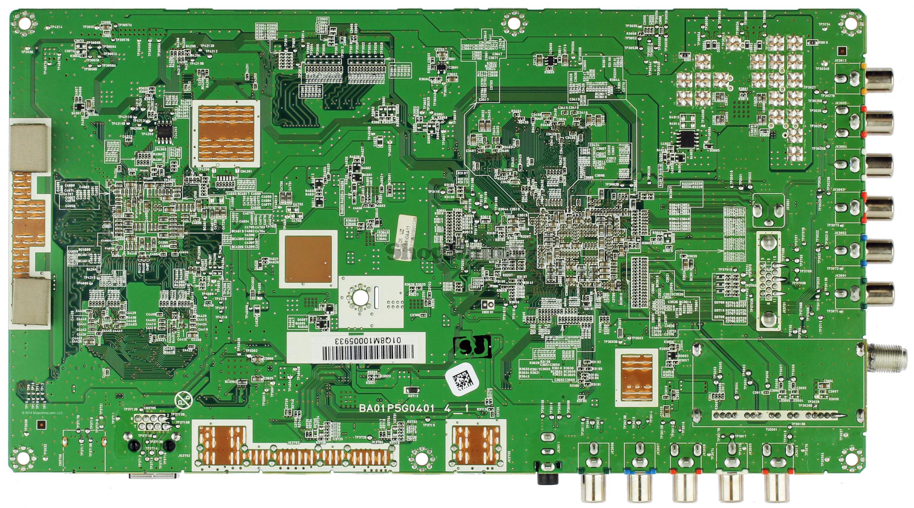

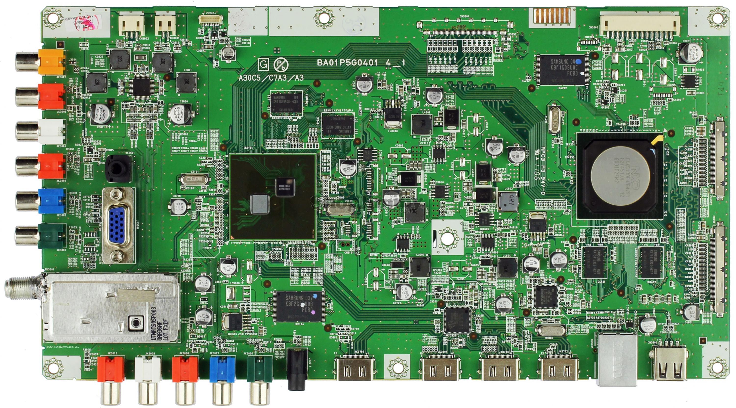

    Tv on bench is a 55PFL5505D/F7 LCD
    Donor tv is 55PFL7505D/F7 LED
    Hdmi ports on mainboard fried,found this 7505 model with identical mainboard with cracked screen.
    Swapped out the mainboard,now picture is upside down and mirrored.

    Question now is: Would it be easier to just swap the eeprom? And then,what chip is the eeprom on this board.
    Or how do I set this up correct in the service menu?

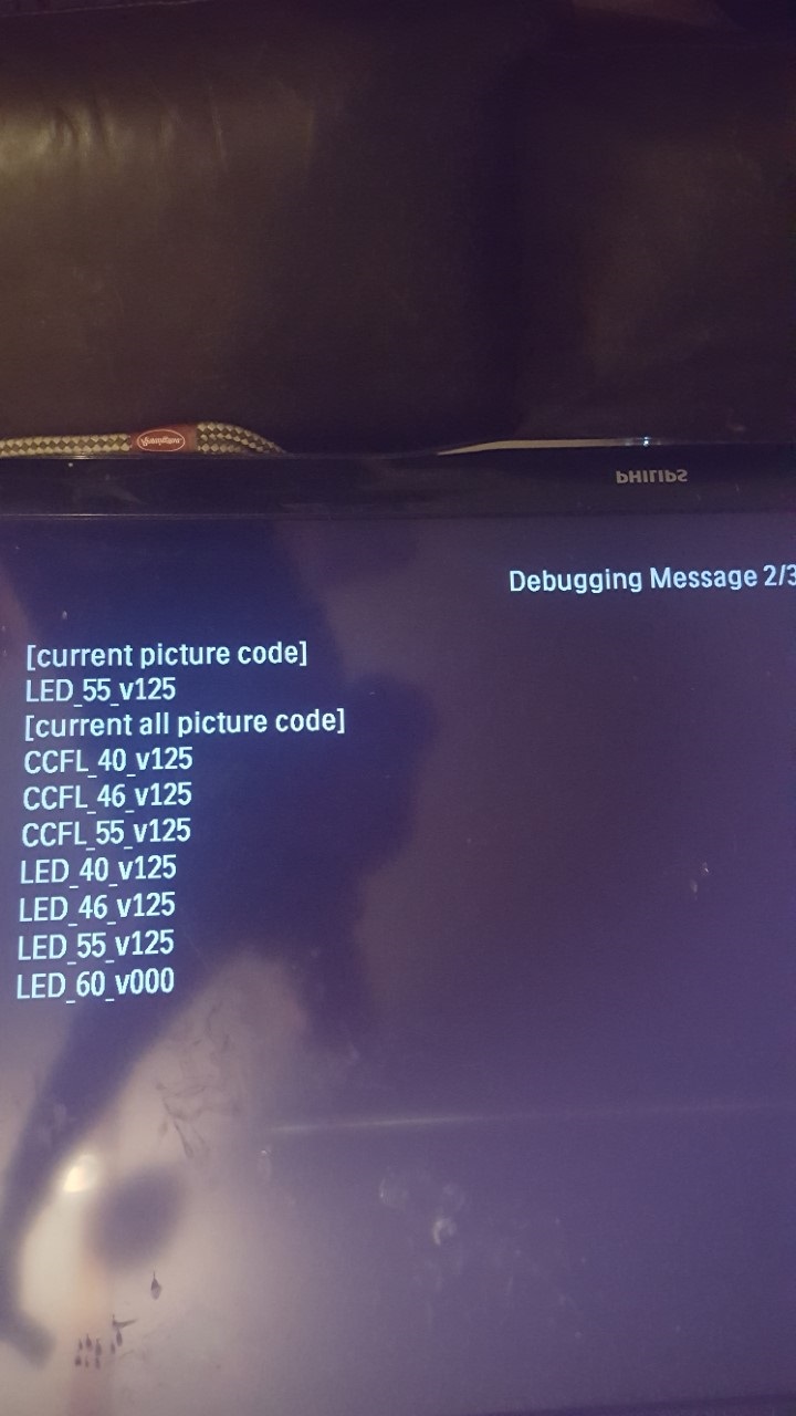

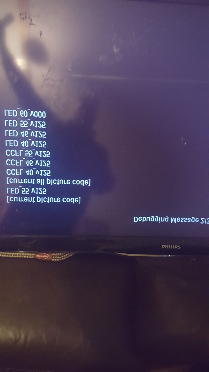

        Re: 55PFL5505D/F7 image upside down and mirror
        So with 062596 info I got into the menu.
        I got to this page (see pic) and it shows the current panel thats selected and then the options you have. I need the ccfl 55" option I'm guessing but I have no idea how to select that one. Pushing random buttons so far doesn't do more then getting me stuck in a color display loop thats almost impossible to get out of.
        I thought I was smart and DL the software update for the 5505 but the 7505 caught on to that and didnt accept the update
        2nd pic I turned it around in paint to make it easier to read lol

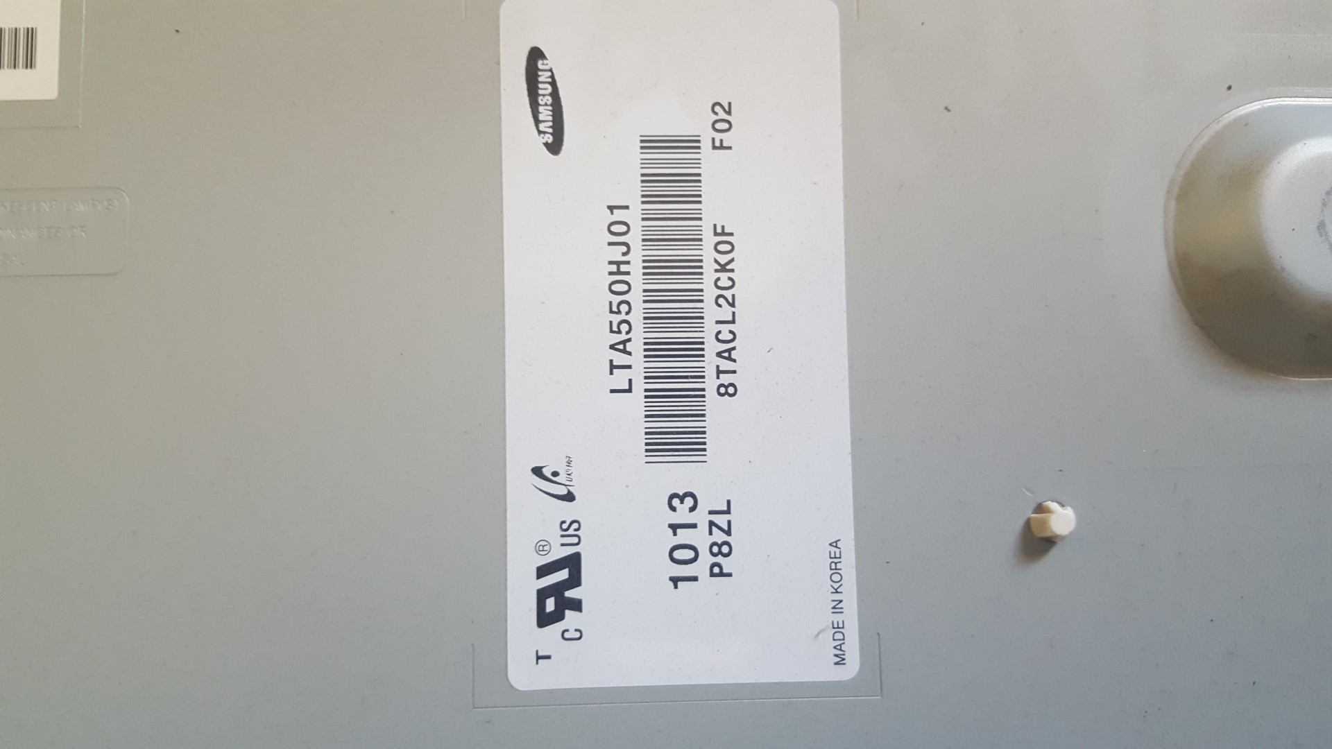

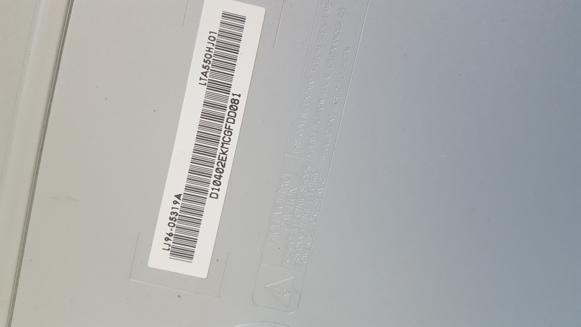

                            These are the stickers on the panel. Hope they make sense to you as they are not making sense to me lol
                                  lcd panel specs link
                                  http://www.panelook.com/LTA550HJ01_S...iew_12171.html
                                      So,I now have this thing stuck in a permanent loop of showing all the colors.
                                      Which IC would be the eeprom,I think the fastest would be to just swap them out and be done with it.
