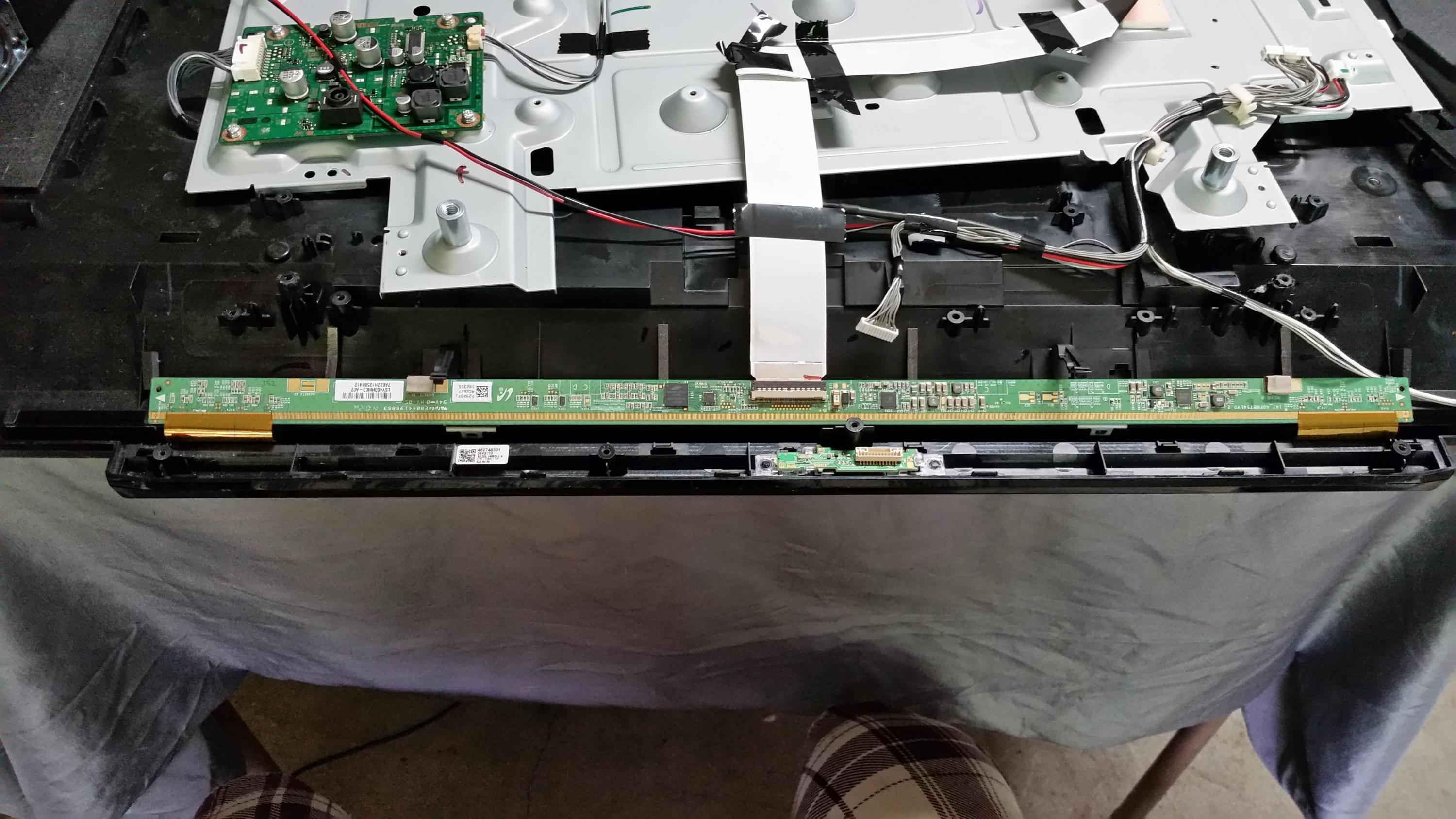

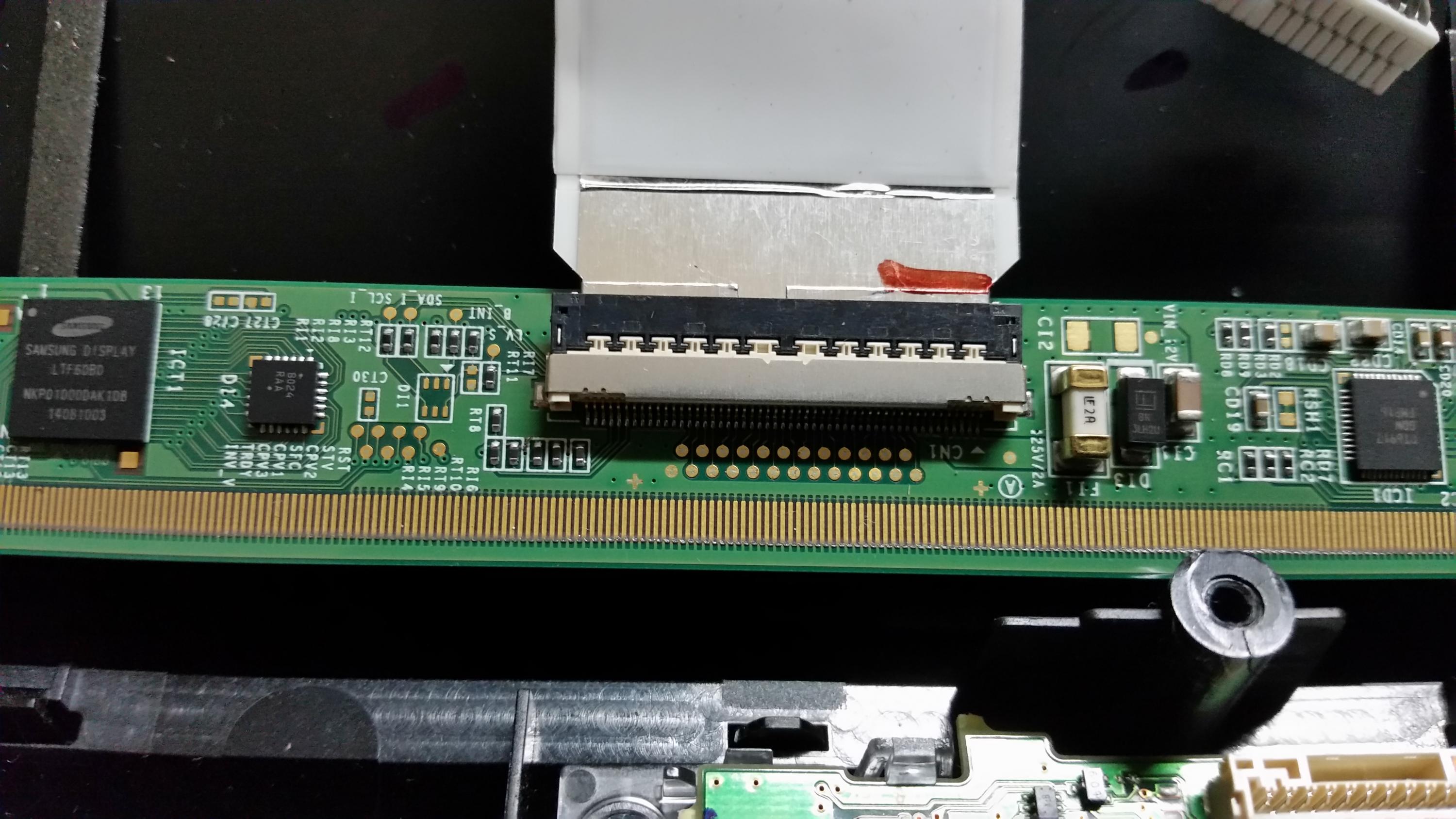

Sony KDL-40W600B blank backlit screen with sound
  • Davi.p
    replied
    Re: Sony KDL-40W600B blank backlit screen with sound
    Ah ok it was the sintax the problem, i can't do better than this sorry
    Leave a comment:
  • nomoresonys
    replied
    Re: Sony KDL-40W600B blank backlit screen with sound
    Originally posted by Davi.p
    Are almost clear, also for a children, test in volt every big capacitor on tcon.
    That's not really English, no matter if it's a child reading it or not.
    Leave a comment:
  • Andrew F. Ali
    replied
    Re: Sony KDL-40W600B blank backlit screen with sound
    Originally posted by budm
    Also get the spec sheet of the IC's so you can check the VCC pin, that is what I do when I do not have schematic of the board, the spec sheet will also have application circuits showing how the IC is hooked up and most companies will used that as the design for their boards.
    Good advice.
    Leave a comment:
    replied
    Re: Sony KDL-40W600B blank backlit screen with sound
    Also get the spec sheet of the IC's so you can check the VCC pin, that is what I do when I do not have schematic of the board, the spec sheet will also have application circuits showing how the IC is hooked up and most companies will used that as the design for their boards.
    Leave a comment:
  • Andrew F. Ali
    replied
    Re: Sony KDL-40W600B blank backlit screen with sound
    If you look carefully at the Integrated T-CON/Driver Bds. The voltage points I asked you to measure are there but under their other names, so it may have been confusing to you. The points to measure are little gold looking dots. The expected voltage and other names of the same test points are in brackets, so here goes:
    1. Vin: 12V (we confirmed as present)
    2. Vdd (Vlogic, Vddd): 3.3V
    3. Vda (Vs, Vsource, Vdda Avdd): 14V to 20V
    4. Vgh (Vgon, Von, Vddg): 20V to 30V
    5. Vgl (Vgoff, Voff, Veeg): -5V to -7V
    Leave a comment:
  • Davi.p
    replied
    Re: Sony KDL-40W600B blank backlit screen with sound
    Are almost clear, also for a children, test in volt every big capacitor on tcon.
    Leave a comment:
  • nomoresonys
    replied
    Re: Sony KDL-40W600B blank backlit screen with sound
    Probably waiting for clear instructions.
    Leave a comment:
  • Davi.p
    replied
    Re: Sony KDL-40W600B blank backlit screen with sound
    A.ALi has told you which tensions to find, i have told you where to test them (very approximately) so what you waiting for?
    Leave a comment:
  • triplefour
    replied
    Re: Sony KDL-40W600B blank backlit screen with sound
    thank you for the clarification... so the tcon can be on this thin "panel board" that isnt replaceable??...what a bunch of cheap bastards!
    its not convenient, but its still possible to troubleshoot and replace components on this board, so i'd like to give it a try
    but i'm still lost as to what to check next and how to determine a component on this board to replace to get the picture showing!
    you have seen the voltage measurements i made in the last picture of post #6, yes?
    thank you
    Last edited by triplefour; 05-17-2018, 12:32 AM.
    Leave a comment:
    replied
    Re: Sony KDL-40W600B blank backlit screen with sound
    That long board attached to the LCD panel is the integrated T-CON/tab bonding board, it is not typical separated T-CON in most TV, it is money saving panel with non-replaceable T-CON.
    Leave a comment:
  • triplefour
    replied
    Re: Sony KDL-40W600B blank backlit screen with sound
    im getting confused... are we talking about voltages on the tcon, or the "panel board" (is that what its called?)
    im thinking tcon is at least mostly functioning because it sends 12v to the panel board. am i wrong to assume this?
    Leave a comment:
  • Davi.p
    replied
    Re: Sony KDL-40W600B blank backlit screen with sound
    Look for and measure these 'top 5' voltages
    If you don't tell him where to test.... check across bigger capacitors..
    Leave a comment:
  • Andrew F. Ali
    replied
    Re: Sony KDL-40W600B blank backlit screen with sound
    Originally posted by budm
    https://www.badcaps.net/forum/attach...8&d=1522555588
    You will have to trace the V1N_12V pad which is connected to the bottom side of the board through VIAS, and see where it goes and if you are getting 12V on the bottom side of the board or not.
    There will be switching power supplies on that integrated T-CON board.
    As stated there would be Switching Power Supplies on the T-CON Bd. that would take the Vin: 12V and convert that to Vdd: 3.3V, Vda: 14 to 20V, Vgh: 20 to 30V and Vgl: -5 to -7V. Look for and measure these 'top 5' voltages on the T-CON Bd. to produce a picture on the screen.
    Leave a comment:
  • triplefour
    replied
    Re: Sony KDL-40W600B blank backlit screen with sound
    the last image has the voltages i measured labeled on it. 12v on both sides of the fuse. first thing i checked.
    Leave a comment:
  • Andrew F. Ali
    replied
    Re: Sony KDL-40W600B blank backlit screen with sound
    In photo No. 1 to the right see if you have 12Vdc on both sides of the white fuse with the gold ends.
    Leave a comment:
  • triplefour
    replied
    Re: Sony KDL-40W600B blank backlit screen with sound
    any ideas? im stuck
    Leave a comment:
  • triplefour
    replied
    Re: Sony KDL-40W600B blank backlit screen with sound
    it took some work getting to the underside of the board, but there are no components there. theyre all on the top side. last image has some new voltage measurements i took now that i can get at more of it.
    i see a lot of 0v with a sprinkling of 12.5 and 5v here and there...the pins on ICD1 are too close together to get my probe on them without bridging pins, except for the ones on the edges. so i tested all those. they were 0 except for the 12.5 and 5v i noted in the picture.
    sorry for taking so long to look at this tv again, but you know how it is. life!
    Last edited by triplefour; 05-12-2018, 05:21 PM.
    Leave a comment:
    replied
    Re: Sony KDL-40W600B blank backlit screen with sound
    https://www.badcaps.net/forum/attach...8&d=1522555588
    You will have to trace the V1N_12V pad which is connected to the bottom side of the board through VIAS, and see where it goes and if you are getting 12V on the bottom side of the board or not.
    There will be switching power supplies on that integrated T-CON board.
    Last edited by budm; 04-02-2018, 11:01 PM.
    Leave a comment:
  • triplefour
    replied
    Re: Sony KDL-40W600B blank backlit screen with sound
    here are all voltages in that area
    thank you for any brain power you have to lend me
    and dick_barton, yes i am sure the backlights are on. i can see them. and no picture. flashlight is not needed.
    Last edited by triplefour; 03-31-2018, 10:08 PM.
    Leave a comment:
  • diif
    replied
    Re: Sony KDL-40W600B blank backlit screen with sound
    Have you measured the voltage at VIN_12V in photo 4 ?
    Leave a comment:
  • Audeze
    Sony XBR-75X950G seems dead with a black screen but backlight and sound is working and no blinking red lights
    by Audeze
    I have a 2019 75" x950g, and while playing a movie, the screen suddenly went dark in a weird way, where it faded towards one corner into being fully black. Now the TV turns on, and the backlight comes on, but there is nothing displayed except black. Sound still comes through the TV speakers, and i have tried doing a hard reset using the volume - and power buttons while plugging the display back in, but it did not fix it. I can confirm that pressing buttons on my remote is still doing "something" because I'm hearing sound still, even though the screen is black.
    Does...
    10-06-2024, 08:54 PM
  • mecha1166
    KDL-60EX500. Comes on fine, sound is fine, backlights come on. Blank screen.
    by mecha1166
    KDL-60EX500. Comes on fine, sound is fine, backlights come on. Blank screen. Already tried reset POWER/VOL-. Anyone else have this problem? Possibly bad T-Con RUNTK4244ZZ or panel? Could main or power supply cause this? There were 2 blown 560u 35v on power going to backlights but they were still working fine. Thanks for your help.
    11-25-2024, 05:22 PM
  • mrtek
    Samsung UN65js8500F, no sound, blank screen and T-Con board with one LED on
    by mrtek
    Hi I am new to this kind of repairs but I want to learn..I have a Samsung UN65JS8500F. the TV used to work and I tried to fix darker areas in the middle only ( img 1,2,3). I thought the led strip were bad..not the case. I did not research in advance what kind and where the LED were located. In this model they are located vertically on right and left side. Took the TV apart and put it back together. Now the tv shows no welcome screen and no sound is available thru the speakers. ..just a black screen..Backlight LED do turn on...also noticed a 5 blink code , not sure if that was there before. I can...
    11-26-2024, 09:58 AM
  • salvatore22
    Sony KD-55XE8505 black screen with sound
    by salvatore22
    Hello everyone…I hope someone can help me to figure out…i have a sony tv which the screen is black but i can hear the sound …so I try in another similar tv a t-con , motherboard and all works perfect but in this tv i see only a black screen with illumination…the display is not broken ..so I think the problem is on the buffer board …someone can help me? Thanks in advance
    10-31-2023, 09:30 AM
  • Ryan.man
    by Ryan.man
    02-04-2025, 12:23 PM
