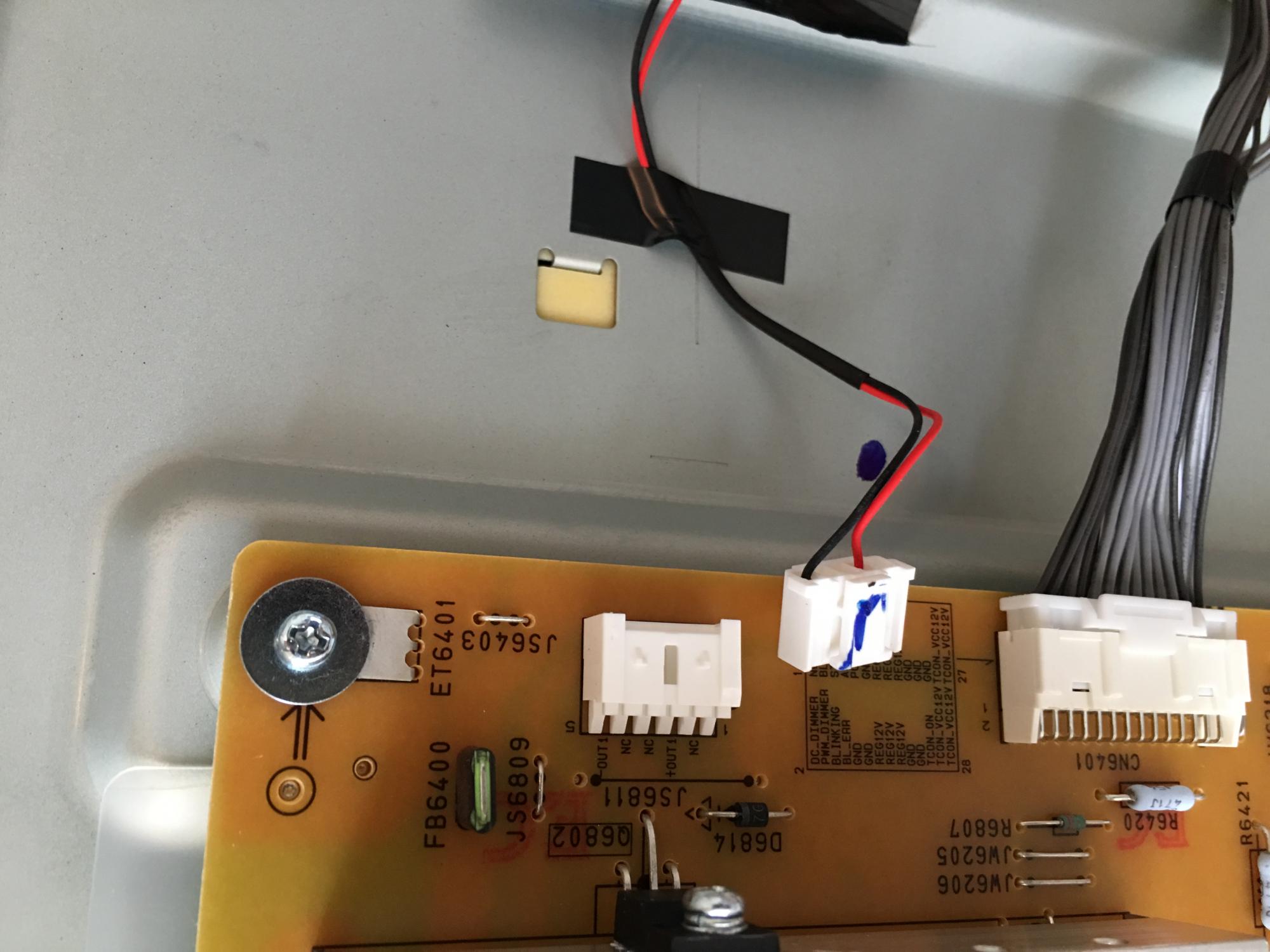

              I checked the harness to mainboard for continuity and it check out. On the backlight connector, should I be getting continuity between the black and red wire going to the backlights? It is open. (See photo of connector) Also, I measured voltage on cn6801 (backlight connector) unplugged and plugged in, and I got the same voltages, around 92v. Still presuming mainboard issue but not confident I can't get any results from the backlight tests.

                the resulting voltage test appears to indicate an open further down from the connector along the red and black wiring since it makes no difference plugged in or not. Are you able to readily trace that wiring towards the "lights"?

                  Should voltage be increasing when powering on? So then red/black wire should not be open circuit? I can take the panel apart and test LEDs/trace short if needed.

                    I think that you will find most systems show a higher voltage (no load) when nothing is connected and then reduce in voltage to "normal operating range" when connected. Regardless, no difference between "plugged" and "unplugged" indicates that the wiring on the other end of the plug is basically "not there" (ie. open) in terms of what the circuit / supply is "seeing". Your resistance measurement kind of confirms this. Good chance that if you can see where the wire ends are... that end has an issue as opposed to say a led gone in the panel.... and might be an easier fix.... if you are lucky.

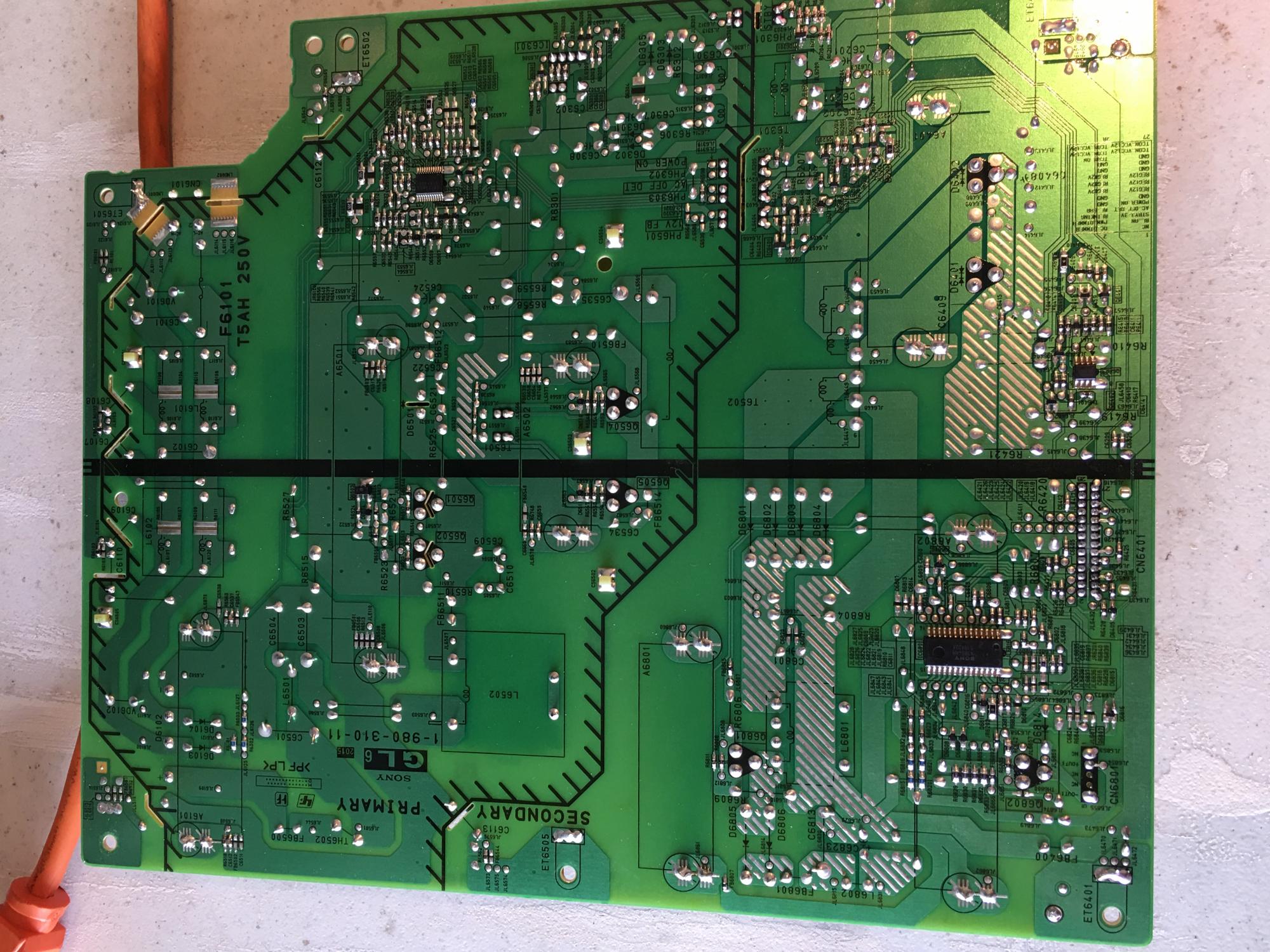

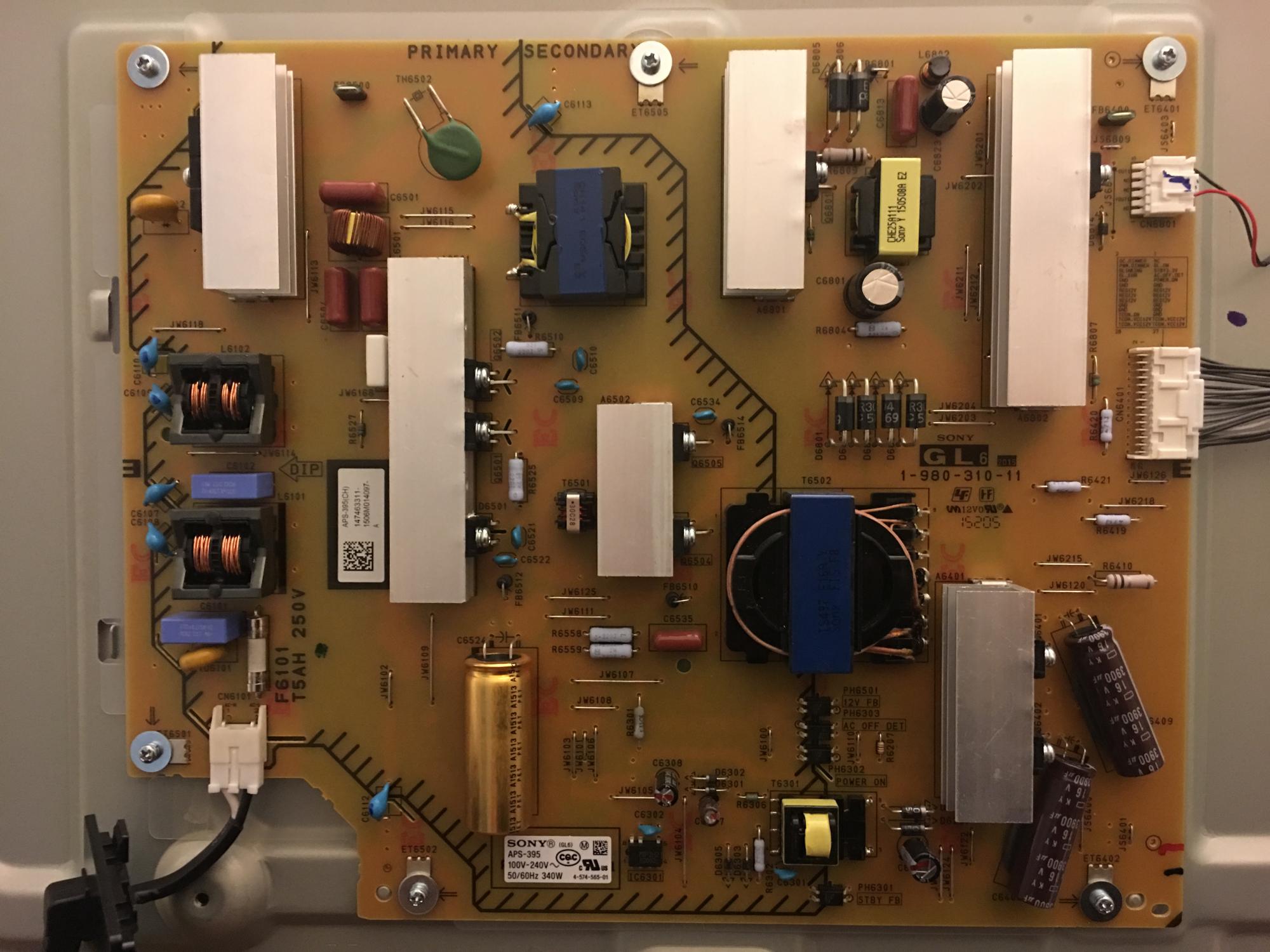

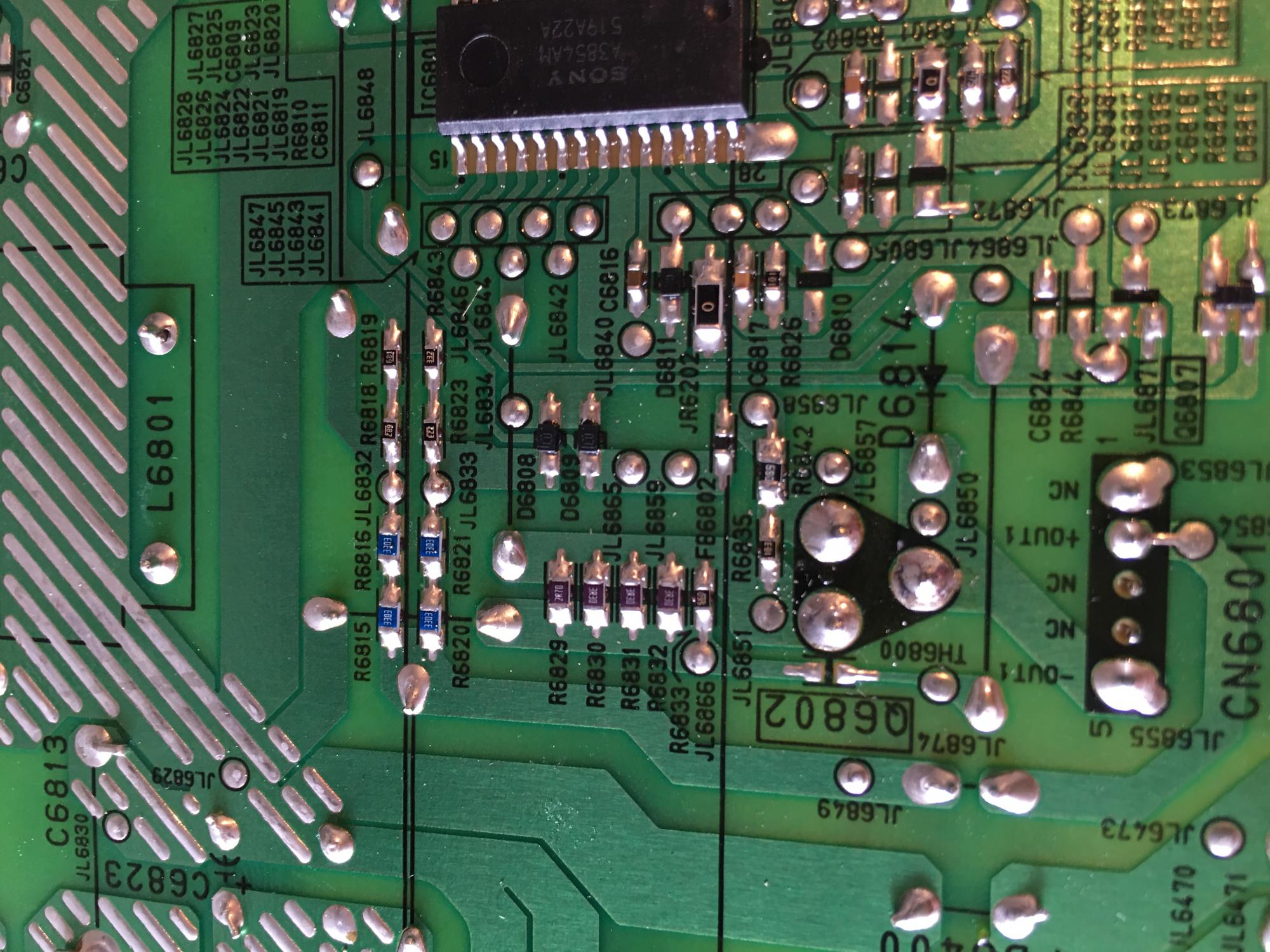

                                “BTW, so does your board an exact matched to the one at Shopjimmy? Sony 1-474-633-11 (APS-395(CH)) GL6”
                                Yes, the board looks to be exactly the same as the shop jimmy one you are referring to. I have attached a pic of my board. I will have to run the other Tests you described later and will report back.

                                  1) There will be no T-CON Voltage until you force on T-CON on pin (I use resistor).
                                  2) Getting 76V on the -Out1 (which is the Cathode return for the LED) that goes to GND VIA PWM Controlled MOSFET and the current sensing resistors (R6829 ~ 33 connected in parallel), it looks like the MOSFET Q6802 is not being controlled or bad current sensing resistors so the Voltage on the +Out1 went up to over 200V. IC6801 is the LED CONTROLLER IC. Can you read the P/N of that IC?
                                  3) I never try to jump the control pins directly to the STBY power supply without the resistors because if you jump it ti the wrong pin you can damage the circuit, I always use resistor for that reason.
                                  Budm,
                                  Info for 2)
                                  I do not see any resistors in the range of R6839 to R6833? Is this on the back of the board?

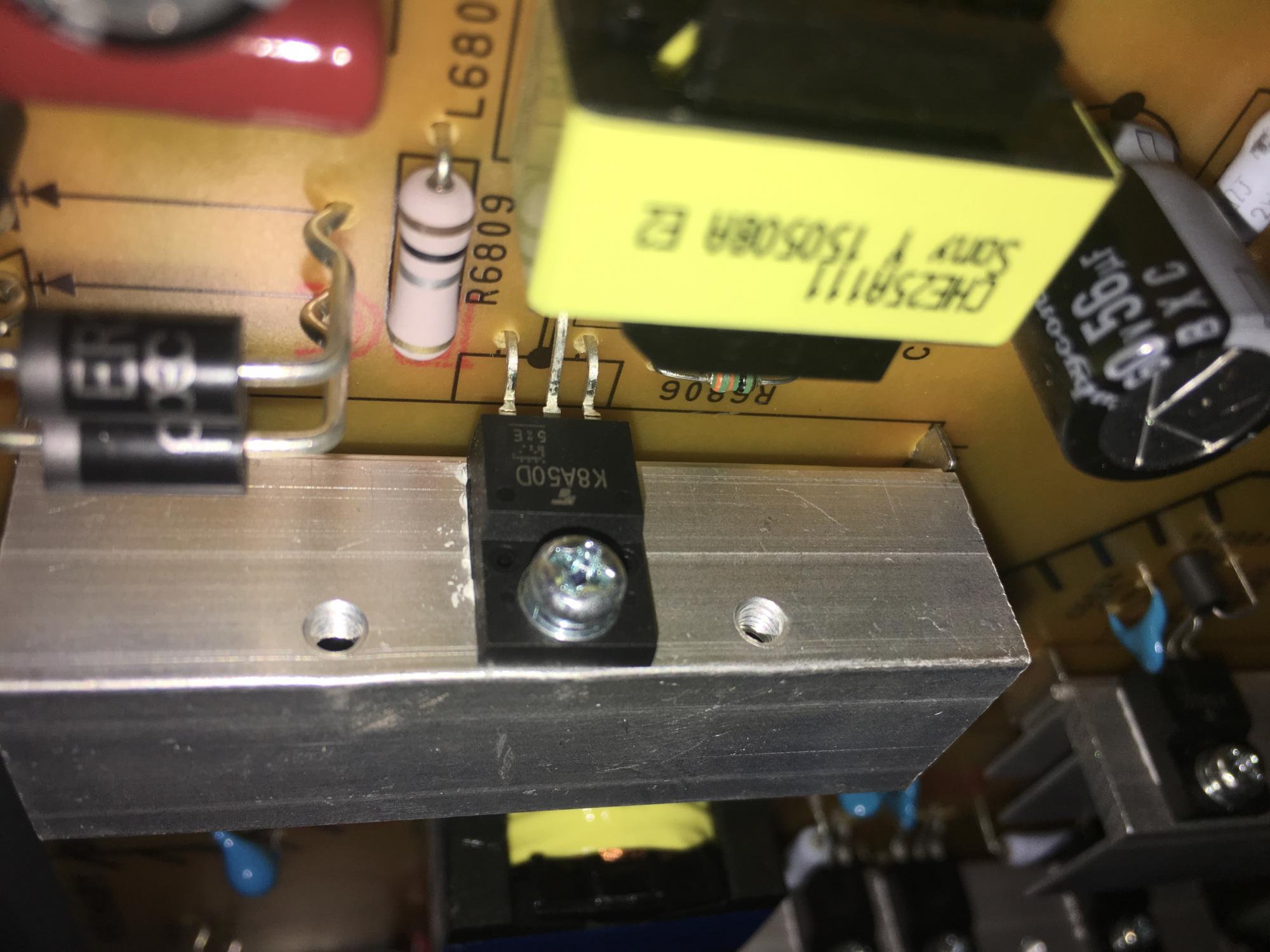

                                  MOSFET Q6802, I measured a few diode checks in circuit and seemed to check out ok.

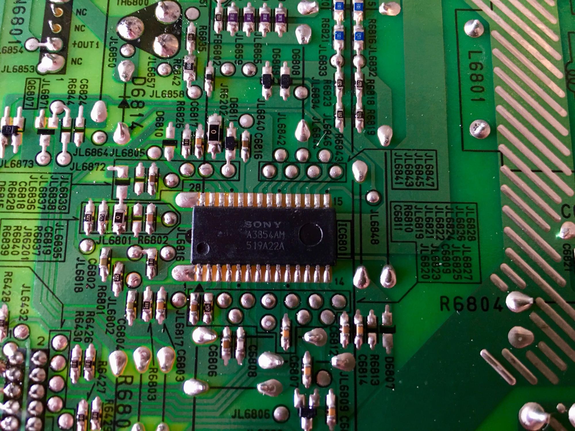

                                  I do not see IC6801, I have IC6301 and the p/n is MIP2H2 and below that is 520S2C. This is the only IC I see on the power supply. Pictures attached

                                    Re: Sony XBR-65X810C Not Powering on
                                    Those SMD Resistors are on the botttom side of the board, one end of each resistor is connected to the Source pin of the MOSFET, the other end of each resistor is connected to the circuit GND.
                                    The IC is also on the bottom side of the board.
                                    There are many parts on the bottom side of the board that you must have seen since you are able to check the MOSFET.

                                      Apparently I was being lazy and didn't want to take the board out of the tv...
                                      On those resistors I'm getting 1.2 ohms across each one. What resistance should these be putting out? Should I take these out of circuit to test? I have a picture of the IC you requested, the P/N is A3854AM and under that is 519A22A. I can report the mosfet readings, but I'm not sure which pin is gate, source, drain.

                                        OK, the resistors are fine, if they are bad they will show in hundreds of Ohms.

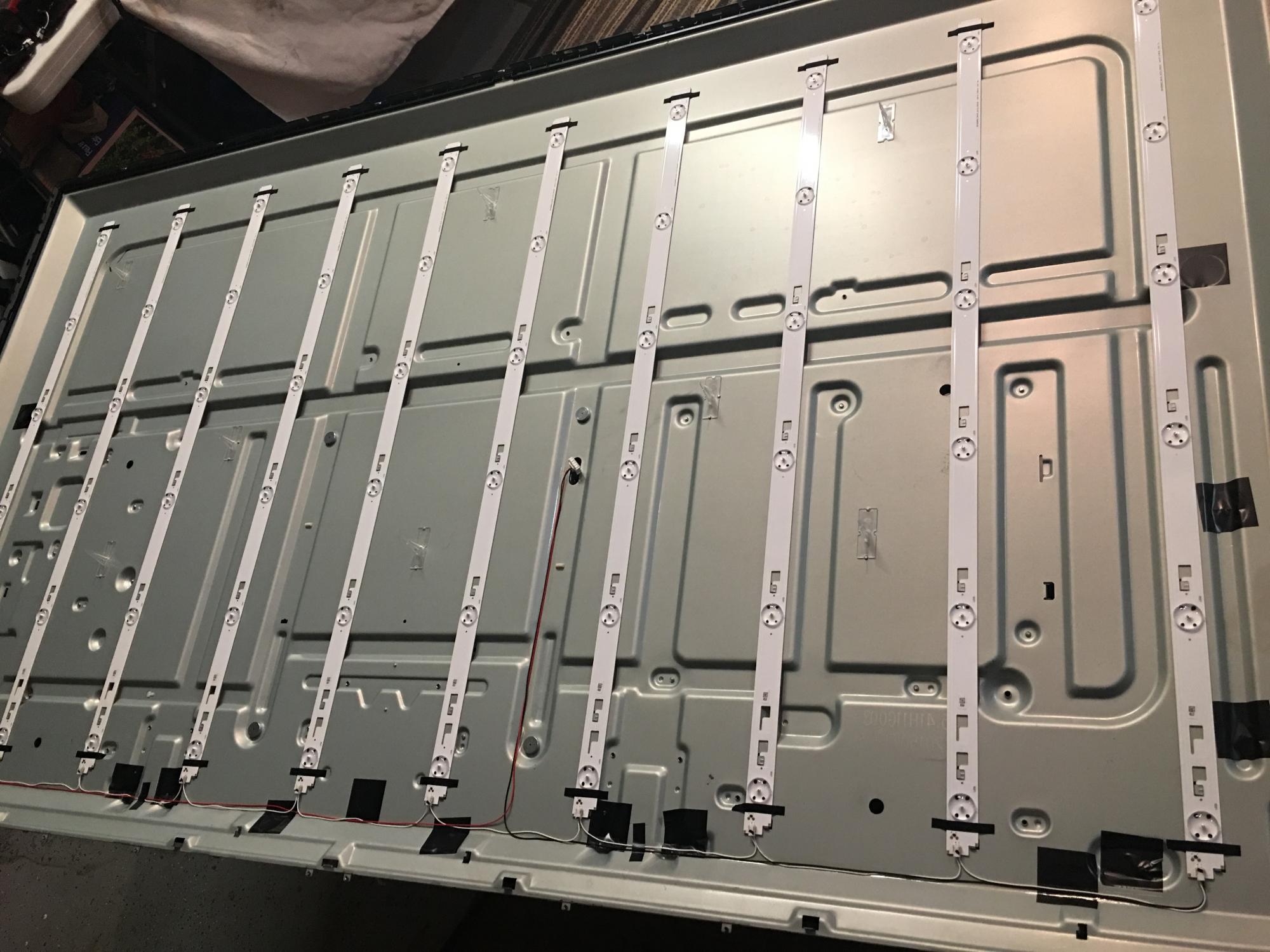

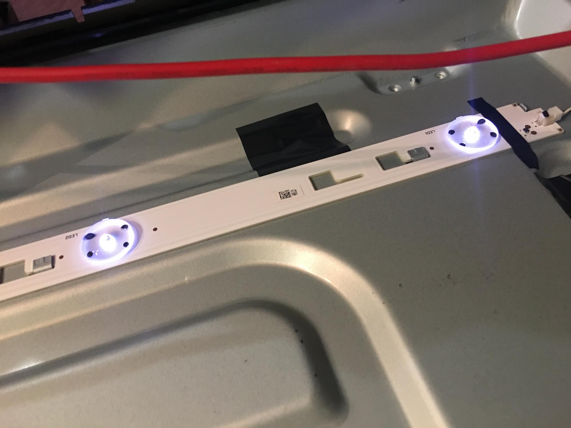

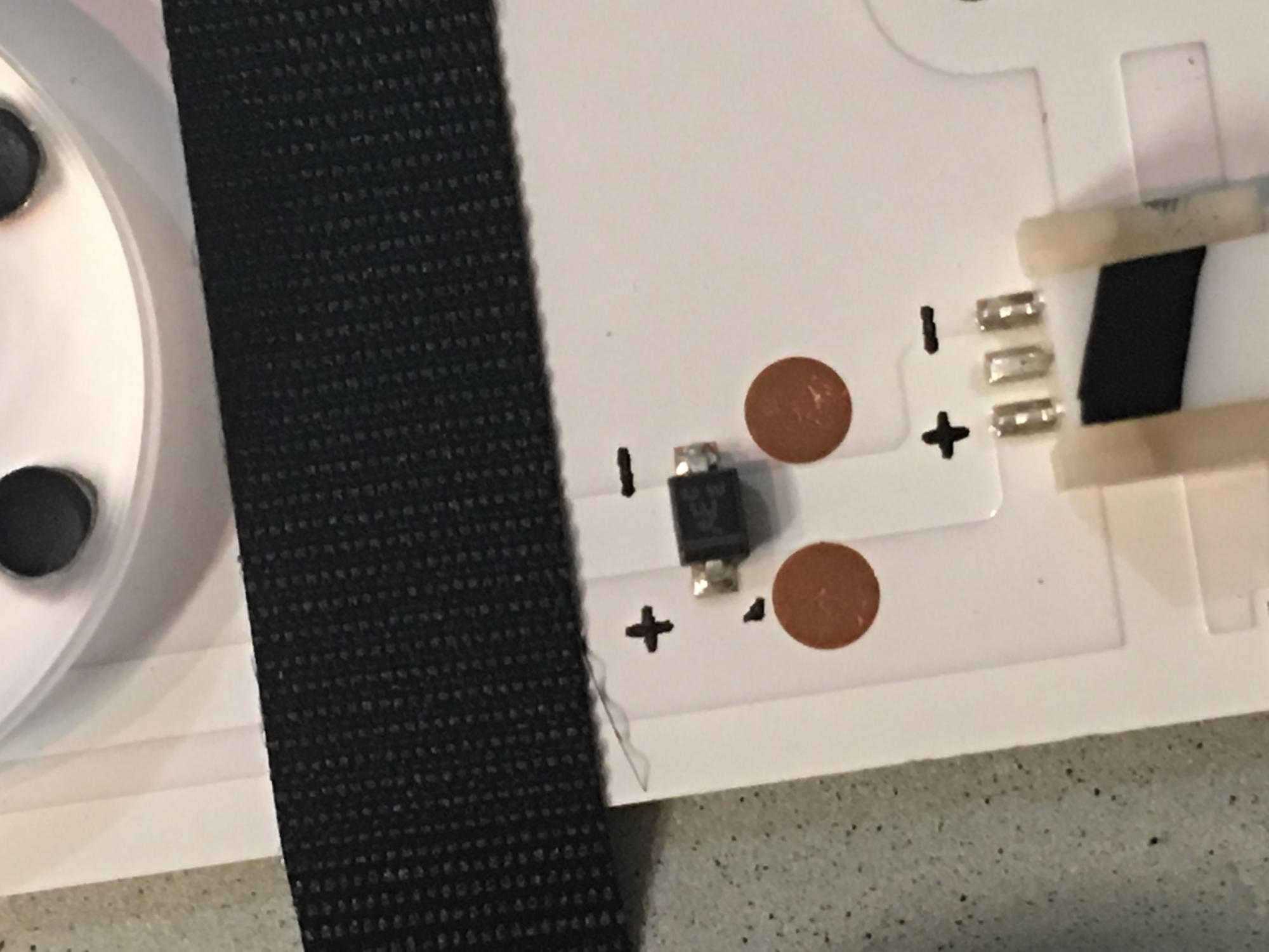

                                          I took the set apart all the way down to the backlights. I tested each light individually and they all light up. I checked 4 at a time with 12v which looked good. It looks like there are some diodes on the LED string and I test these and one is OL both ways. I might have caused this when I tested 12v across it. That area is lighting dimmer then the others that test good. Any ideas on replacement? I have a photo of the diode and the dim-ness of the led string in question. Also a pic of the entire backlight assembly.
                                          I also used a 1k resistor to jump bl_on and checked voltage. I got 220v on the +out again but no voltage on -out. That was checking from chassis ground and also across +out and -out.
                                          Is this an LED string issue or the control IC 6801 issue? I still have not been able to get the backlights on with the powersupply.
