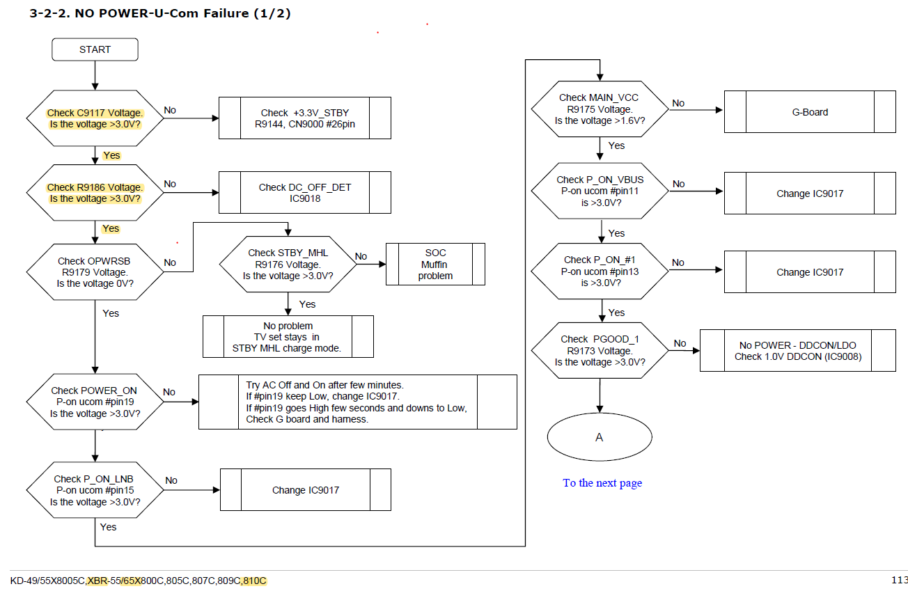

    Reading these posts has helped me to get to this point.
    I have a Sony XBR65810C, its completely dead.
    I can get all the voltage outputs from the Power board.
    So at this point I have 2 leads, there
    I used the Service Manual from ELECTROTANYA site that someone kindly shared.
    I need help interpreting the next steps on this troubleshooting tree.
    I've completed steps highlighted in yellow, (see attached picture).
    but I don't know what "Check OPWRSB R9179" and then the next step is "Check STBY_MHL R9179" these are referring to the same resistor but what does OPWRSB and STBY_MHL mean.
    ALso the following steps
    "Check POWER_ON
    P-on ucom #pin19
    Is the voltage >3.0V?"
    Please see attached Picture.
    Thanks again for getting me this far.
