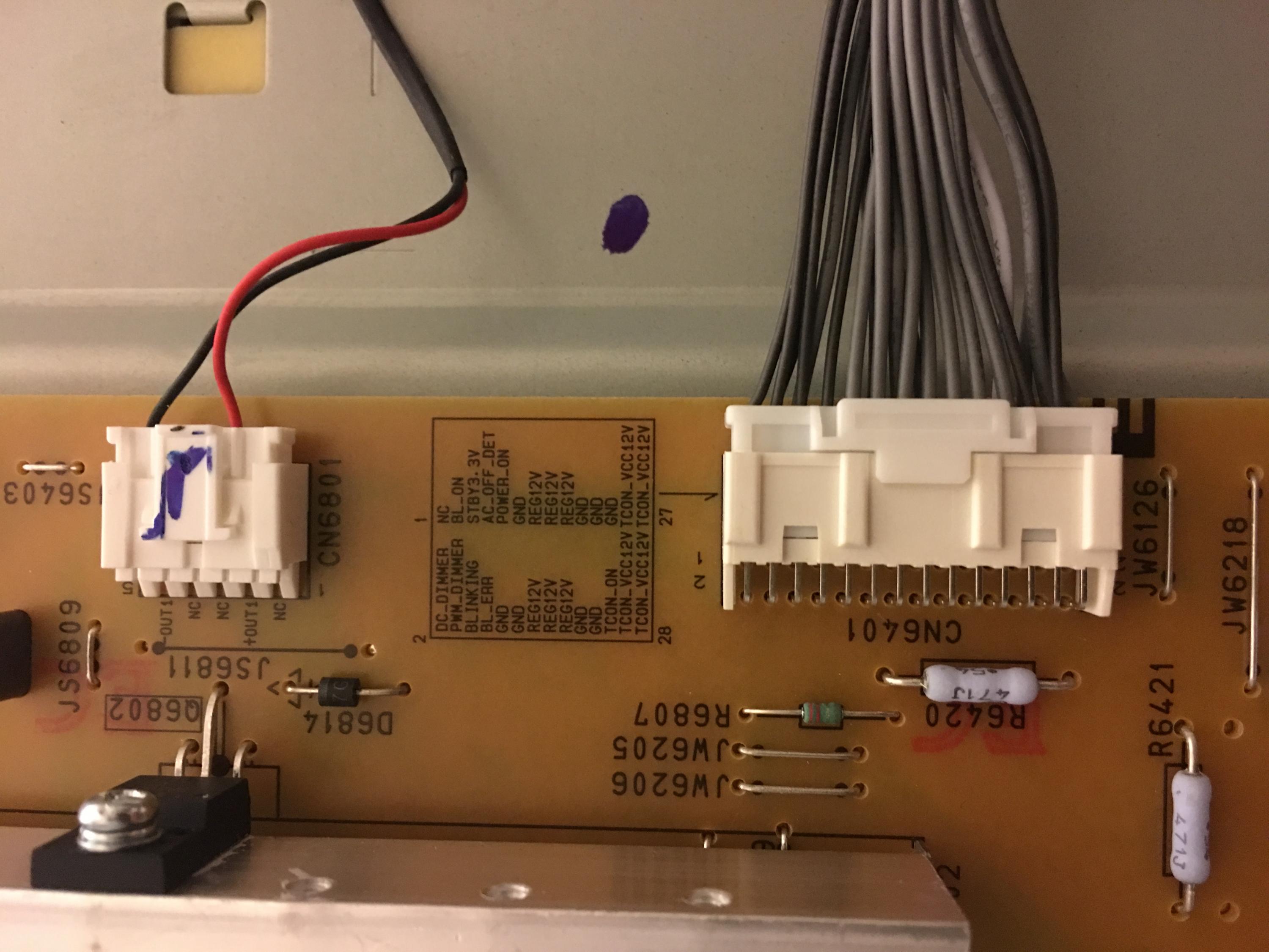

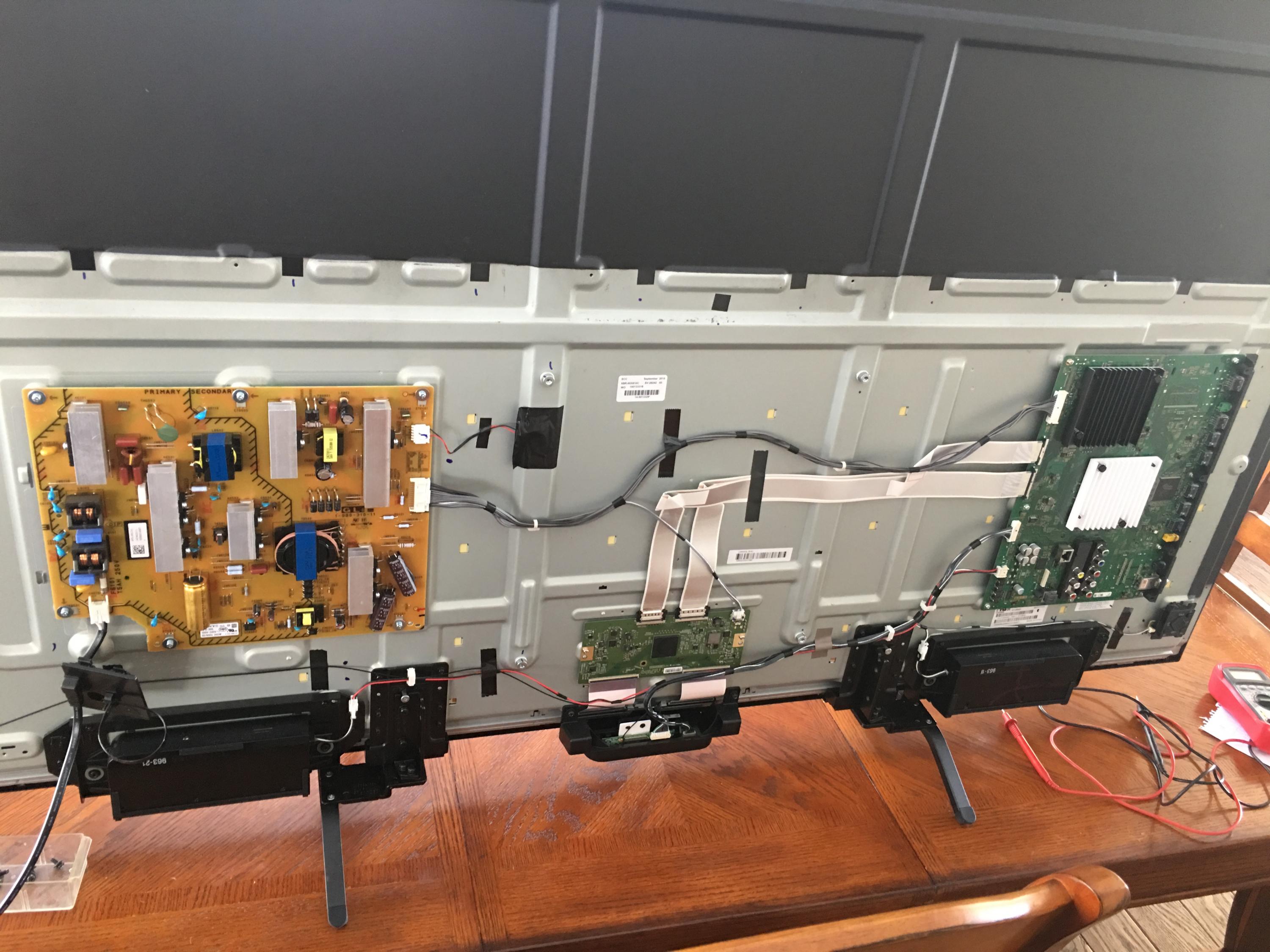

    Hi! Looking for some help with this monster i picked up. It is only 2 years old so I am not finding too much info on repairs for this set. When I attempt to power it up, the logo in the bottom middle illuminates white for about 10 seconds and turns off. No blinking codes or other colors are occurring. There is no screen flash of any backlight illumination.

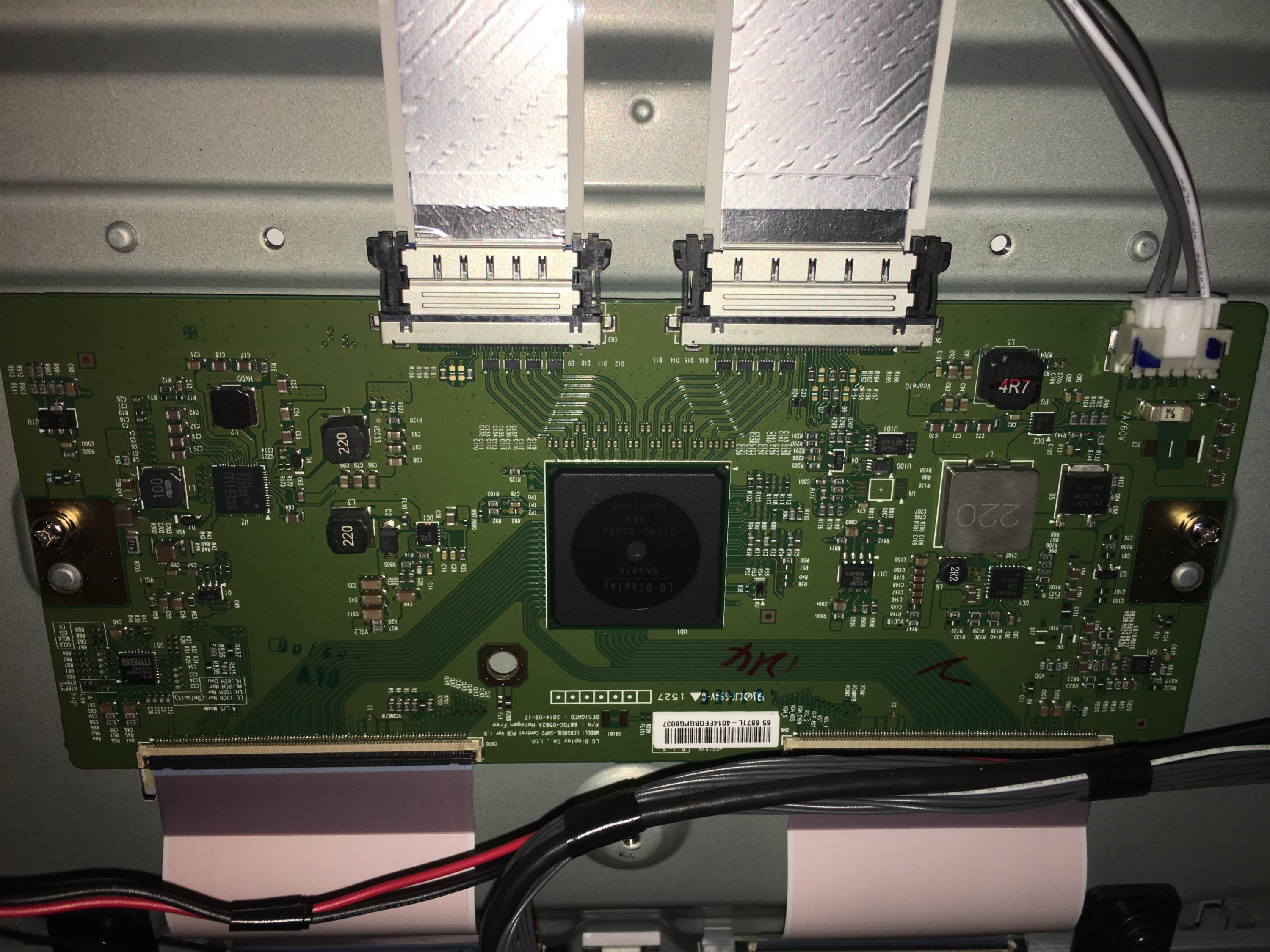

    I tried unplugging ribbons going into t-con from mainboard, and that made no difference.
    I took voltage readings on powerboard connector CN6401. I got the same voltages with the set plugged in and when i attempted to power on. None of the voltages changed when the power button was applied.
    Here are the readings I got:
    1) DC_Dimmer 0 Volts
    2) PWN_Dimmer 0 volts
    3) Blinking 0 volts
    4) BL_ERR 2.36v
    5) GND
    6) GND
    7) REG 12V 12.6v
    8) REG 12V 12.6v
    9) REG 12V 12.6v
    10) GND
    11) GND
    12) TCON_ON 0 volts
    13) TCON_VCC12V 0 volts
    14) TCON_VCC12V 0 volts
    As I wrote these voltages i noticed their are 2 banks of pins on this connector and I only test the 2nd bank. But, I believe it shows enough that I am missing several voltages that should be present.
    Should I be looking at faults on the powerboard? or is my mainboard not sending any signal to turn on the powerboard? Is there any way to force on backlights to confirm they work? Any reason why I am not getting any blinking error codes. Any help is appreciated. Thanks

    You did the test right, you NEED to test both rows, same way, test with tv plugged in, take reading then hit power button check for voltage changes, make sure you have steady stby 3.3 voltage, need pin label with expected voltage and the voltage you got when measured.

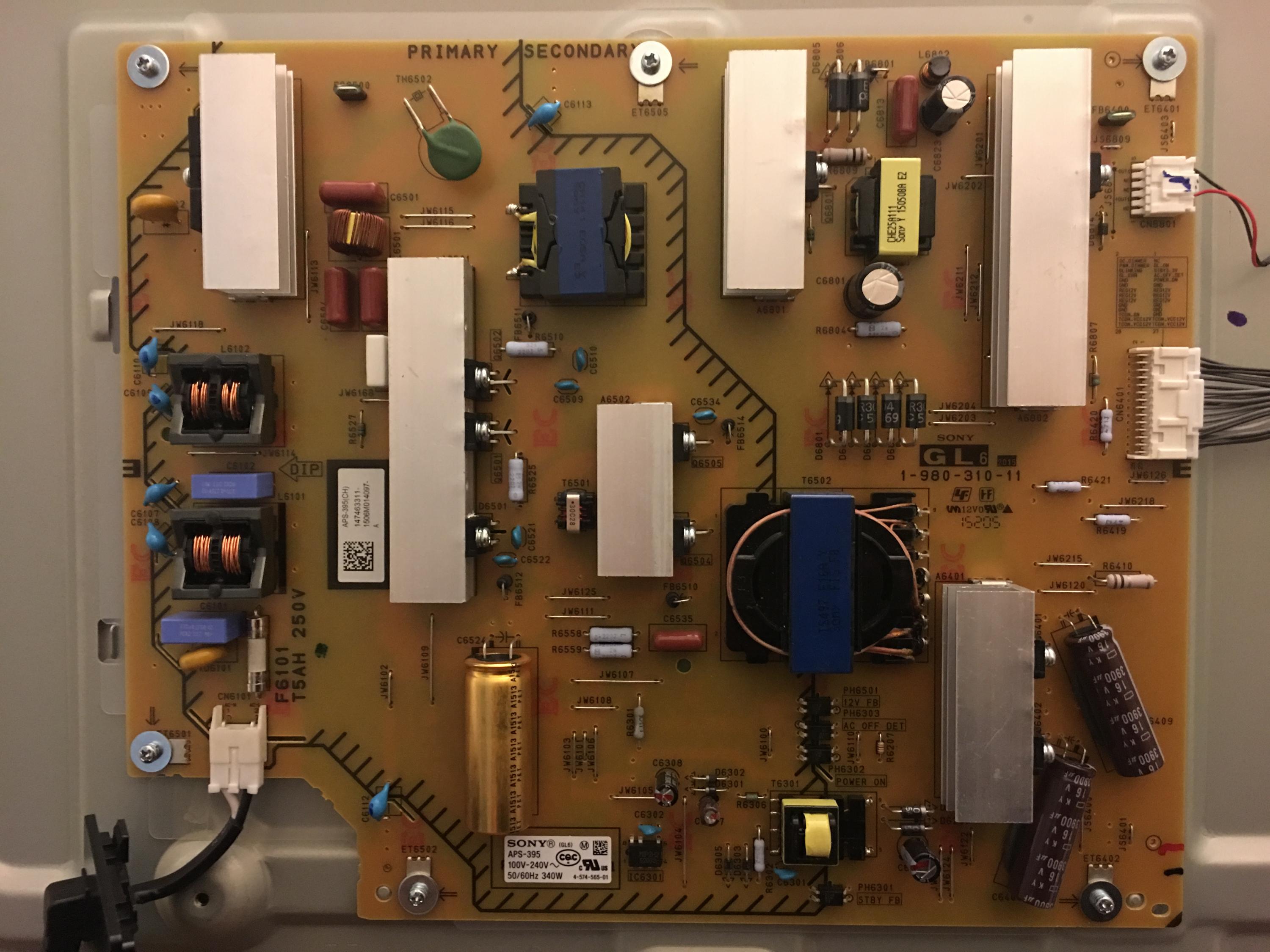

      This is secondary side of powersupply, whenever working with primary/hot side ALWAYS USE CAUTION HIGH VOLTAGE CAN BE DEADLY, on your board it's clearly marked.

          Ok,
          Here is my pinout reading for the other bank on connector CN6401. No change between plug in and power on.
          NC reading -No pin out connection
          BL_ON reading-0 volts
          STBY 3.3v reading- 3.45v
          AC_OFF reading - no pin out connection
          POWER_ON reading 3.45v
          GND reading - 0v
          REG12v reading 12.6v
          REG12v reading - no pin out connection
          GND reading - no pin out connection
          GND reading 0v
          GND reading 0v
          TCON_VCC12v reading- 0v
          I had all the same reading when i attempted to power TV on. As i said before TV will illuminate "sony" light under the screen for about 10 seconds and then turn off. When i say "no pin out connection" The cable from the connector does not have a wire connected in that particular location. It would seem to me the set is not getting any prompt from mainboard to power up the other voltages (bl_on and tconn 12v).

            I attempted this by removing connector from power supply to main board on top left of board. I did not get any backlight illumination and it did not appear that the TV was trying to power on. ( i was not getting the light on the bottom as when the main was plugged in) So no confirmation on backlights working or not.

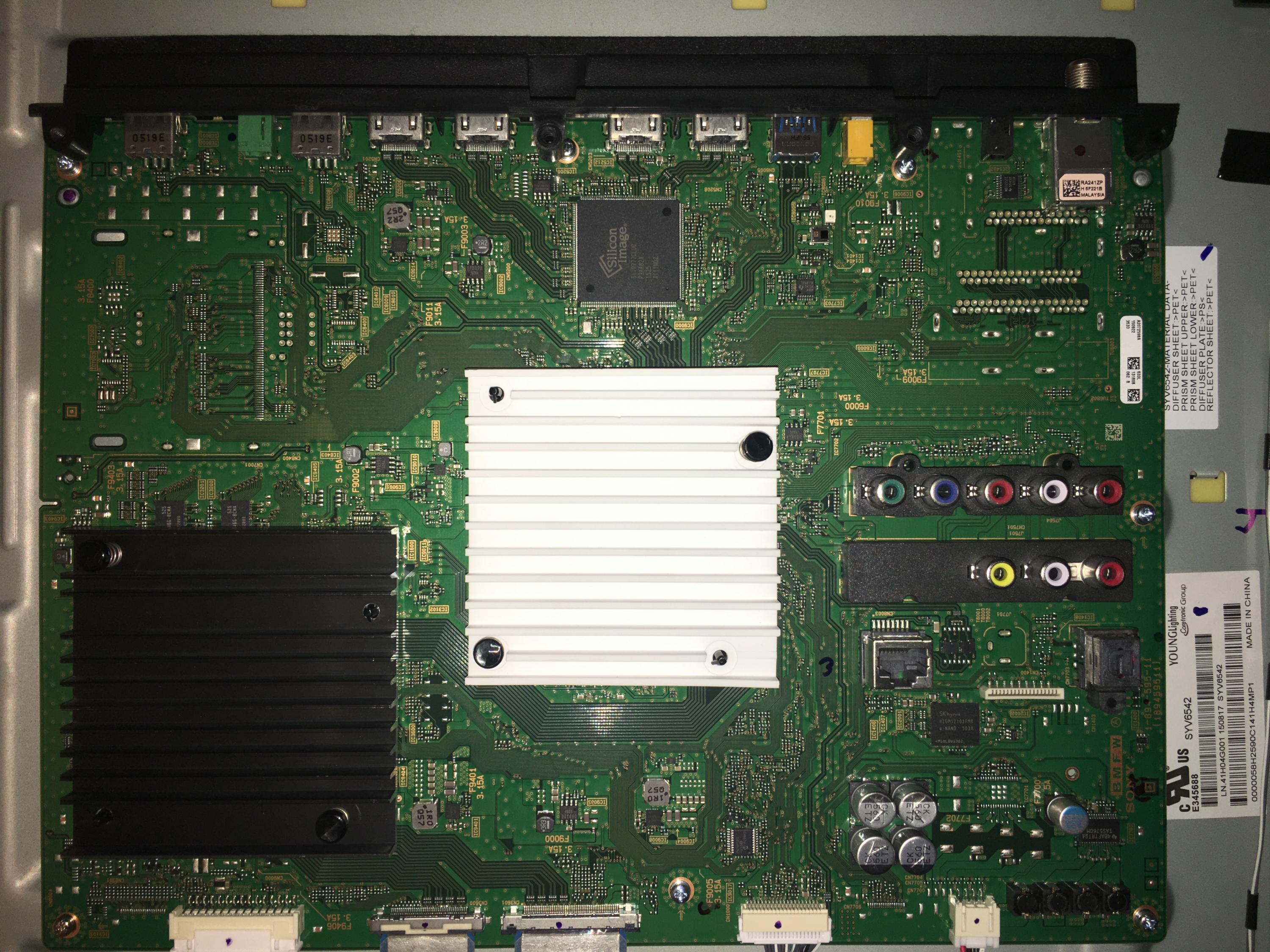

              I think you're right, sure seems like a mainboard problem.

                These main boards are extremely finnicky with failed firmware . Get a USB stick and download the newest version of the firmware via Sony website and formatted in fat 32.
                Unzip the file and put it on the USB stick . Put the USB stick in the TV and plug in the TV. Look for the light to turn white flashing and wait.
                This will determine if the firmware is corrupt and needs to be re flashed

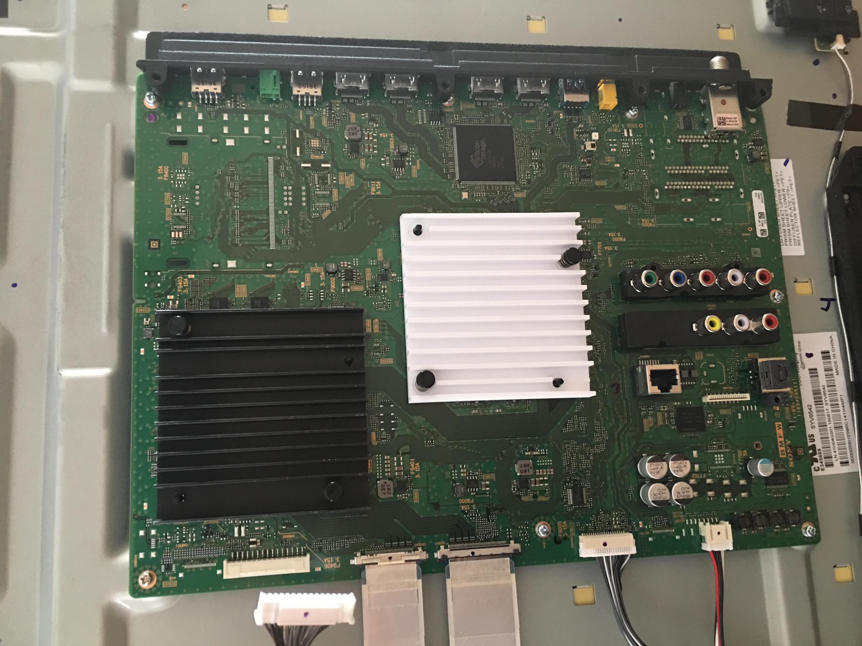

                            Quite possible. Last resort usually is taking a hairdryer and hitting various components on the board including the processors to check for bad BGA connections and see if it lowers up.

                                  So I applied some heat to the main board with my heat gun. I was getting the indicator to light white for about 2 seconds and immediately turn off. Before it was staying on for about 20 seconds. So it acted like it didn't like the heat.
                                  I tried a hard reset by pressing power and volume down simultaneously and then plugging the power cord in. I did get a green indicator light to illuminate for 2 seconds, which should show that the reset worked. I powered the tv back on and the indicator stayed on, i did not turn off. Nothing changed on the screen, no backlights, no picture. At this point I tried the firmware update again and it did the same. I also checked voltages again but they were the same as previous.
                                  Does this set need BL_on to be shorted to ground or 5v to start? I want to try jumping the backlights to be sure they are at least operational.
                                  My other question is should I remove the 2 large heatsinks to apply heat to the BGAs under those and see if I get a response? What BGA's should I pinpoint with heat? I tried following some of the traces and I'm unfamiliar with what section is involved in powerup. I see the audio circuit and the circuit for all the outputs like hdmi, etc.
                                  Also, This tv has 3 usb's, which one should I be attempting the firmware update on or does it not matter? I feel like the heat got the boards attention a little and it started to act a little different, but still not much change.

                                    Have you attempted to shine a flashlight into the screen as you power the TV up and look in the center for the Sony logo to show up Right before it shuts back down?
                                    Edit: Scratch that you're probably not gonna get anything since tcon 12 V is not coming live

                                        Yes what I meant was if there is not at any time 12 V to the tcon you will not get a picture regardless of the back lights are on or not.
                                        On your power supply you may have to jumper 3.3v to the DC_Dimmer or PWN_Dimmer pins as well. I'm not quite sure.
