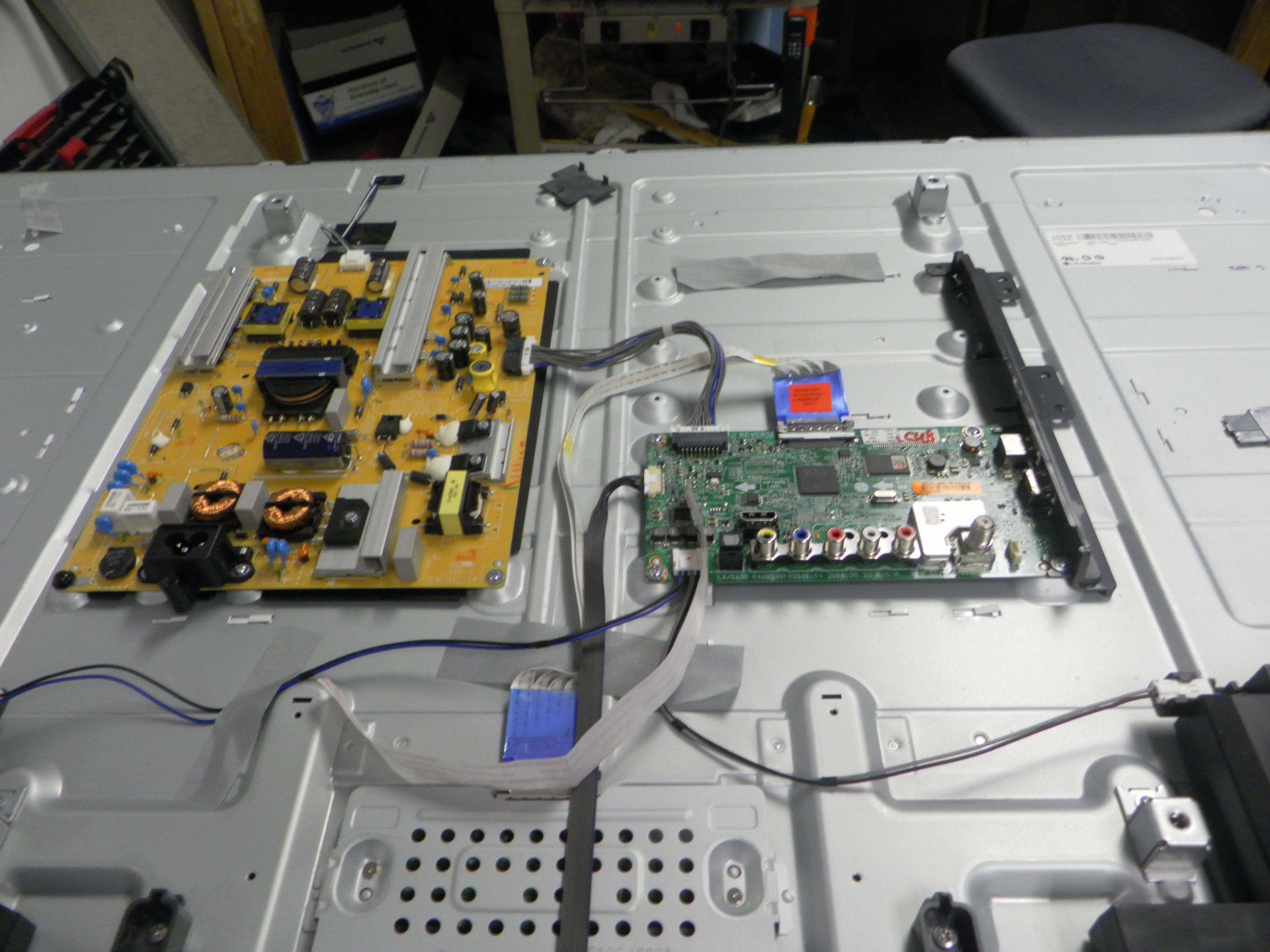

    I have one I thought was going to be easy. It came in with no backlight. I found several bad LED's so I ordered a complete set of LED's from Shop Jimmy. The only problem is they did not have the original but had a substitute set. I tested the LED's when I got them and they tested good. After installing them and testing the LED's just flash repeatedly ever second or so. Tested the voltages on the power supply and here is what I get:
    on P801 LED+ both when first turned on get 30v then creeps down
    on P201
    Pin 1 PWR-ON 2.7v
    Pin 2 drv-on 2.9v
    Pin 3 2.3V
    pin 4 p-dim1 4.2v
    pin 5 2.3V
    pin 6 2.7v
    pin 7 gnd
    pin 8 p-dim1 1.7
    pin 9 24v
    pin 10 22v
    pin 11 gnd
    pin 12 gnd
    pin 13 9v
    pin 14 12v
    pin 15 9v
    pin 16 nc
    pin 17 & 18 gnd
    then they drop to ov
    I have replaced the power supply and main board with ones I have in stock but I am not sure if they are good. I did try a different set of LED's that are from a different tv and they also blink. Any help would be appreciated.

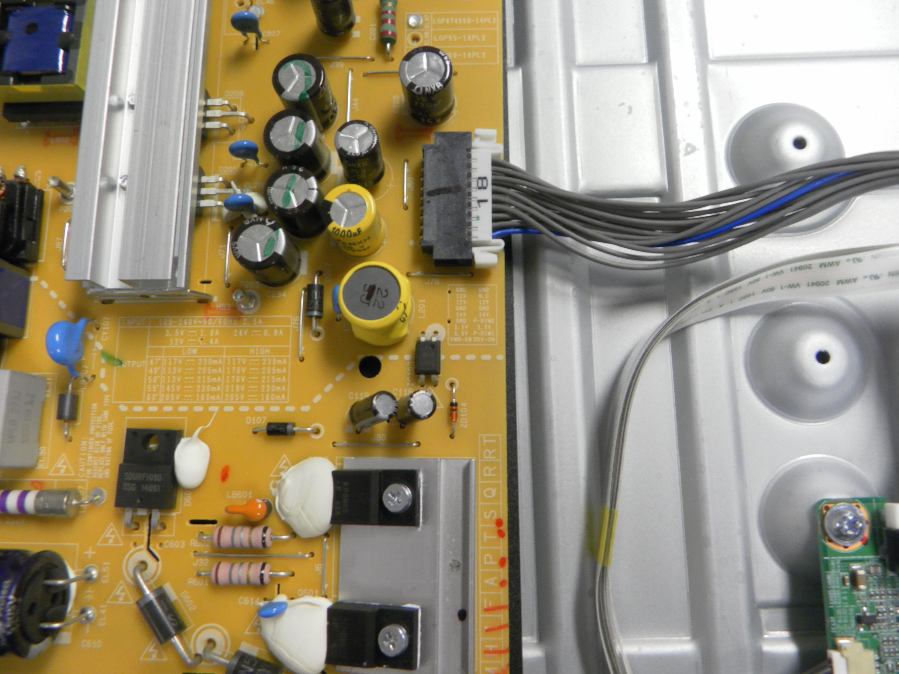

    Based on LED Voltage chart for the 47" screen, the loaded Voltage should be 117VDC AT 230mA.
    You have two set of LED strings driven by individual Boost converters so you need to test Voltages of both L+ OUTPUTS by leaving all the probes connected before turning on the TV to see how high the Voltage jumps up to before coming back down due to protection circuits kick in, meter set to 200V scale.
    BTW, the power supply board should match your LCD panel size as shown in the Voltage chart.

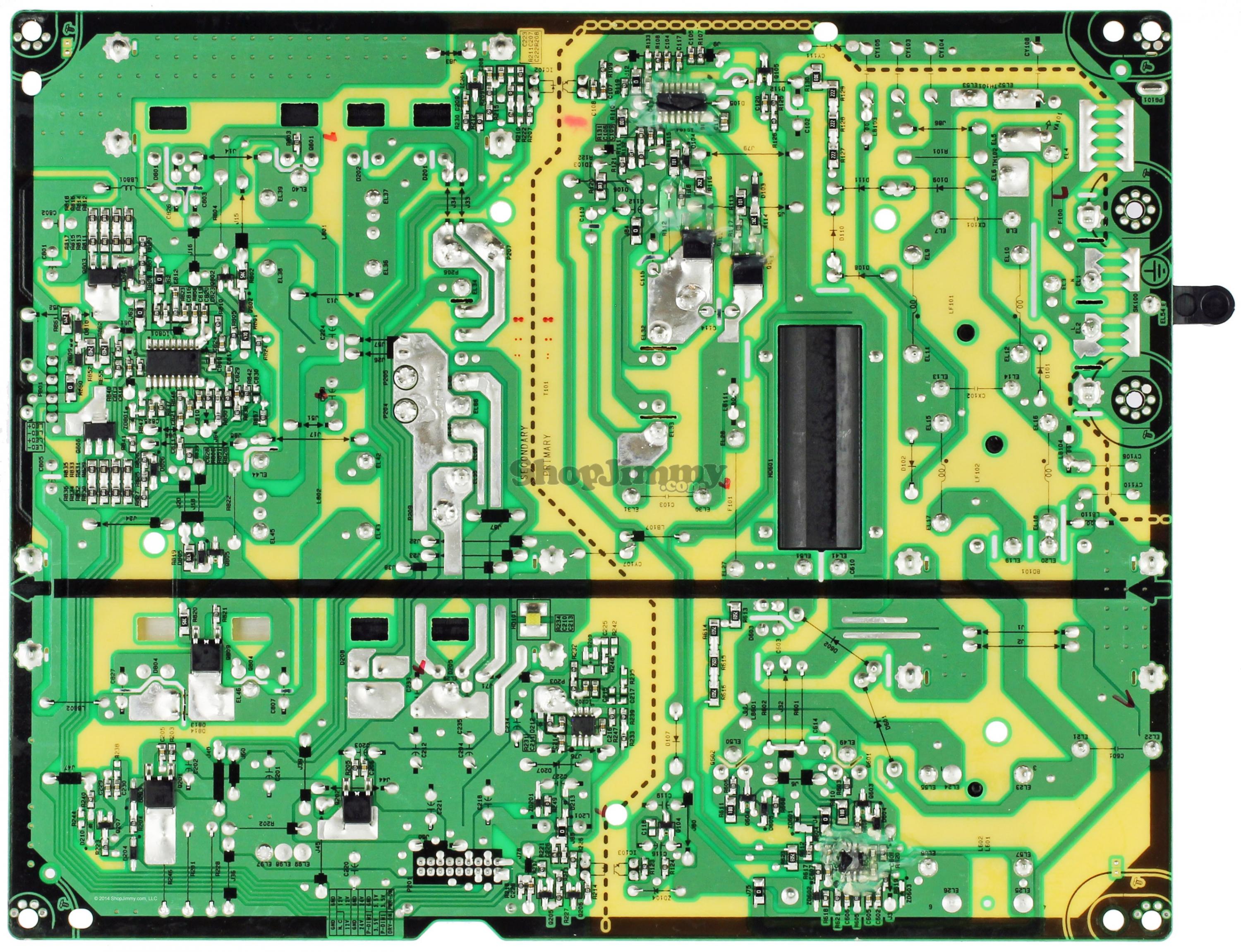

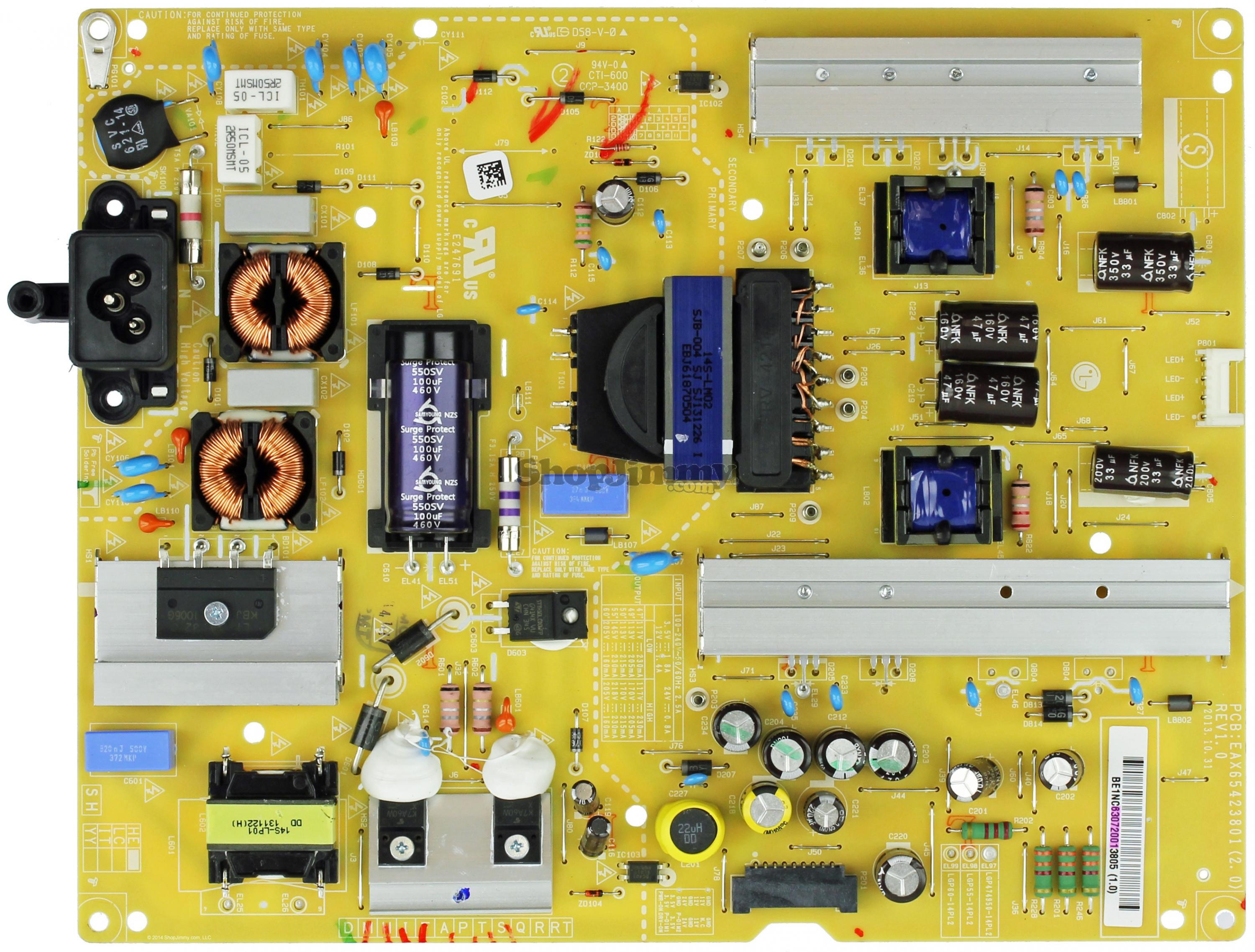

          What happen if the LED connector not in place? The L+ should jump over 150V without LOAD (LEDs) connected, if not there is problem on that power supply board.
          And what DC V do you have between the two legs of C219, C224, main filter cap C610?
          http://www.shopjimmy.com/lg-eay63072...-led-board.htm
          LG EAY63072001 (LGP474950-14PL2) Power Supply / LED Driver Board
          Pictures provided by shopjimmy.

                    These led's are a replacement set because the original ones had too many defective strips. So I would normally agree but I used a know good set of led's with wiring and it too did the same thing. I also went through with my led tester and tested all led's. I may pull the led panel again and check the wiring.

                      Well I went back and reseated all the connectors to the led strips and now all led's are working. Thanks for all of the help again to all of you.
