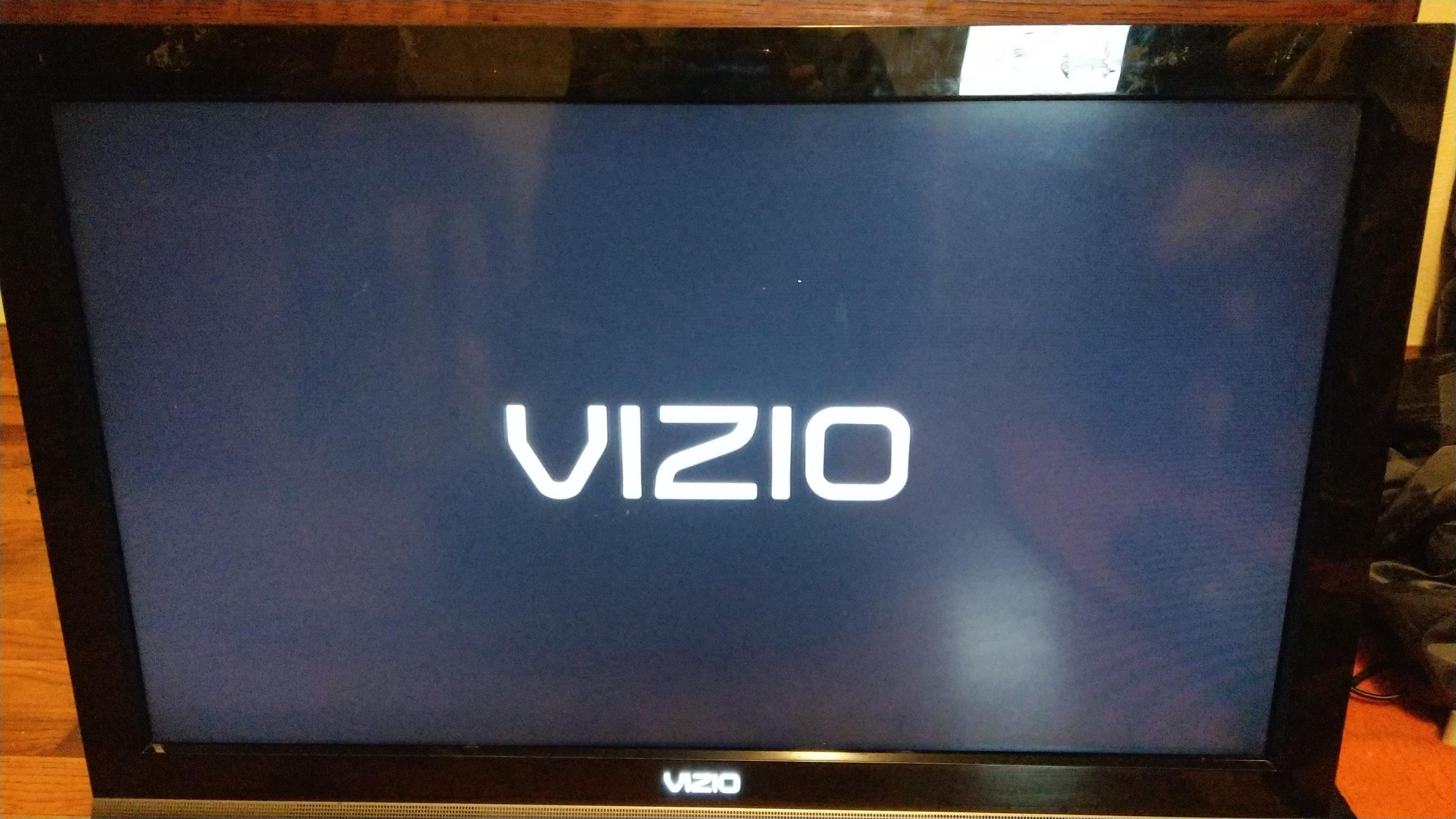

    Vizio E320VA shows logo then black screen

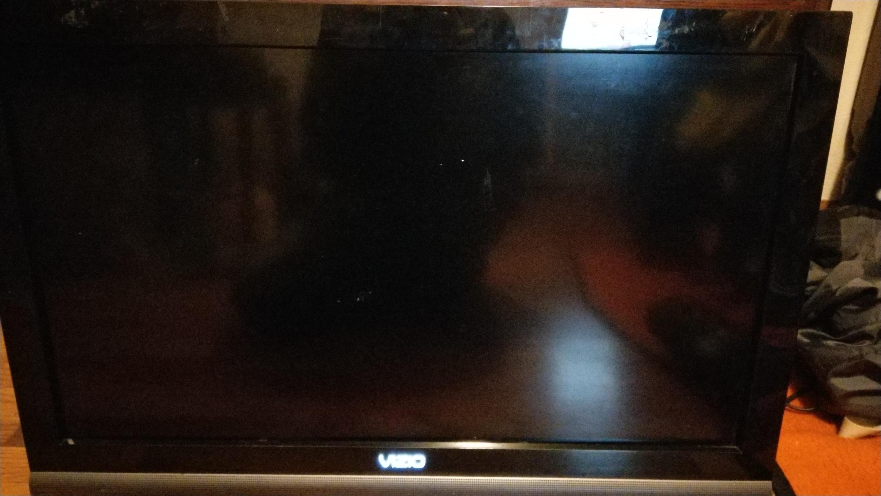

    So basically the TV turns on shows the Vizio boot logo for a couple of seconds then goes to black screen. The indicator like is still lit up showing the TV is on. I can turn the TV off with the power button and the light indicator light goes dim.
    I can then repeat TV boot logo comes up and then couple seconds back to black screen.

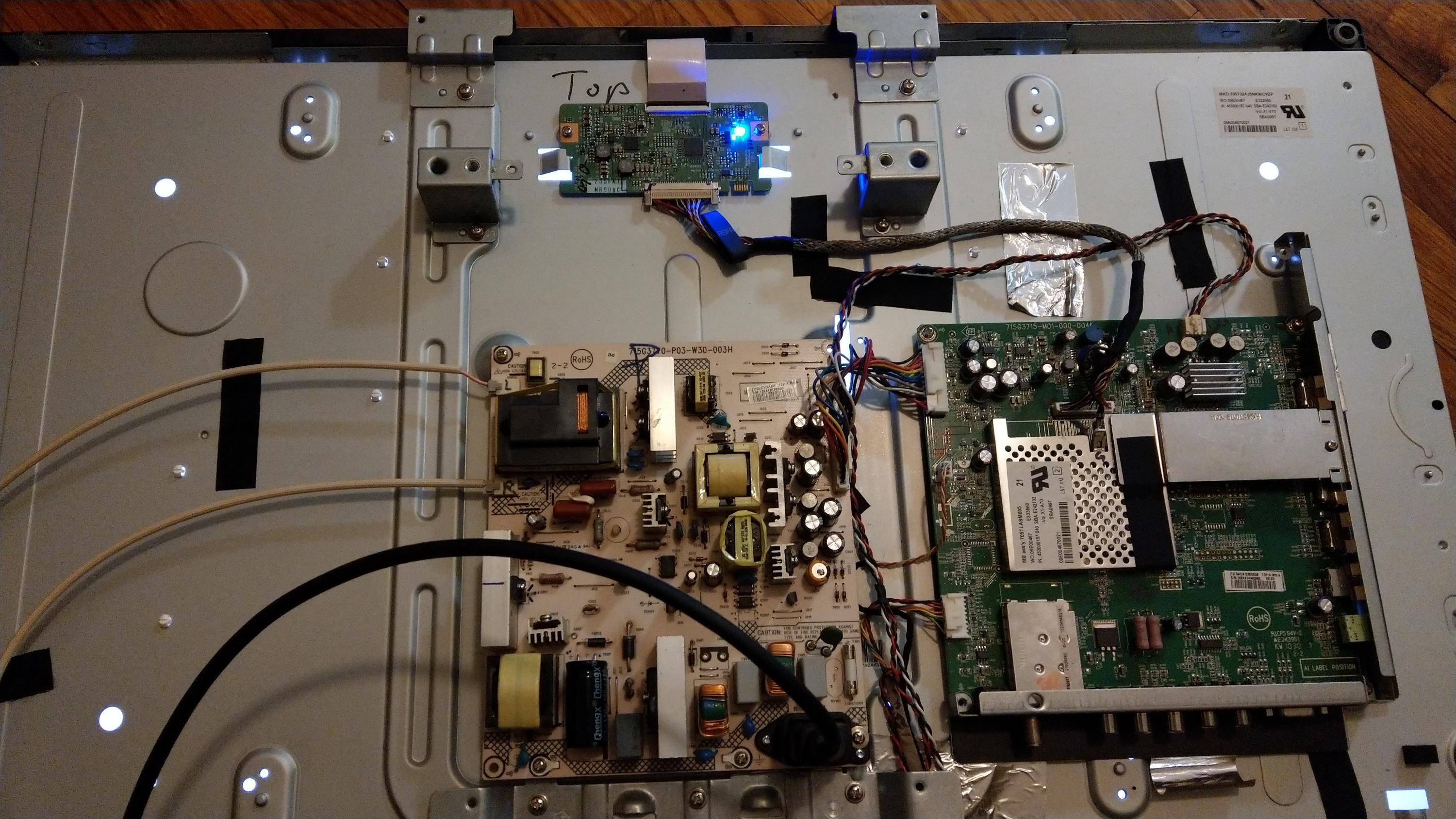

    I have a blue LED that comes on, on the T-Con board with logo and backlights working then when logo disapears the backlights turn off and the blue LED does as well.
    I was told the sound was starting to go out on the TV as well before it went completely out like this. Was also told that sometimes they could get it to work sometimes but they had to power cycle the TV a lot, and it would also turn itself off randomly usually around 10mins of use.
    This TV was given to me so I'm not at any kind of a loss, any help would be greatly appreciated thanks.

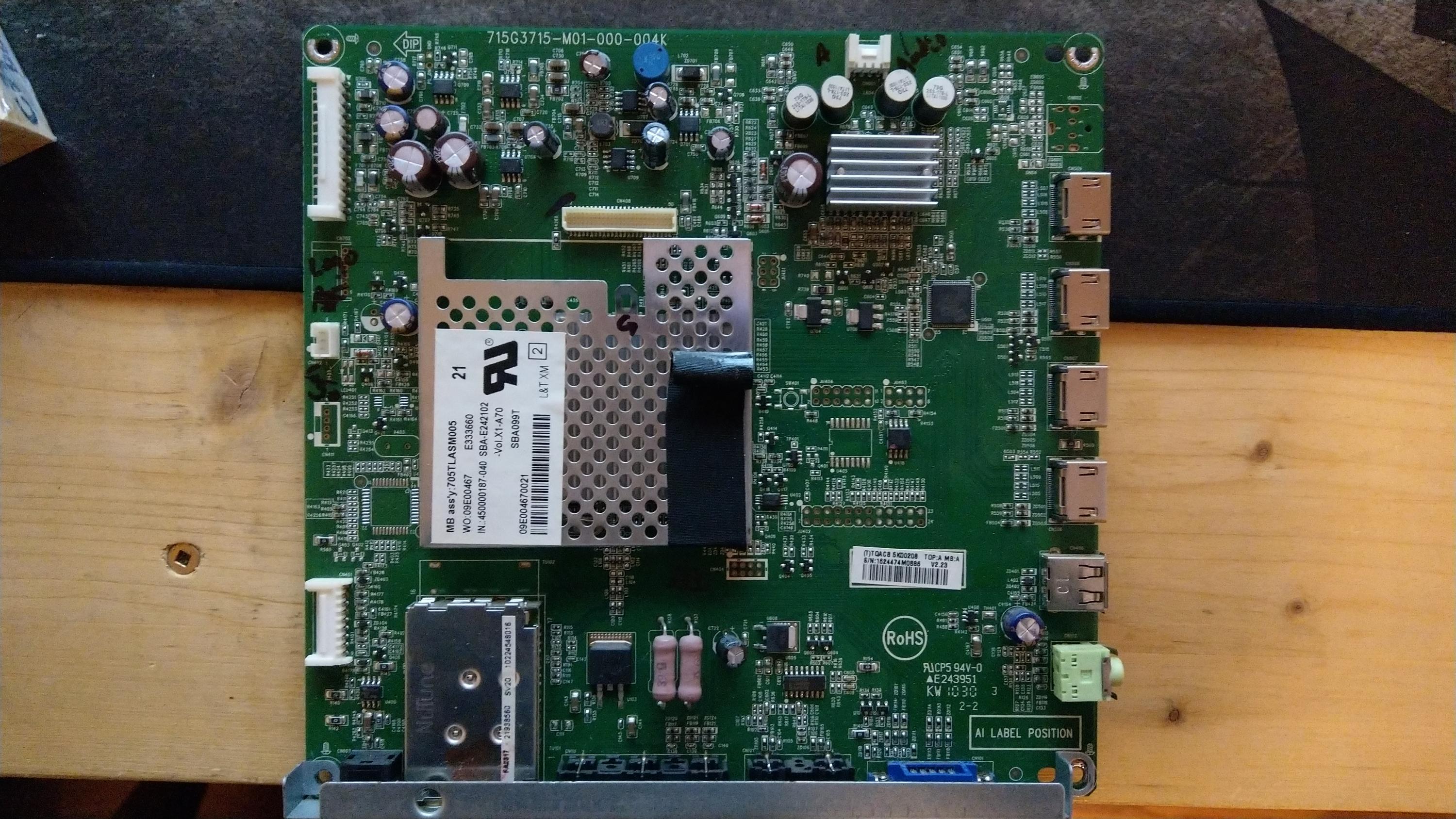

      Re: Vizio E320VA shows logo then black screen
      Thanks budm, Any Idea which repair kit I should be getting? lol

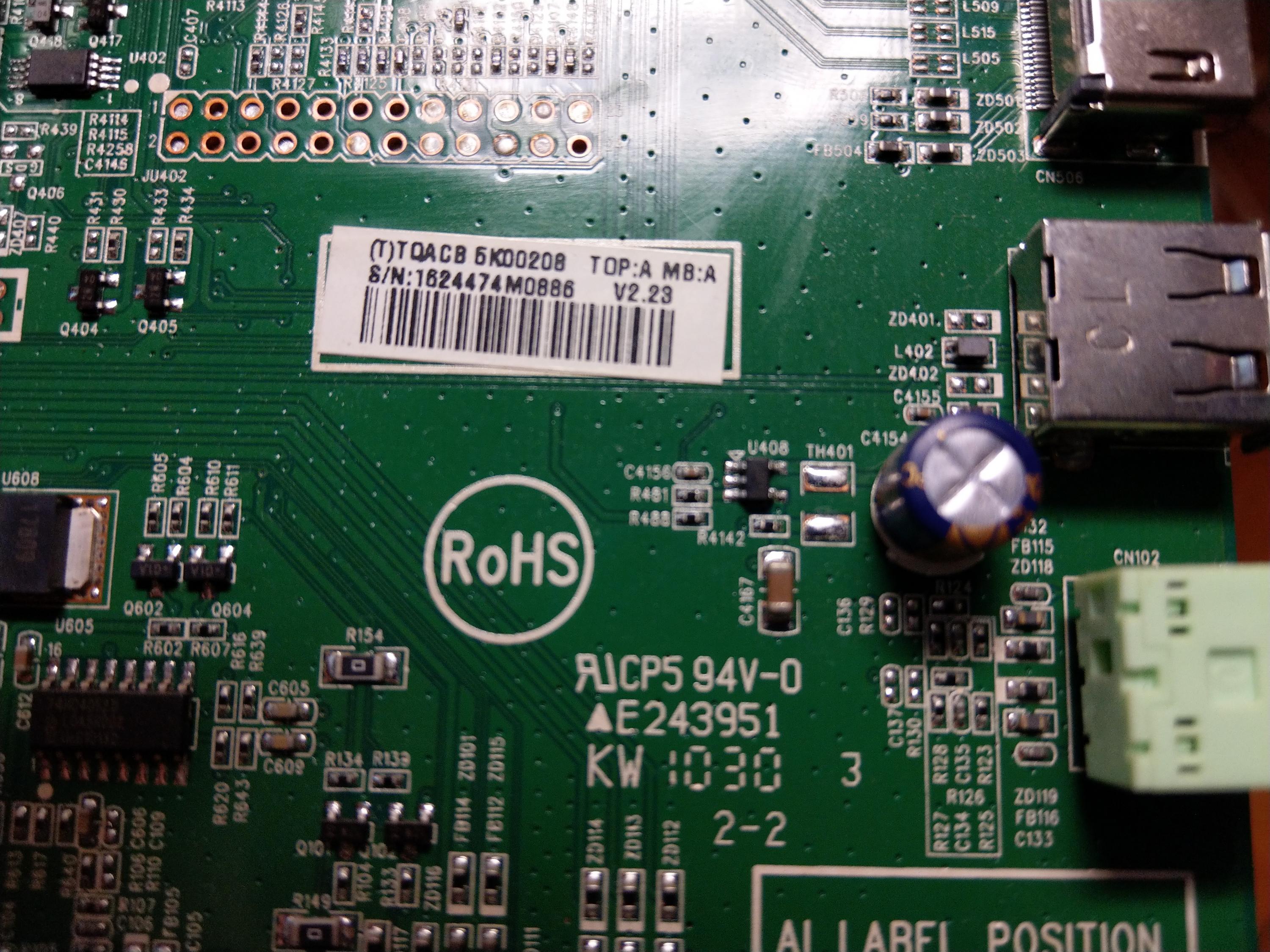

      Top Board # 715G3715-M01-000-004K
      Sticker #'s
      (T)TQACB 5K00208 TOP:A MB:A V2.23
      Also Which one is the EEPROM?

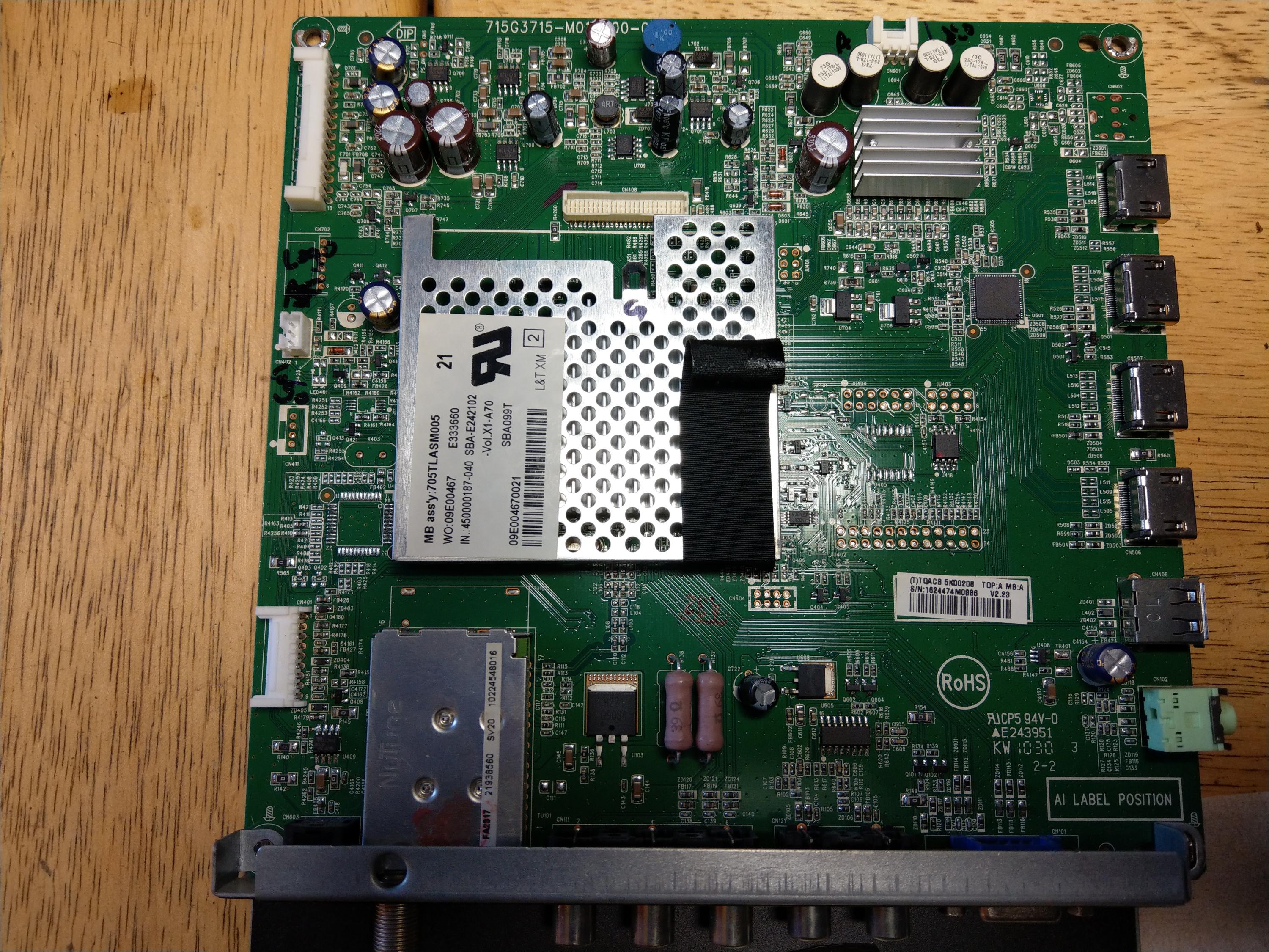

        Okay I found the eeprom and the audio chip
        rom: U418
        audo: U602
        Now just need a little help figuring out which one I need to order.

          What is your FULL model number of tv or the whole number on the little white sticker on your mainboard?

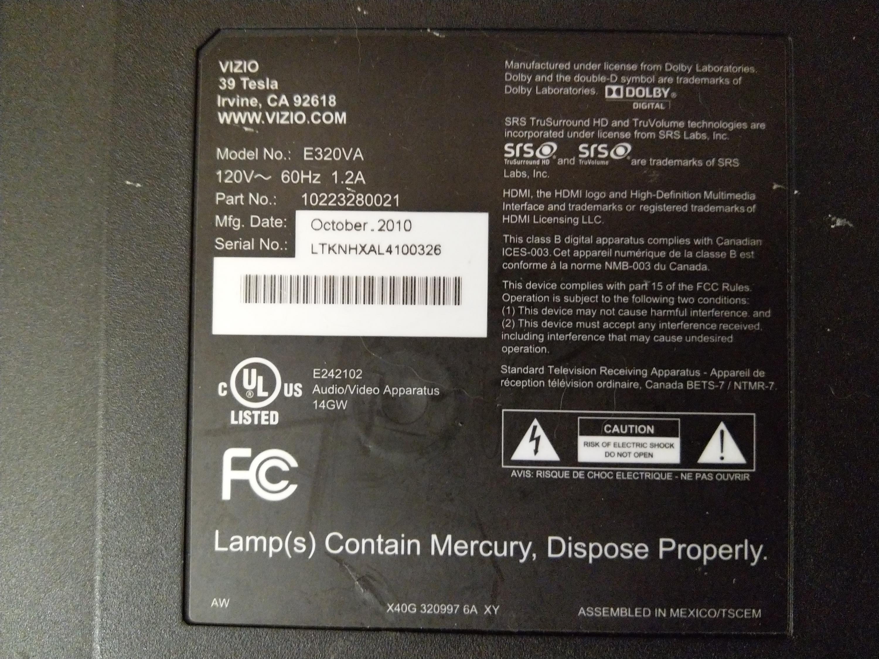

            Main Board small right sticker
            (T)TQACCB 6K00208 - First Image
            Second Image I think is the T-con board driver
            Third Image Sticker on back of TV
                Ok, yes it matches up with the first part of your serial number.

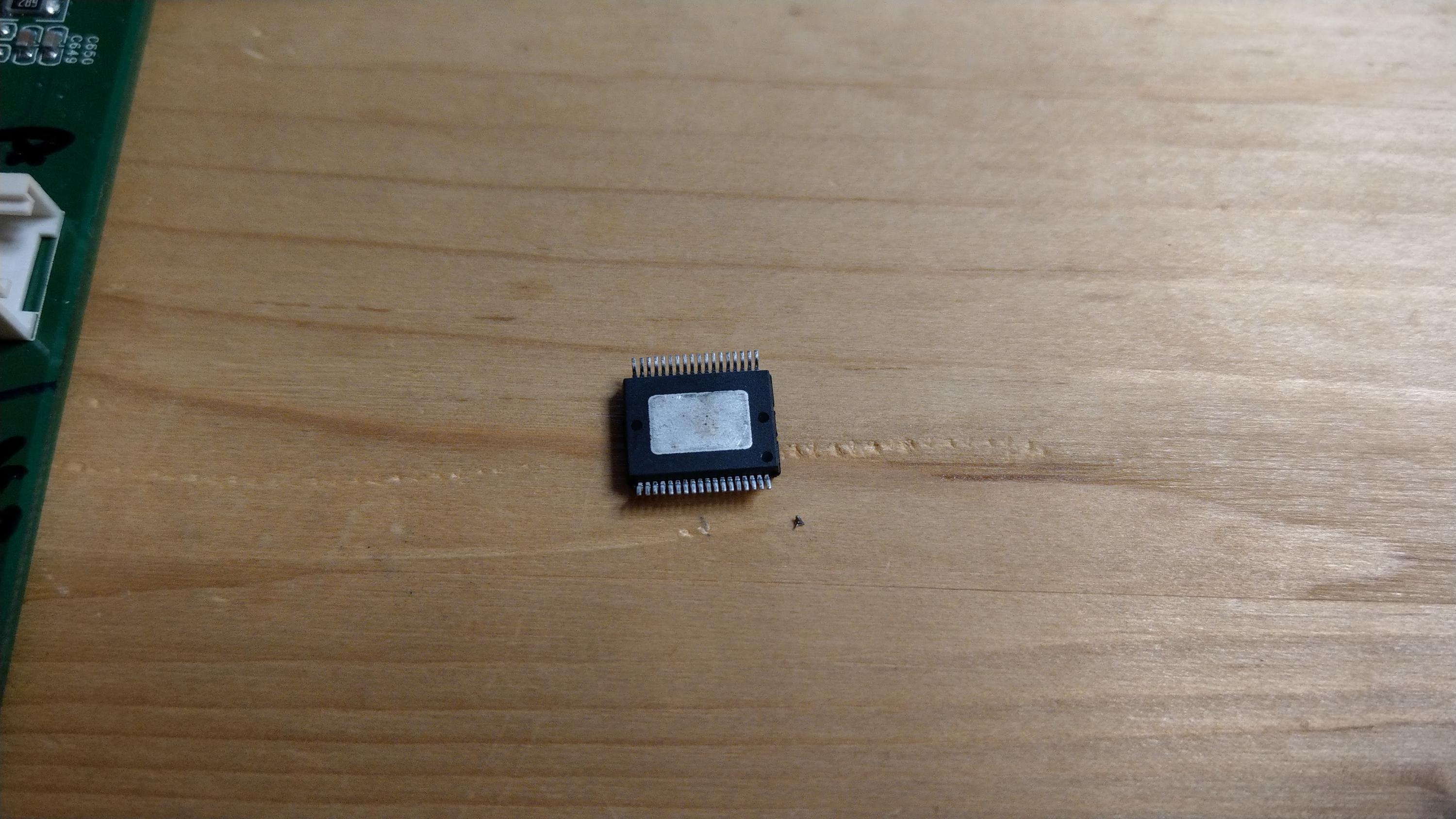

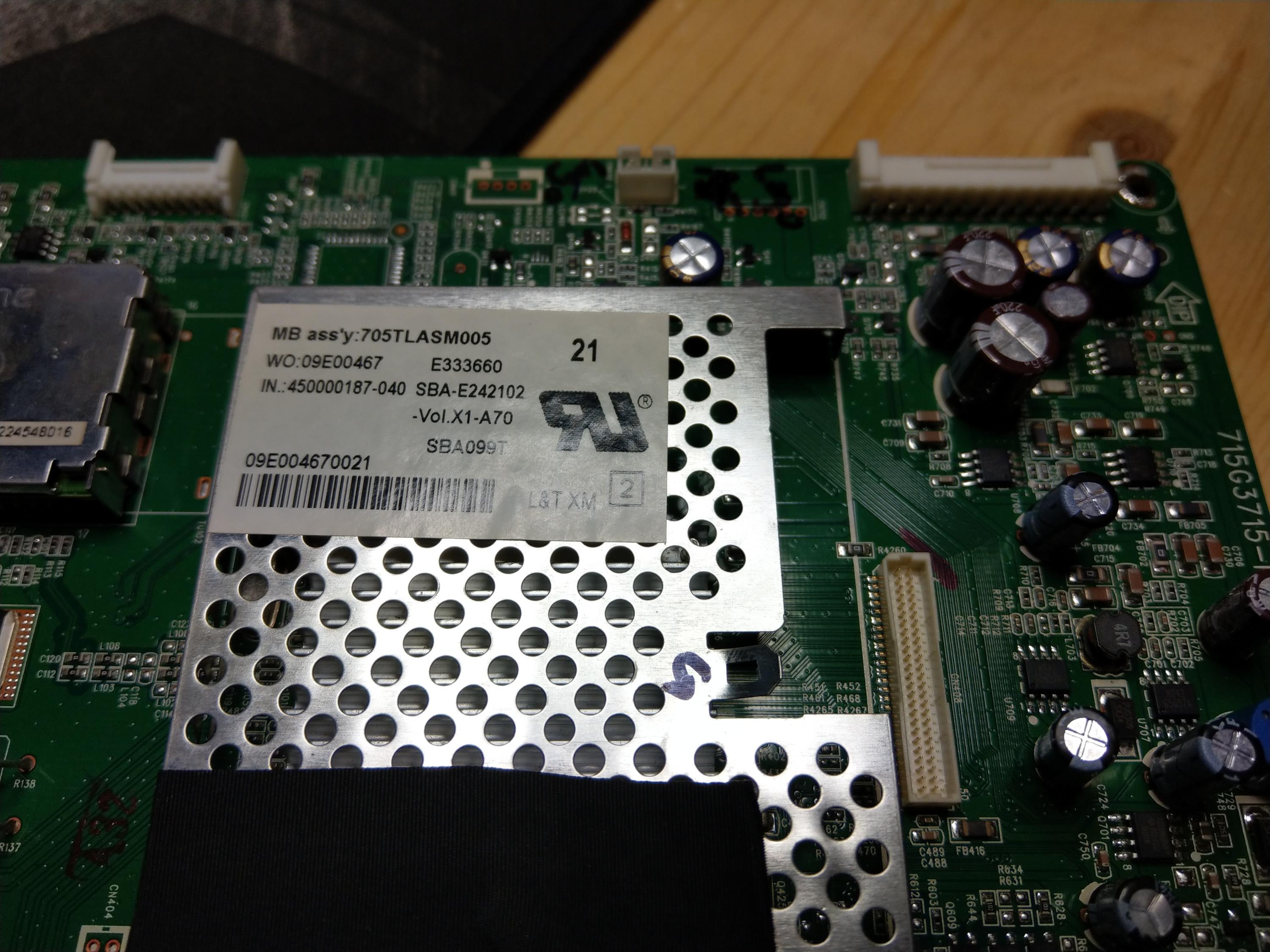

                  Okay Should be final Question lol. I got my new chips today and the audio chip "U602" has a metal plate on the under side of the chip. does this mean that it is soldered underneath the chip?
                  I'm leery to try and remove this chip since I'm not sure, and all I have is a soldering iron and not sure how to desolder this. Also how I would go about soldering it back to the board. If I get it removed

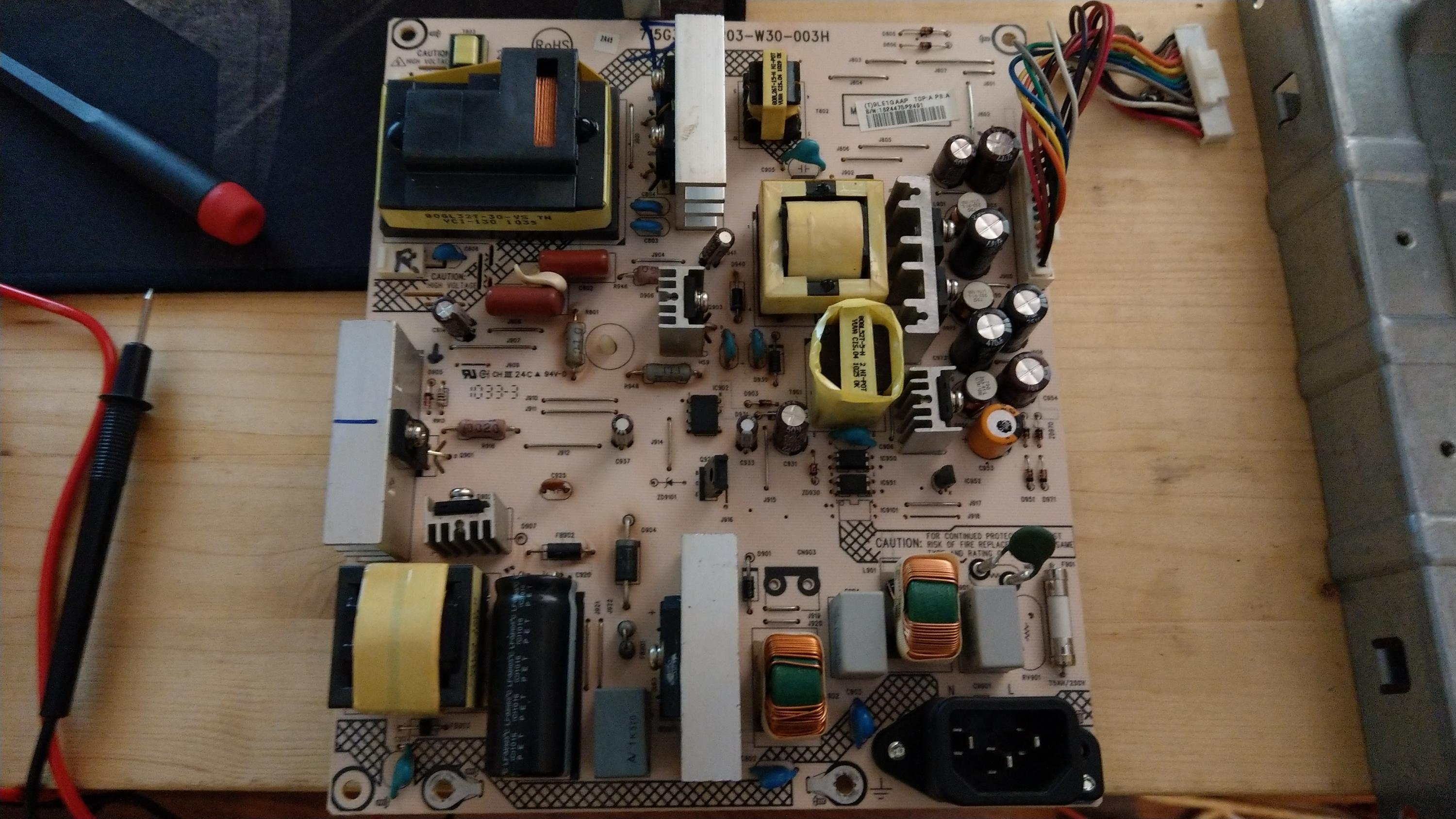

                      Could be a separate issue with the mainboard. Usual place to start troubleshooting unless you have a real good idea is the powersupply voltages. Look at the second video in my signature, HEED THE DEADLY VOLTAGE WARNING.
                          I would check the LED's. If you turn the tv on and press the menu button then hold a flashlight up to the screen and see if you have the menu showing.
                            Never mind. I did not see the picture with the led's lit up

                                  Check your solder work over and check for bad solder joints all over and underside of mainboard.
                                  • nomoresonys
                                    • Jan 2013
                                    • 12331
                                    • U.S.
                                    Get the hair dryer out and heat up the mainboard, see if anything changes, if it does you're closing in on the faulty area.
                                      So it's 2 seconds to black, could be a backlight issue.

                                        Do the testing in video post #16, do it just like he does it and do the flashlight test in post 13. There's a tcon test you can do too.
