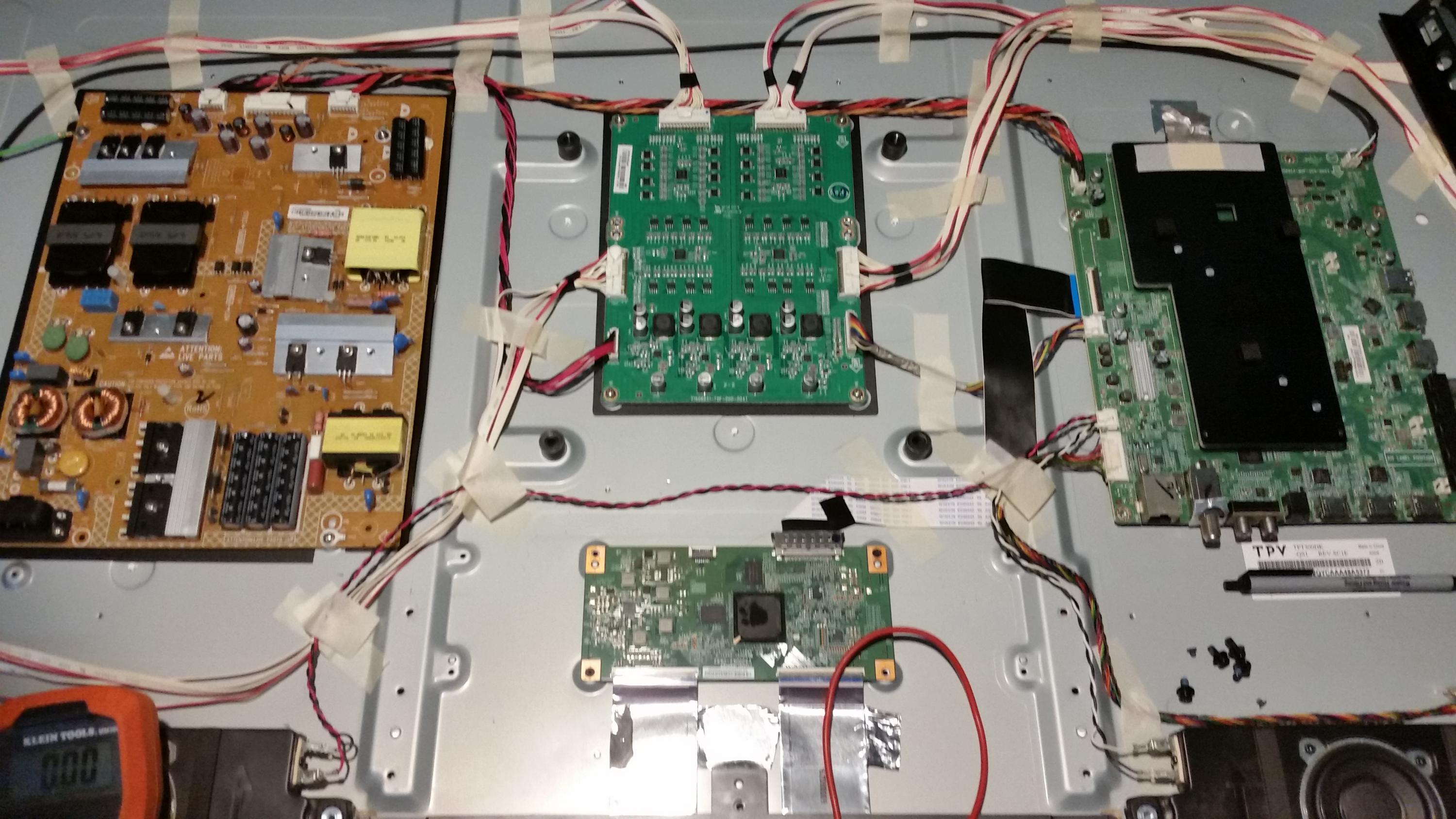

    budm you saw that i explained i measured the EN pin as you asked and it never spikes?
    and ok i will get that picture
    Don't fear the repair...
    • budwich
      • Jul 2015
      • 3097
      #62

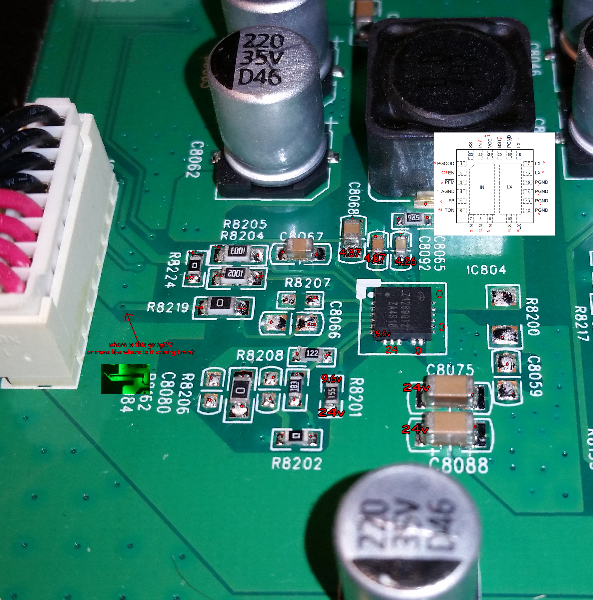

      Re: Vizio P502UI-B1E has no backlight, no voltage from driver board to LED's
      triplefour.... budm's picture shows the '220" or something resistor but your picture shows a "0 ohm" one which is either a jumper or fuse depending on design. Are you checking the "EN" on the side closest to connector?
          heres some pics.. i wish there could be more posts per page

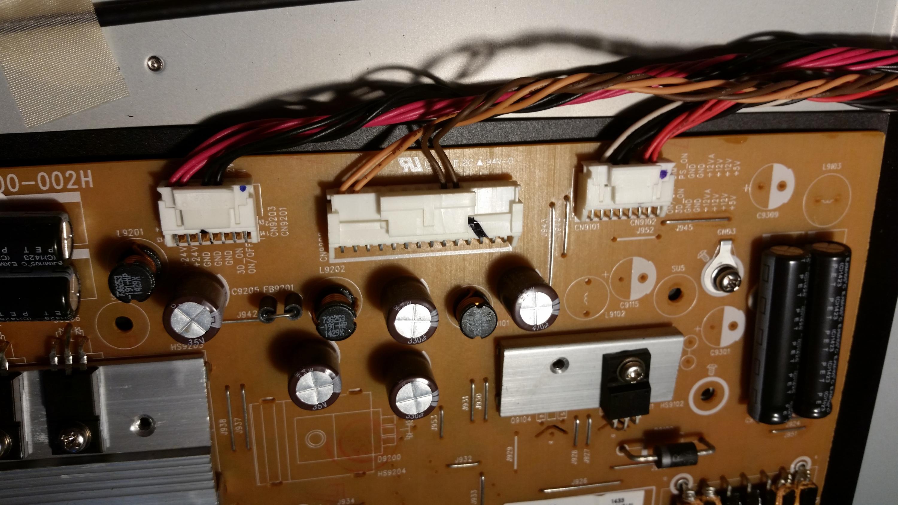

                        If you need more voltage comparison i will still be watch this thread. Always learning something.
                          #72
                          Connector CN805 on the LED driver board is the one that gets the BL-ON and dimming control signals from the main board.
                          I can see 6 small signal traces.
                          Can you read the P/N of the LED driver IC's (4 of them)? I.E. U301 to find the spec sheet to find out which pin is for dimming control.

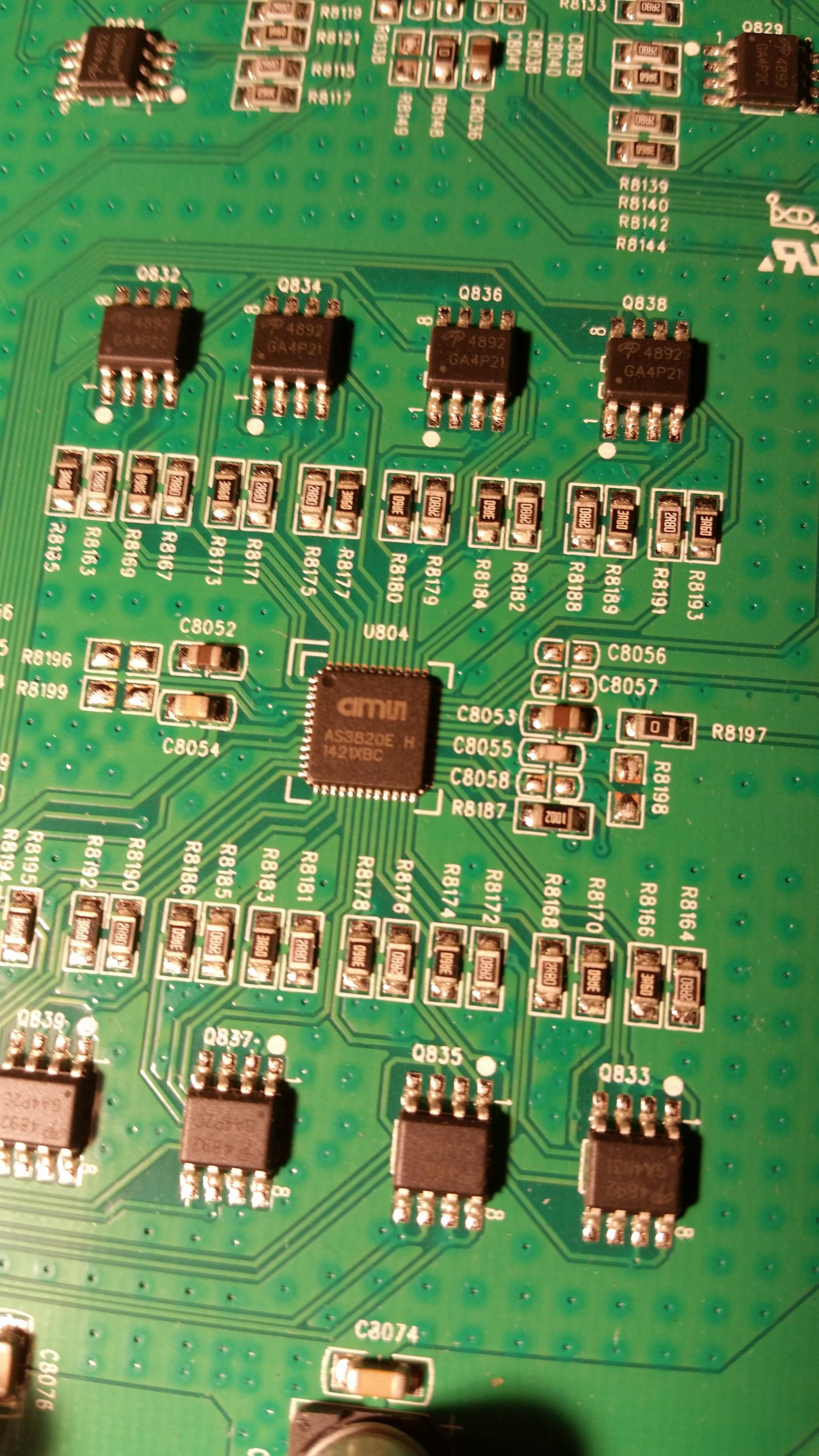

                            #73
                            i know it doesnt apply to my problem (yet) but im happy to help
                            i think i see
                            AS3820E H
                            1421XBC

                              al1415 could you verify the voltage you have on the ENable pin (pin2) of IC804? easiest way to get is to measure either side of R8219
                              and also if you can, the voltage on C8067 (which is connected to the SS pin)
                              just to see how this IC is actually working, if i am supposed to have voltage at the enable pin for "normal" operation.
                              thank you
                              • al1415
                                • Oct 2012
                                • 39
                                • usa
                                #75
                                R8219=4.1
                                c8067=1.8
                                • al1415
                                  • Oct 2012
                                  • 39
                                  • usa
                                  #76
                                  Budm the chip numbers are:1Z690l2 and ZA4S16. Look for data sheet could not find by either number.
                                  • triplefour
                                    • May 2014
                                    • 1747
                                    #77
                                    al1415 thanks, so i guess the enable pin DOES have to be on..as well as the SS
                                    im thinking those voltages must come from the mainboard and correspond to the 2 im missing on CN805

                                      i think i see
                                      AS3820E H
                                      1421XBC
                                      https://www.dialog-semiconductor.com/products/as3820
                                        #79
                                        Your P/N is not same tripefour in post 73
