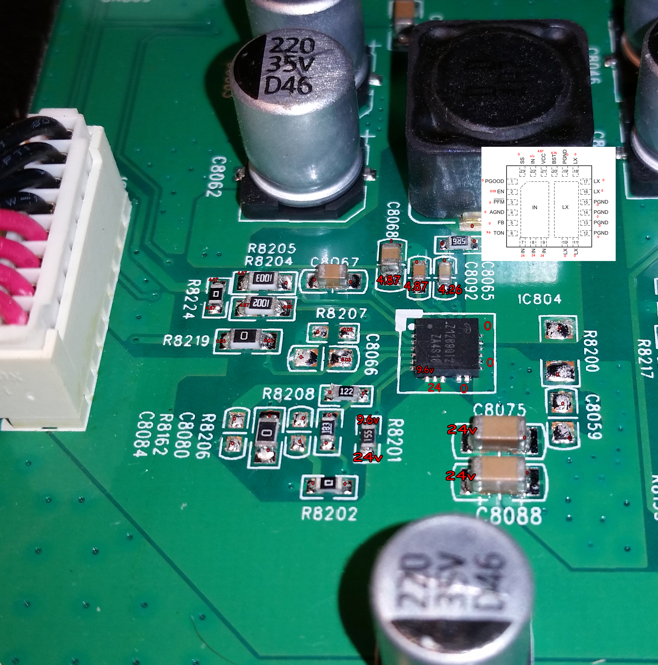

        Re: Vizio P502UI-B1E has no backlight, no voltage from driver board to LED's
        i cant see that resistor either lol even with my glasses on maybe its the 122 marked one?
        • triplefour
          • May 2014
          • 1747

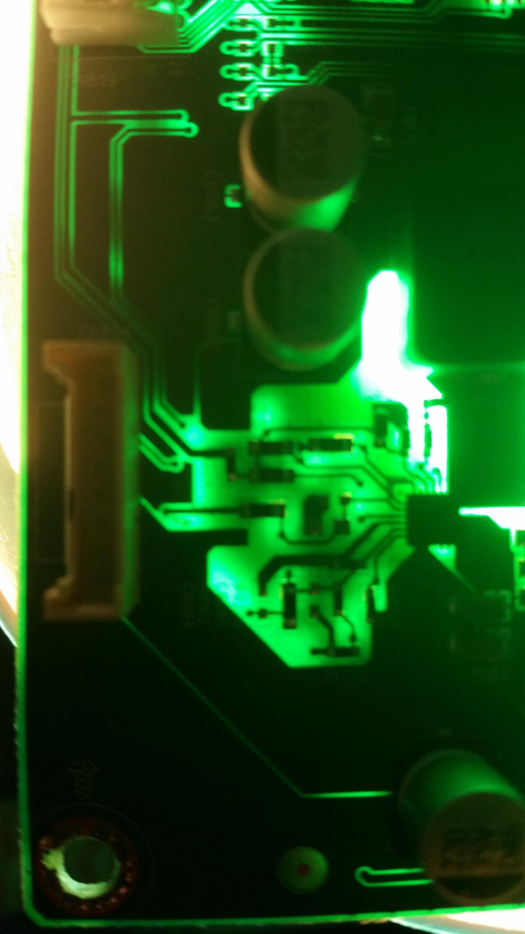

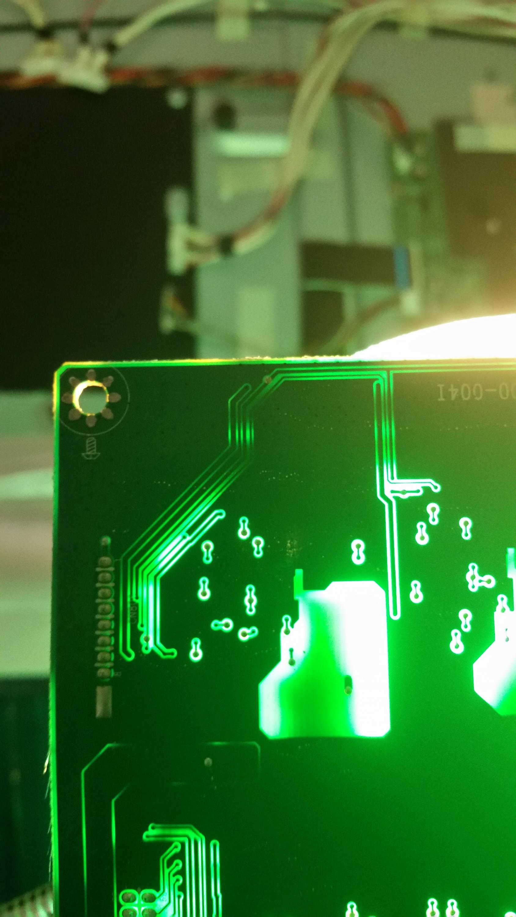

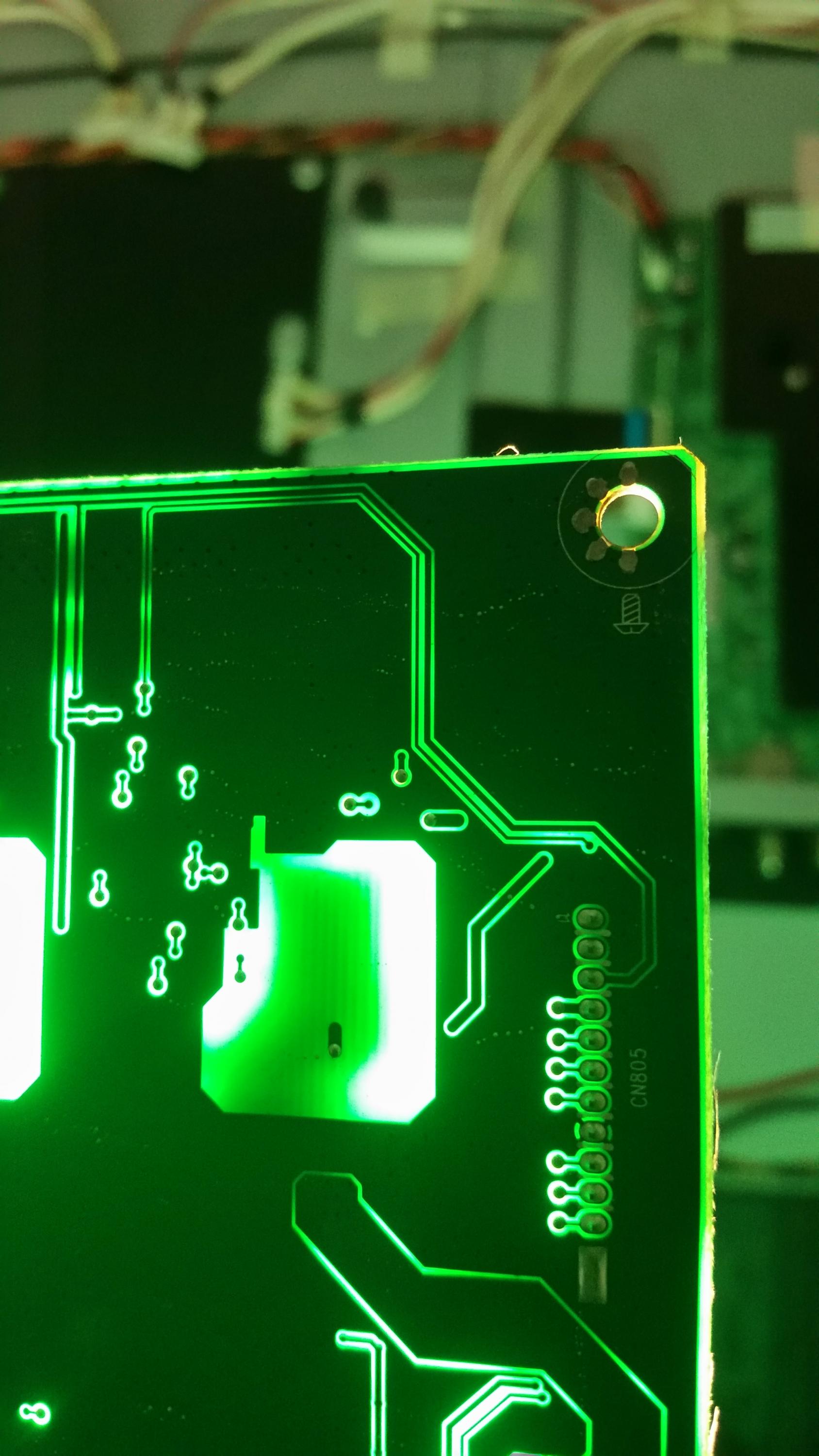

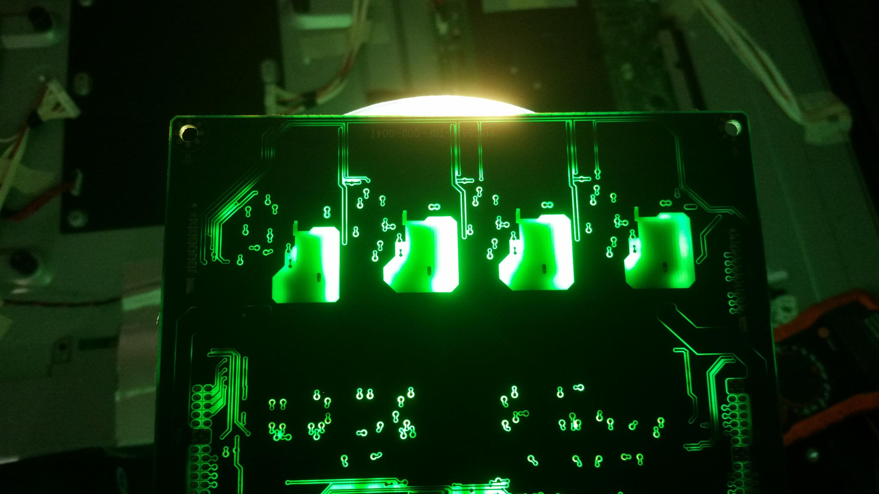

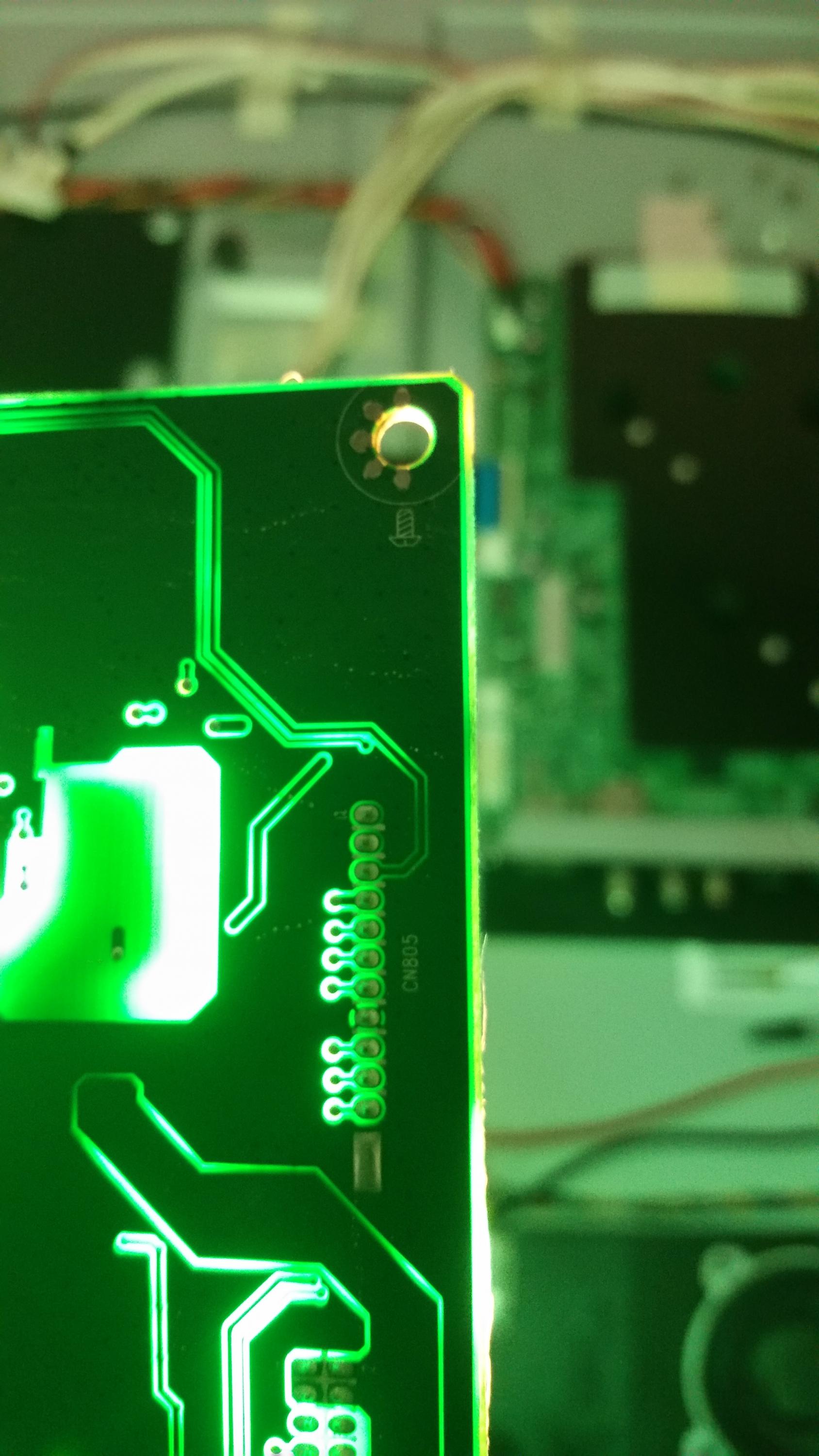

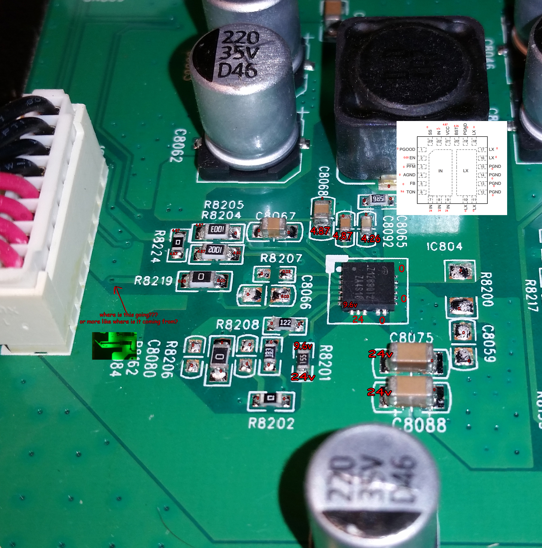

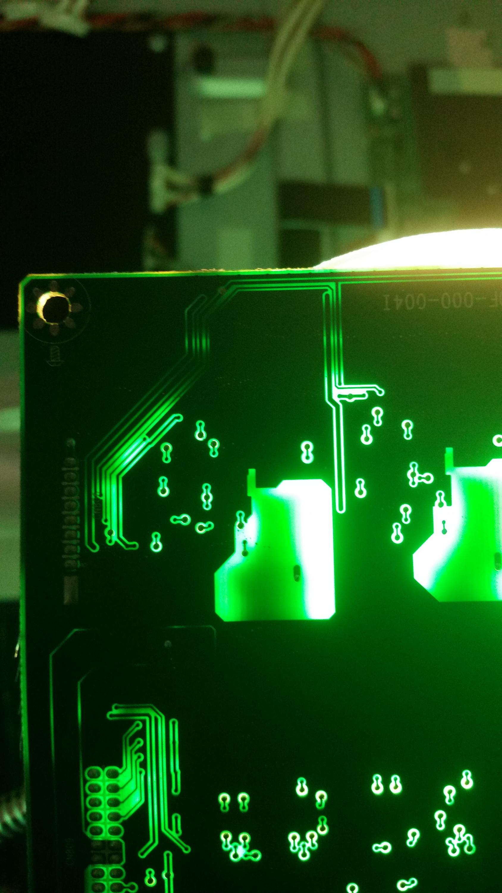

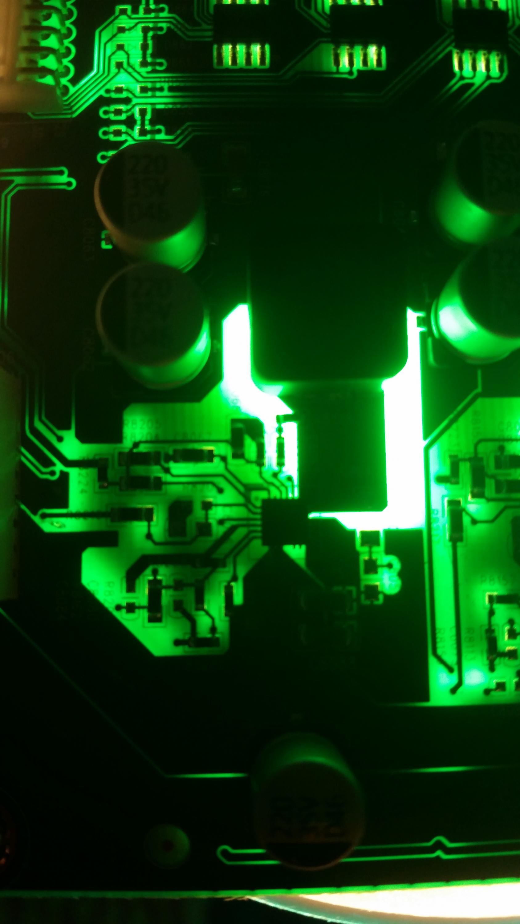

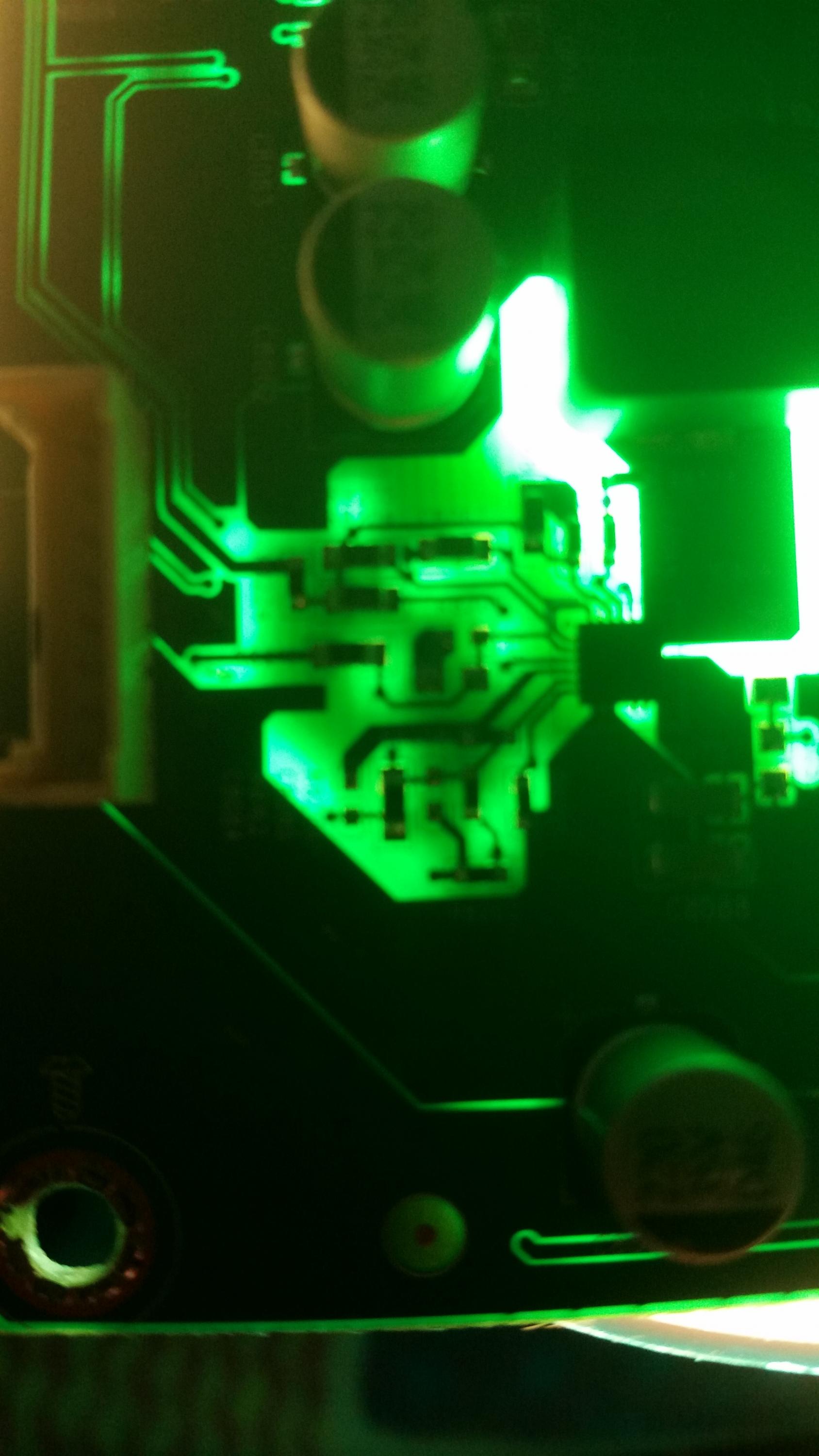

          you can see the markings clearly in the photos i took if you zoom in. there is no resistor marked 220
          here are some "see thru" pictures (light behind the board)
          i also did it for the underside of the board (which there are no components, but some traces)
          im getting 0 on that whole line leading to the EN pin, and where that line starts i cant tell because it just disappears right there near the connector. how can i tell where it "jumps" to?
            re-checked and labeled all voltages.
            some observations:
            the PGOOD pin is 0
            it comes from R8205 which says 1003 on it which is 100k
            on the left side of it we have 4.87 but on the right we have 0.
            should it be 0? or could this resistor be bad? or is 4.87v going thru a 100k resistor always gonna end up with 0? my math not so good
            the resistor checks out at 100k tho so i dont think its that...
            just poking around half blind here
            and i am seeing a very small voltage 0.03 on the EN pin and the resistors leading to it
              Does the resistor marked 1003 test ok? 4.87v one side 0v the other
              • triplefour
                • May 2014
                • 1747
                i noticed that as well, and edited my post probably while you were typing yours
                "the resistor checks out at 100k tho so i dont think its that...
                just poking around half blind here"
                also the 1002 resistor checks out at 10k as it should
                according to the data sheet, i should expcet to see ~5v input to the vcc pin, and then some kind of voltage out from the PGOOD pin. im getting 4.87 to vcc so that seems good (but i cant really tell where this 5v is coming from since the only input to this board is 24v from the psu... it seems like it comes from the northern part of the board somehow, not from the connector CN806) but i am not getting any v out from the PGOOD pin...
                of course im not so great at making sense of what it says in datasheets...struggling to understand!
                but something funny is going on... Im getting 24v on the three IN pins, but the enable pin needs to be high, not low. output from LX cannot happen without this. also if LX is not outputting, then PGOOD will be missing as well.
                so what enables the enable pin :???? and can i, or should i trick this pin to go high?
                i trace the enable pin and it goes to what appears to me as a dead end. maybe someone knows better ...

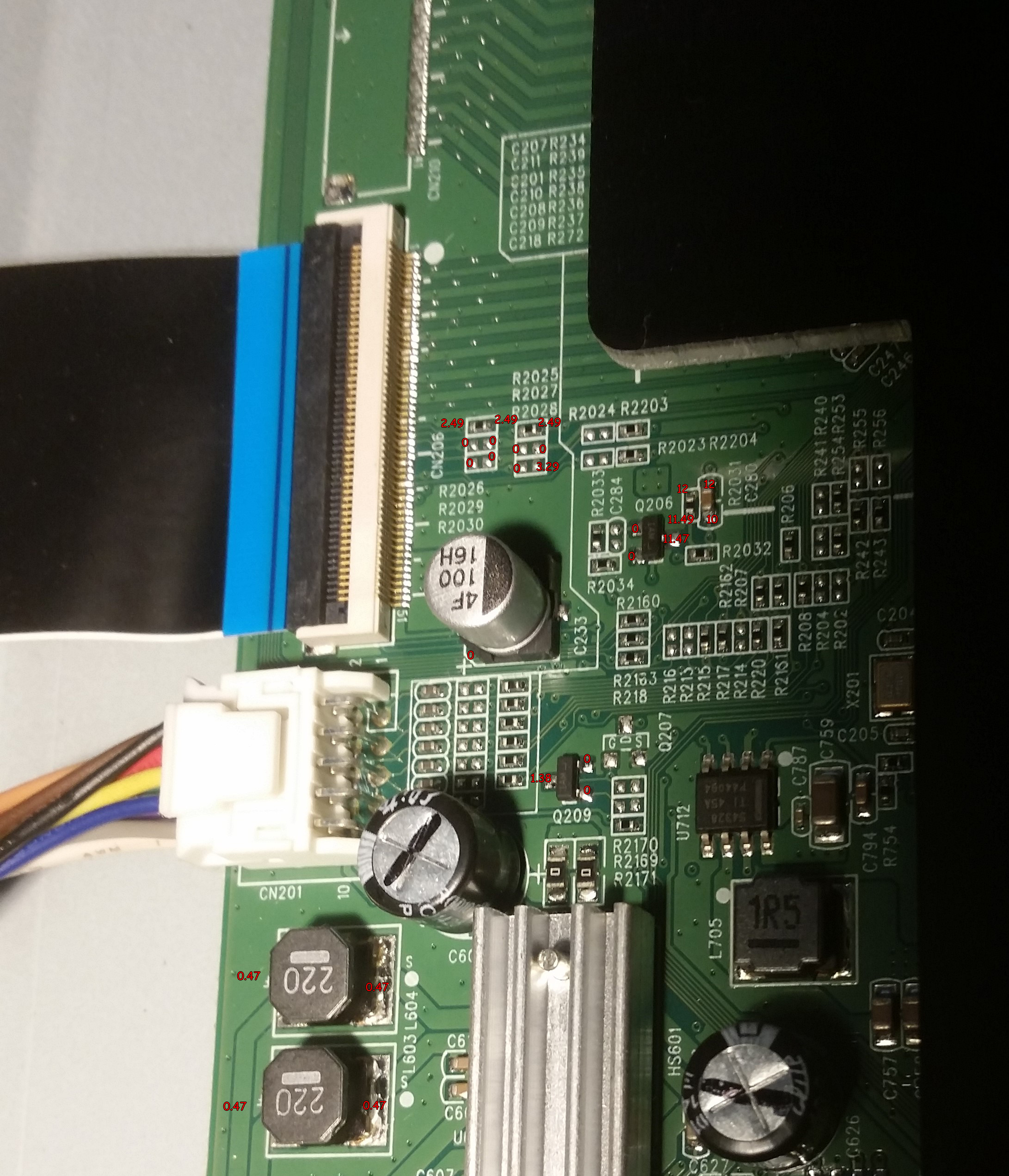

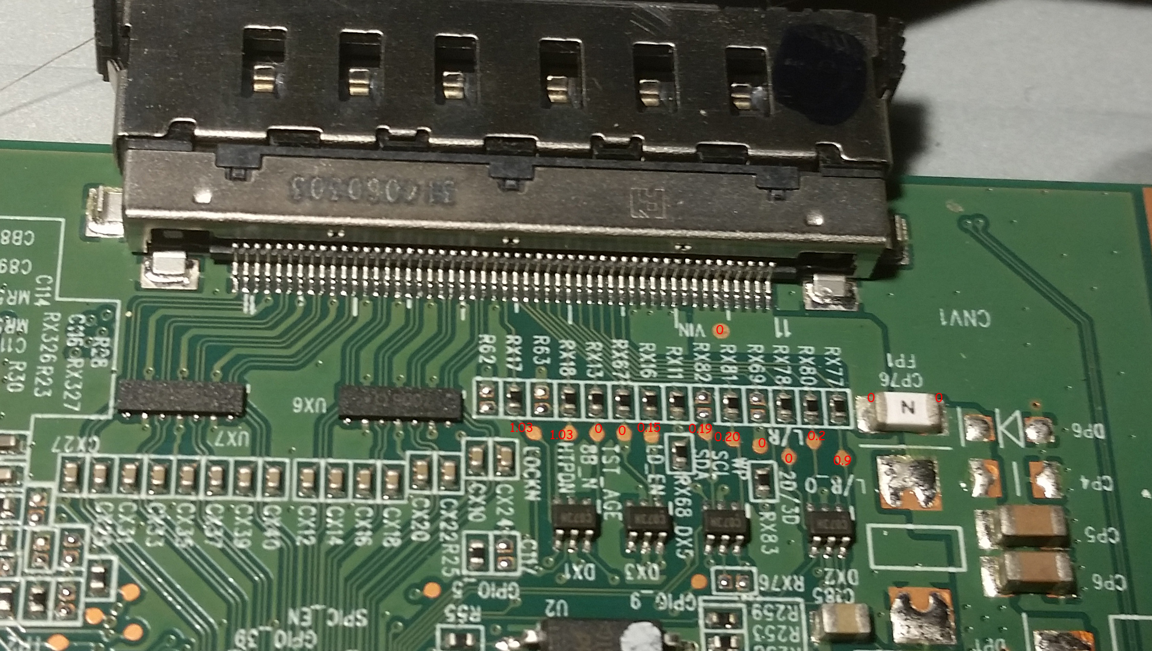

                            started looking at some mainboard voltages now... specifically near the LVDS connector going to the TCON since it seems like we're not getting much there, or on the TCON itself for that matter.
                            these voltages also drop when the mb resets
                            actually the 12v ones dont drop, only the lower ones and the ones on the tcon itself drop when the mb resets
                            and actually when i checked the voltages a second time, the ones that i had written down as 2.49 are now only like 1.09
                            and shouldnt that 4F 100 16H cap have some voltage on it?
