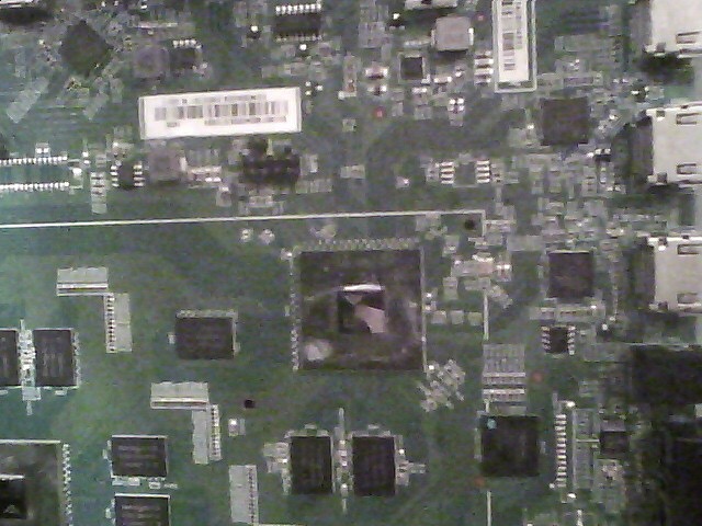

                              I'm going to chime in here that I have the same TV with identical symptoms to triplefour. My backlights do not try to fire at all like al1415. I have tried replacing the EEPROM with no luck.
                              I'm interested in some other ideas also. The fact we never get the BL_ON (or EN to U801-804) really seems to point to the main board not doing something. I'm open to suggestions for what to check. I noticed on my main board at least the TCON_ON signal does not act properly either. I manually did grounded the gate of the transistor that controls this and the TCON_12V did end up turning on and going to the TCON.

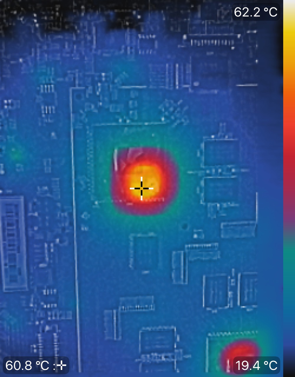

                                Just a follow up to this. I took a couple thermal shots of the main board with the heat sink removed. Everything to me in this post is pointing to the main board, so I figured I would try to reflow the two main IC's. I have access to nice equipment, so I feel comfortable doing this. One certain gets warmer than the other during the attempted power on, but neither give anything definitive. I did not run them without a heatsink for more than a minute.
                                Thermal and normal of IC near RCA/HDMI jacks
                                Thermal and normal of IC closer to TCON and power cables
                                Any other testing suggestions are welcome

                                  Re: Vizio P502UI-B1E has no backlight, no voltage from driver board to LED's
                                  neat what do you use to take the thermal images?
                                  Don't fear the repair...
                                    A FLIR One Gen 2 https://www.flir.com/support/products/flir-one-gen-2
                                    It helps finding shorted components sometimes without using my finger everywhere. Unfortunately, it didn't seem to help much with this problem. Those two chips should be getting warm even when operating normally. I'd really like to have some suggestions on where else to look besides just ordering a new board.
                                    I have an external power supply to try to turn on the LED board, but it seems I would need a couple of them for the dimming and other signals. I'm not sure what voltages I would send over just to try it.
