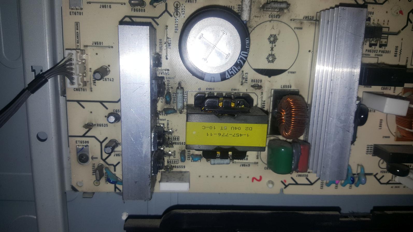

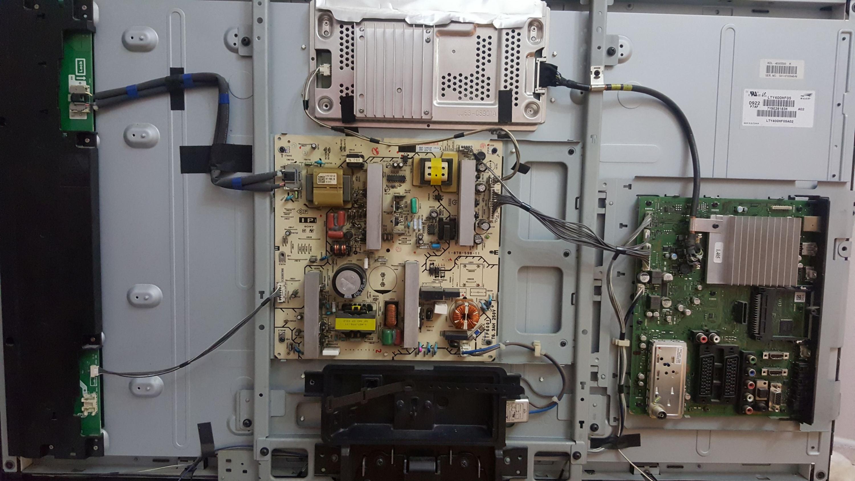

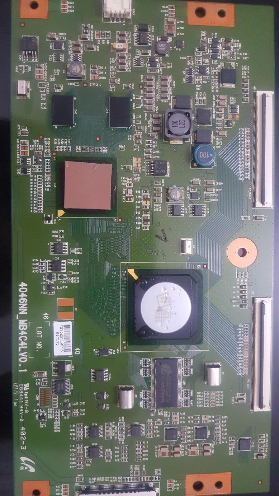

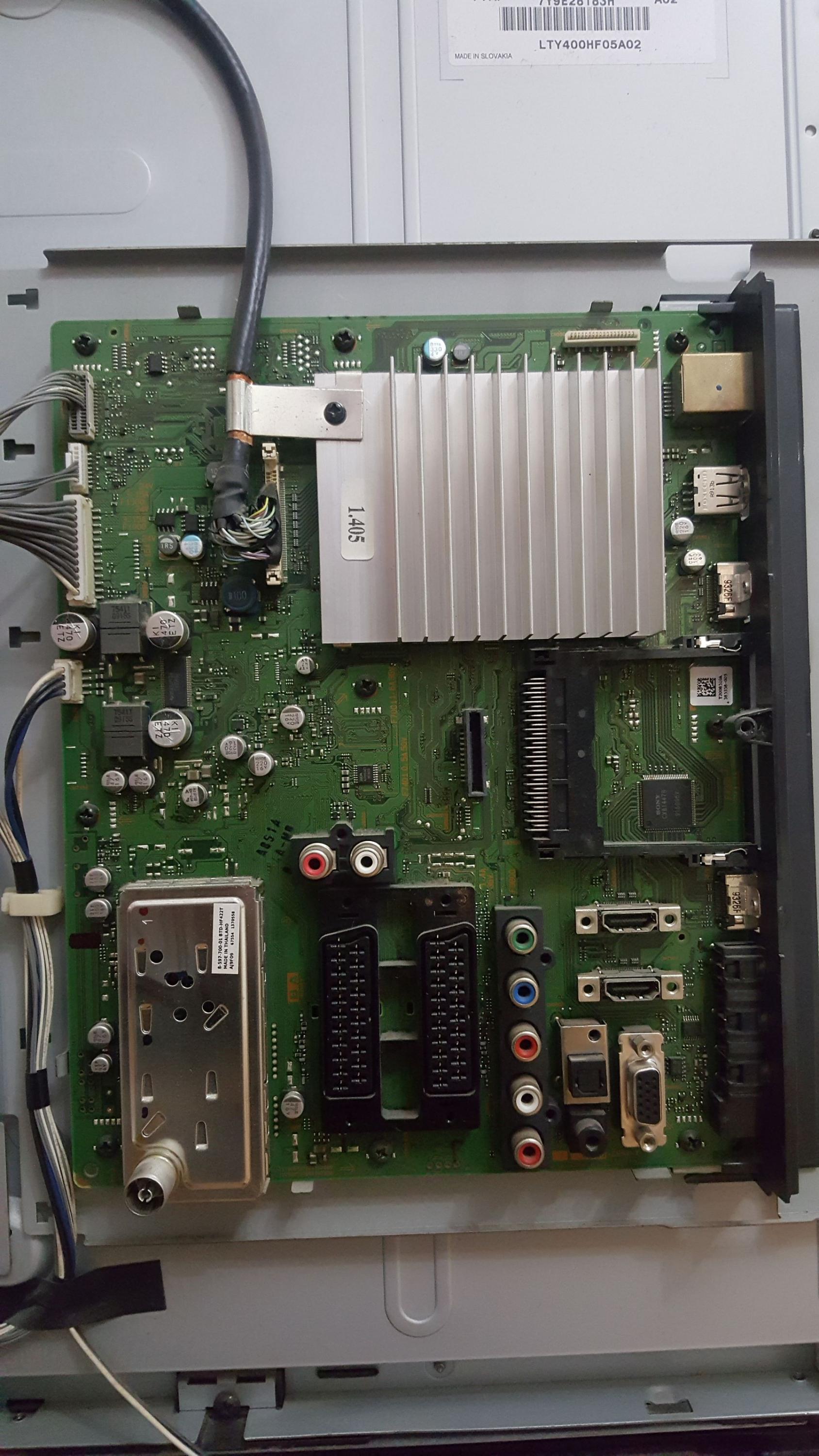

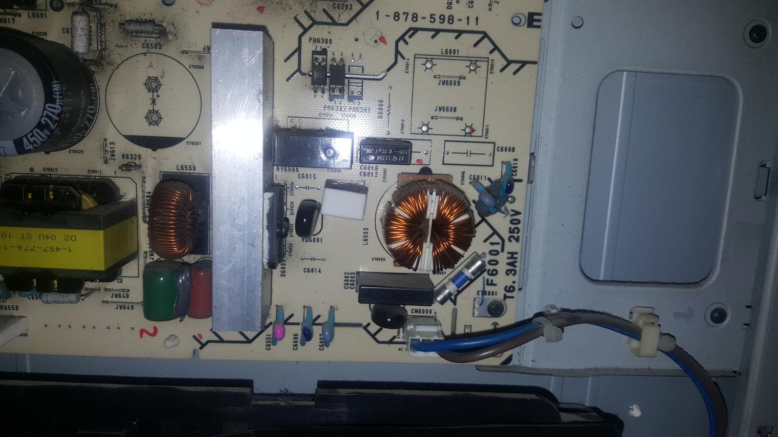

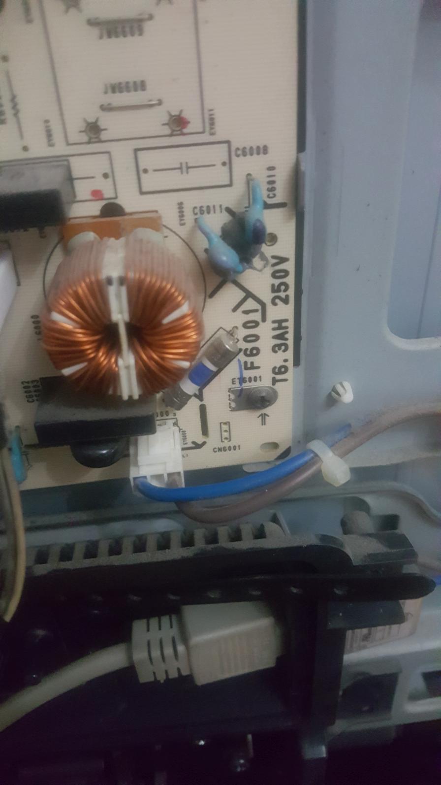

    Problem: After an electrical outage my parents bravia lost all picture and they got the (in)famous 14 blink code. Code indicates T-CON error.
    1) I disassembled the TV and inspected IP1 (power board) and T-CON boards visually. Seemed notheing was off.
    2) Controlled the fuse on IP1 power board and F1 micro fuse in T-CON, no problem.
    3) When I turn on the TV, the panel is pitch black, no backlight. Some relay clicks, T-CON is supplied with 12V from IP1 power board, approximately 10 seconds later there is another click (probably relays) and IP1 cuts power supply and 14 blink sequence starts
    What I want to make sure: How do I be sure the problem is only T-CON and not any other parts? Is there a way to make sure LCD panel, backlight, BA board functions so that when I order T-CON it will not be in vain.
    (I cleaned IP1 power board after taking pictures, sorry)

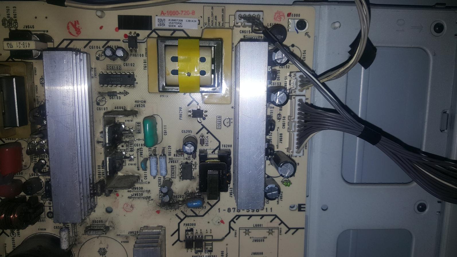

      This appears to be an Inverter or Backlight problem and not a T-CON Bd issue. The Hi-Volt Transformers supplying power to the CCFLs could be faulty also.
      • freakaftr8
        • Oct 2012
        • 3743
        Re: Sony Bravia KDL-40W5500 - 14 blinks problem
        I would look at all resistors and any fuses related to the high voltage transformer section going out to the inverters. Also listen for any faint buzzing sounds from the transformers on the power supply right before shutdown.
        This power supplies on these Sony's have been known to have resistors go open with a high voltage line spike.
        This would be a quick and dirty way to tell if the Transformers are supplying the inverters.
        Also have a look at your backlight on pin from power supply to mainboard. See if voltage comes up then drops off.

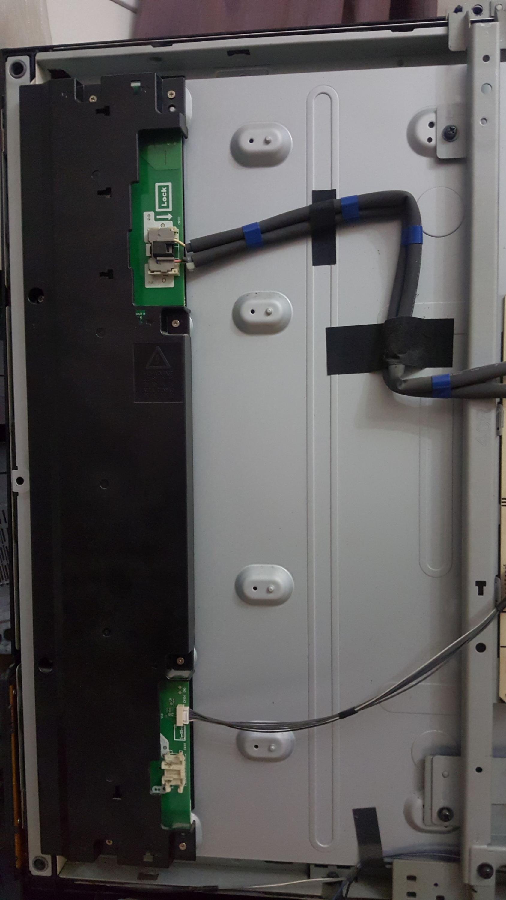

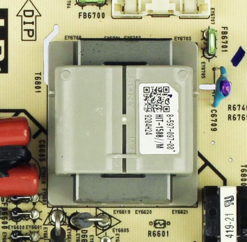

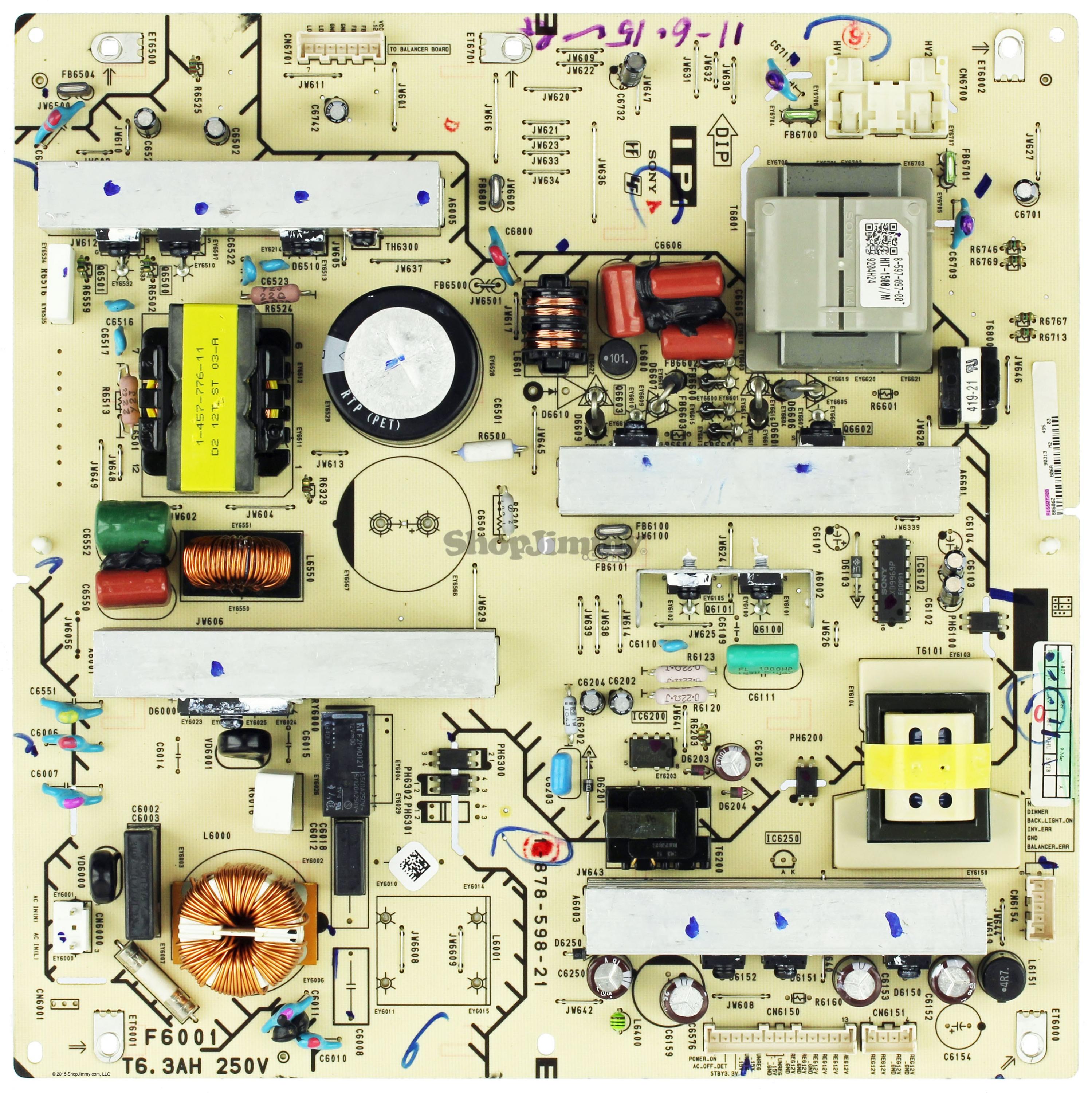

          Can we see the pictures of the whole backside of the TV showing all the boards?

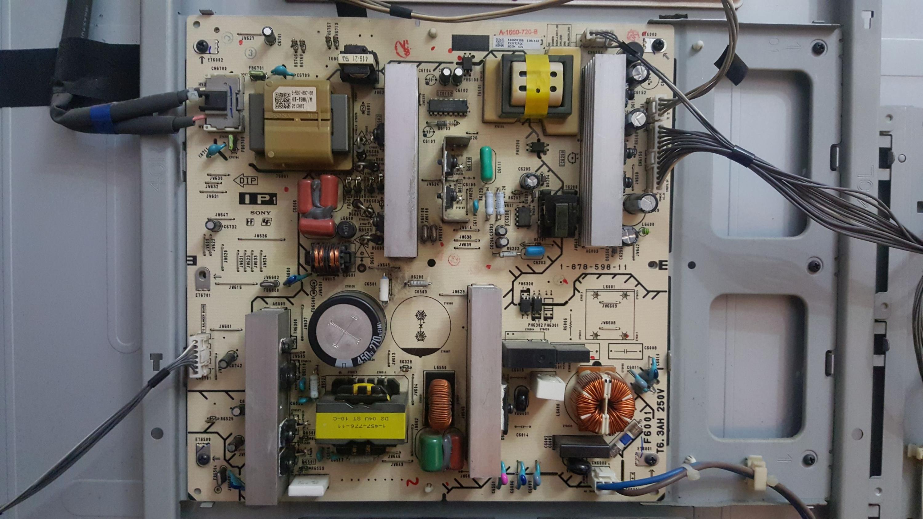

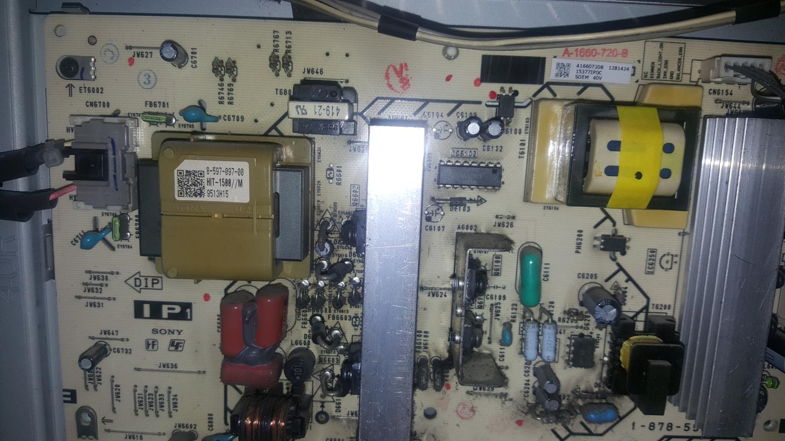

            https://www.badcaps.net/forum/attach...8&d=1520000880
            You need to probe each pin of that connector CN6154 when TV is turned on, you will leave the probe on the pin and then turn on the TV while watching the meter then record the DC Voltage reading then turn TV off, then move on to the next pin. Basically we are looking to see what is going on on each pin when every time TV is turned on.
            Also verify that you do have about 380VDC between the two legs of the main filter cap when TV is turned on.
            This is your power supply-inverter board, correct?
            Sony A-1660-720-B (1-878-598-11, 1-878-598-21) IP1 Board.
            Pictures providedd by shojimmy

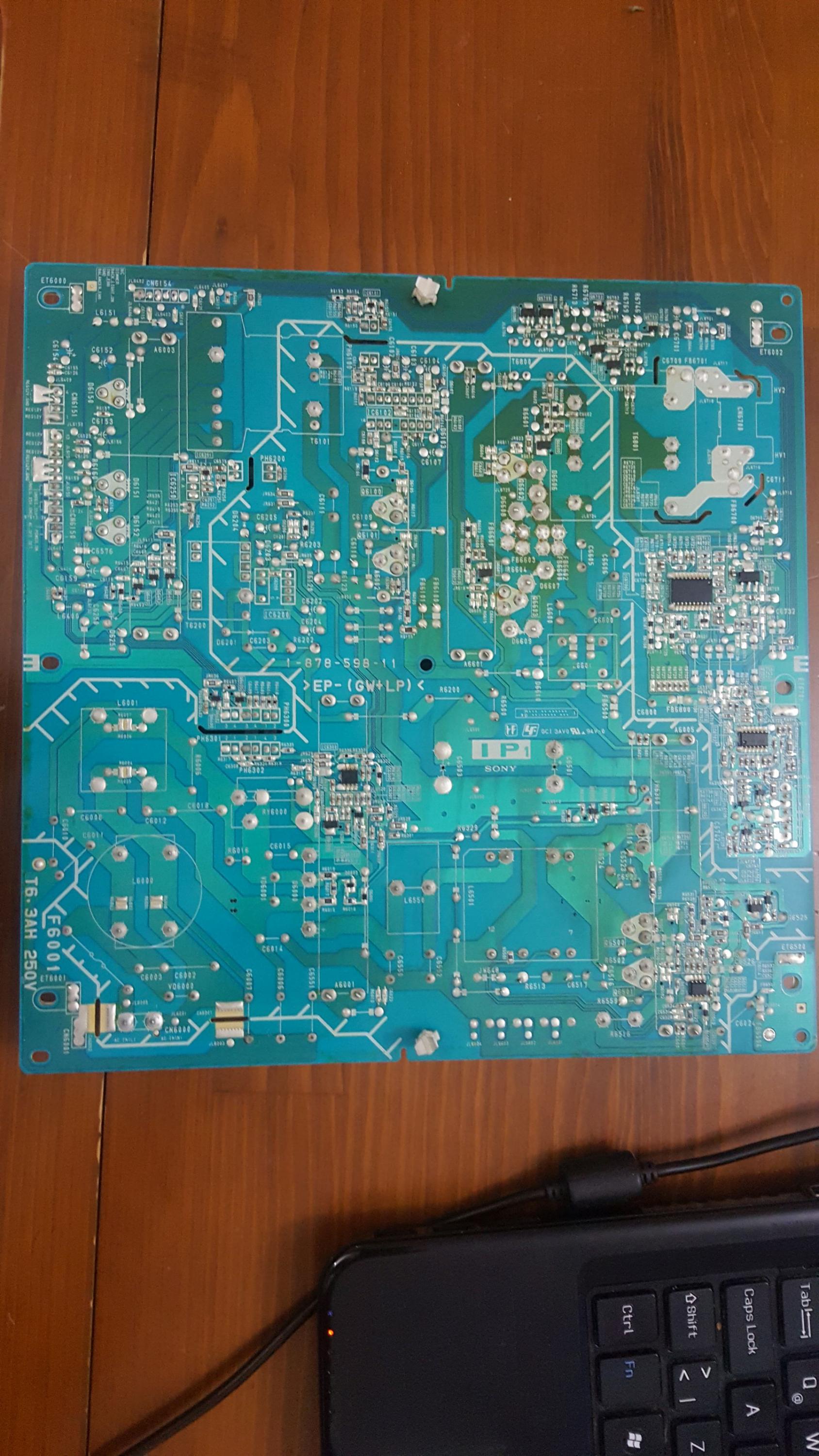

              OK, will disassemble IP1 for checking
              OK, i will try to upload pictures I took in this reply.
              OK, will check connector now, also I assume main filter cap is the biggest one

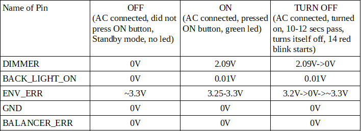

                    CN6154:
                    NC: 2V -> 0V
                    DIMMER 0V -> 0V
                    BACK LIGHT ON 3,2-3.5V -> 3.5-3.0V
                    (when i turn on tv and "->" when it turns off and displays 14 blinks)
                    Also there is NO reading (0V) on CN6700 HV1 and HV2 which connects to inverter. So should i assume problem probably lies in high voltage section?

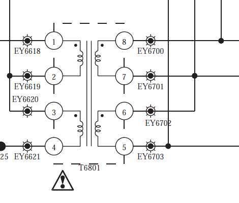

                          Is it normal to have a resistance reading between HV Transformer windings? I got:
                          EY6621-EY6620 0.5 Ohm and shortcircuit buzzing in short circuit mode
                          EY6618-EY6619 0.5 Ohm and shortcircuit buzzing in short circuit mode
                          EY6700-EY6701 30 Ohms no shortcircuit buzz
                          EY6702-EY6703 30 Ohms no shortcircuit buzz
                            Those readings of the windings will be really low because they are DC resistance (DCR) especially the primary windings.
                            At this point you need to make sure you have the correct Voltage and the command signals for the circuit to run first.
                            How about the DC Voltage on the main filter cap when you turn on the TV/
                            If there is no boosted Voltage the there will be no H.V. output.
                            BTW, do not measure the H.V. on the output of the inverter transformer, if the inverter comes on it will damage your meter since the output can be as high as 2000VAC!
                            CN6154:
                            NC: 2V -> 0V
                            DIMMER 0V -> 0V
                            How about the Voltage on the ERROR pin?
                            You have 5 pins on that connector but I cannot tell how many wires are attached to that connector using your pictures.

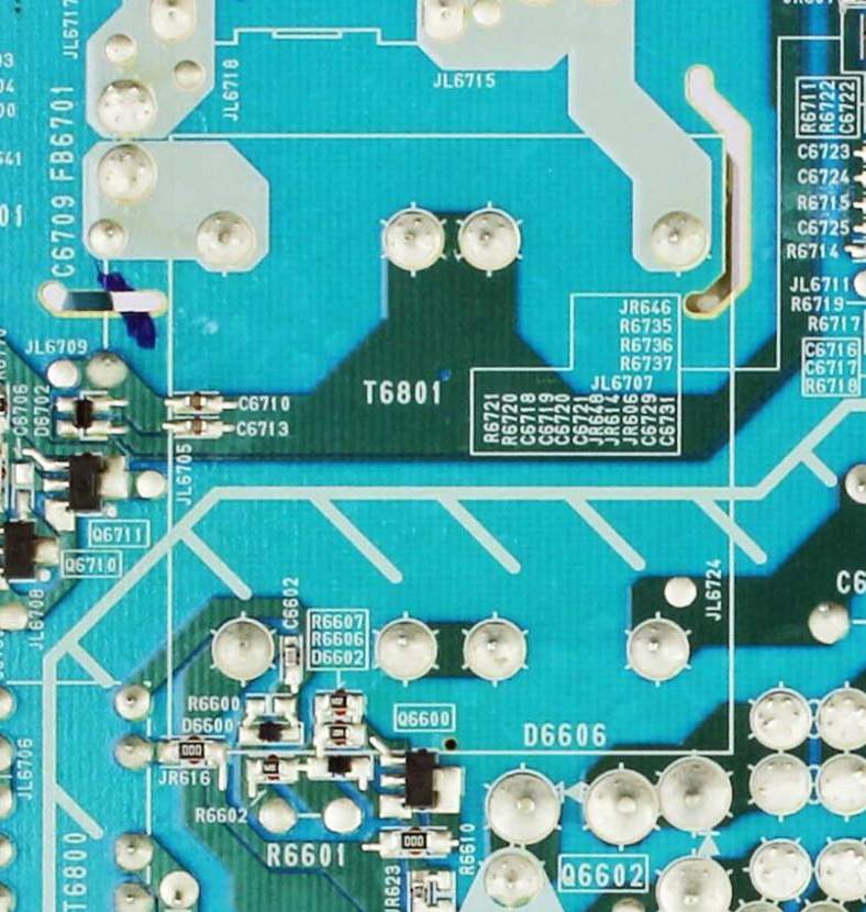

                              BTW, if you do have 380VDC between the two legs of the main cap then check that resistor R6700 (4.7 Ohms) which feeds the 12VDC for the GATE drive circuit for the MOSFETs that drive the primary of the inverter transformer.

                                CN6154:
                                NC: 2V -> 0V
                                DIMMER 0V -> 0V
                                Sorry, messed measurements. There is no NC (as intended).
                                First main capacitor C6501 is around 308V
                                Then measurements for CN6154 pins (All other boards connected to IP1 power board, measurements of CN6154 from IP1 side) as a attached table.
                                Inverter error fluctuates around 3.3V, when AC plug connected to grid, again fluctuates around 3.3V when TV is turned on, after TV shuts itself and error red led starts blinking, it statys around 3.3V for 1-2 sec then quickly gets down to 0V and again after 1-2 sec it rises to around 3.3V again.

                                  Only 308VDC on the main cap? Your AC Voltage for your country is 230VAC, correct? Then the DC Voltage between the two legs of the cap should be around 230VAC x 1.41. = 325VDC unless you incoming AC is not at 230VAC.
                                  Since you do not have 380VDC when TV is turned on then you have problem with the power supply board, that section of the power supply has to be fixed first to get the correct Voltage to run the inverter circuit.
                                  Since you have the schematic then you just have to start checking the power supply board next. Make sure that you do have PS-ON present for sure when you turn the TV on.

                                    Hello budm, sorry far late reply, weekend, daughters volleyball sessions, etc.
                                    Our mains is 220VAC, measured mains, it was 224VAC, main CAP was 304V DC when plug connected to supply, 389VDC when TV turned on, till 14 blinks.
                                    Will start to check power board.
