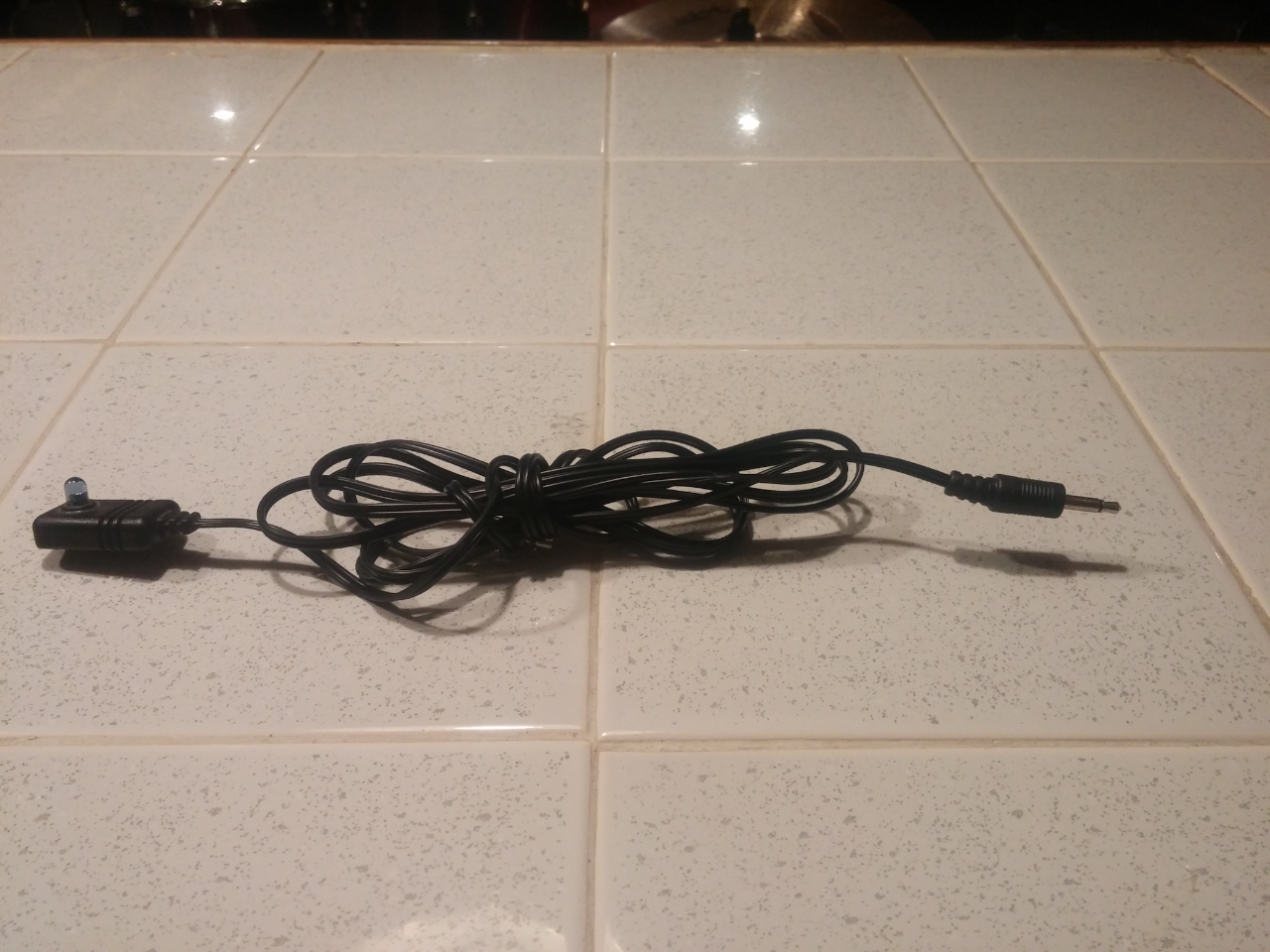

    Is there another way to get into the hidden service menu on an LG 50PS60 ? I have tried the menu/menu & enter/enter but nothing comes up. I'm trying to find how many hours are on the TV.

        you might have to have a "service remote" for newer lg's. further, there is a few threads here that provide links to "making your own service remote" via playing a wav file on your computer that puts the resulting output thru to the output jack to a "ir diode"... thus "simulating" the required service remote sequence.

          I found a old rf repeater remote system in my junk pile and plugged the ir diode into my computer and played the "instart" and "ezadjust" sound file and it worked, got me into the service menu's.
