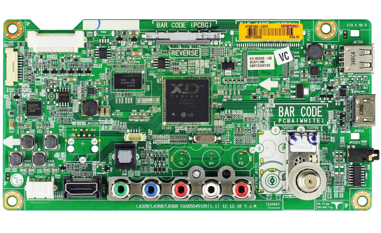

    Here’s a photo I found of the exact mainbord in my set. Currently have it assembled and since one HDMI works for now don’t have any urgency to take it apart again but I’m curious on any feedback or possibly someone that encountered same issue and resolved it so if HDMI 2 stops working I know where to start looking

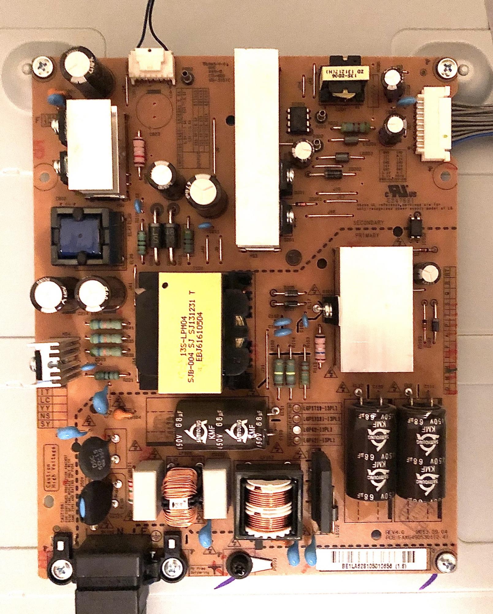

                  So I found an exact main board replacement on eBay cheap which I purchased. Now with the new one I have different symptoms. No flashing standbylight, no light at all actually and the only voltages I measure now are the two 3.3v.
                  With my original mainboard I get all voltages 3.3v 3.3v 12v 12v and 24v and the standby light would flash twice before going out completely. No backlight flicker at all with either mainboards. Possible I purchased a faulty mainboard?

                    Re: LG 42ln5300 - Only 1 HDMI Input Work
                    Sounds like the new board is not sending out the PS-ON signal to turn on the rest of the power supplies.
                    You need to check the Voltage on all the pins of the power supply connector that goes to the main board to see what are there and not there.

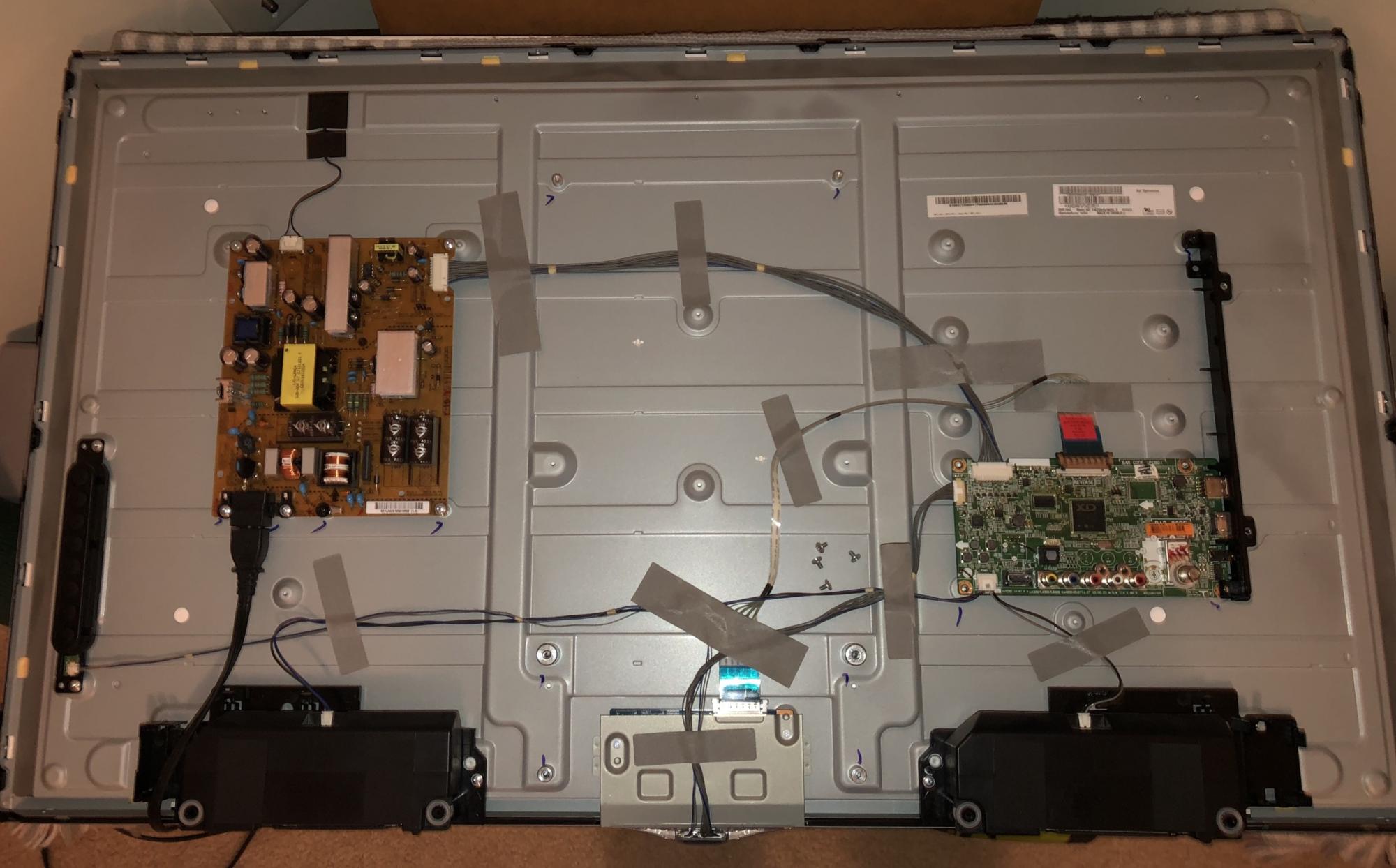

                        Show us the pictures of the whole backside of the TV showing how all the boards are connected, then good clear straight shot of the power supply board, the connector should be labeled to tell you what each pin is for.
                          Ok here are some pics. Best I could do right now with lighting. Let me know if you need clearer ones I'll try during the day.

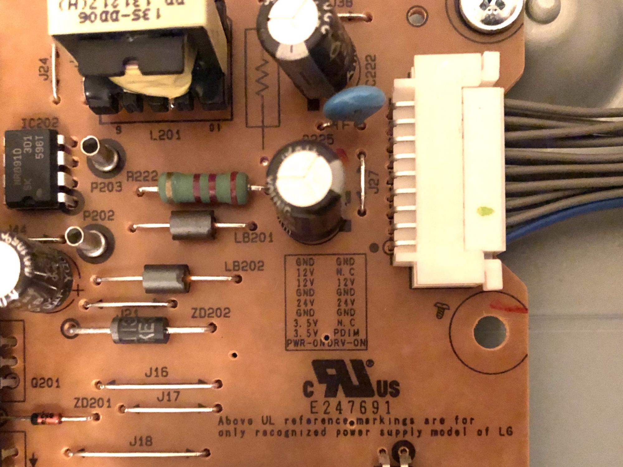

                            https://www.badcaps.net/forum/attach...1&d=1577585031
                            The exposed pins you can see from the top side of the board are the odd number pins (Left column of the pin's chart). To measure the EVEN number pins you will need to use skinny probe to probe the connector at the wire entrance side of the connector, but for now we are interesting in the PWR-ON pin.
                            As you can see, the pin with the black dot is pin one and it is corresponding to 'PWR-ON' (same as PS-ON), it should be around 3VDC for the 12V/24V power supplies to turn on.
                              Ok and the mainboard provides this 3.3v right? So the mainboard has a fault?
