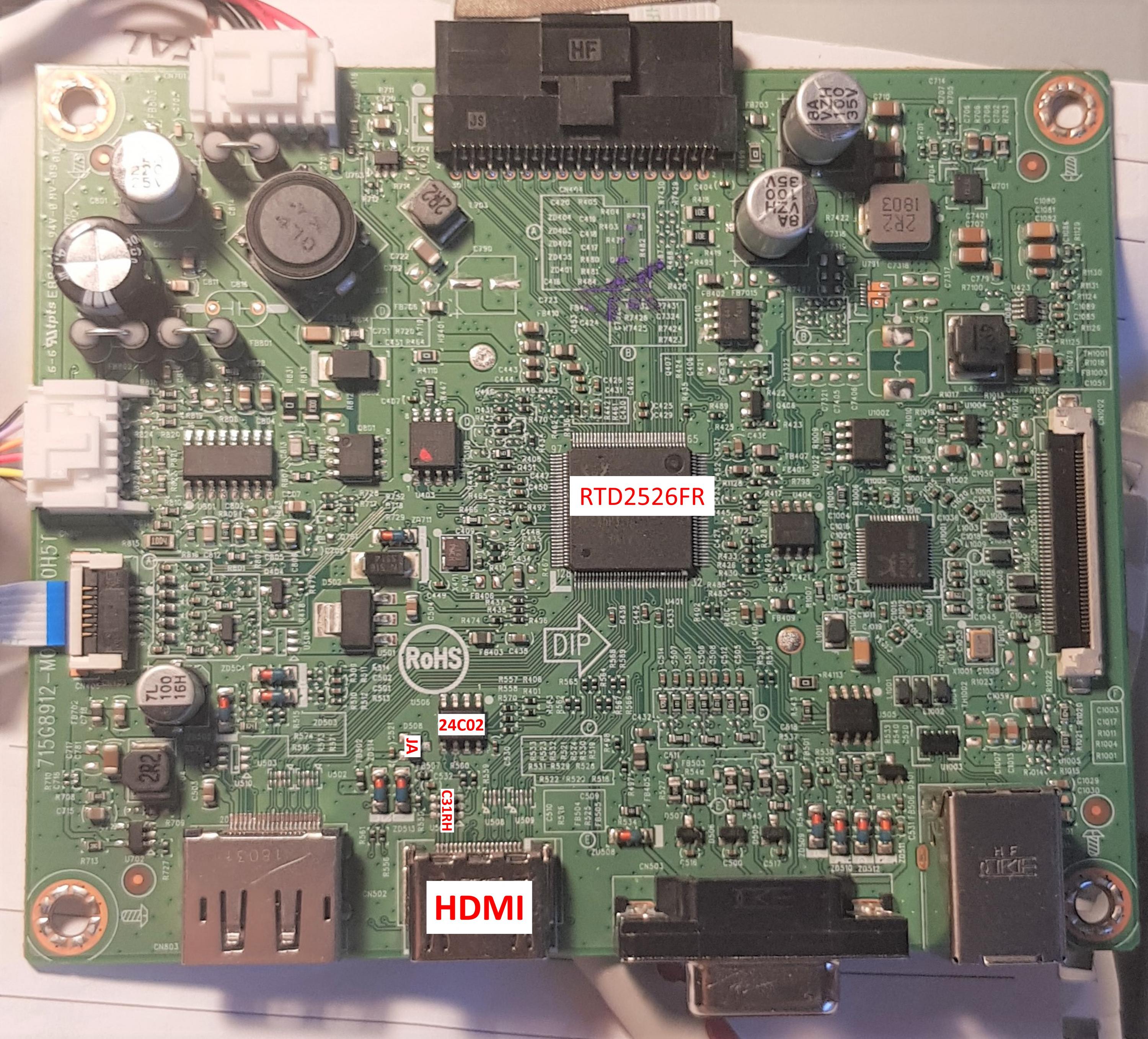

    Hi
    The display is working great except for the HDMI. VGA, DisplayPort is fine.
    i have tried several cables and sources with no luck.
    Board number is 715G8912- but i didn't find its schematic anywhere.
    The main chip is RTD2526FR which i didn't find its datasheet as well.
    Main board looks fine without any blown components or soldering issues.
    When an HDMI source is connected the screen goes blank for a few seconds and then it says, "HDMI is inactive" and enters to sleep mode.
    Tested Components:
    HDMI connector - pin 19(HPD) show 2.4v without hdmi cable, 5v with cable.
    JA - 2.4v, 5v in, and diode check forward polarity=0.6v and "OL" the other way around.
    C31RH - i guess it is an ESD protection IC, all I/O's shows 0.6v to GND pin and "OL" in reverse polarity and "OL" to Vcc pin
    24C02 - EEPROM, i do not own a scope so i do not know how to test it except for measuring voltage which demonstrates 5v to Vcc, SCL,SDA pins.

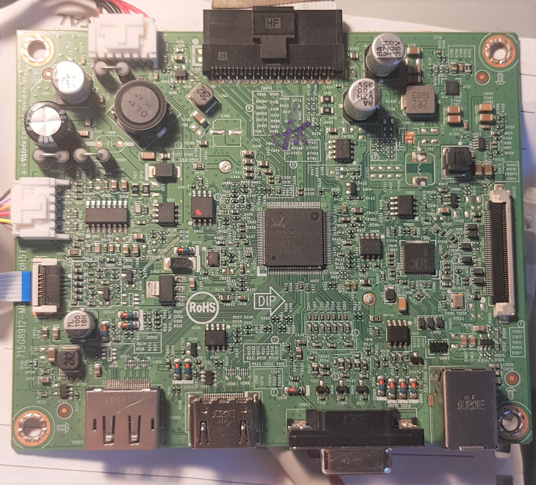

    attaches are board pics
    any help is most appreciated.
    The main reason for fixing it is learning so buying a new board is non relevant.
    tx
    Ran

    Re: HP E233 display HDMI no input
    attach pic of PCB with tested component p/n

        Unfortunately there isn't enough information given. Try a different cable, wiggling the connector etc. Does the computer recognize the screen, or is it dead as a rock? Are there any loose /damaged pins on the HDMI connector on the board? Does the monitor turn on at all?

            If it isn’t the cable nor any other inputs work, it’s either the firmware, EDID, or the main CPU.
