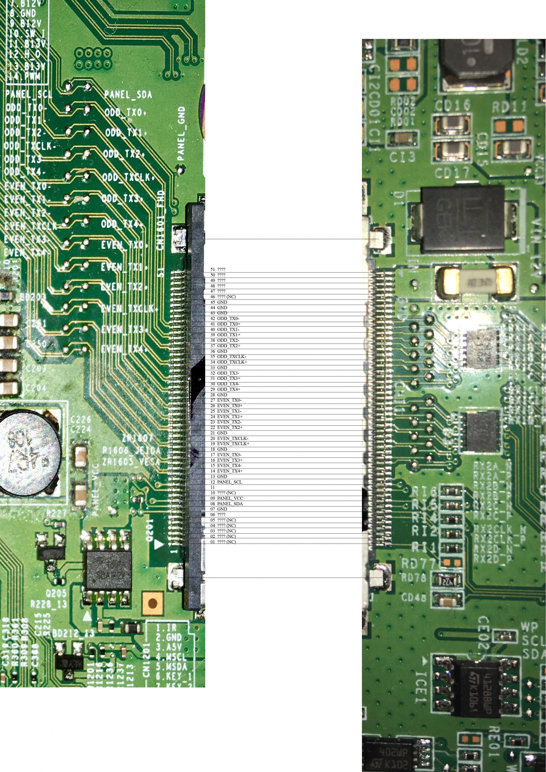

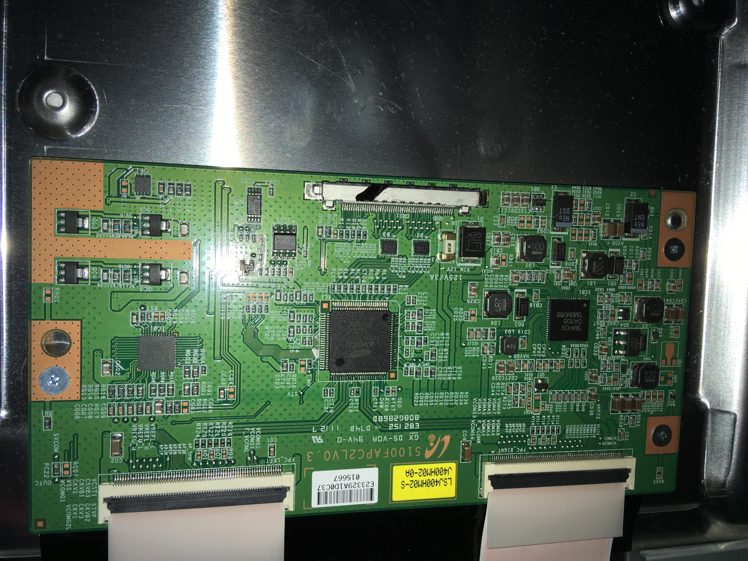

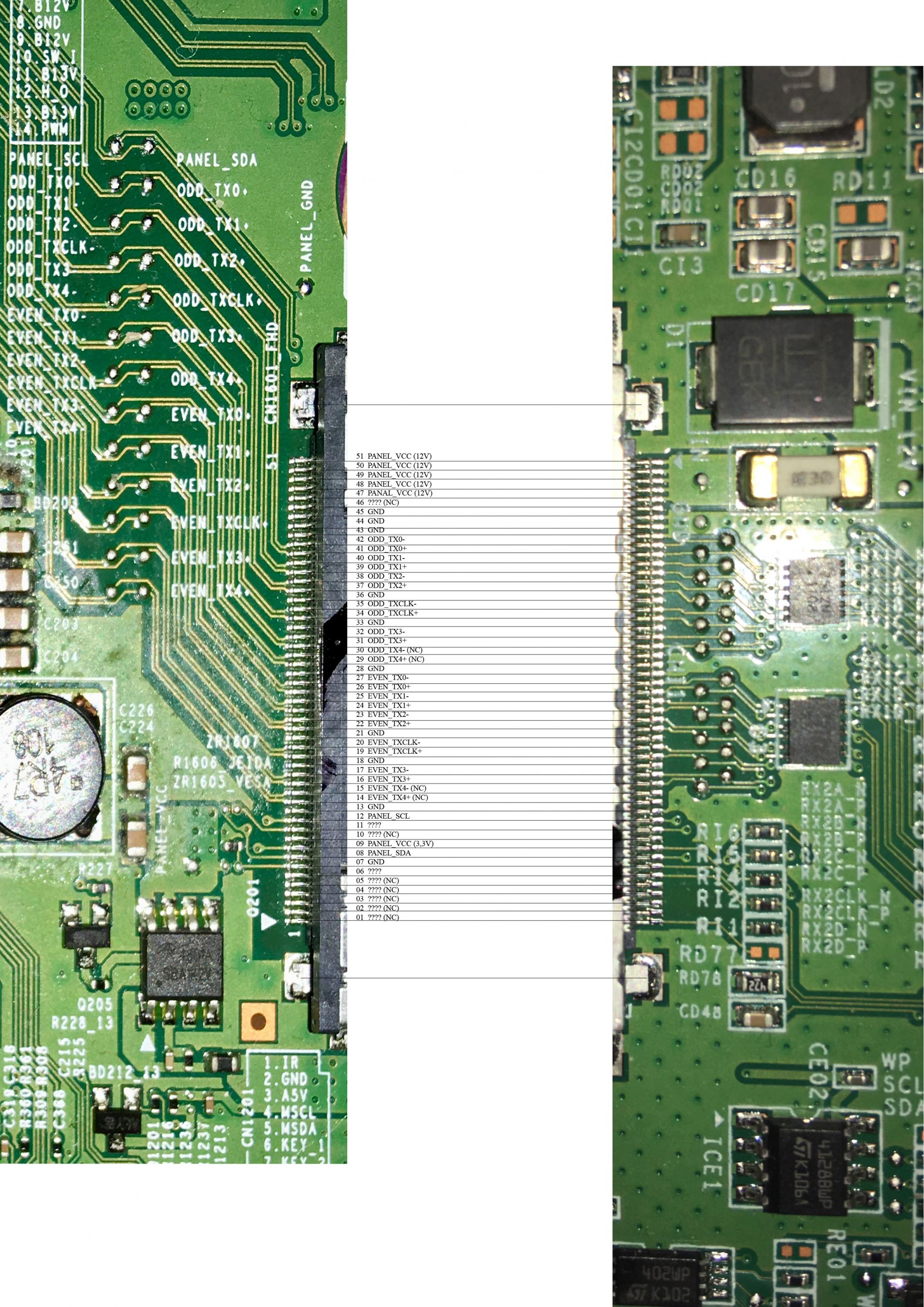

    Just mapped the connections between the Mainboard and the T-Con.
    51 ????
    50 ????
    49 ????
    48 ????
    47 ????
    46 ???? (NC)
    45 GND
    44 GND
    43 GND
    42 ODD_TX0-
    41 ODD_TX0+
    40 ODD_TX1-
    39 ODD_TX1+
    38 ODD_TX2-
    37 ODD_TX2+
    36 GND
    35 ODD_TXCLK-
    34 ODD_TXCLK+
    33 GND
    32 ODD_TX3-
    31 ODD_TX3+
    30 ODD_TX4- (NC)
    29 ODD_TX4+ (NC)
    28 GND
    27 EVEN_TX0-
    26 EVEN_TX0+
    25 EVEN_TX1-
    24 EVEN_TX1+
    23 EVEN_TX2-
    22 EVEN_TX2+
    21 GND
    20 EVEN_TXCLK-
    19 EVEN_TXCLK+
    18 GND
    17 EVEN_TX3-
    16 EVEN_TX3+
    15 EVEN_TX4- (NC)
    14 EVEN_TX4+ (NC)
    13 GND
    12 PANEL_SCL
    11 ????
    10 ???? (NC)
    09 PANEL_VCC
    08 PANEL_SDA
    07 GND
    06 ????
    05 ???? (NC)
    04 ???? (NC)
    03 ???? (NC)
    02 ???? (NC)
    01 ???? (NC)
    Does sonmeon know the ???? (see also atachement)

      #42
      Re: Samsung UE40ES5700S blinks 5x2 in loop
      Just found this :-) for the 46"
      https://www.electronica-pt.com/esque...d5500-r-32807/
      But this is not really matching mine (Isn't it?). Compare SDA/SCL for example
      Found out that
      51 - 47 is Panel VCC 12V
      09 was 3,3 V when the set was on (if I remember correct).

        #43
        Atached the updated mapping

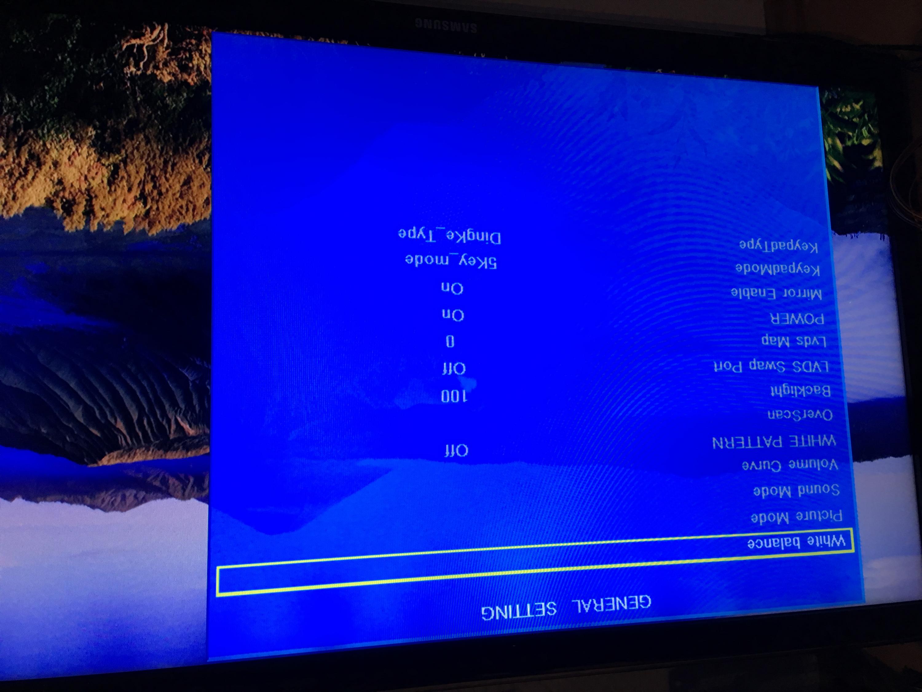

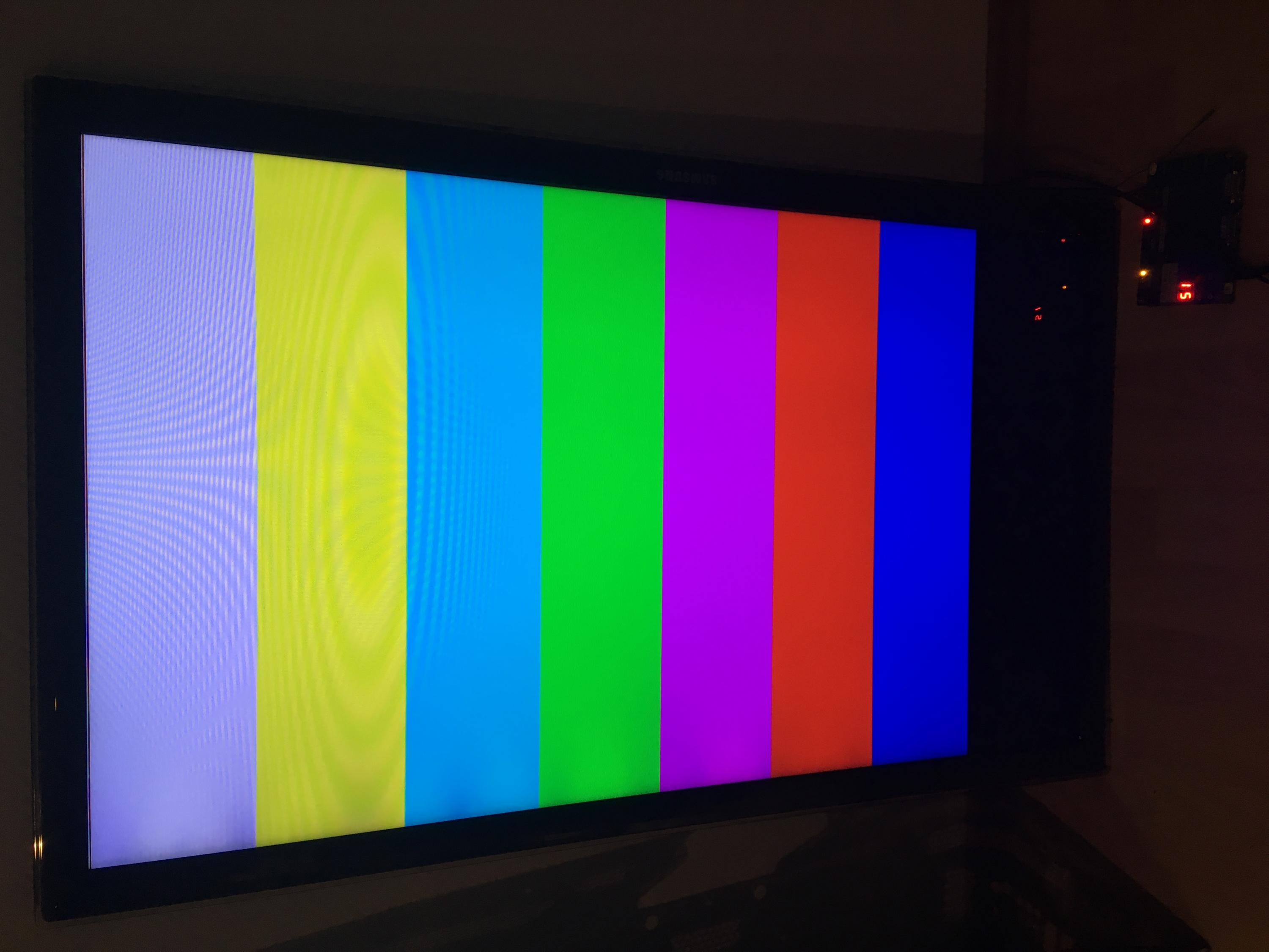

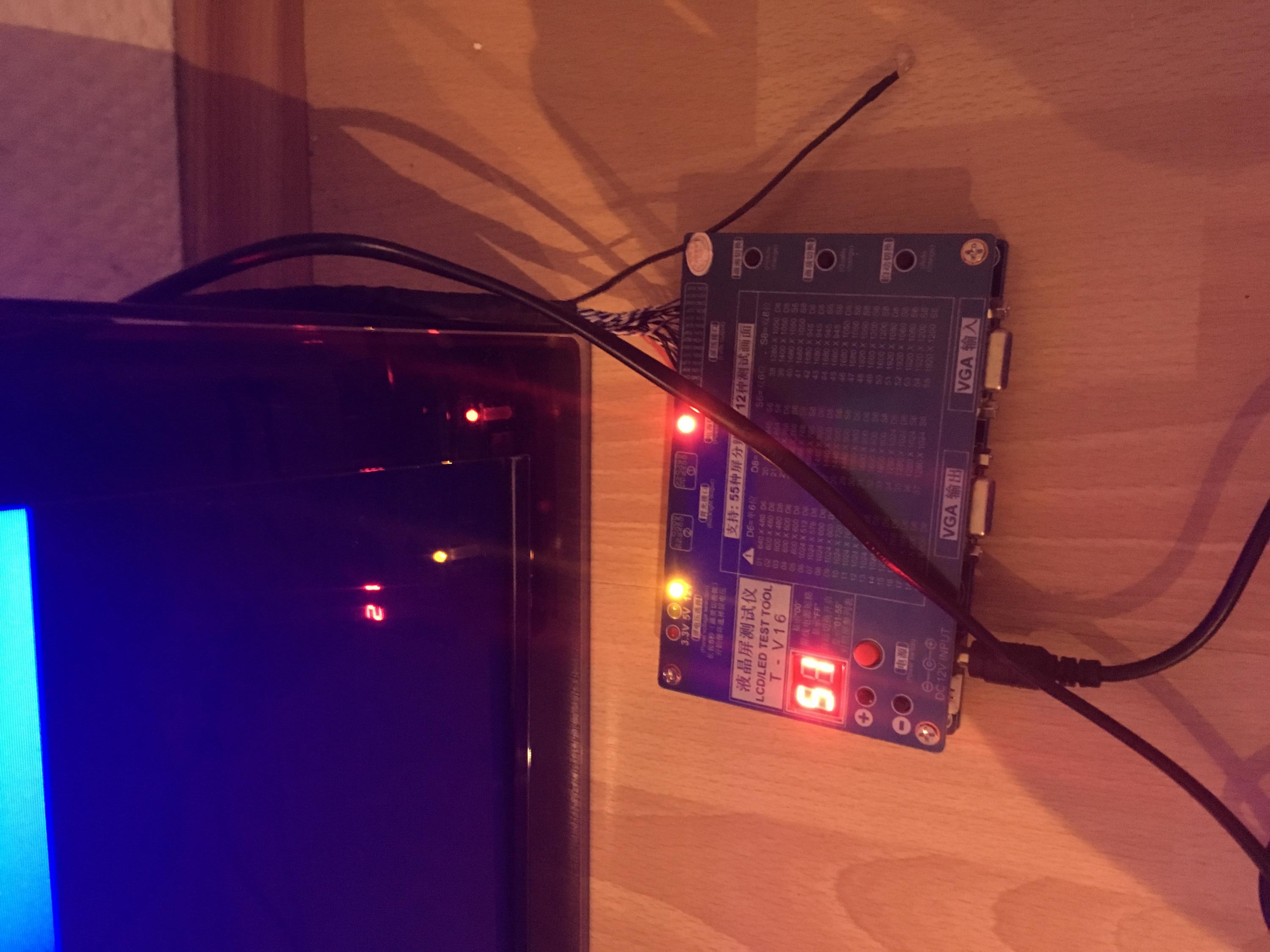

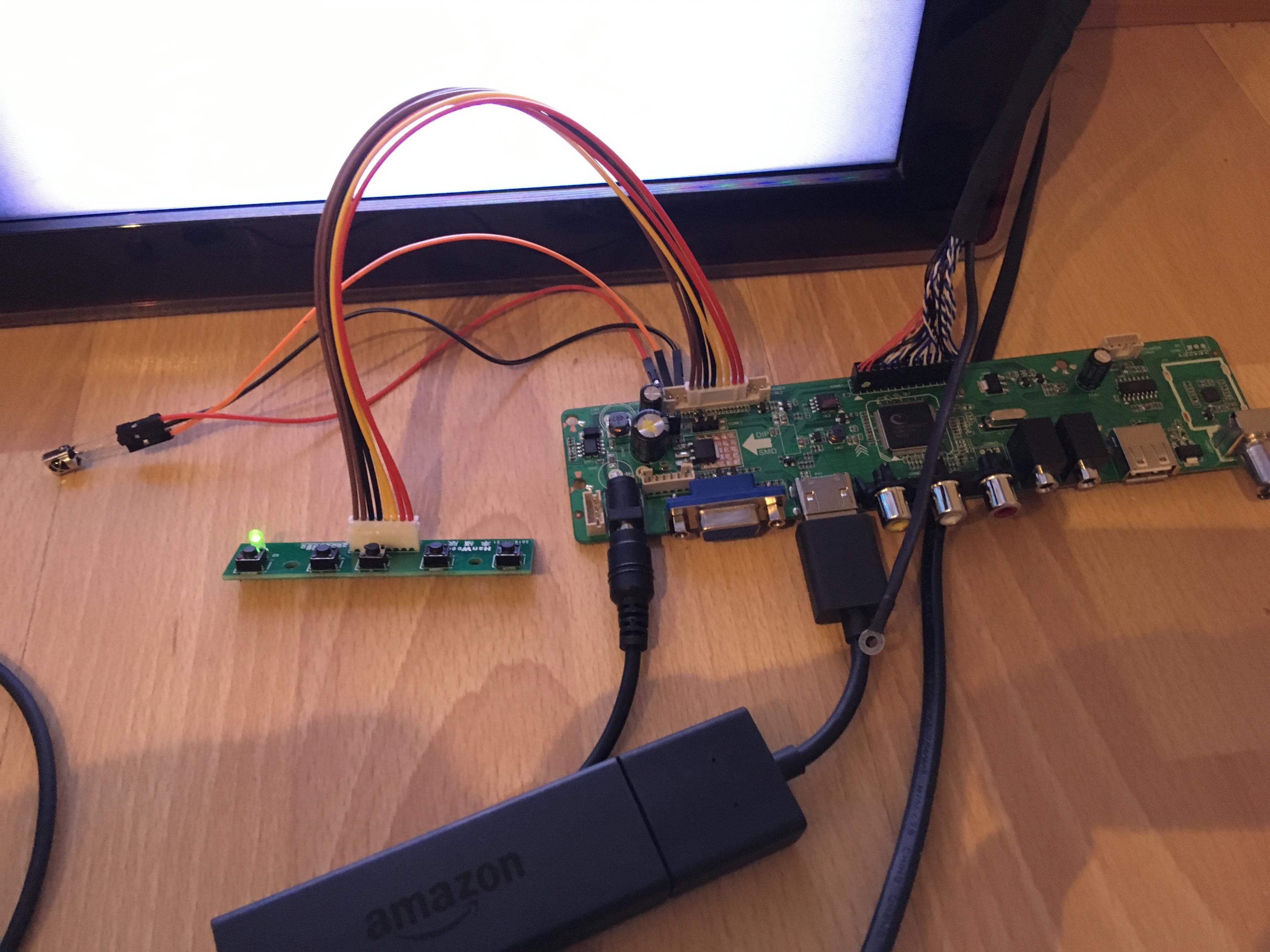

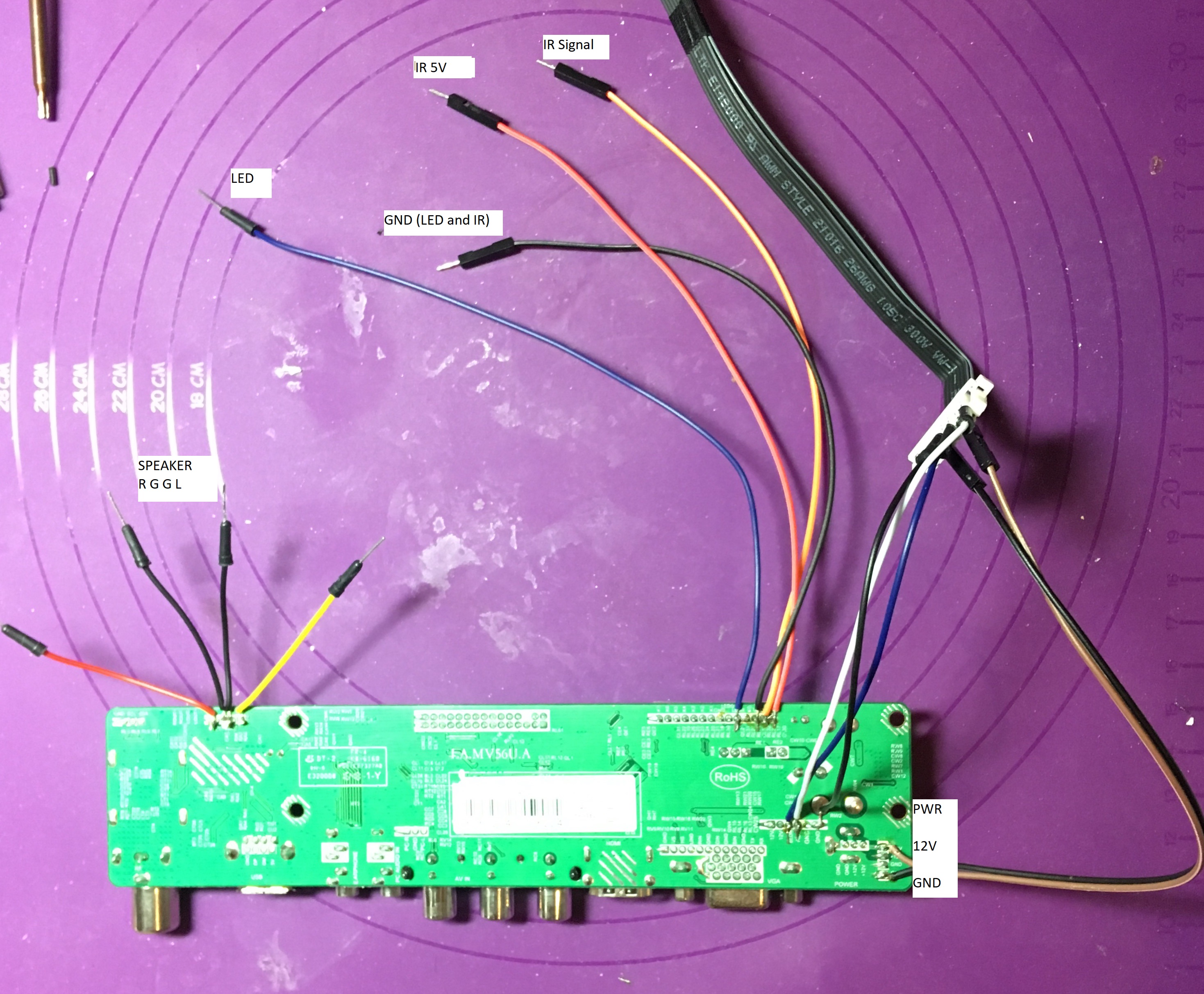

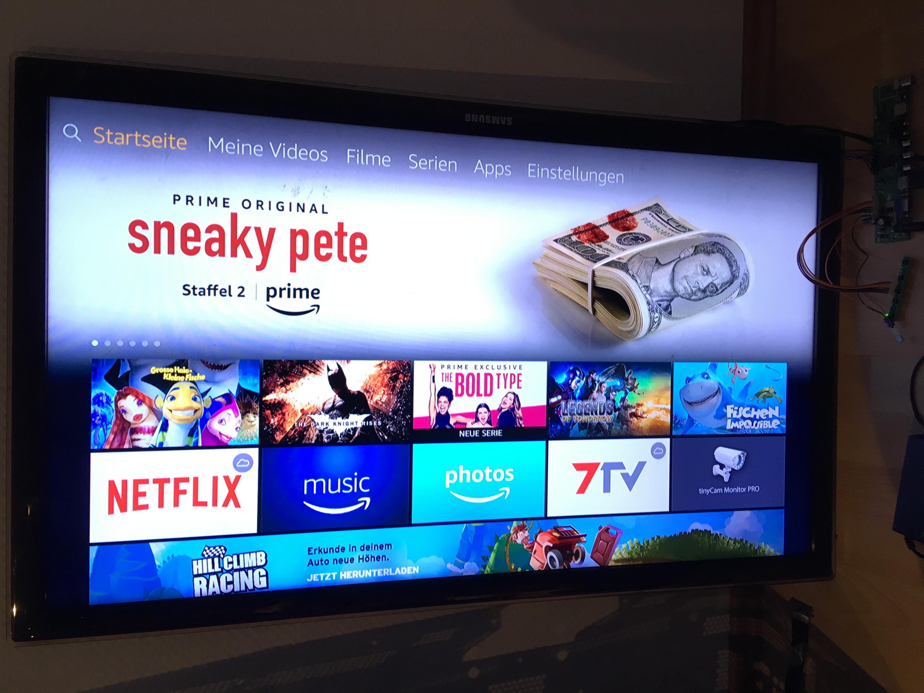

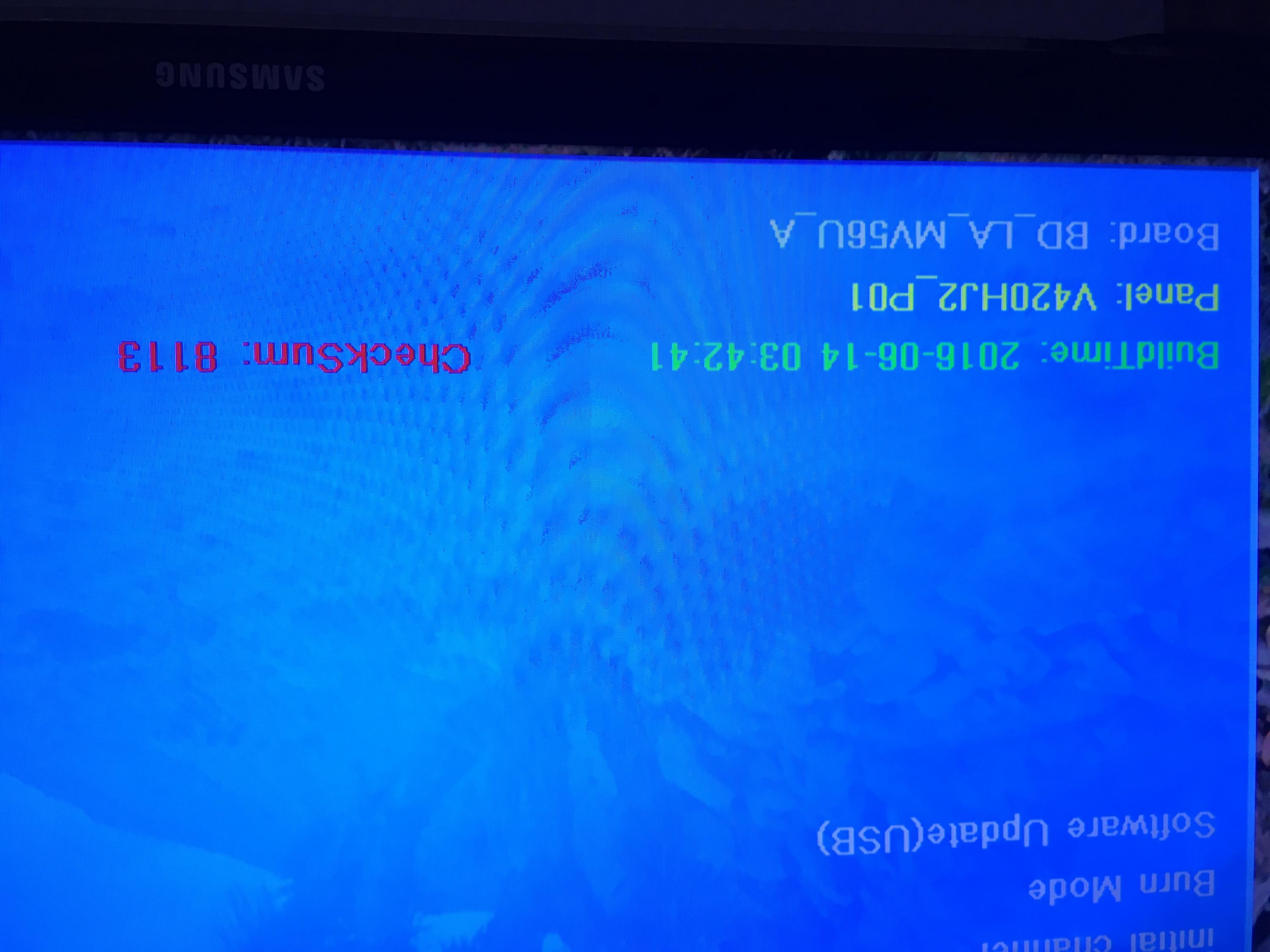

              just attached a V.56 from Banggood with such a LVDS Cable . Beware, you need the "right" one.
              Here and here are good sources for knowledge seekers.
              I've had some 5 Key pad laying around from such a lvds controller.
              v.56 Firmwares Link 1
              v.56 Firmwares Link 2 from this site

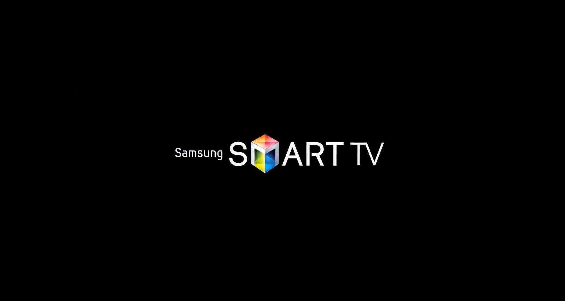

              I've also added the Samsung SmartTV logo as bootlogo.
              Next steps will be to connect "somehow" the original D5700 keypad to the V.56 board and also connect the Samsung Power Supply as currently I have two power cords to the set. Do you know how?
              Note:
              You have to change the LVDS mapping to 0 via the Service Menu (1147 on the remote)
              Also flip the picture (Mirroring via the Service Menu)
              The CPU is getting hot. I will add a heatsink.
              The IR is sticked to some jumperwire. Those wires are soldered to the bottom pins of the V.56
              I've added the Firmware I've used as attachement
              Cheers
              fluxflux

                  Looks like you're making great progress, wonder what's making the cpu get hot.

                    @vinceroger69
                    It was Easy. Got the Info from here
                    1. Take a JPEG and store it on a thumb drive
                    2. Change Source to MEDIA on the V.56
                    3. Select the picture -> scroll right -> select "capture".
                    Thats it.
                    @nomoresonys
                    I think it's the Full HD resolution. As these types of boards are primary used for turning an old LCD/LED Monitor to a TV the most computer panels have lower resolutions.
                    There are also Mainboard on the market with LAN/DVB-S2/DVB-T2/ANDROID...
                    As said; I had the old V.56 boards laying aroud as I got them for a few bucks on banggood sale.
                    For me the time paying unrealistically high prices for used mainboards are over.
                    Example 1 : ZL.VST.3463GSA.LB
                    Example 2: T.V56.81
                    Example 3: MSD628V6.0

                        So how do you adjust the backlights level? I do not see any interface between the backlights circuit and this new main board, or turning the power supply board on and off.
                        Great works getting the interface to work.

                              #54
                              OK, I see that the connector by the DC jack is being used in the Video.'
                              I did not see that in OP picture.
                              https://www.badcaps.net/forum/attach...5&d=1520892991

                                • fluxflux
                                  • Mar 2017
                                  • 46
                                  • @MyCountry
                                  #56
                                  I have not yet done it. That's one of my "next steps"
                                  Currently I have two seperate Power Cords (12V AC-DC to the V.56) and the original PSU. I'm not sure if the Samsung PSU can deliver the 4A current that is needed by the V.56. Have to measure it. I belive that the 4A is used if the V.56 delivers the 12V to the LCD Backlight inverters only. So I need to somehow wire the V.56 to the PSU that this one starts up and activates the LED Backlight.
                                  Found some other intresting video. ;-)
                                  This shows an V.56 implemntation into a 42" LCD
                                  Will keep you updated.
                                  • fluxflux
                                    • Mar 2017
                                    • 46
                                    • @MyCountry
                                    #57
                                    Here's the update:
                                    Original IR Sensor works
                                    Original LED works for triggering Remote Control buttons.
                                    The Power indicator LED does not work.
                                    Original touch sensitive buttons do not work (as they are chip controlled)
                                    Backlight power on works
                                    Backlight dimming does not work! (I see the Voltages change on my DMM - but it does not have any impact on the Backlight)
                                    The PSU is always on as there is no quick standby solution possible.
                                    The V.56 needs always 12 V for Standby. But if I put the Samsung PSU into standby mode there are no 12 V present (Henn Egg Problem)
                                    Will do a video later the day.
                                    Next steps:
                                    Drill some holes for Micro Buttons to the Backcover.
                                    Attach a Power Switch to the Backcover.
