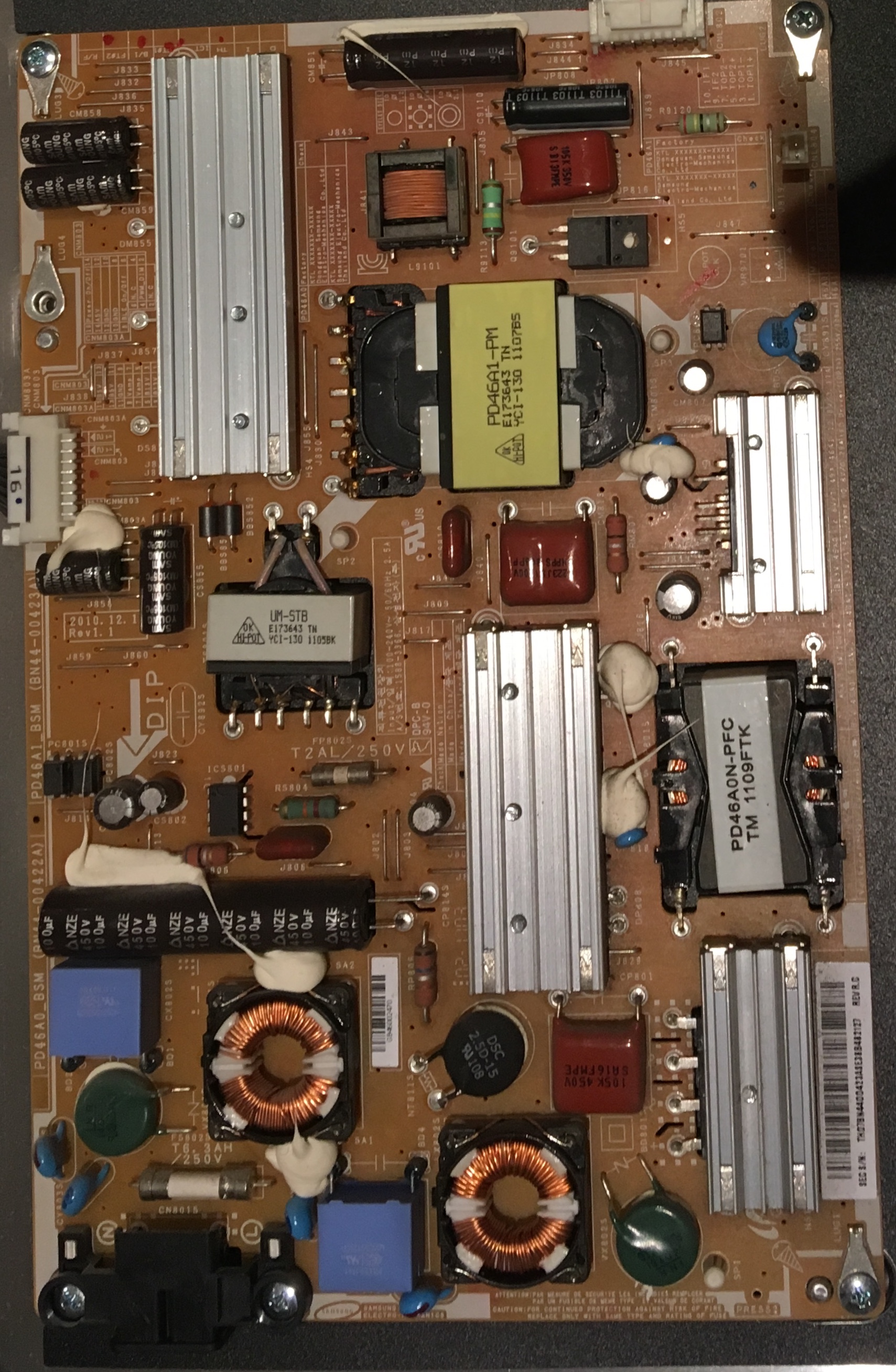

    Hi Forum,
    I have a Samsung UE40ES5700S (found in the dumpster) which blinks five times doubleblinks (in all 10 times) and after 3-4 sec. it blinks again.
    So I don't know the history of the set.
    I've already tried the factory reset (shorting pins)
    Model: UE40ES5700SXZG
    Mainboard: BN41-01660A
    PSU: BN44-00423A
    Panel: LTJ400HM03-J
    Is this a typical boot loop (bricked?) or an other issue?
    Kr
    Flux

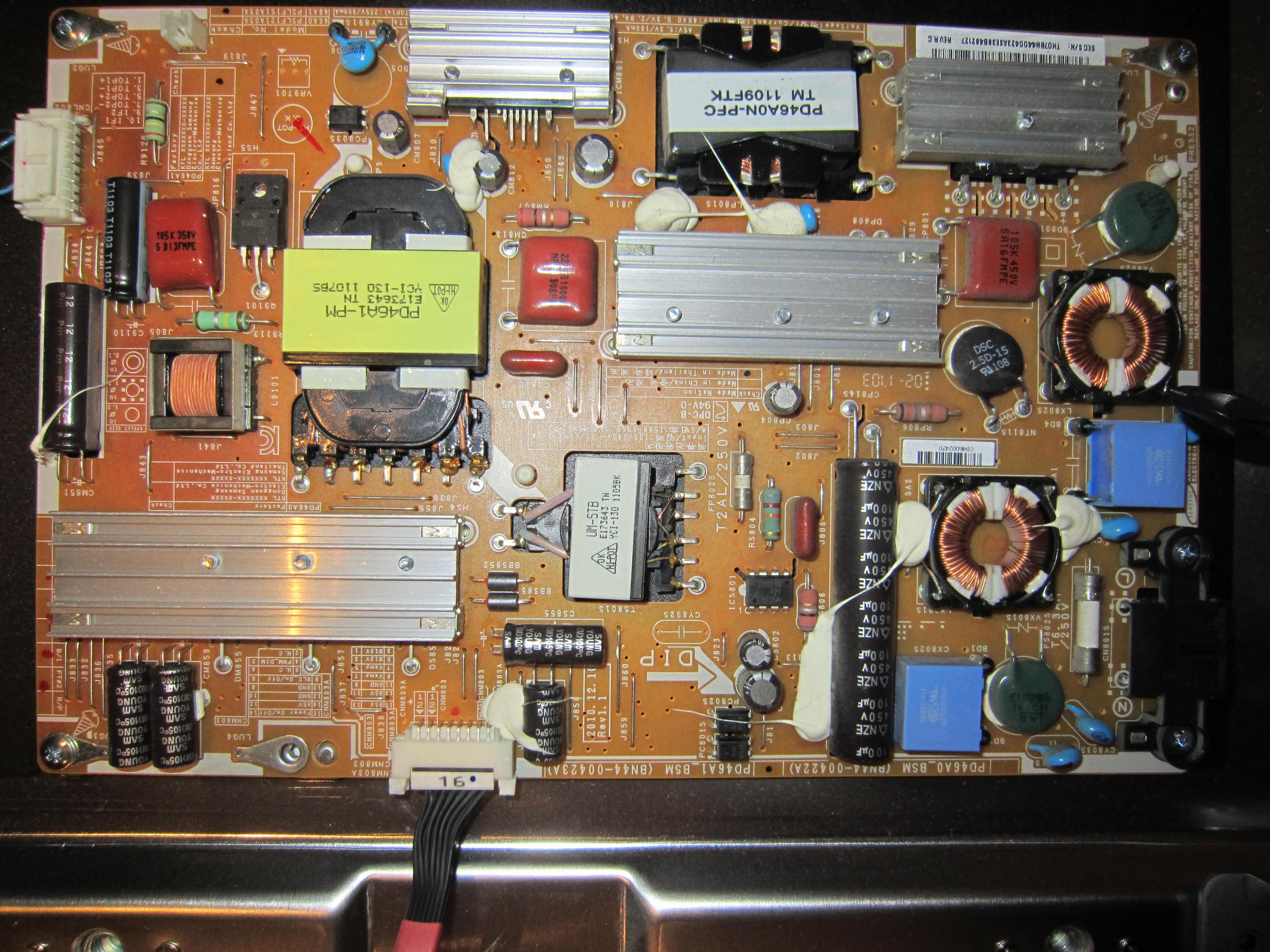

          Re: Samsung UE40D5700RSXZG blinks 5x2 in loop
          Dear all,
          fist of all, I'm very sorry as I've made an mistake by naming the Model.
          It's an Samsung UE40D5700RSXZG. The other one is also at my workbench.
          Lesson Learned: DON'T TRUST YOUR MEMORY :-)
          @thoma:
          The following happens:
          Disconnect the main from the PSU - no blink -> logical as the status LED is connected to the main.
          Disconnect the tcon from the main - blink
          Disconnect the backlight from the PSU an keep the main connected - blink
          Overall there is no backlight.

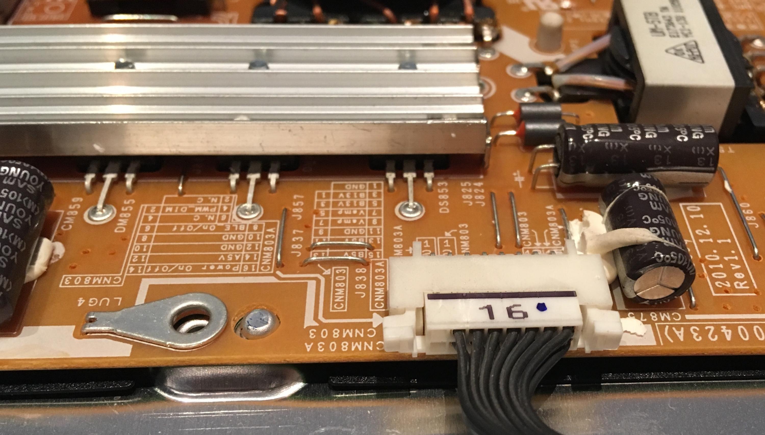

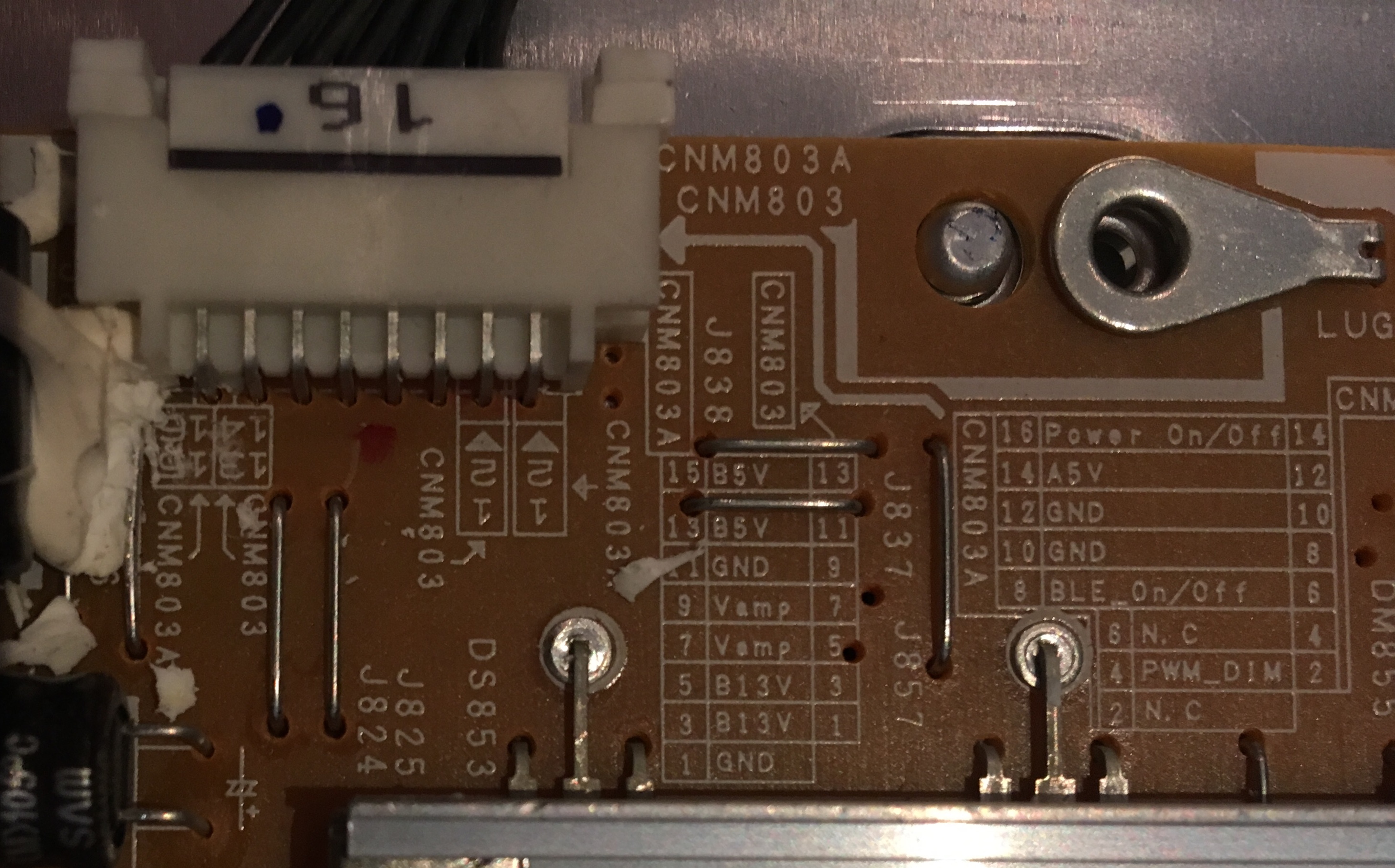

            Re: Samsung UE40ES5700S blinks 5x2 in loop
            https://www.badcaps.net/forum/attach...9&d=1518734402

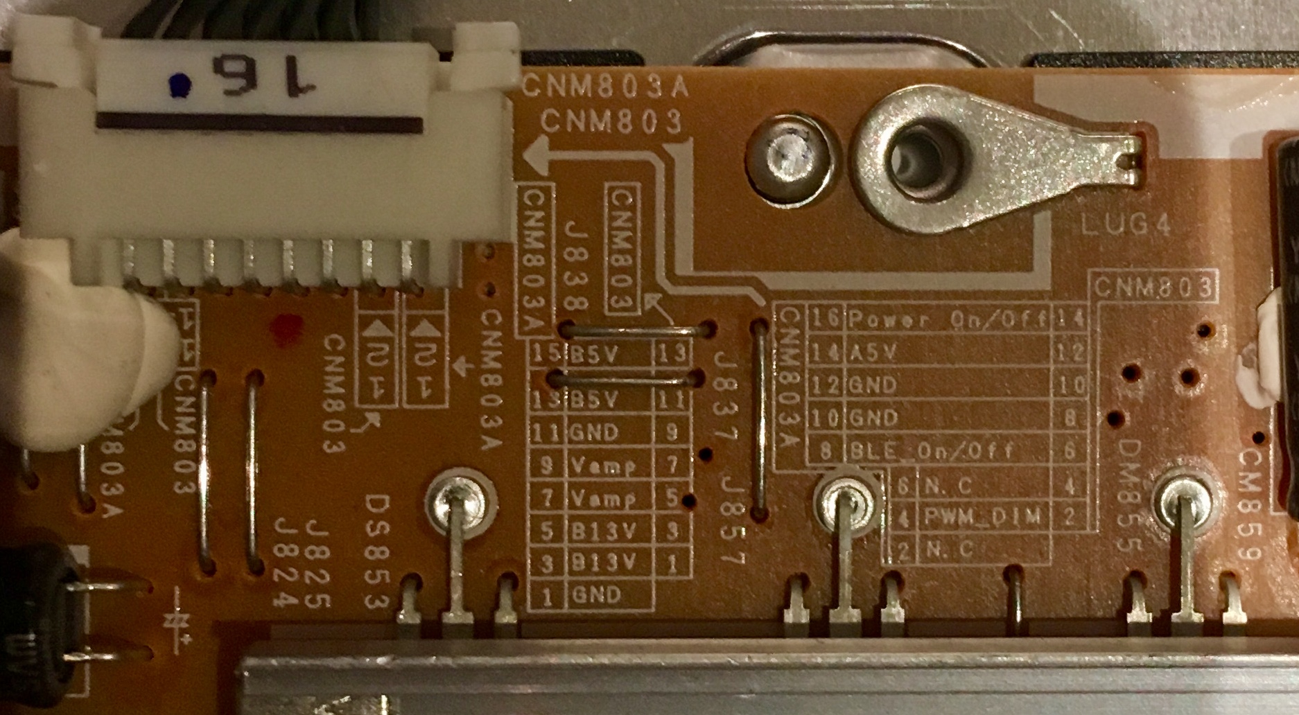

            It looks like you count the pin of the CN803A (not 803) wrong, see the chart for the CN803A.
            CN803A is 16-pin, CN803 is 14-pin.
            You have CN803A so no way you can have 5.31V at pin 12 because pin 12 of CN803A is GND!
            The exposed pins you are seeing on the top side of the board are ODD number pins, the EVEN number pins are located on the bottom side of the board.
            So you need to retest the Voltages of all those pin again and you MUST pin down the pin names and follow by the Voltage readings so we can easily see if the Voltages are correct or not.
            I am not sure if this BN44-00423A has pull-up resistors for self test or not, I have to look at my notes later.
              Hi budm,
              thank you and apologize for confusion. You are right - of course :-)
              I've removed some of the glue and now the layout is clear to me...

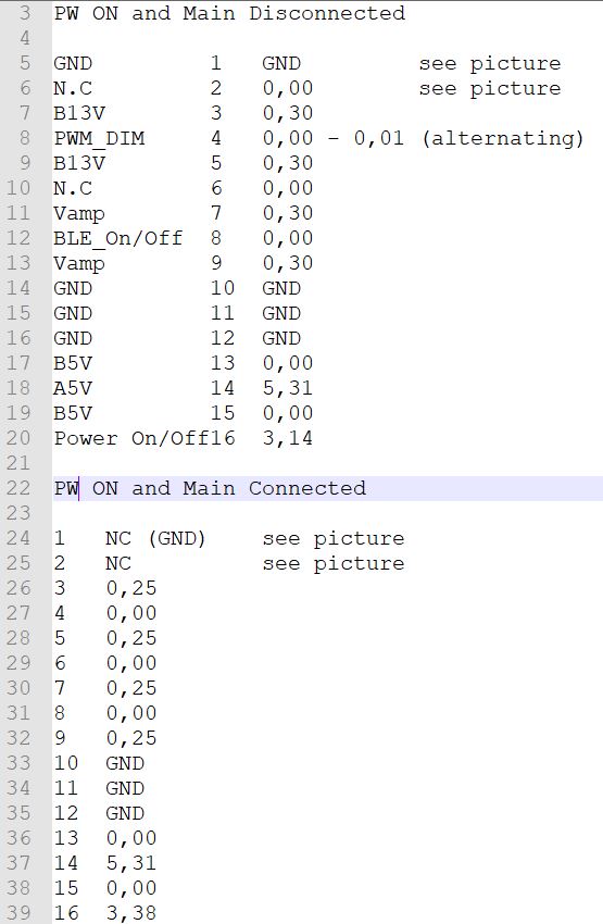

              Here are the new measurements.
              CNM803A
              PW ON and Main Disconnected
              GND 1 GND see picture
              N.C 2 0,00 see picture
              B13V 3 0,30
              PWM_DIM 4 0,00 - 0,01 (alternating)
              B13V 5 0,30
              N.C 6 0,00
              Vamp 7 0,30
              BLE_On/Off 8 0,00
              Vamp 9 0,30
              GND 10 GND
              GND 11 GND
              GND 12 GND
              B5V 13 0,00
              A5V 14 5,31
              B5V 15 0,00
              Power On/Off 16 3,14
              PW ON and Main Connected
              B13V 3 0,25
              B13V 5 0,25
              N.C 6 0,00
              Vamp 7 0,25
              BLE_On/Off 8 0,00
              Vamp 9 0,25
              GND 10 GND
              GND 11 GND
              GND 12 GND
              B5V 13 0,00
              A5V 14 5,31
              B5V 15 0,00
              Power On/Off 16 3,38
              If POWER ON the voltages 3,5,7,9 and 16 alternating from 0V to the given voltage in sync to the LED blinking (reastart).
              Thank You
              flux

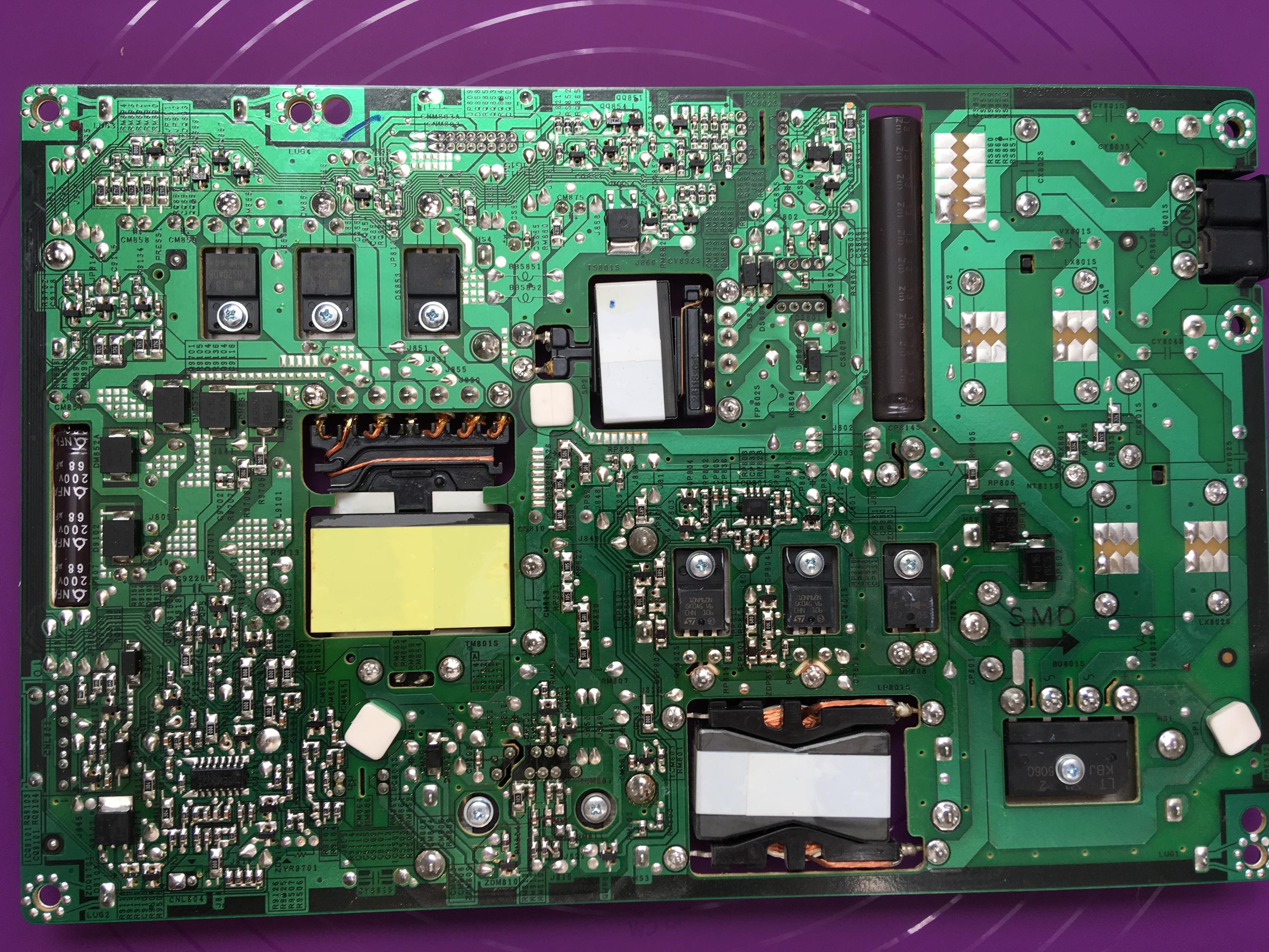

                          EDIT: Reflowed the CPU without success - still blinking.
                          @thoma: Will check the content in the link. (btw. the PSU is not clicking)
                          Intresting:
                          I've also tried to do the EEPROM reset again. I've noticed the following: If I let the pins shorted and unplug the power cord the system keeps blinking (discharging of caps?). As soon as I remove the wire the system stops blinking.
                          Kr
                          flux

                            You do have PS-ON (POWER ON/OFF) of 3.14V so the switched 13V, B5V, and the Vamp Voltages should be present.
                            I do not understand this statement "If POWER ON the voltages 3,5,7,9 and 16 alternating from 0V to the given voltage in sync to the LED blinking (reastart)."
                            What do mean by 'IF'?
