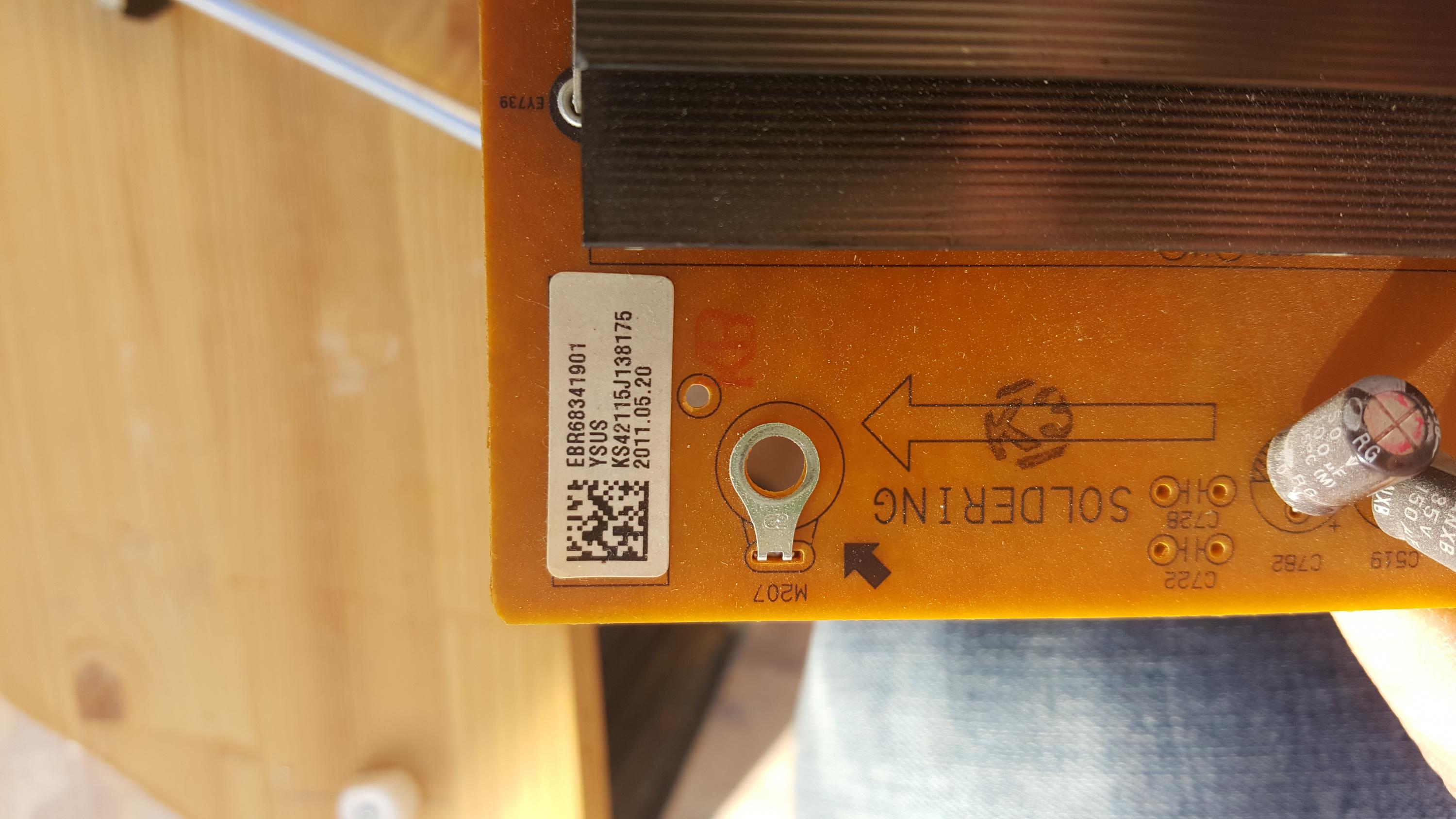

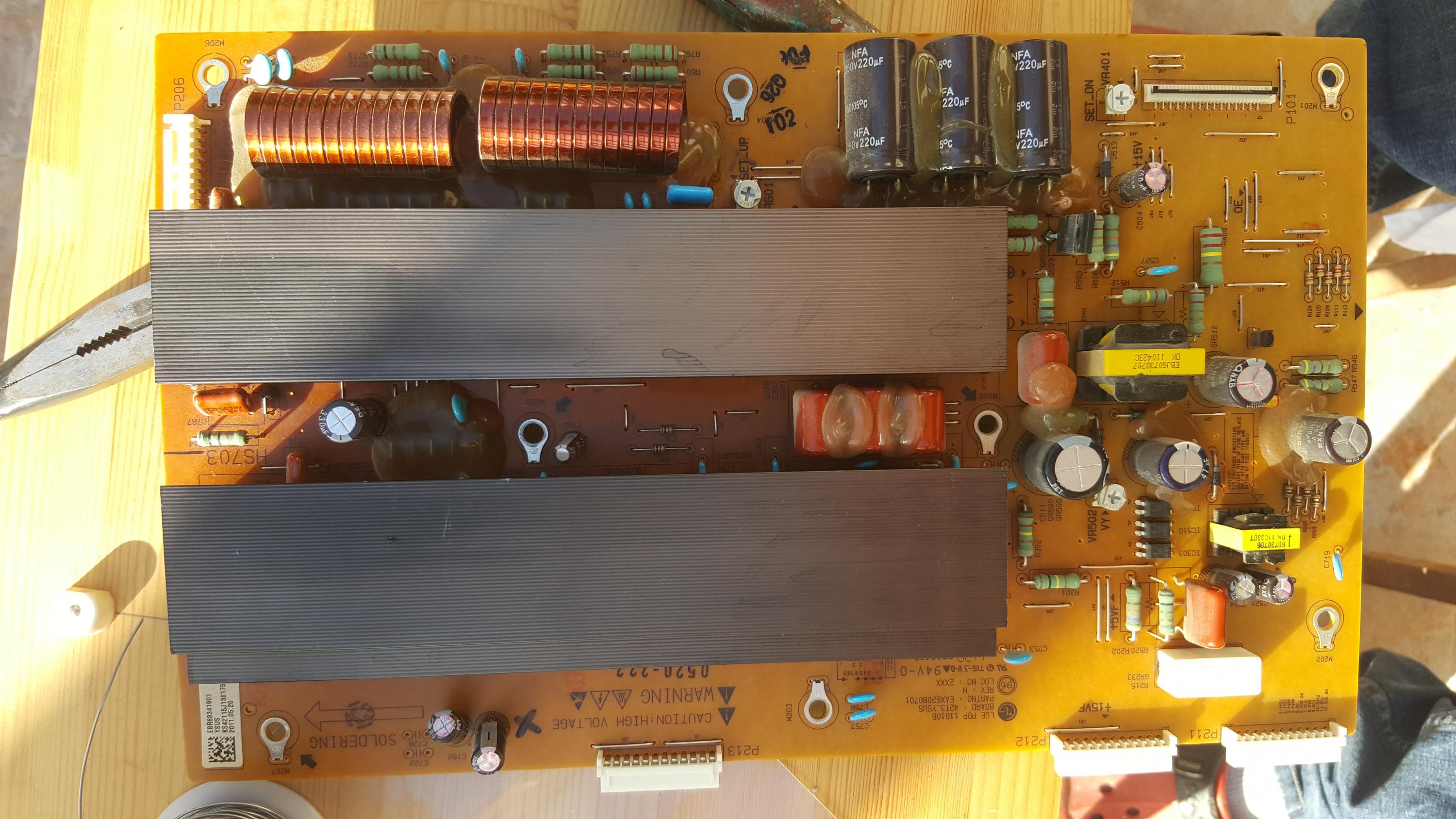

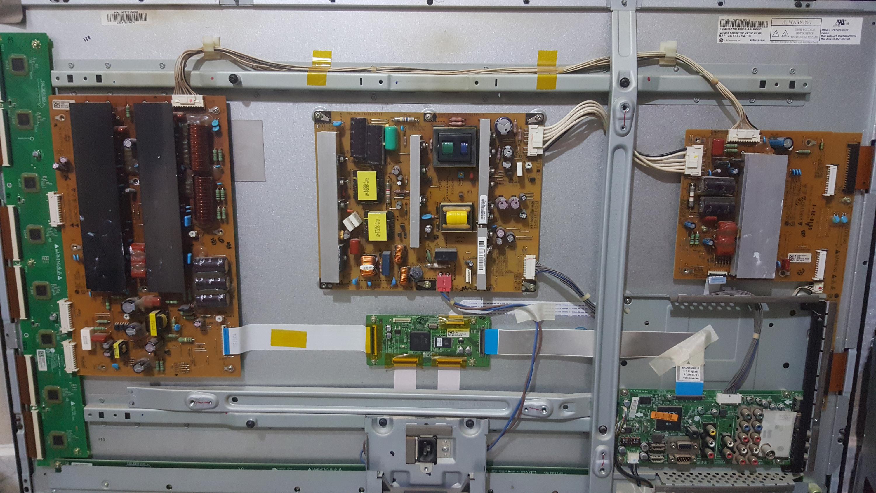

    Replaced a few igbts on ysus and zsus and now the clicking stopped, also the voltages VS and VA are ok. But, when I connect all boardes together it burn out one of the igbt on the ysus.
    What I came up to is when I disconnect the ribbon cable between the zsus and the T-CON board, it doesn't burn out the igbt on the ysus.
    I know there should be 15V on ysus/zsus/t-con but I am not getting it. All other voltages are ok.

    Are you running it without all the Ysus screws put back in which I think causes problems.

                  Re: LG 42PT350R clicking problem fixed but still doesn't turn on
                  These boards have floating grounds. This is not a joke. 1 or 2 screws left out without that particular lug touching a ground point will have disastrous results
                    Probably you were all right. found a few igbts shorted. this weekend I'll solder new ones hopefully it will help.

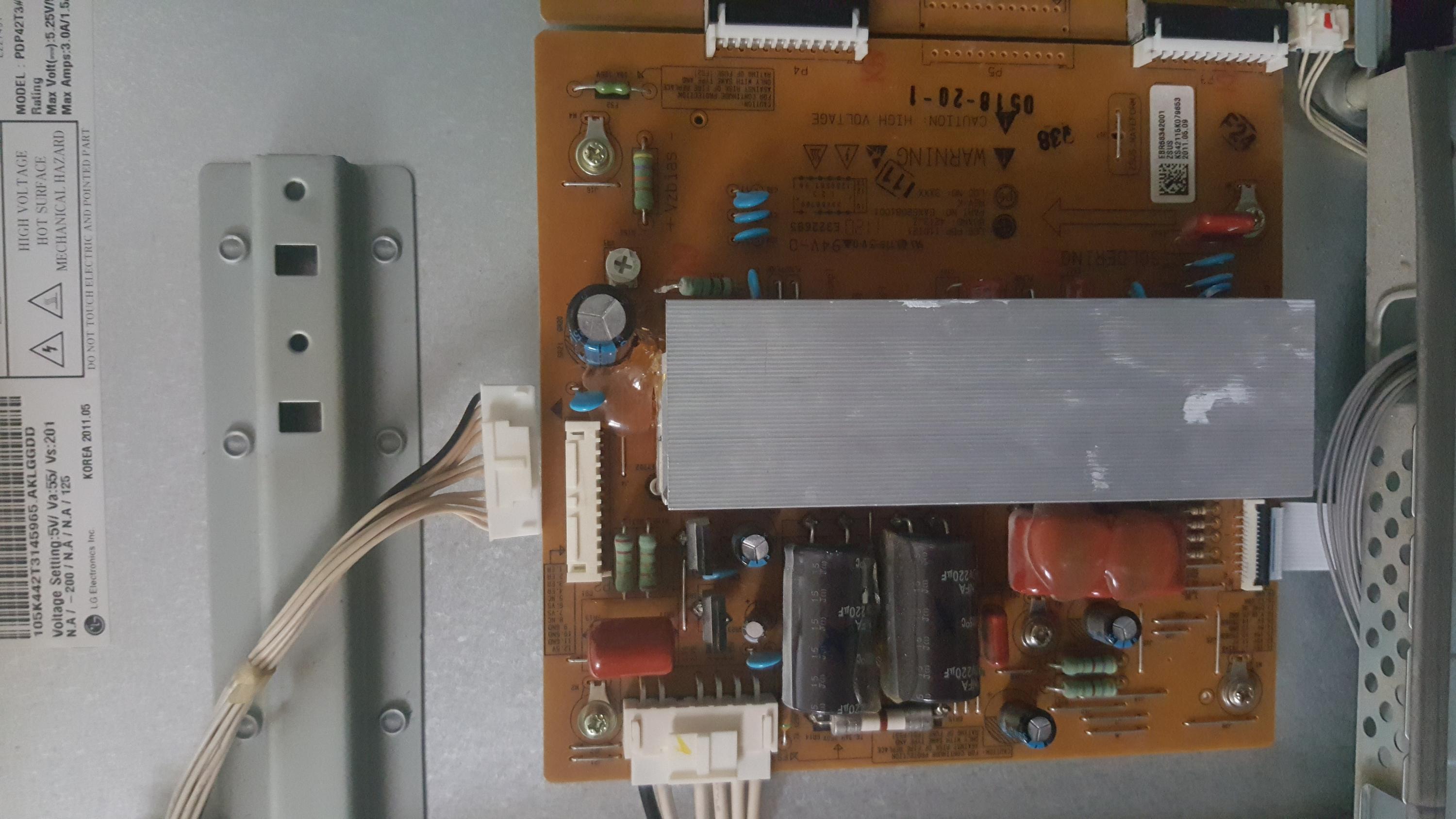

                                  My VZBIAS should be 125V and I am getting only 55V.
                                  What could be the reason?
                                    on my Ysus bd when IGBTs were shorted - also had (2) 2.2 ohm resistors shorted. check those. also check the 15V line on the Ysus board when the set is on from first startup. Mine would go to 18V then go down to 4.1V.
                                      Mine isn't going to 18V it stays on 4.1V
                                        your problem is the Ysus - 15V, 15fl, 5fl, are all generated on the Ysus bd. either bad Ysus or bad panel
