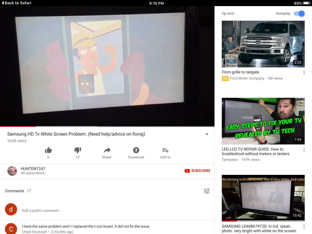

    Hi
    Just got this tv today free
    Powers on fine and everything seems to work but the image is real real light
    The image detail is great....but is so light you can barely see it
    Im thinking its a bad lcd panel
    I have not opened back of tv yet
    The screen is very bright...backlight is fine.....

    Re: Samsung LN37A450 screen washed out
    I posted a screenshot i got from youtube...very similar to my issue,...and his was a samsung lcd also

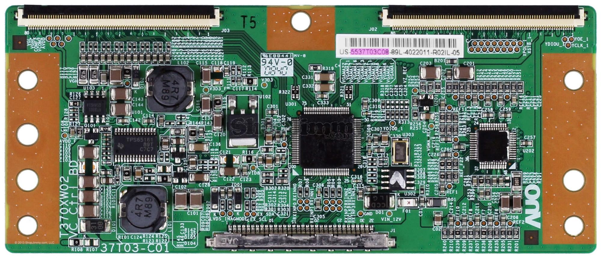

            Here is photo of tcon
              Yes very common fault AS15 chip most likely gone
              You can either replace yourself if you have the right equipment and skill level
              Or find someone offering a AS15 repair service on ebay etc
                thanks....what board is chip on?
                tcon?
                i ordered a tcon for $10
                  Look at U202 P/N.
                    tcon?..
                      fyi im not looking to replace a multi pin chip...i dont have proper equip....just wanted advice on what board causing issue...it seems its a common tcon issue in whichi ordered a tcon board already
                          Originally posted by shelby5041
                          tcon?..
                          yes.
                              Update
                              Installed replacement tcon...tv works good now
                              Thanks budm and others
                              $10 tcon shipped and free shipping...and now got a decent tv....
