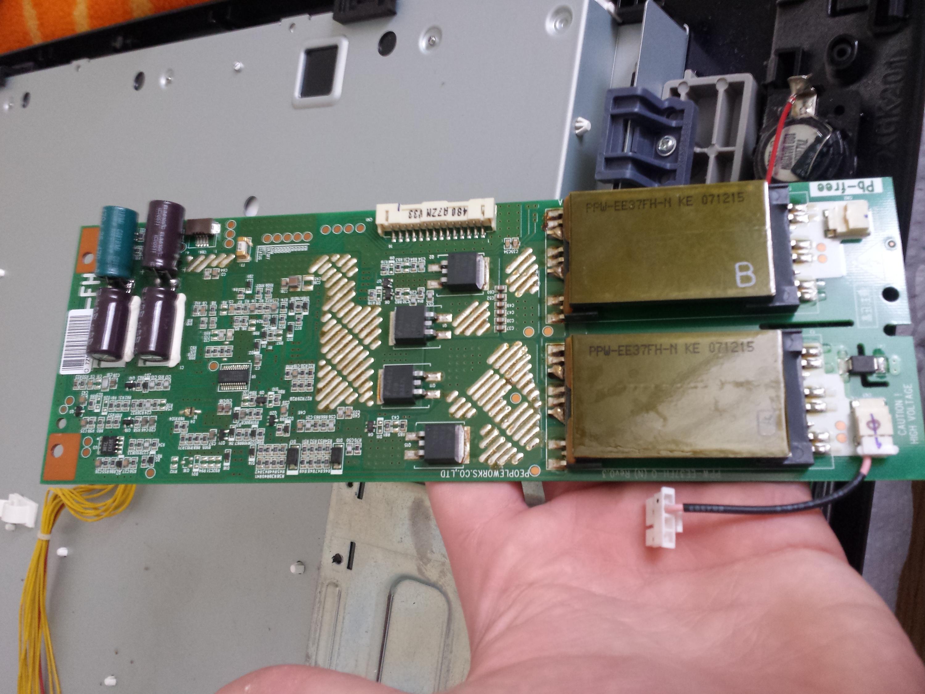

    So i have this tv for like 7 years no issues and like a month or two my tv started having issues when turning on the light blinks like its going to turn on and then the light lights up bright as the tv wasn't even turned on and no picture on the tv. So you have to turn on the tv for like 10-15 times in order for it to turn on and when it turns on (on hdmi input) when i turn on my satellite it turns off for some reason but if i leave it running on the blue screen while my satelitte is off for a half an hour you can watch the satelitte with no issues... I already replaced 1 capacitor when the tv wasn't turning on at all and now this is happening to me for some weird reason i inspected the mb while i was replacing that cap and i found nothing..
    Help?

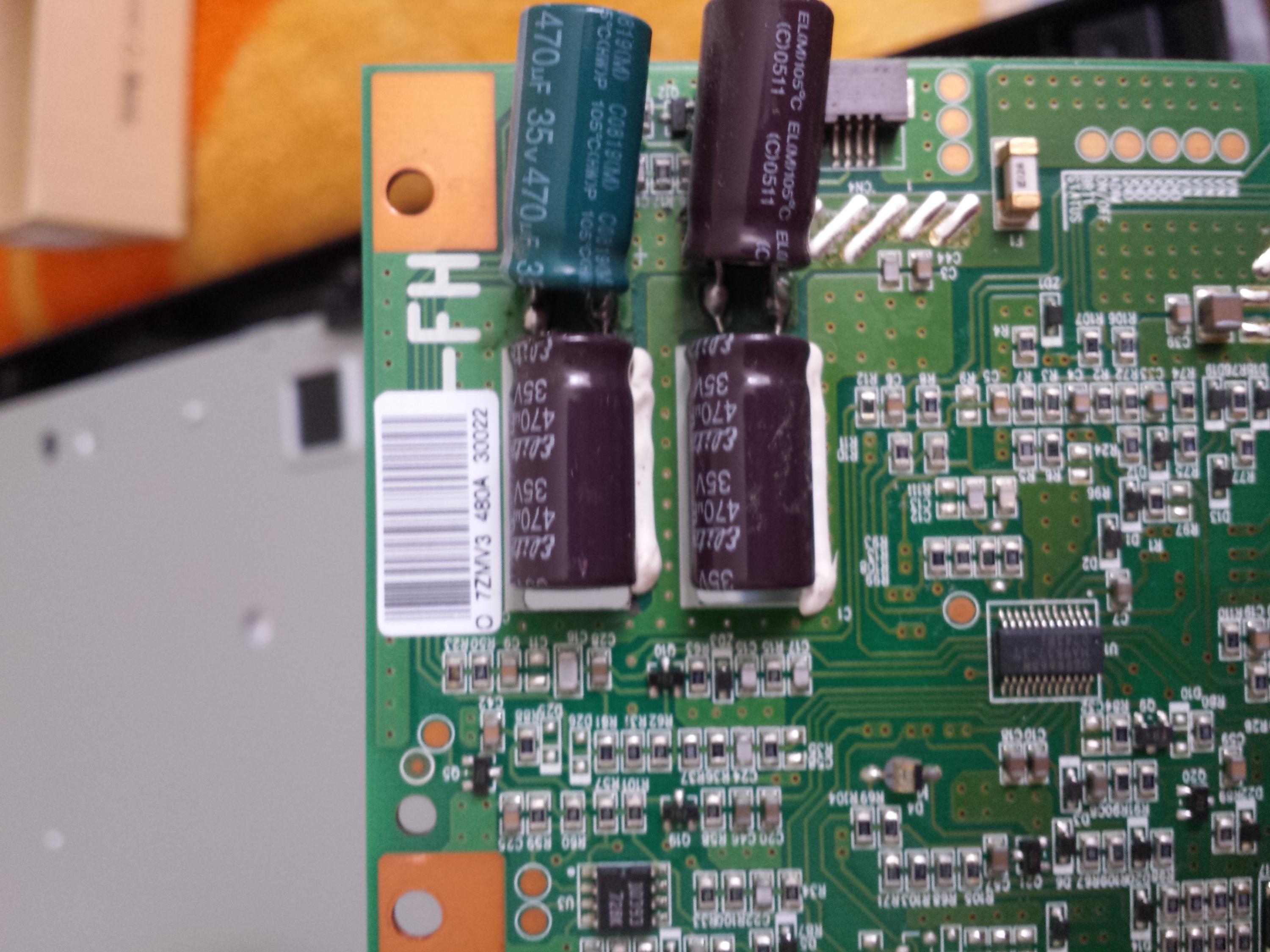

            I just noticed this as the tv was previosly repaired by some guy.
            Originally there was 2x 680uF 35V but now there is 4x 470uF 35V.. Could this be the issue?
              Re: Grundig Vision 7 37-7851T hard to turn on
              you have tu take new parts 105grd types!They are not expensive!!!!
