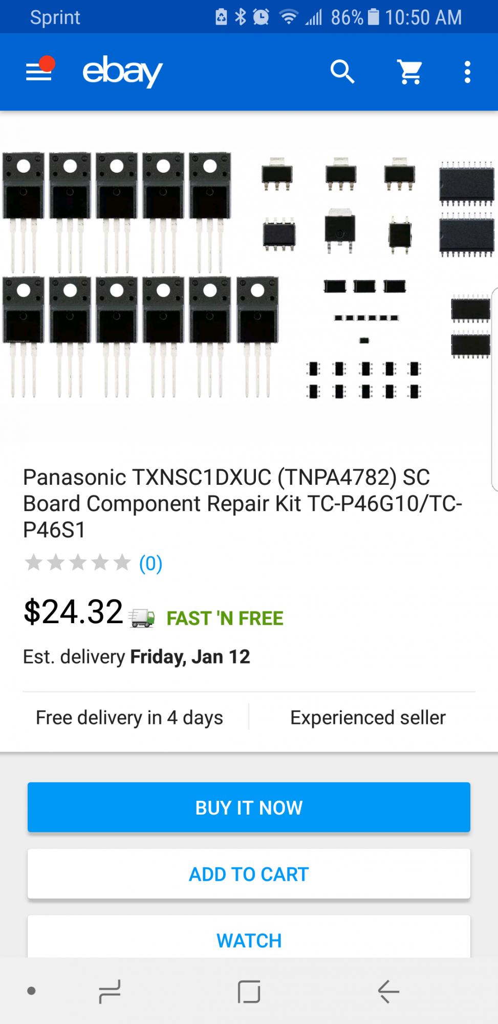

    I would say SC board is shorted. Can you take a picture of the SC board and the part number located on it. Should be TNPA****. Look for shorted Mosfets on this board. These are designated with a Q. Check middle pin to each side of the outer pins. Use diode mode on DVM.

      Thanks for the comeback. Sorry I don't have any pictures but the SC board number is TNPA4782AB.
      I can use diode mode but unsure how to identify a mosfet on this board.
        Re: Panasonic Plasma TX-P50G10B no picture
        They stand up and are screwed into the aluminum heat syncs. Here is a picture of most likely some or all the parts failed on that board. If you feel comfortable with soldering you could try to give it a go, but This is a very hard board to work on. Best thing would be to send it out for repair or Stage for a repaired board.

          Thanks for that Freakaftr8, Im going with a replacement board, I can solder but advice I have had suggests its a difficult board to repair. I'll post once Ive procured and fitted a suitable SC board
