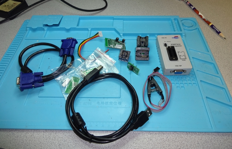

        I thought I started this thread? LOL My new toy came in the mail today. No software so what is it called and where can I download it? version 1.18???

          Re: EEPROM Programmer
          Do a search for RT809F drivers and software, either on here as it's popular with those that program laptops or a wider internet search, there seem to be plenty of links and resources.
          1.18 is for the CH341A programmer.

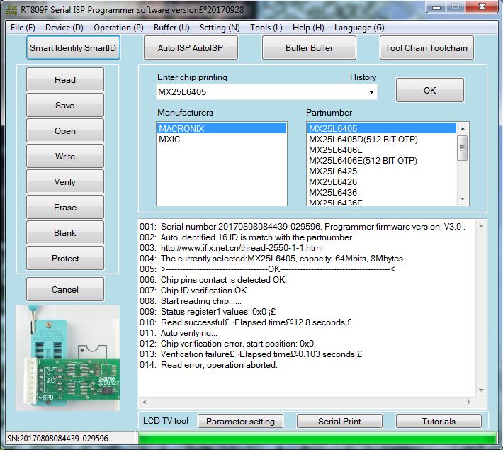

              Ok I think I have the software installed from link above and drivers and software does see the device so good to go. My first project to try. I ordered a main board for a VIZIO from eBay and it arrived yesterday however it has the audio port torn off and another part missing most likely from being a little rough removing it from the donor TV. I believe the original board has the chip messed up as it's stuck on logo screen. What I would like to do is take the image off the one that came in the mail and see if I can't put it on the original. I do not want to remove the chips and I think the Jtag clip I ordered extra should do it??? could anybody walk me through this? I do not see the correct orientation of how to put the clip on the chip either.
                Well I'm guessing and think I'm close but I get a read verification error as seen in the pic and happens on both boards so I think I must have something wrong.
