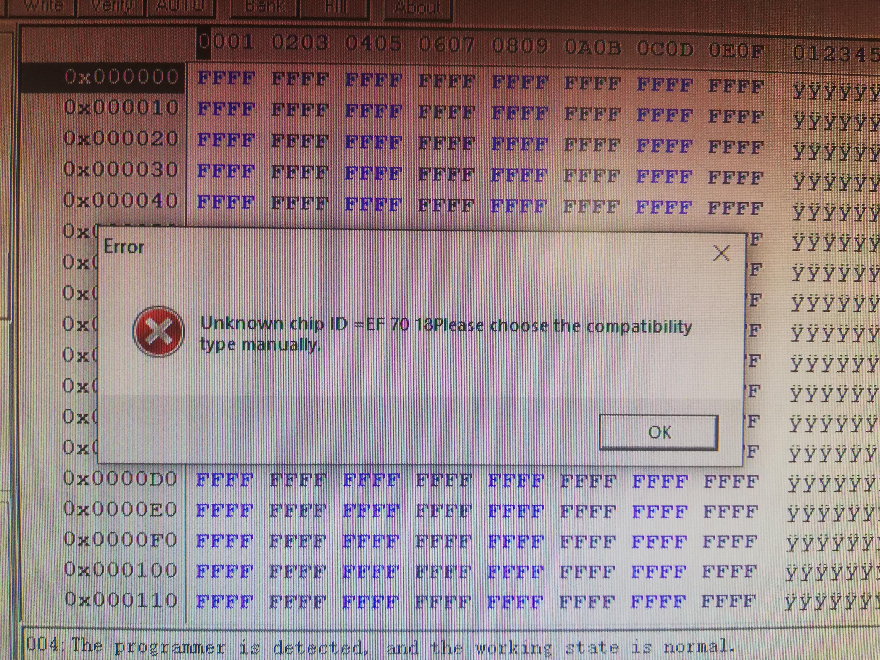

    Hi I should program this eeprom: 25Q128JVSM Winbond but my EZP2019 + programmer gives me the attached message in the picture that I don't understand.
    Can you help me? Thank you

    Try the latest version.
      • 31087
      Re: Programmer eeprom
      turn off the device id checking if you can
      stupid winbond made 2 versions with different electronic ID, and stupid EZP programmers didnt notice!
      page 22 in the datasheet
