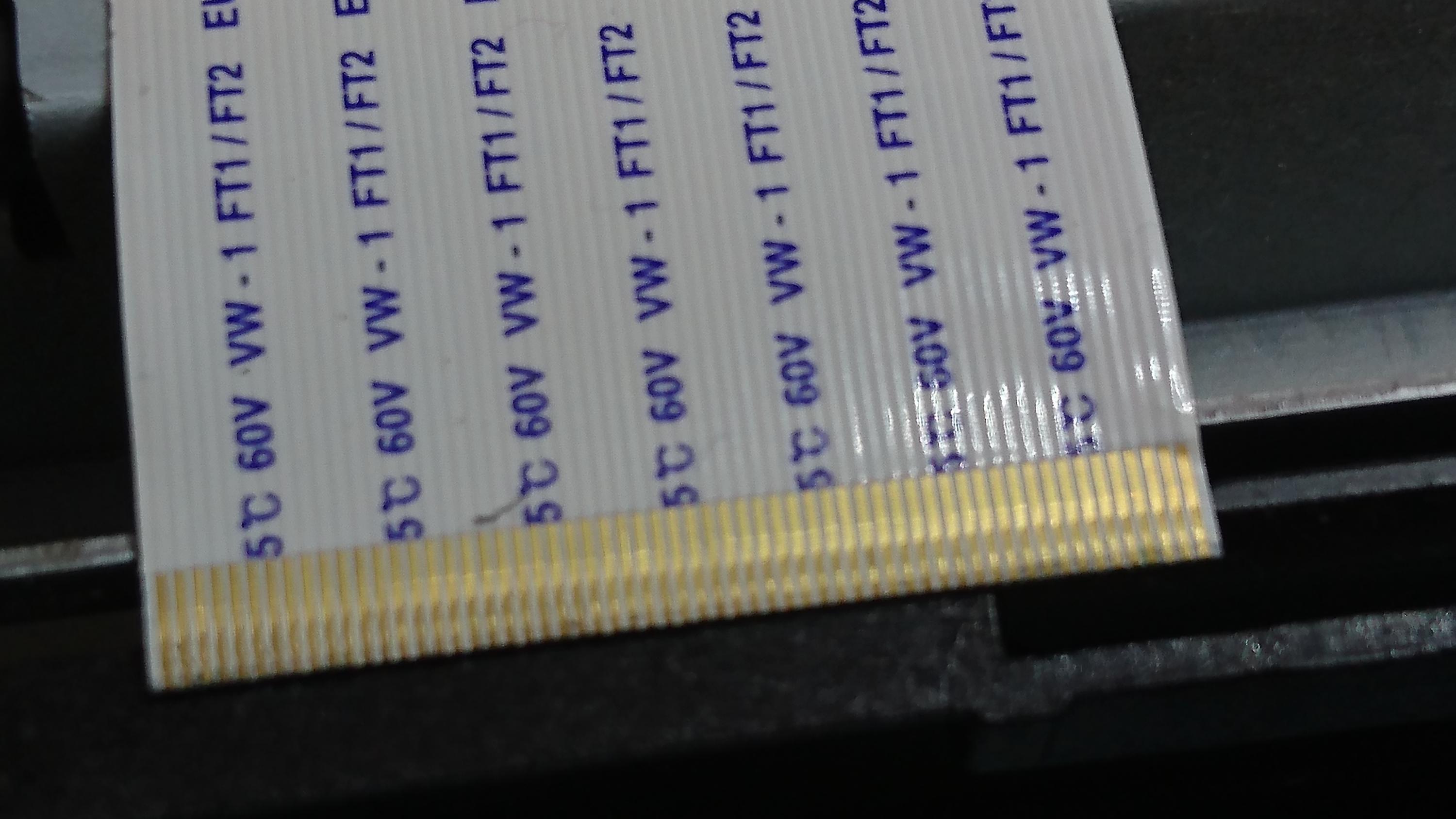

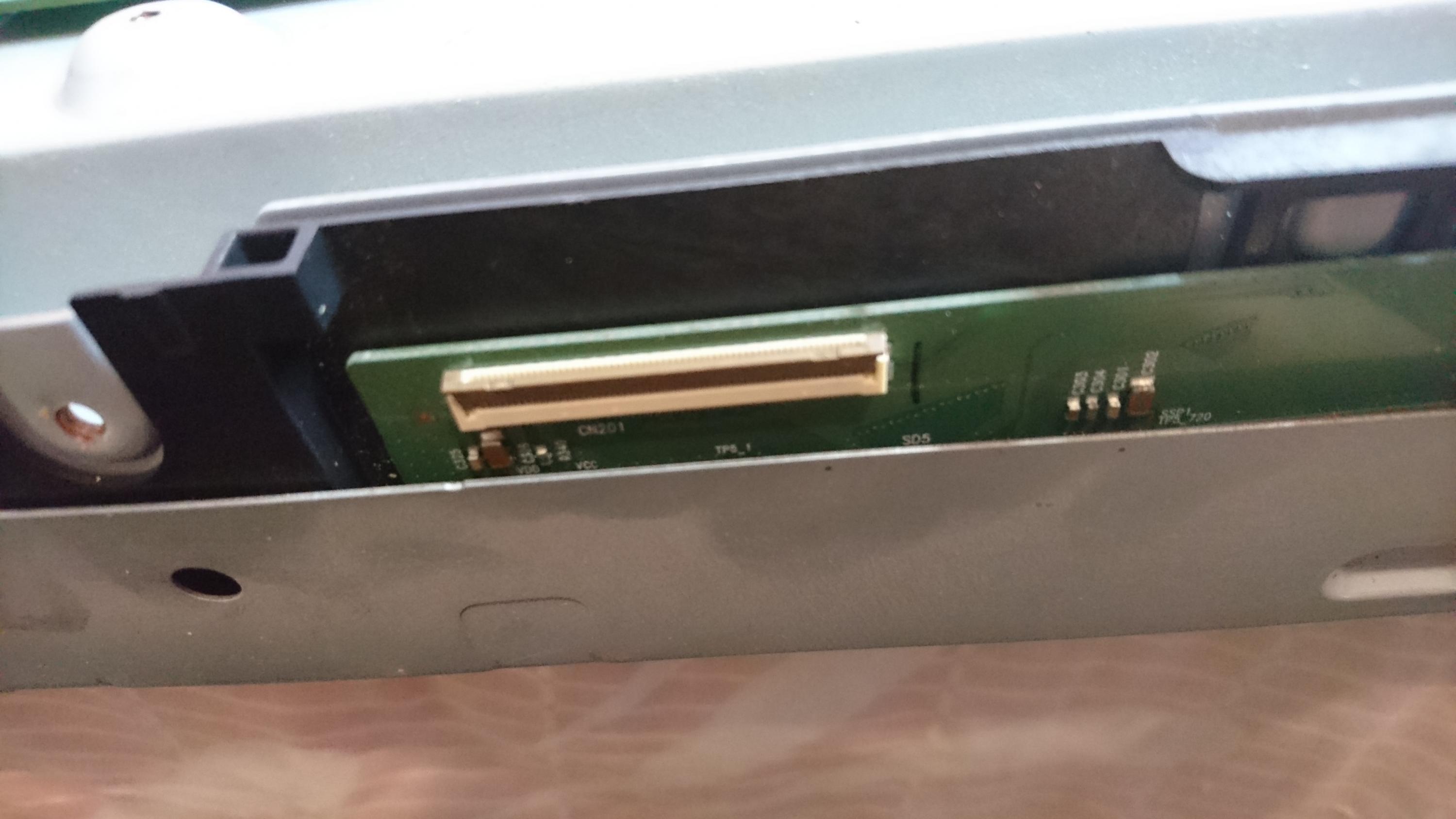

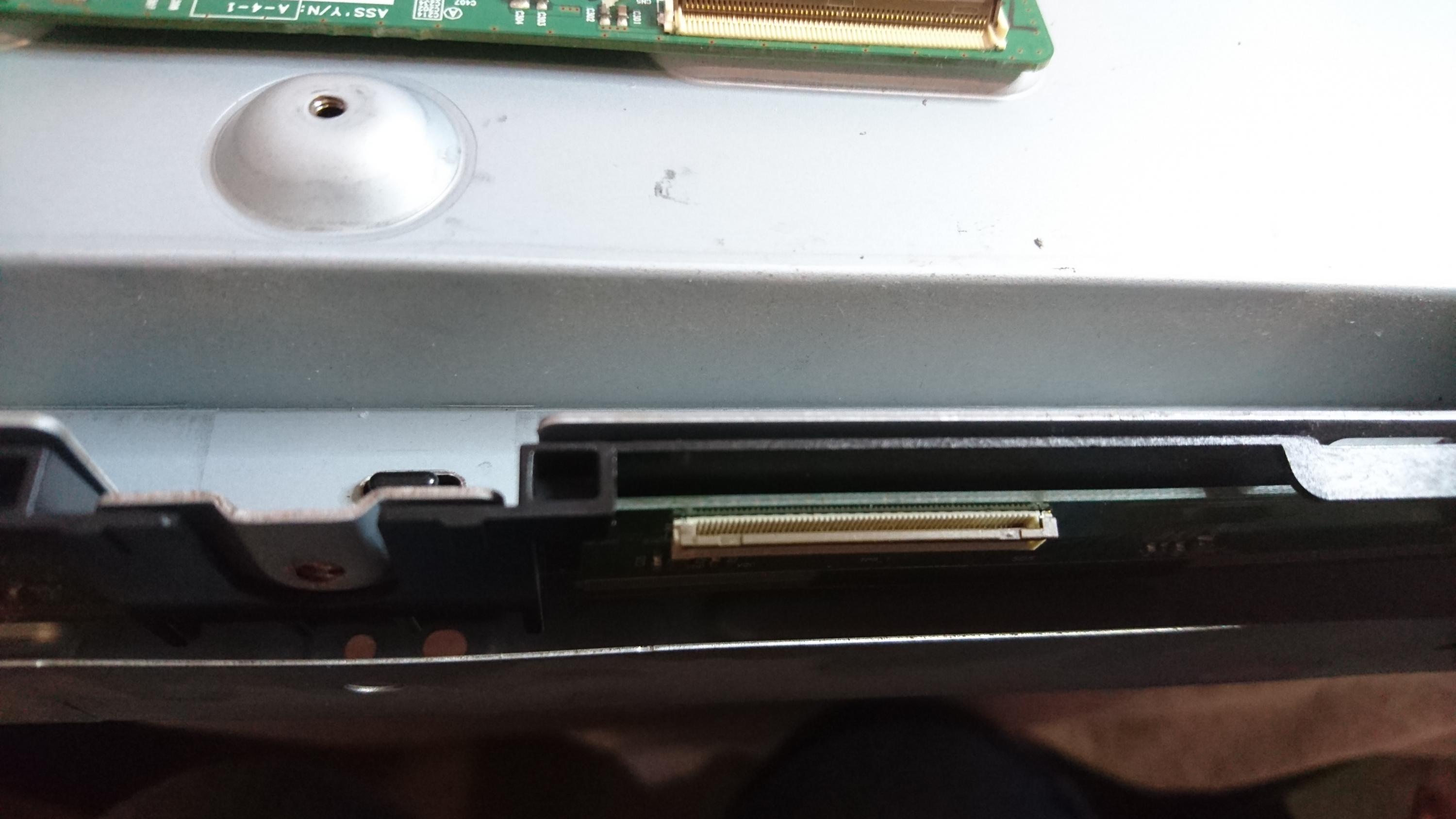

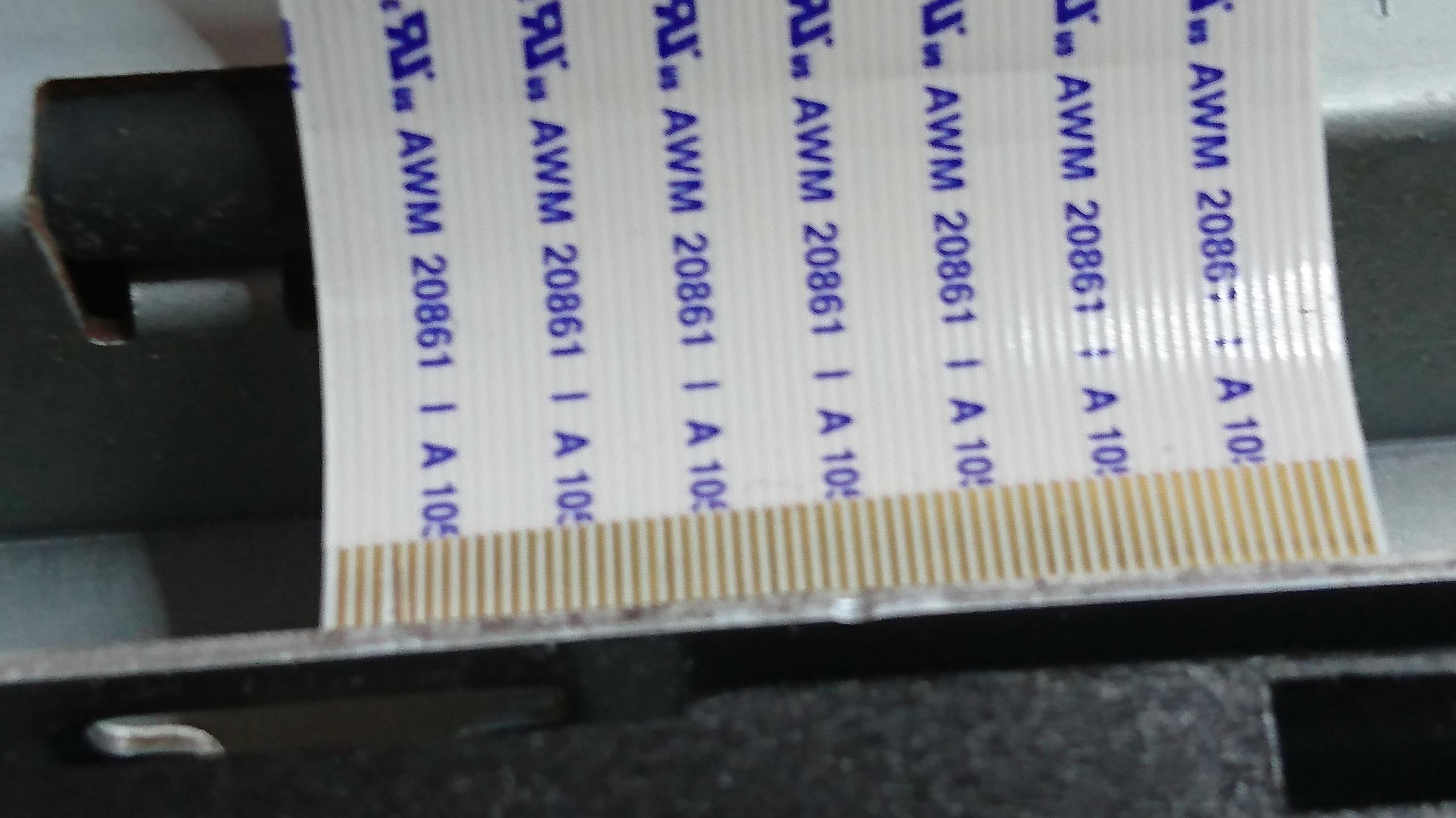

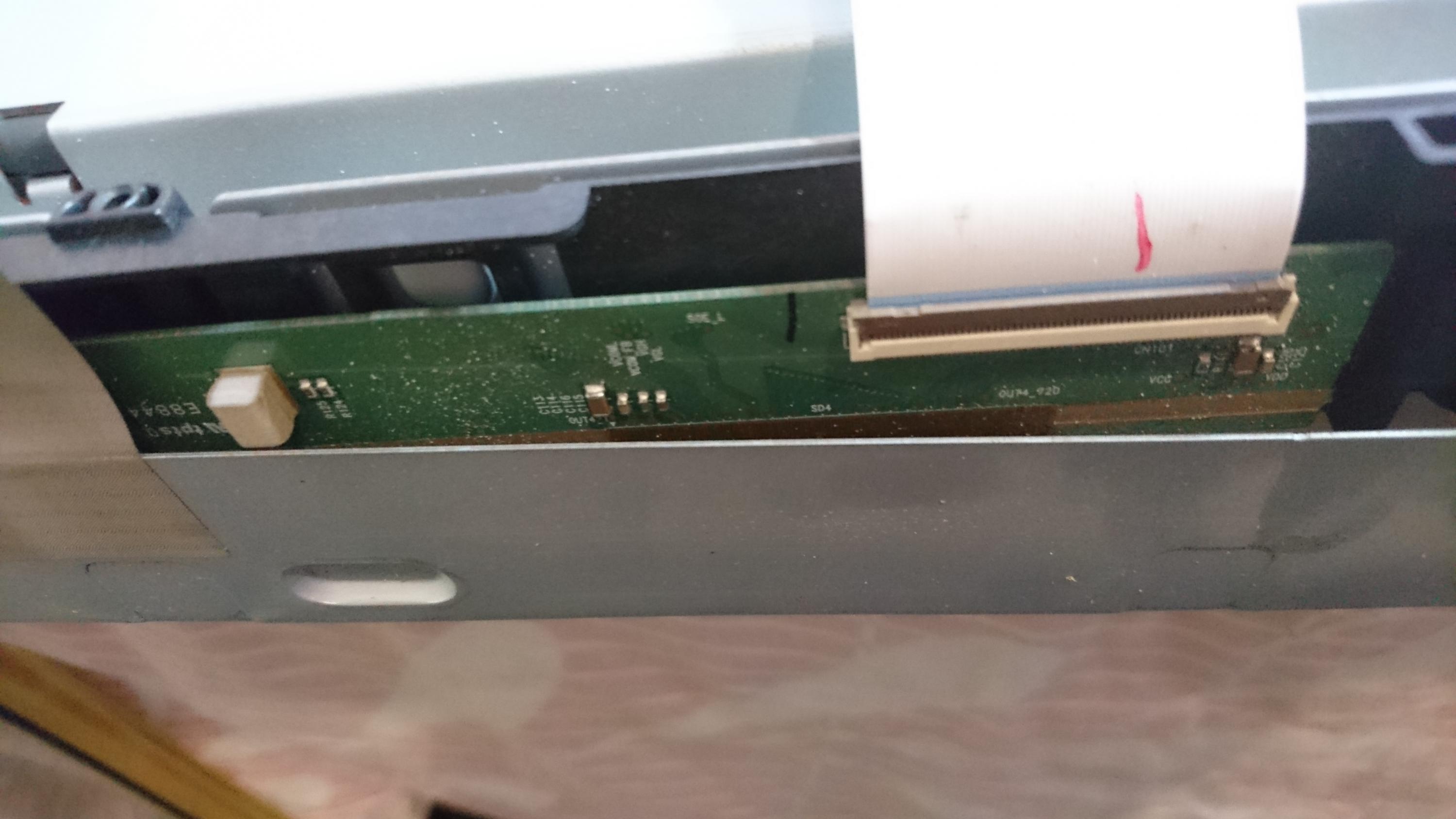

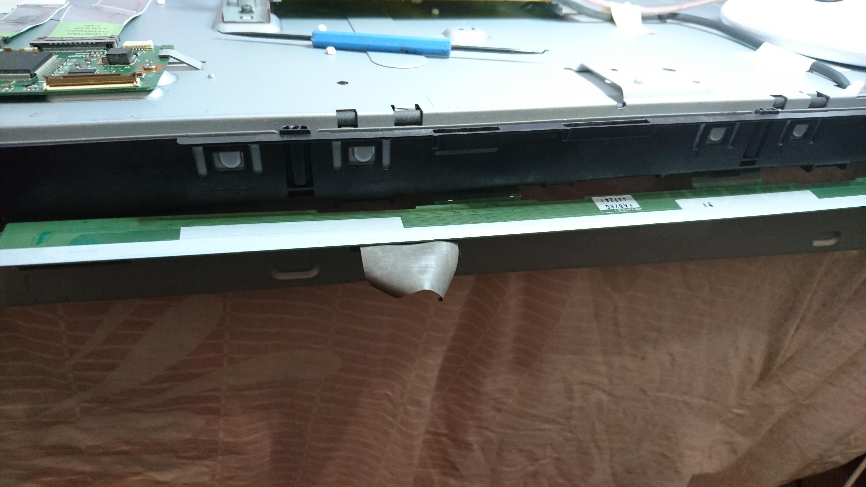

    The fpc connector is broken, where it connects from the tcon to the lcd panel source board, so it will not secure the ribbon cable in properly. I don't want to trash this tv as screen is fine but the board this ribbon cable attaches to secures directly to the panel. Pls see pics for more info. What tips does anyone have to fix this.
    pin 4 and 5 on the ribbon cable from the left appear to be too close together, could someone pls verify if this is the case?

      I've used a thin piece of plastic in the slot over/under (depending on pin location) the cable to provide extra force to ensure a good contact.
      The pin spacing looks slightly off, but the photo is blurred and you have the original in front of you, perhaps that part of the track has become unattached from the back.
      Buy a cheap $1 microscope to help you see the details.
