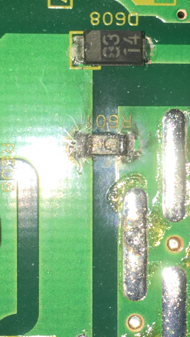

    Sorry for all the stupid questions I'm a noob just trying to diy my tv since money's tight so can't afford a new tv.
    • Fordman
      • Dec 2017
      • 28
      Re: Need resistor help

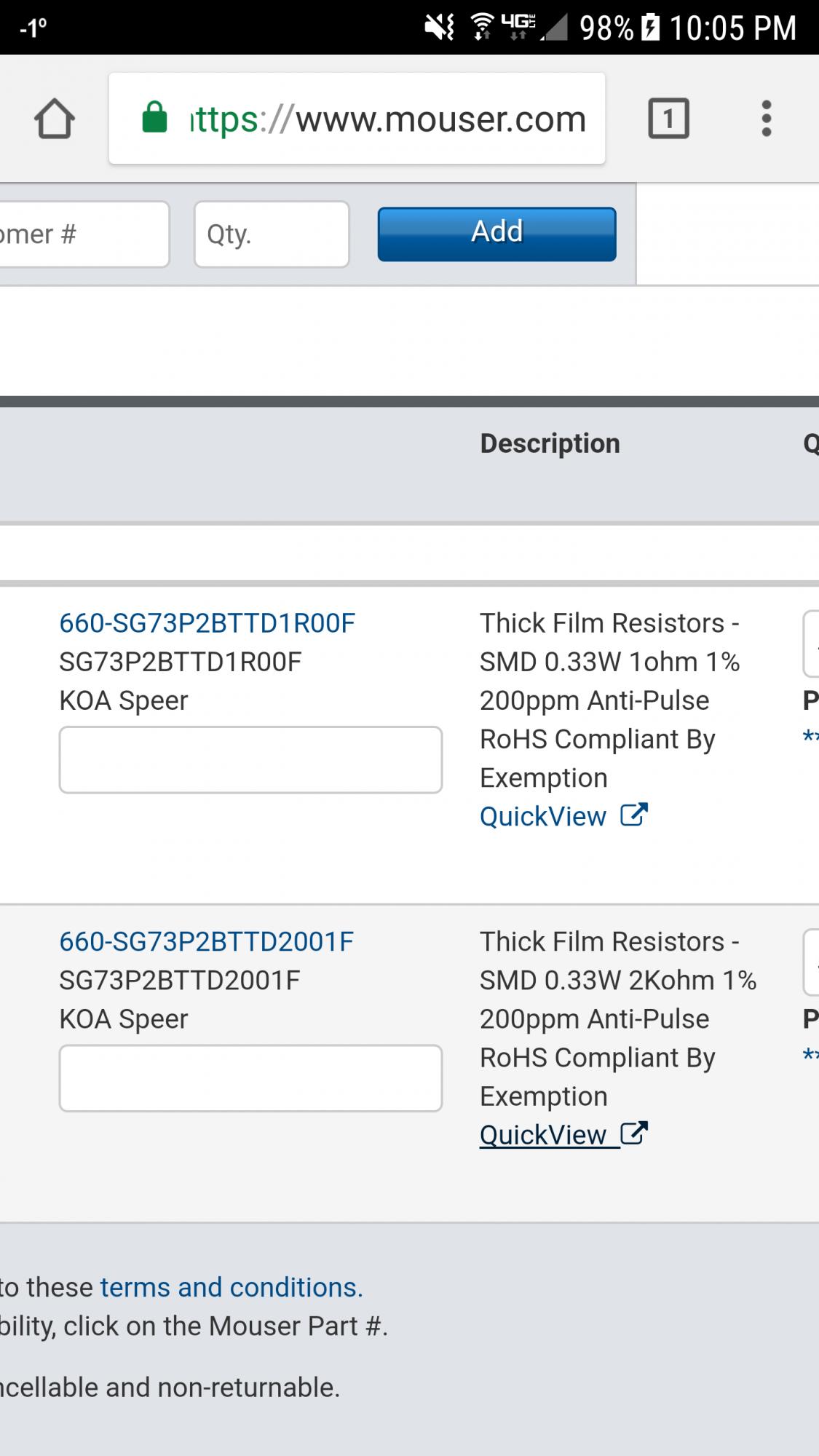

      So based on the info these should work to replace my two blown resistors.

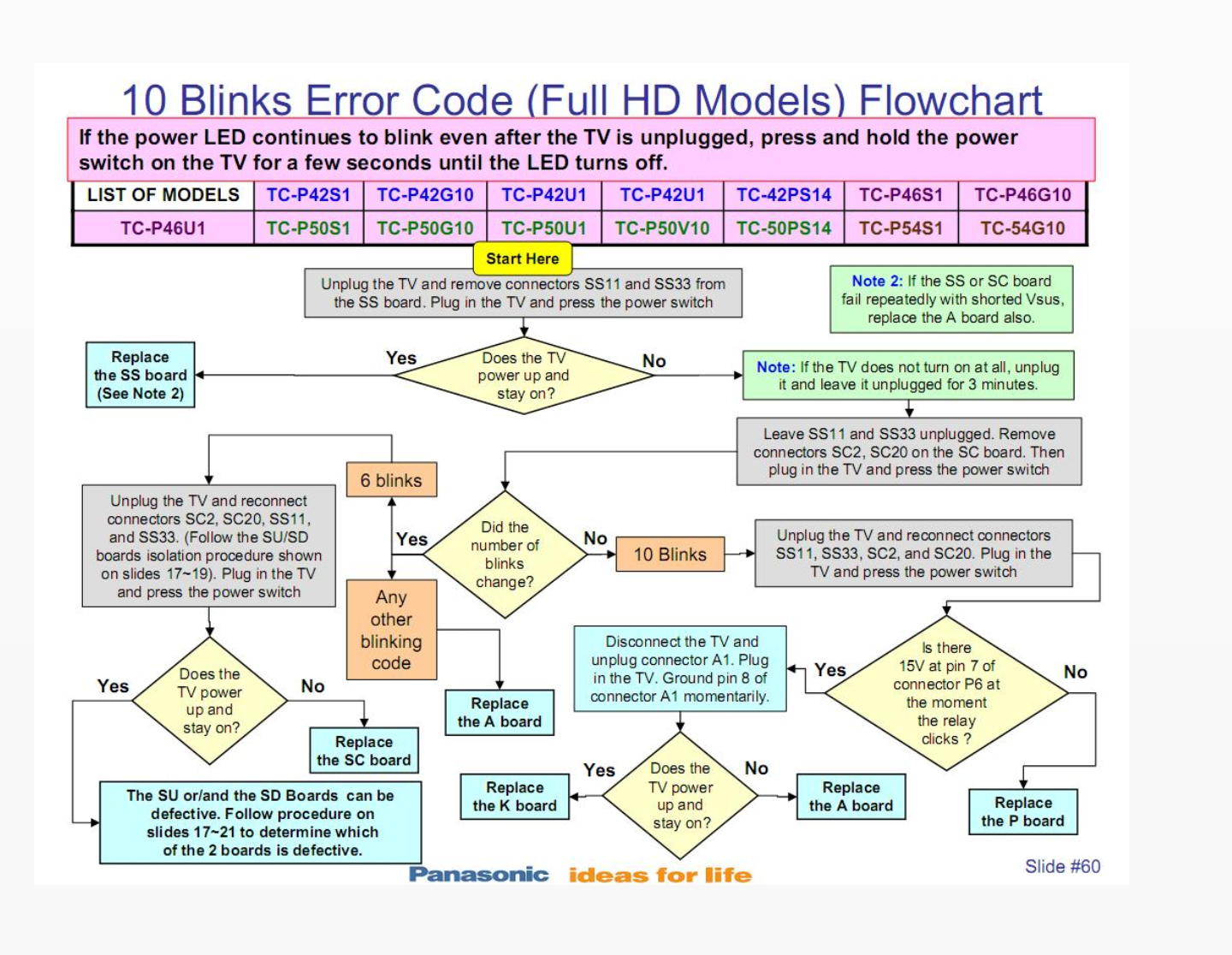

                  Ok I'm stuck on what way to go need more help. I followed this flow chart and unplugged ss11 and ss33 tv doesn't stay on. So per chart removed sc2 and sc20 and now got 6 blinks. So next is to remove all 4 screws from the su/sd boards plus the three connections. Then jumper sc50 and if tv stays on sc is good and su or sd bad but if still no good and 10 blinks it the sc still correct.

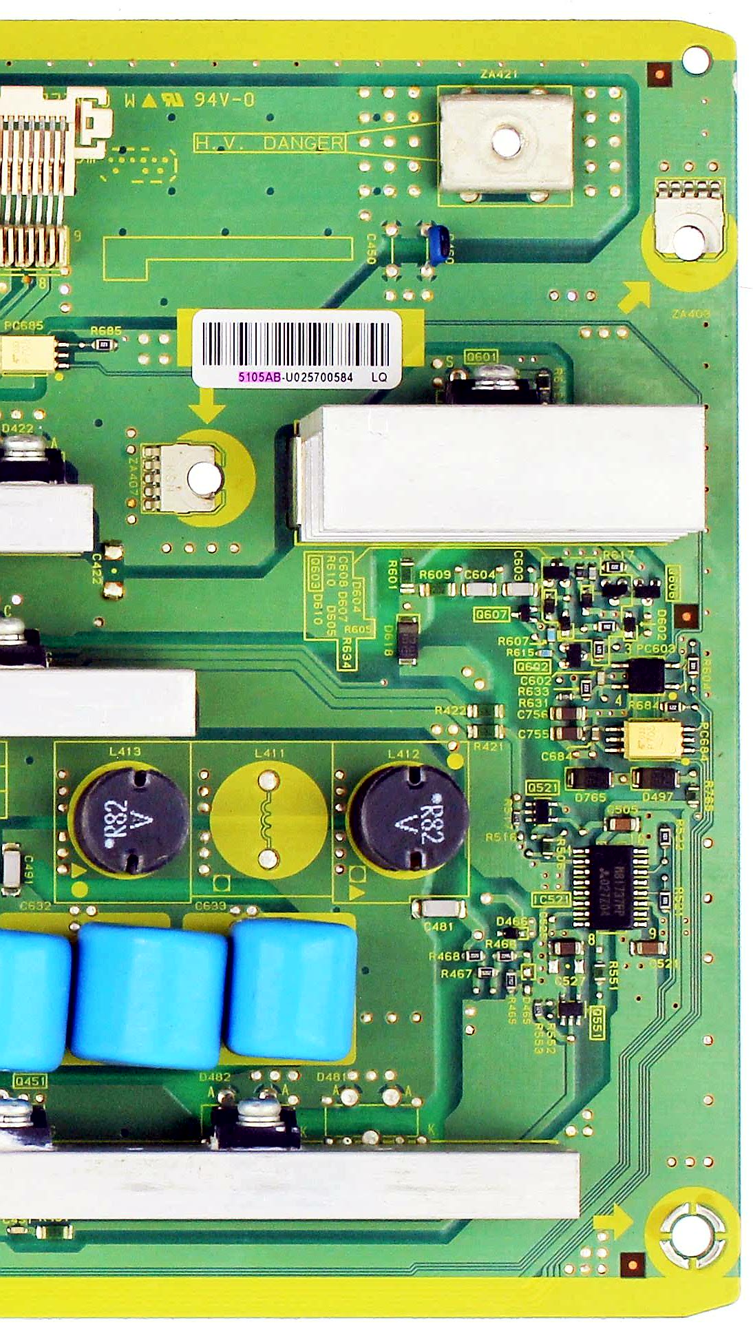

                        If your tv is model TC-P50S2 then I believe you have to put 16 in front of the numbers on the SC board. R601 becomes R16601, D618 becomes D16618, Q601 becomes Q16601.
                        If this is correct then R16601 is a 1 ohm 0.33W resistor
                        I would also check all the above components which may well be damaged.
                        See page 82 of manual

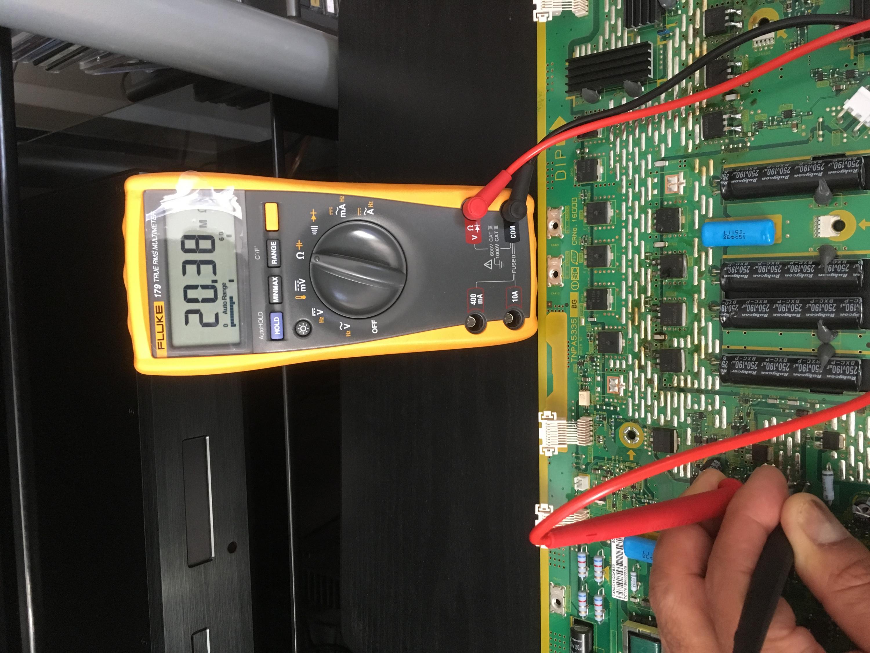

                              tested the resistor ang get this reading.. does this mean its not shagged?

                                    #37
                                    That resistor shows in the repair manual as:
                                    R16601 D0GF1R0JA047 M 1 OHM,J,1/3W
                                    Your reading shows 20.38Mohms, so it's broken. Mohm stands for Milions of ohms...
                                    I am sure you have more than this simple resistor to fix, there's a reason it blew up like that...
                                    Here's the manual for P55GT30. Maybe it's useful...
                                    Usually the variants ST30, GT30 and VT30 are very similar but not identical.
                                    And yes, dick_barton is right, you want to "read" 16 in the schematics for all parts, ie. resistor marked R601 on your board is named R16601 in the schematics and the tables after that (bill of materials).
