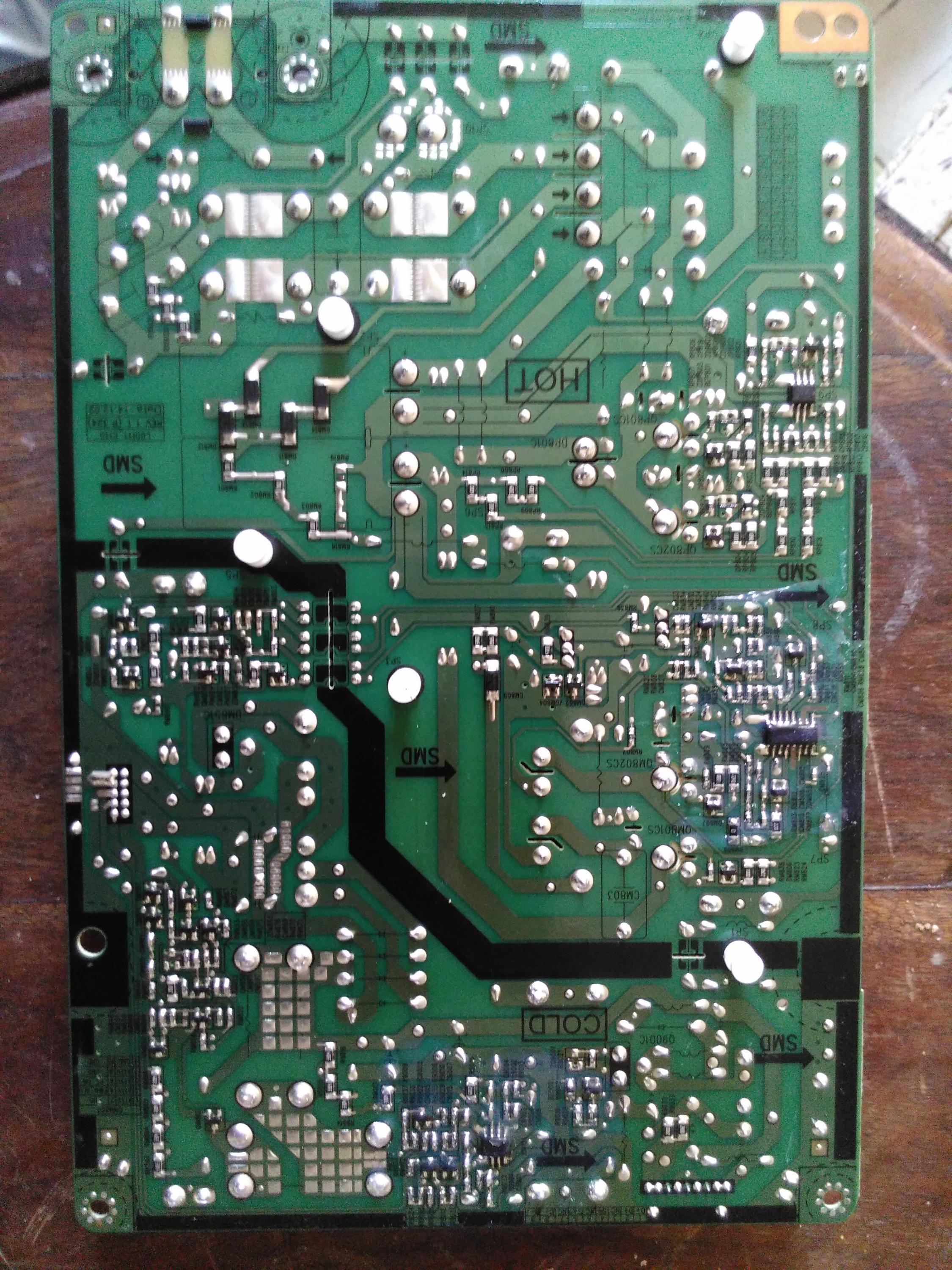

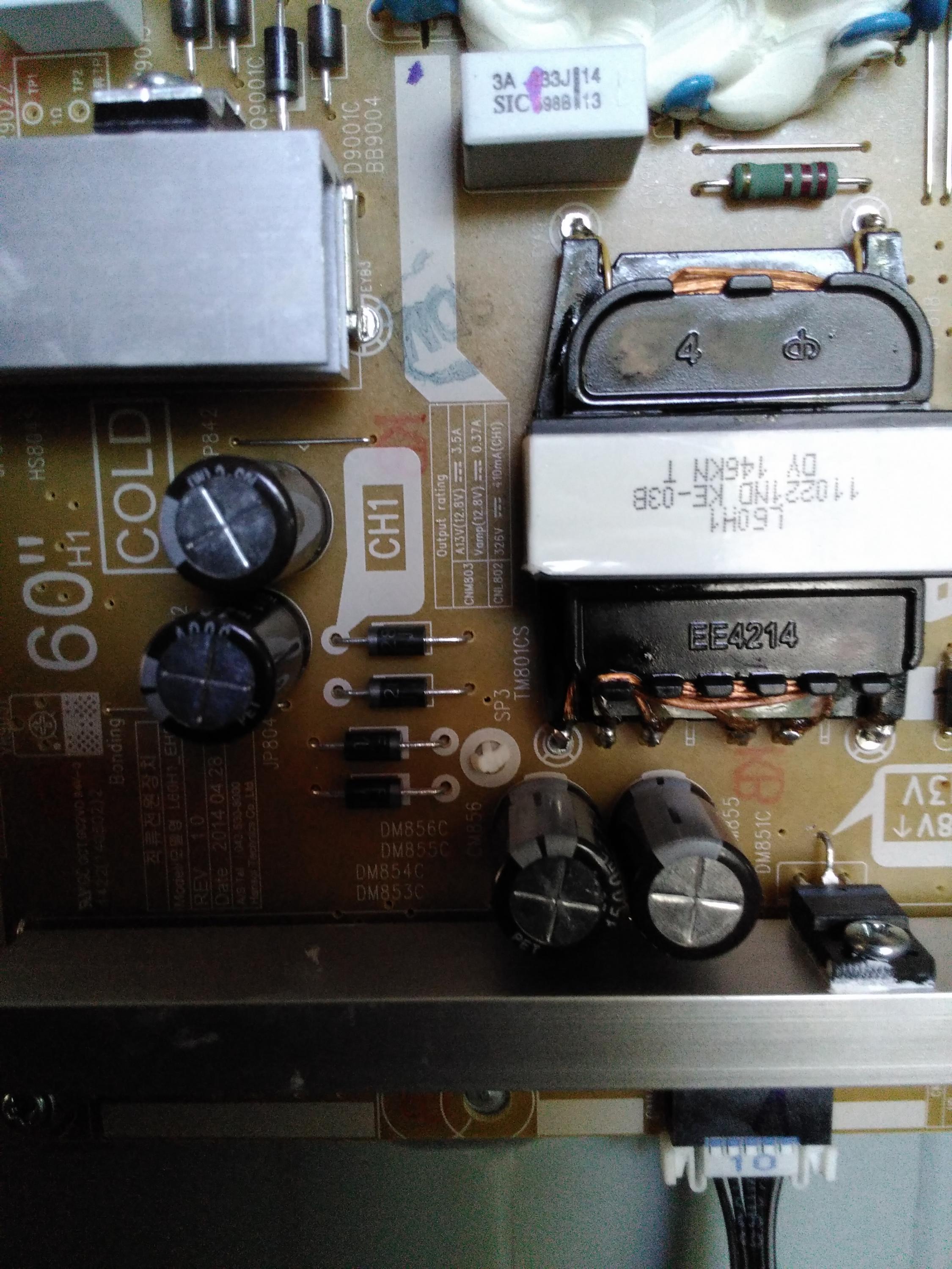

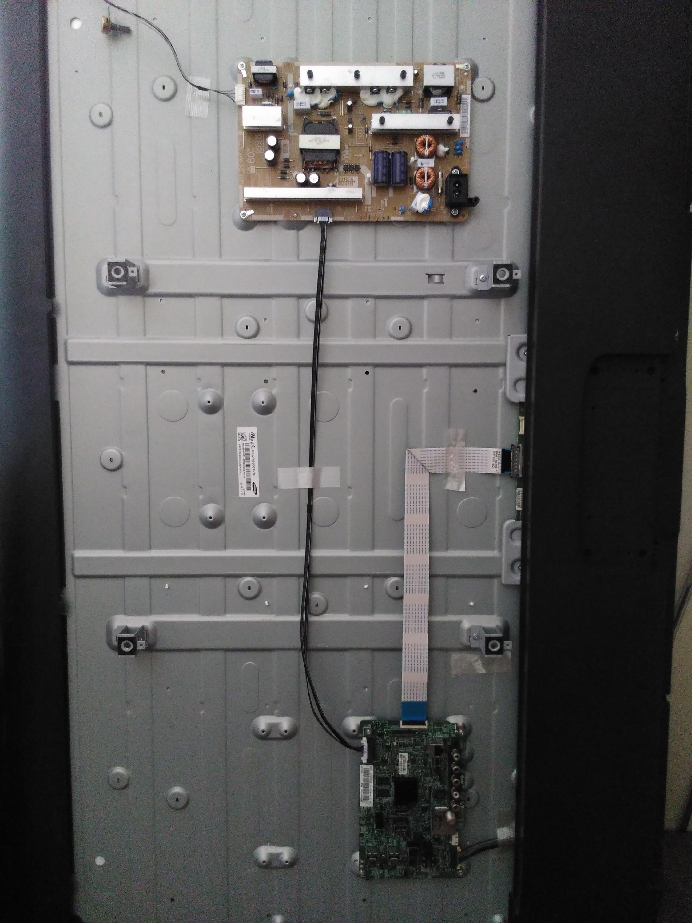

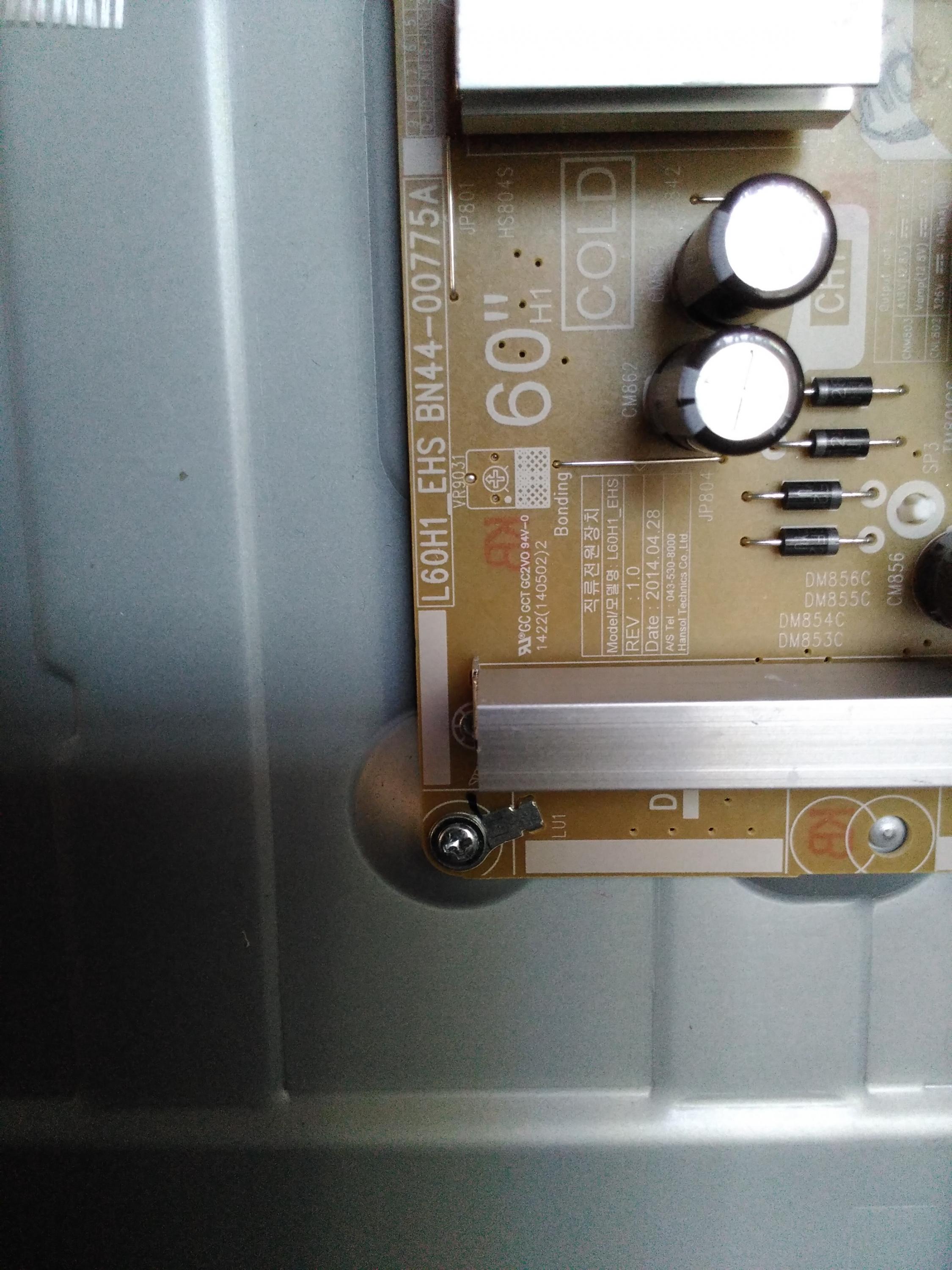

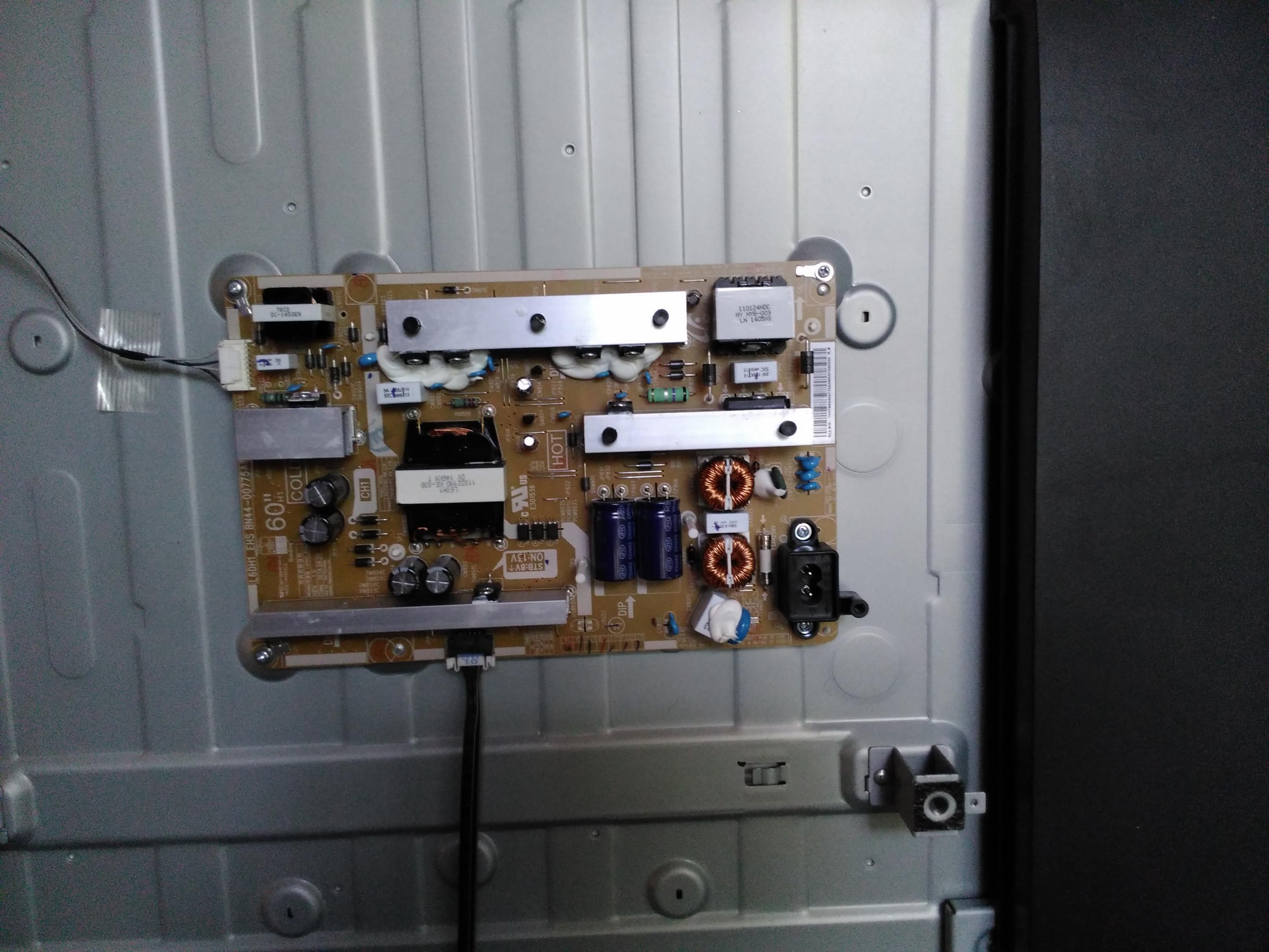

    Hi guys
    This TV backlight flashes constantly from the time it is plugged in. Unplugging the Mother board causes no change. I thought it was bad leds so I opened the panel and attached an LED tester and all the leds lit up which led me to conclude it was a bad power supply. I replaced it but the problem still remains.What I have noticed is the standby and the voltage across the mains filter caps are fluctuating and very low, eg standby 4 - 6 V and mains 150 - 160V . With the back light disconnected standby is 13V on and mains 390V. What am I missing here? I did a video when I was testing the backlight. I would have to post a link .
    Re: Samsung UN60J6200AF backlight flashing
    We need good clear pictures of the whole backside of the TV showing how all the boards are connected together, then the pictures of the whole top and bottom side of the power supply board.
    Power suPply P/N is BN44-?????
      photos,and video links
