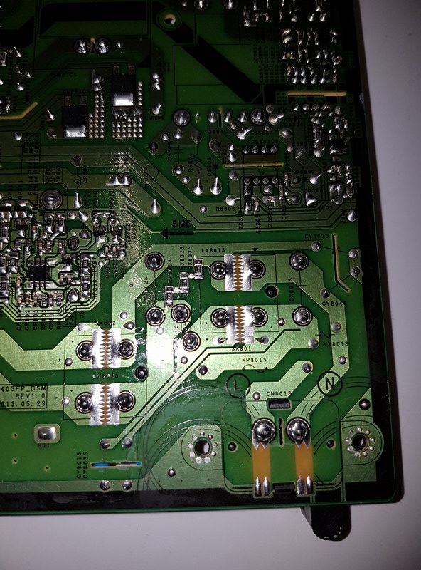

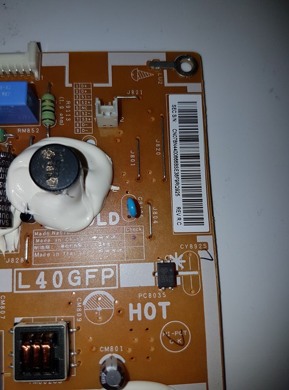

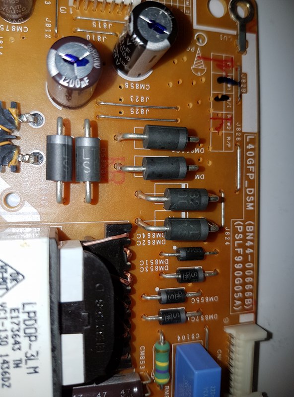

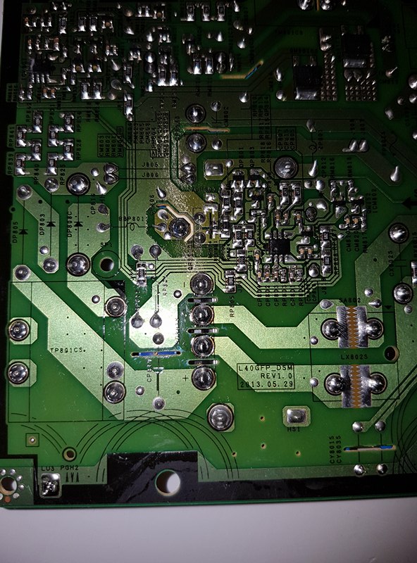

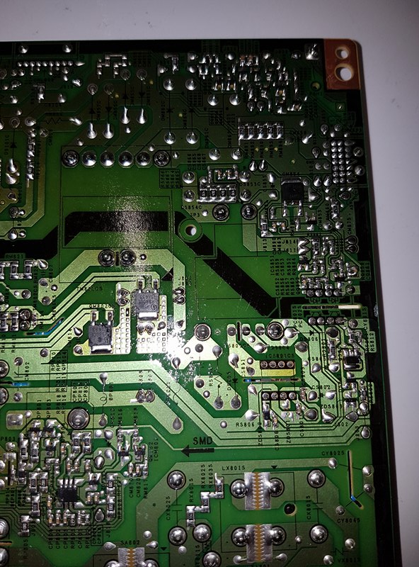

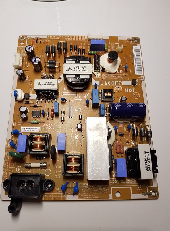

    Re: Samsung UE40EH5000K No Power

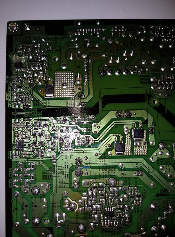

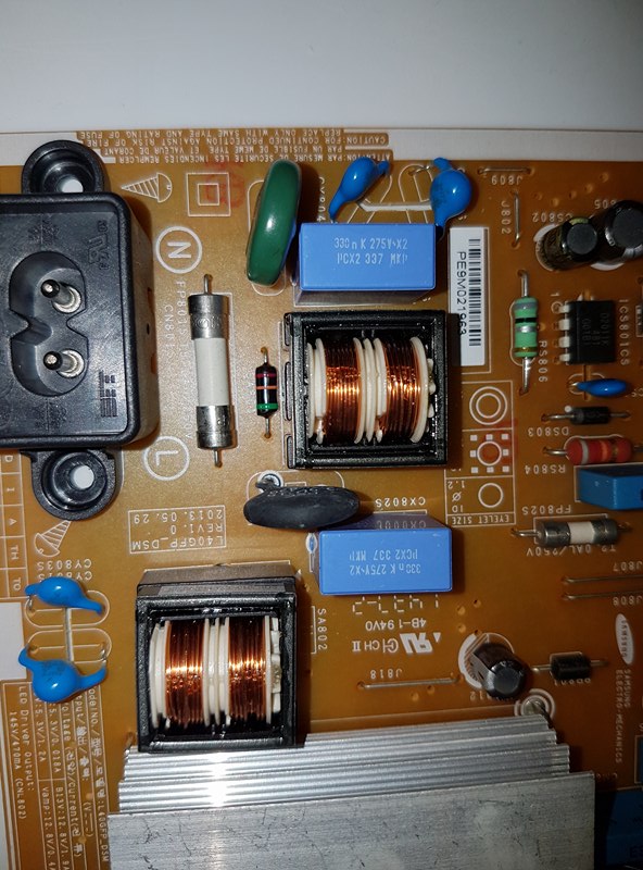

    here are photo's of the PSU guys

        Hi there.
        Thanks for the reply there is no output at all i have done some further testing and the fuse FP8015 T5.0AH 250V
        Has blown
        So no power at all on any connector

          Well I would say a bad power board

                  Check all the Devices that are mounted on the heatsink in the primary side of the circuit for shorts.
                        ive discovered a few parts are bad on the PSU
                        DM855C
                        DM857C
                        DM853C
                        DM851C
                        have no continuity at all
                        and the main input fuse
                        is there any point repairing them ?
                        or should I just replace the board ?
                        thanks
                          Seems strange you have blown fuse and open diodes
                              How are you measuring the diodes? are you using the diode test mode on the meter or just checking their resistance?
                              If the diodes are indeed open, that will not blow the fuse.
                                      Hi guys
                                      Sorry ive not been in touch sooner.
                                      Happy new year to you all.
                                      Well anyway the mosfet is shorted to ground as ive discovered that by testing it with a multimeter.
                                      Ive got a replacement mosfet but its slightly less on the spec
                                      The original one is a 60R580P
                                      And the replacement one is a 13N50C
                                      Do u think it would be ok for testing purposes as im still learning all this.
                                        Underspecd component may work for testing but will not last.
